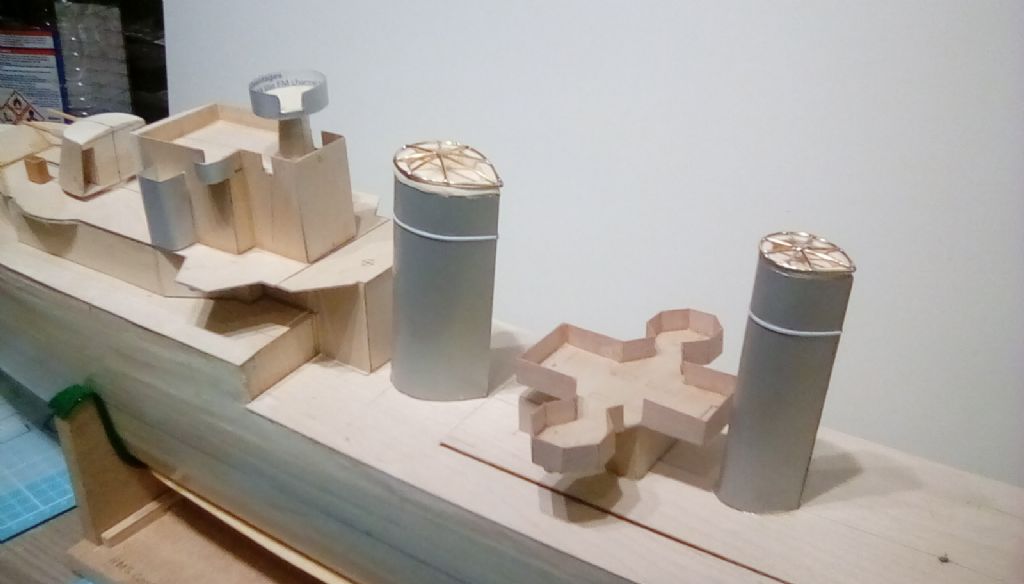

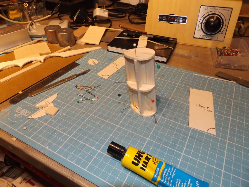

          I have to do things the hard way! here is the balsa core of the main forward funnel, the idea is to roll some litho plate sheet and wrap it round, will be interesting if it works
          #84434
            Your problem may be to avoid getting dents or creases in the lithoplate. You will need to be careful. In those circumstances I have used 1/64 (0.4mm) birch ply very successfully.
            #84435
              Hi oh wise one (Colin)
              You were right about the dents & creases in litho plate, but here is the good side 😀I

                Now I have 2 funnels with the frameworks over, so covers could be deployed over the funnels when in port I guess.
                Torpedo tubes next 😀

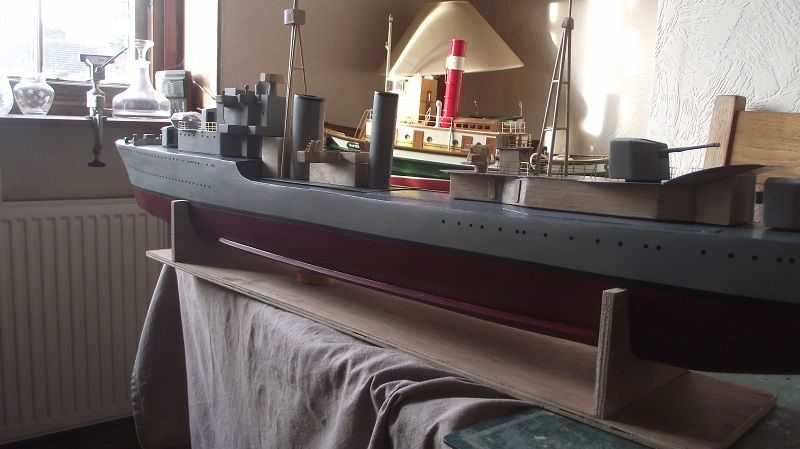

                  Hi.All, much more progress on Cossack this last week, the hull is now painted, I am just waiting for some decal paper to arrive for the No. L03,I have a couple of sheets some where in a safe place, but I haven't found the safe place yetsad.
                  The 'portholes' are all fitted on the hull and some of the railings on the upper works, not sure which is the most fun,cutting dozens of little black plastic dots or drilling dozens of 1mm. holes for stanchionslaugh.
                  This could be a long time to finish if all the lockers and deck hatches are added, but they can be made and fitted after all the main structure is done.
                  Regards.
                  Eddie.

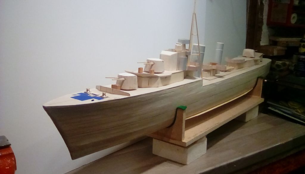

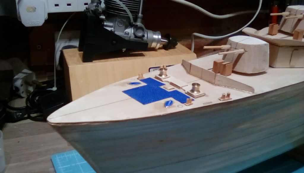

                  #84534
                    Hi Eddie,
                    I'm waiting a while before I give her a couple of coats of sanding sealer then Halfords grey for the hull & superstructure & red oxide primer below the waterline. Which shade of grey paint have you used??
                    The blue patch on the foredeck is a heavy weave fabric which looks like chequer plate when painted.
                    There are many lockers on the deck which I'm using hard wood blocks, trying to scratch build the fittings to keep costs down
                    The decks looked like timber planks in one of the images you posted a while back with the red white & blue turret?

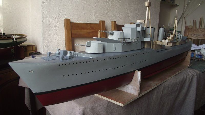

                        Hi, Ray,yes I looked at that colour sceme, and I have seen another model painted in those colours,I quite like it, but I don't think she would have been like that on the Russian convoy duties.
                        The below waterline colour is Revell 331 purple red, the hull and topsides are Tamiya XF80 royal light grey, the deck is Tamiya XF 53 neutral grey all are water based acrylic, when the decals are on I will finish it off with a coat of matt varnish.
                        I have used a fine wire mesh in front of the anchor capstans.

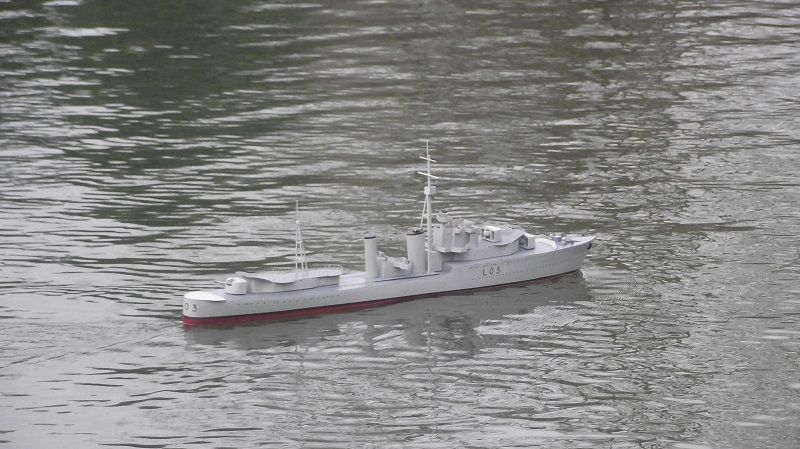

                          Hi. Cossacks, my Cossack had her fisrt sea trilals today, she is not finished yet except for the hull.
                          She sailed well but needs some of the ballast that I kept back fron the initial ballasting to establish the water line,
                          some of that will be used to correct her bows down attitude and a slight list to starboard,but apart from that I was pleased with how she handled, turninging in a little under three lengths.

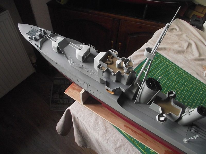

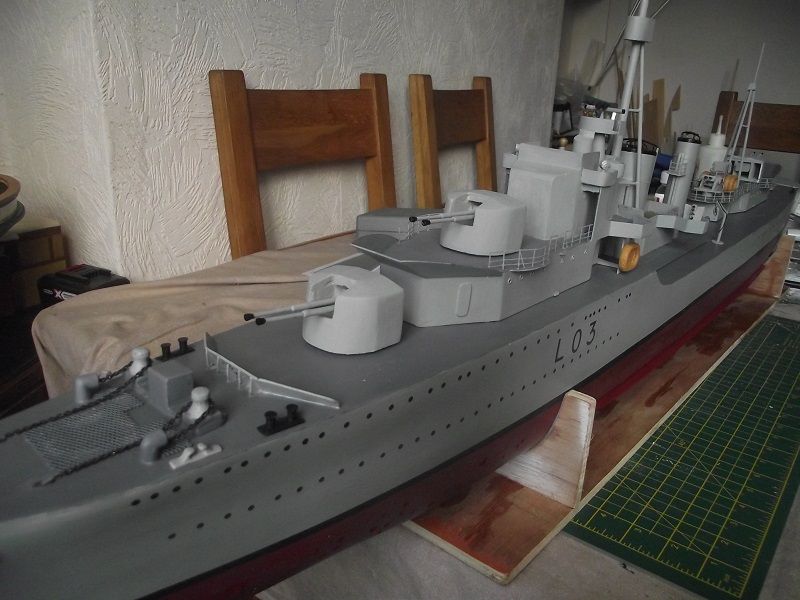

                                                      Hi. All, an update on my Cossack build,dscf3734.jpg All of the large items are made and fitted, I only need the ladders and the railings for the hull, I will get these this weekend at Ron Deans open day.
                                                      All the main parts have been scratch built with balsa, ply, bamboo skewers and cocktail sticks, the only bought in items are the brass etched railings and the ladders.
                                                      She has been back on the water ( the fish pond) to sought the ballast out to bring her onto an even keel, she needs another kilo to bring her down to the waterline, I'm not sure of her all up weight as my kitchen scales only go up to 3 Kilos.
                                                      If the weather is kind to us tomorrow she will be backout for further running trials.
