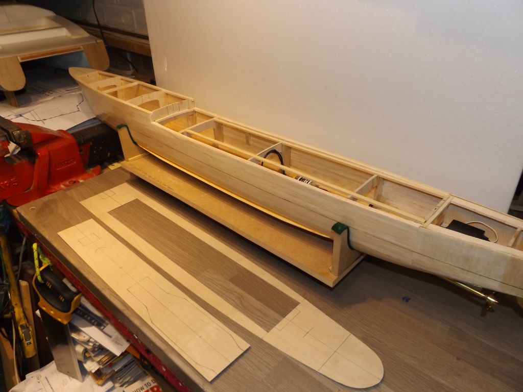

              Hi All
              Here we go with the rear superstructure good old 1/16" ply with 1 /32" decks this is the fun part 😀I
              Any more takers for the build ??

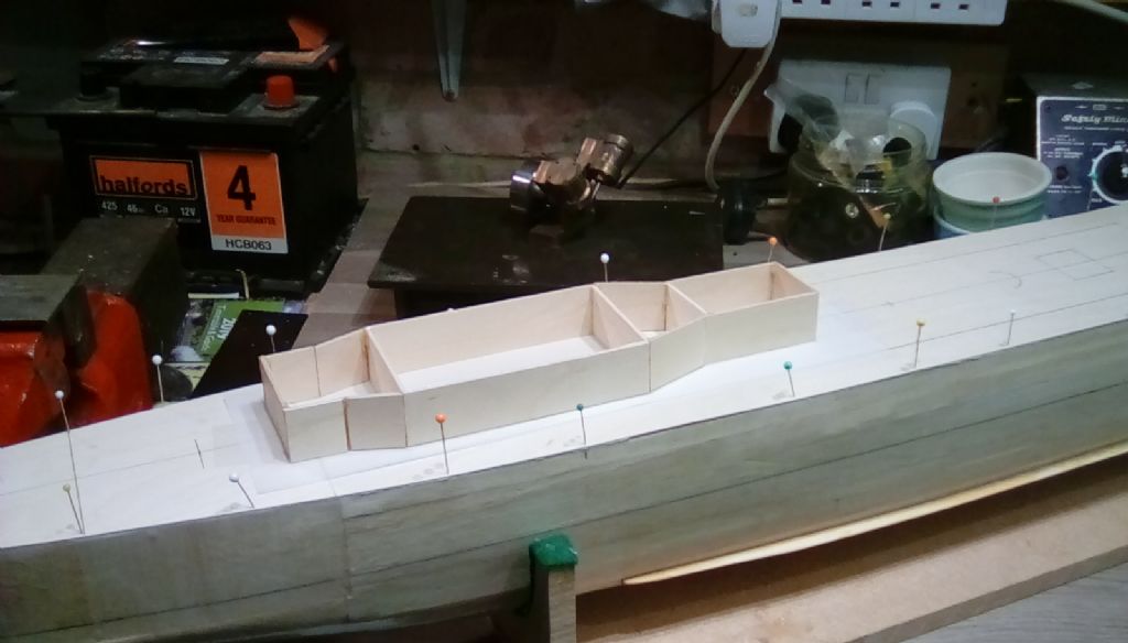

                          Hi Cossacks,
                          If I learned anything from building HMS Diamond a slightly more modern Daring Class Destroyer you always need good access to the works for oiling and running repairs, so Cossack is having a large section of the rear decking removable, which will include the rear superstructure, AA platform, torpedo tubes and the rear funnel, easy to say but keeping the deck camber maybe a challenge, we will see
                          I have cut up and painted 1/4" steel plates to fit inside the base of the hull to put 5 lbs of ballast in the best place, then the decks will be glued in place.
                          Eddie and I are meeting up on Sunday morning to compare notes and hulls at the Chantry MBC's tug day at Bluewater Shopping Centre.coss 031019.jpg

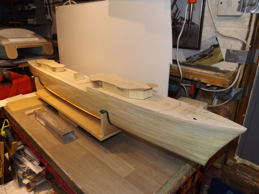

                            Good Afternoon Cossacks
                            Major milestone reached, both decks and basic superstructures in place

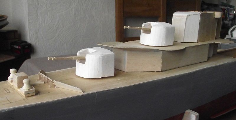

                                  Eddie Lancaster
                                    @eddielancaster
                                    A bit of progress on Cossack this week, foredeck fitted and other bits and pieces made ready to fit when painted.

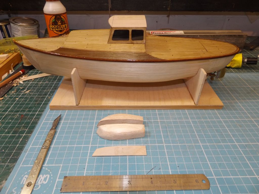

                                      Hi Eddie,
                                      Well you have zoomed into the lead with your Cossack build well done I've been slightly diverted with Mini Mist my 15" version of Vic Smeed's Silver Mist, but will be back on Cossack soon, I have made the central Pom Pom structure but not the bridge, what a task !!

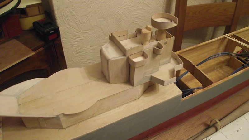

                                              Eddie Lancaster
                                                @eddielancaster
                                                Hi.Cossacks, a bit more work done on the bridge, there is a lot more detailthat can be added,how far are we going to go?
