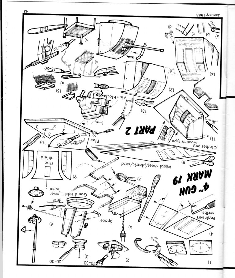

          Hi ya Ray and fellow Cossackers this scan which I have put on here may help you make a simplified 4 inch gun – although it's only single barrel – it could be simply adapted for the twin barrelled version – the article comes from Model Boats magazine January 1983 – I believe (by reading part of the article) that in February 1983, there was a follow up article – which covered the double barrelled version of the gun. Until I find that issue (if I have it) I am a bit unsure – someone though may have the February issue of the magazine and be able to confirm it.
          Whilst search for the article, I came across several articles in Model Boats magazines (Feb 1970) a guy has built a 1:72 HMS Cossack from the same set of plans – overall length 63 inches.
          So I will carry on searching and see if I can find more information in my back issues of Model Boats mags.

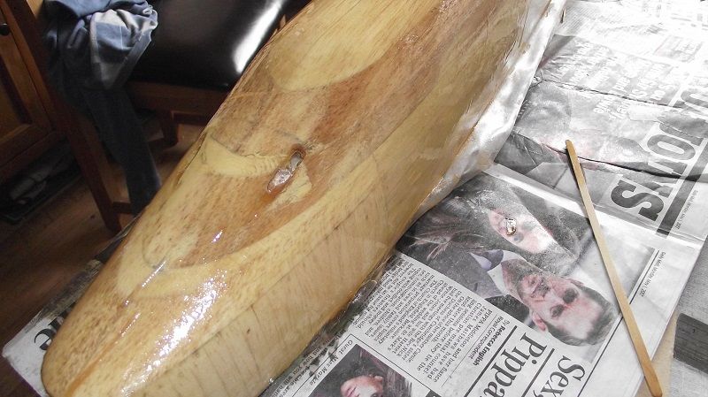

              Hi. All, thanks John,duly printed offsmiley it will help no end with the pictures I have posted.
              My hull with a covering of glass cloth and three coats of epoxy resin,the fisrt two thinned with approx. 25% meths.
              The prop shafts and motors have been dry fitted but removed to put the glass and resin on,I then cut the glass away from the holes while the resin was still green.

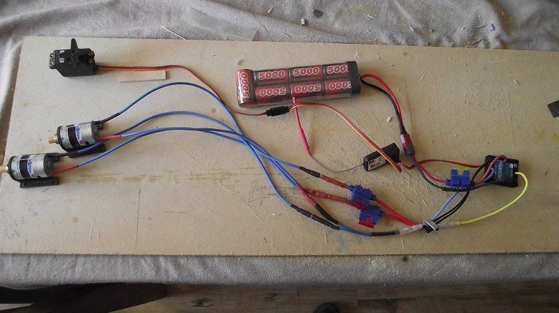

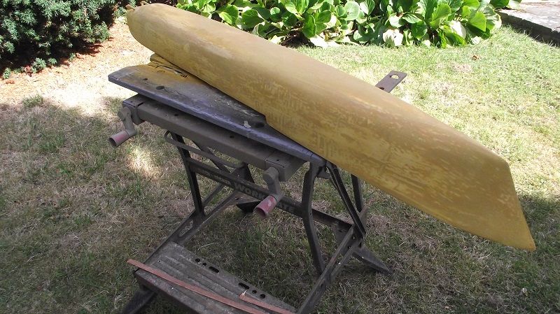

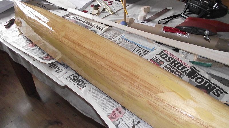

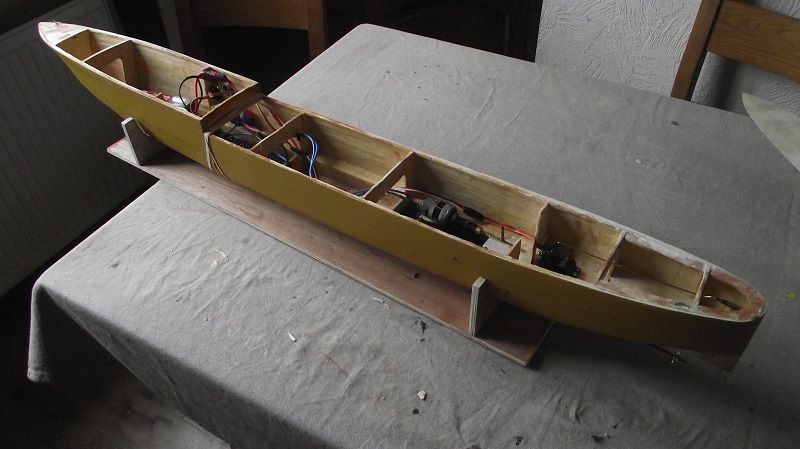

                    The hull with it's fisrt coat of primer filler sanded down showing the umps, and ollers that will need more filler primer and finally filler to get a smooth finish.
                    The electrics/ electronics connected and tested ready for fitting.

                      Looking good, you may have to do some carving to get the motors in low enough, I did but it depends on the angle of your stern tubes 😊 see you on Sunday for the racing at Bluewater 😄

                        Hi. Ray, yes looking forward to Sunday again, weather should be warm but not sure about wind strength.
                        The motors have already been in place, as you say had to cut into the bottom side planks to fit them but all seems fine.

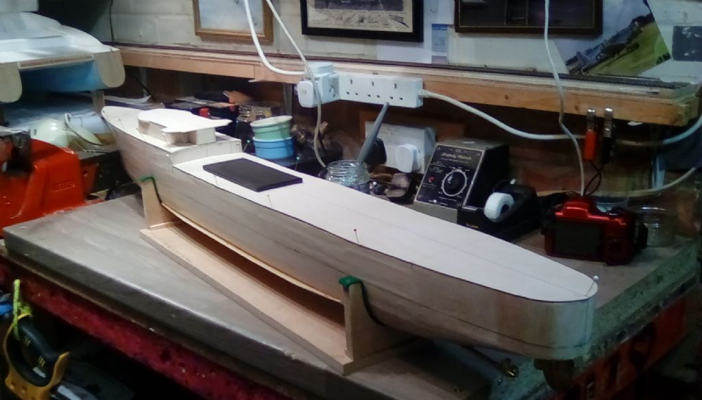

                                    Back on the case after a short break Fitted some bilges strakes form 1/8" X 1/4" obeche planed to triangular section and superglued on , these are scale as shown on Eddies recent colour drawings and will help to stop her rocking and rolling so much

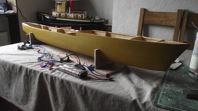

                                      Good morning Cossacks, Have done a bit moreon the hull this week after a break down in broadstairs.

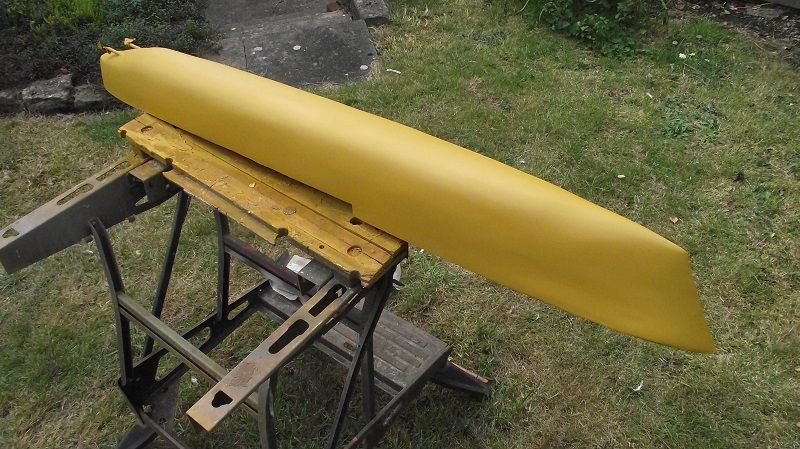

                                      I found a problem with the shape of the hull at the after end when I was rubbing down the first coats of primer,that has now been fixed with a bit of filler, and she now looks ship shape.
                                      She now has a stand and the waterline marked and the electrics are all ready to go in, it's then into the pond to see how much ballast is required.

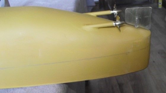

                                          Have now got the rudder made and fitted. The dining room is now a no go area for modelling until after the weekend.

                                            That's very flashy a stainless rudder ?

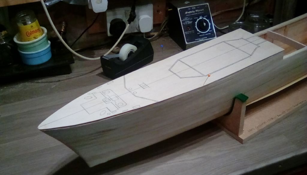

                                            I,ve traced the positions of fittings & superstucture etc & pinned the foredeck in place temporarily, I'm going to build the superstructure in situ to take account of the deck camber, which is not mentioned on the drawing. Will then take the deck off and cut the access opening and coaming/upstand.Regards

                                              Hi. Ray, it is brass, the way the light has caught makes it look silvery.I am doing somehing similar with my decks,

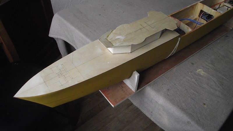

                                                    Hi. Cossacks, we now have power to the props, and steerage, she has been on the water and ballasted to the water line, it has taken 3.9 kilos spread throughout the hull,but with largest amount, 1.640 kilos in the centre section, I will keep back around 500 grams until all the topworks are complete.
                                                    The foredeckis now ready for fitting.
