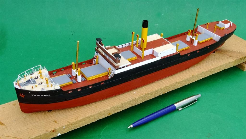

        @bobwilson59101
        Monday, 30th May, 2022
        Baron Vernon.

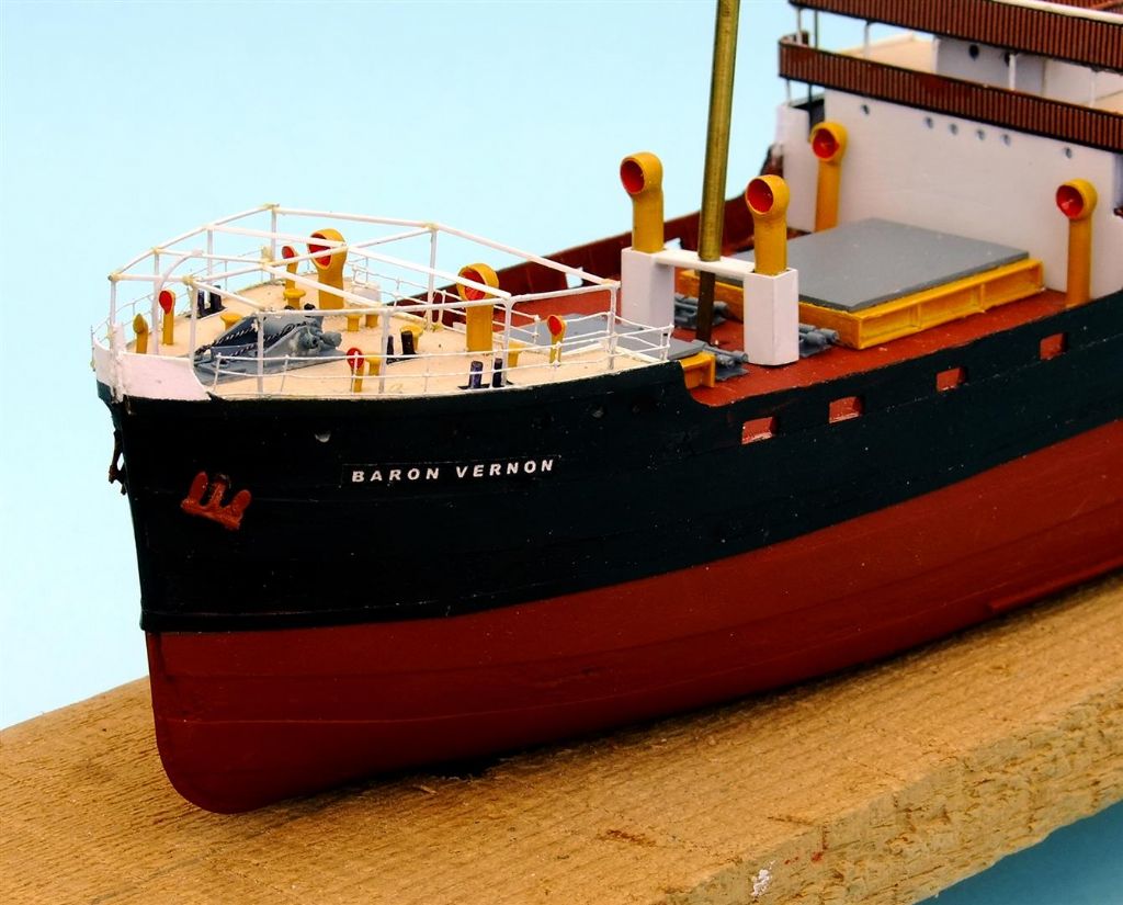

        I have now practically finished the forecastle head. This involved making and fitting the guardrails, anchor cables, a small cowl ventilator, the forward davit and the awning spars. The awning spars were a pain in the neck, The first lot looked too clumsy, so I removed them and made a new lot that look much better. I just need to paint the cowl of the forward ventilator red, and then I can move somewhere else on the model.

          Bob, that is excellent detail on such a small model, very impressive.
          #100634
            Hi Bob,
            I really like the forecastle fittings, would the Awning framework only be rigged when in a very hot country ??

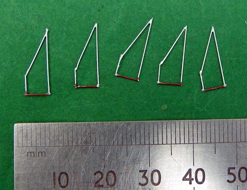

                @bobwilson59101
                I have not done much today – didn't feel like it! But I did produce some ladders side that took half an hour. They are made from 33 swg tinned copper wire, soldered. Each side consists of four separate pieces of wire. They look pretty rough, but this is a big enlargement, in real life, they look just great! –

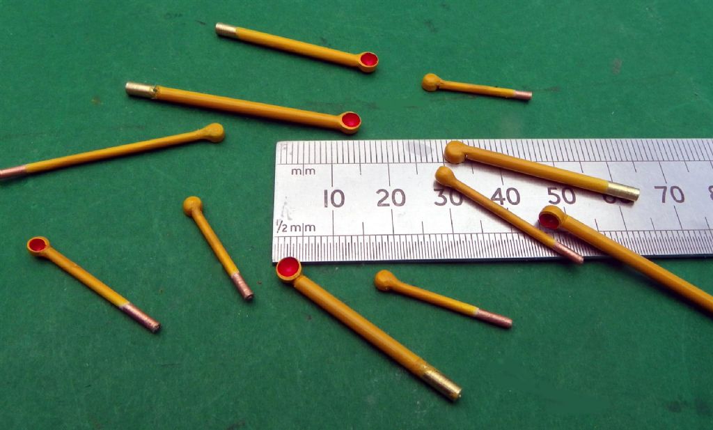

                  ventilator construction 2 (large).jpgFriday, 3rd June, 2022
                  Baron Vernon
                  Today, I felt like doing something as boring as it was simple, so sat down to make a few ventilators and some more ladder side rails. The ventilator shafts of the smaller vents were copper wire that I had converted into straight copper rod. The larger shafts were brass. All the cowls were made from brass rod, hollowed out on the lathe and soldered to the top of the shafts. They were spray painted.
                  I made this lot whilst listening to a "talking book!"

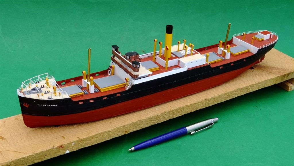

                              Sunday, 5th June, 2022
                              Baron Vernon
                              I did a fair amount today, Fitted some rails round the poop. Fitted three more winches. Made and fitted the wheelhouse. Made and fitted three coal hatches. Fitted four cowl ventilators, and engine-room skylight, two smaller skylights and water tank to top of engine casing aft of the funnel.

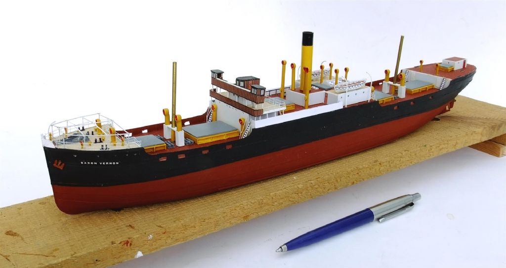

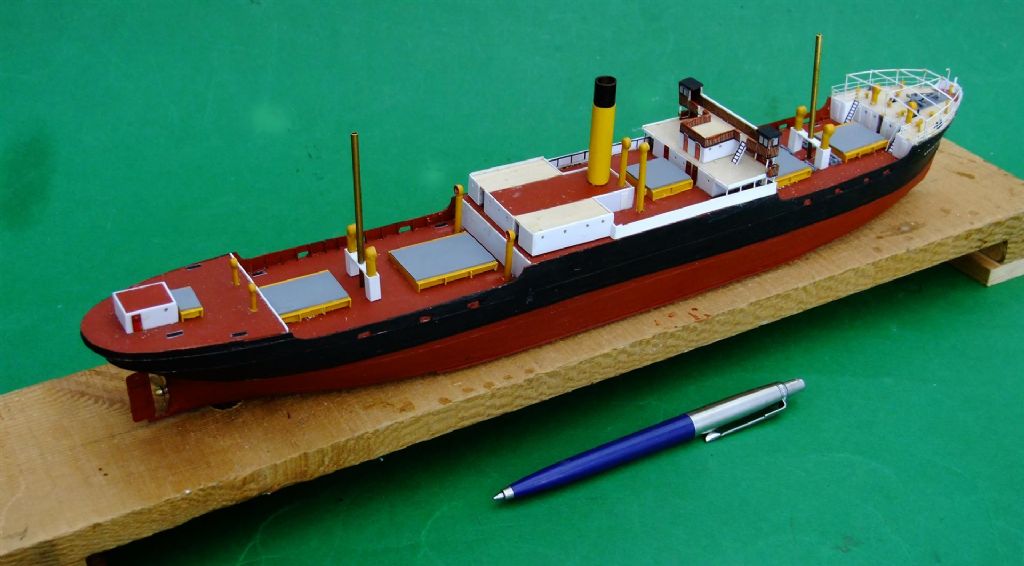

                                    Wednesday,8th June, 2022
                                    Baron Vernon.
                                    Today, I made and fitted the two lifeboats. Work remaining: poop rails, mooring bits, navigation lights, ladder sides, two winches, awning spars on bridge, ensign staff, ice box on captain's deck, lockers, Gig and davits, masts and rigging. And, of course, the completion of the base and display case.
                                    I will be really glad when this is complete, and I can disappear into obscurity!
                                    Had another request for info the other day, and stopped everything to give a comprehensive reply, followed by the usual stony silence.
                                    I was heartened earlier today, by receiving a short thank you e-mail from a USA group member, for information supplied – and that is all I need – It is good to know that my message got through and was appreciated.
                                    I now find that I cannot upload the latest images of the Baron Vernon with the boats fitted to this forum, getting Error 500 (Internal server error)!
                                    Edited By Bob Wilson on 08/06/2022 18:58:33

                                          @bobwilson59101
                                          It is fixed now –
                                          #100729
                                            Really coming alive now Bob, the lifeboats in particular look very effective in that photo.

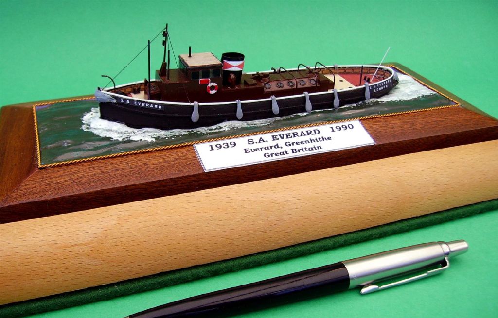

                                                Hi Bob,
                                                Don't worry you have a legacy in print already, this being one of my favourites
                                                #100733
                                                  @bobwilson59101
                                                  Hi Ray,
                                                  Tiny Thames River tug – I remember building it – SA Everard
