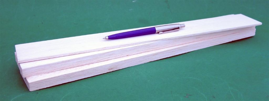

      Day 1
      #7218
        @bobwilson59101
        #99995
          I take it that is balsa Bob?
          #99996
            @bobwilson59101
            Yes it is – makes life a lot easier –
            #99997
              And selected thicknesses to give you the height of the hull in the scale you are working to? Would that be keel to main deck?
              #99998
                @bobwilson59101
                That is correct. The top thin plank will only be glued in the centre, the ends being raised with wood filling pieces to form the sheer. The three raised islands, forecastle, 'midships and poop decks will go on top.

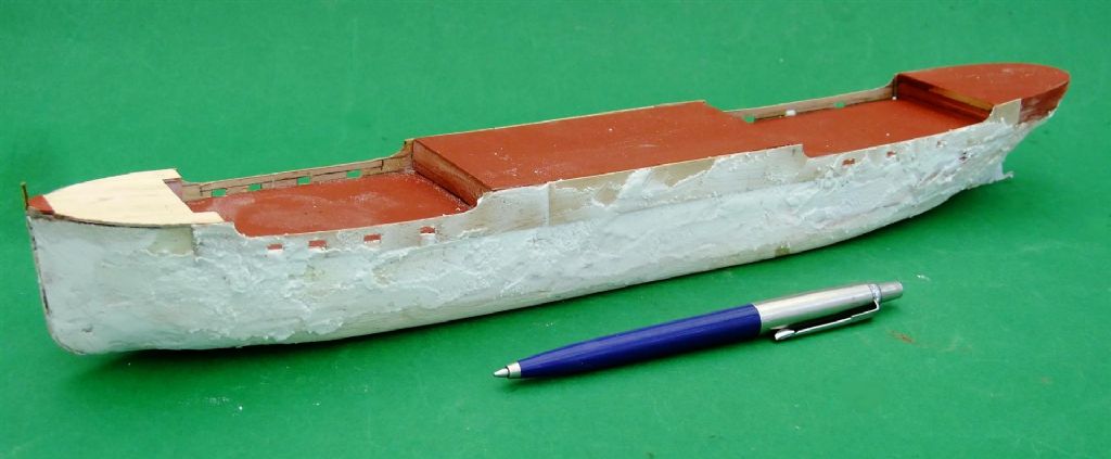

                  Monday, 18th April, 2022
                  Although I haven't felt much like doing anything on the tramp steamer for the past two days, I made an effort this afternoon, making the forward bulwarks, and fitting the ones on the port side. This is the most boring stage of model construction – getting the hull right. The fine detail is much more interesting. The total time spent on it has now reached 12.2 hours. This build is proving very popular, and has an excellent following world-wide –

                    I've obviously missed a lot between the first picture and the last one. When you started the thread I was looking forward to the build being posted on here so I was waiting for the next step.

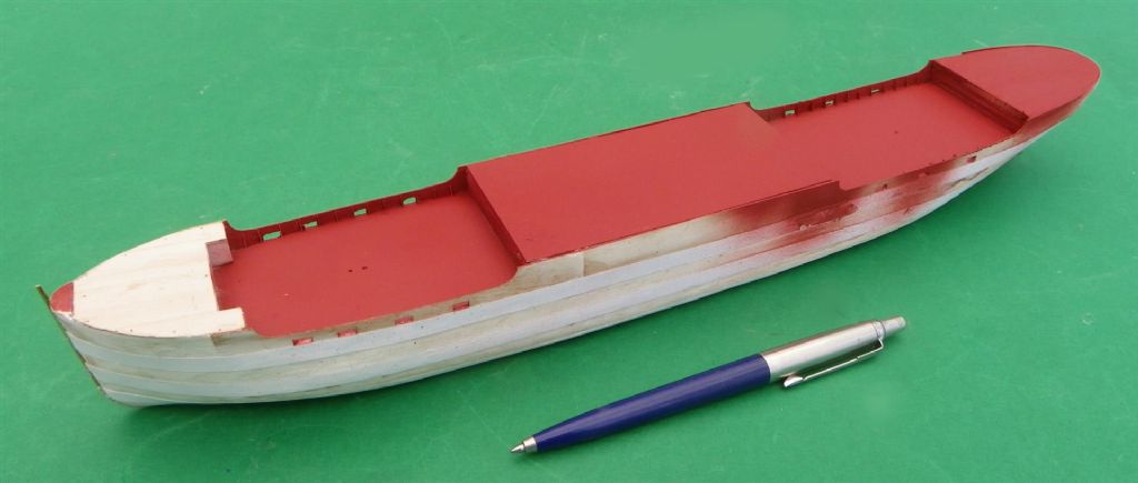

                                Thanks. I am not depressed, but as I said, if anything I post here is just met by a long row of silence, I loose interest. Probably the success of the Facebook group is due to the fact that it appears to be one of the two groups in the whole world that deals specifically with merchant ships – The other one being Civilian Ships run from Turkey.
                                I have written lots of articles for Model Boats, even going back to when Vic Smeed was editor. The last one was about the barquentine Bellmore. In fact MB was the first magazine that ever showed interest in my articles, and I am really here for "old time's sake!" But the trend these days is more toward "boats" than "ships." The last Editor, Martin Chorlton asked me to write an article about building the motor tramp Hylton before the pandemic, but I couldn't oblige because I was about to have major eye surgery that took some recovering from. By the time it all came back again, he was no longer editor!

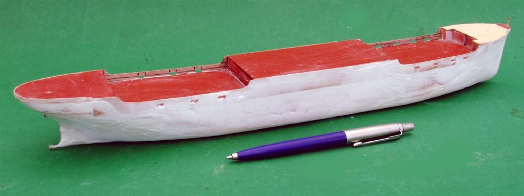

                                  Still a bit of a mess, but coming along slowly –

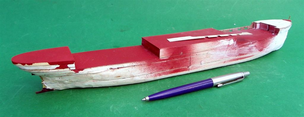

                                    Thursday, 28th April, 2022

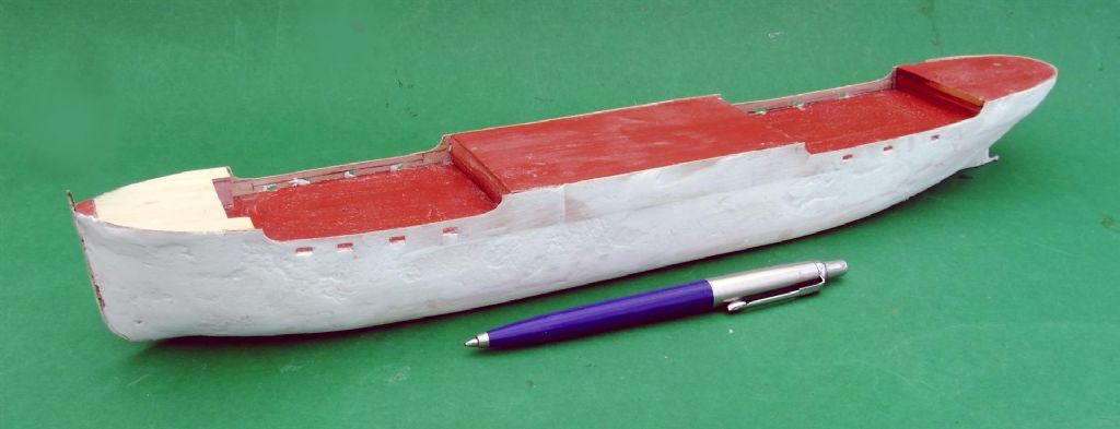

                                    More work complete on the tramp steamer. I have assembled the display case and inner mounting base. The port side of the hull has been filled and smoothed down almost to its final shape, whilst the starboard side remains lumpy. Having run out of 80 grade Wet & Dry paper, I must await its arrival from Ebay. Ordered early this afternoon, and already posted already, so should not take too long.
                                    Not much craftsmanship used so far, but lots of chopping, hacking and filling with wood filler. That is how I prefer to work. I will be very glad when the hull is complete, and I can begin the "fitting out!"

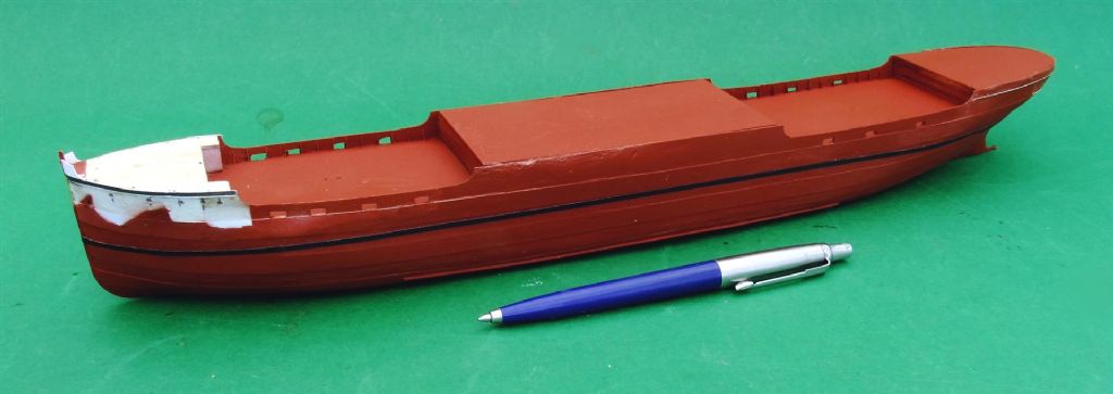

                                                    I have now smoothed and painted the hull with red oxide. The black strip along the waterline is painted paper masking tape stuck on. Tomorrow, I will paint the hull black above the black stripe, and the whole thing should soon start looking a lot better.
                                                    The hull still needs the anchors, propeller and rudder fitting. I have made the rudder already, but not the propeller, names or anchors.

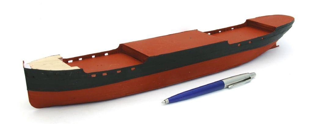

                                                      I have now completed the painting of the hull using the new black acrylic paint form Lithuania – it is superb! The early morning light conditions are not the best, but you can see a great improvement in the general looks of the model.
