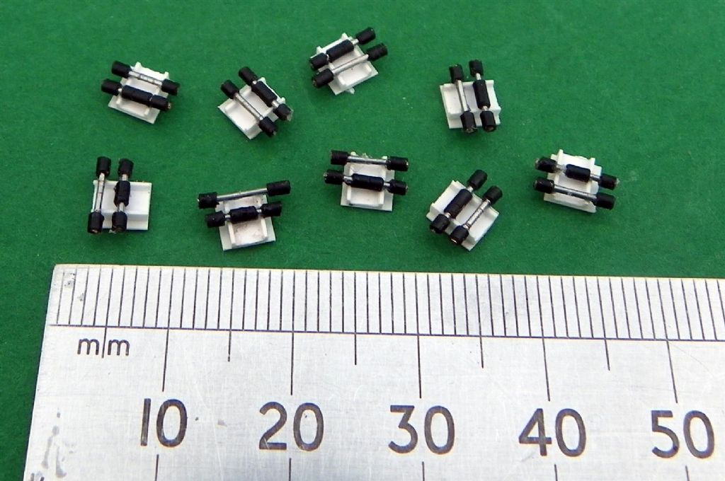

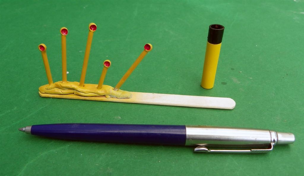

      Today, I made 9 cargo winches. Each winch is 0.16 inches square. They look a bit rough in the photograph, but that is because they are so small. In real life, the look pretty neat, and after they have been spray painted, should look a lot better.
      They were made from very thin styrene sheet, a bit of styrene channel, bell wire, and its plastic insulation for the drums. No soldering was involved, and they were all stuck together with superglue. Not difficult, but rather tedious.
      I now have two slightly larger warping winches to make, and the anchor windlass.
      I used fine tweezers to assemble them (a common statement is “My fingers are too clumsy for fine work!” – So are mine – hence the tweezers).

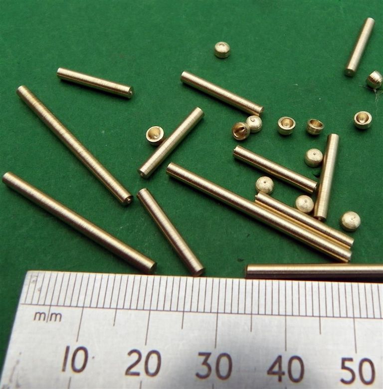

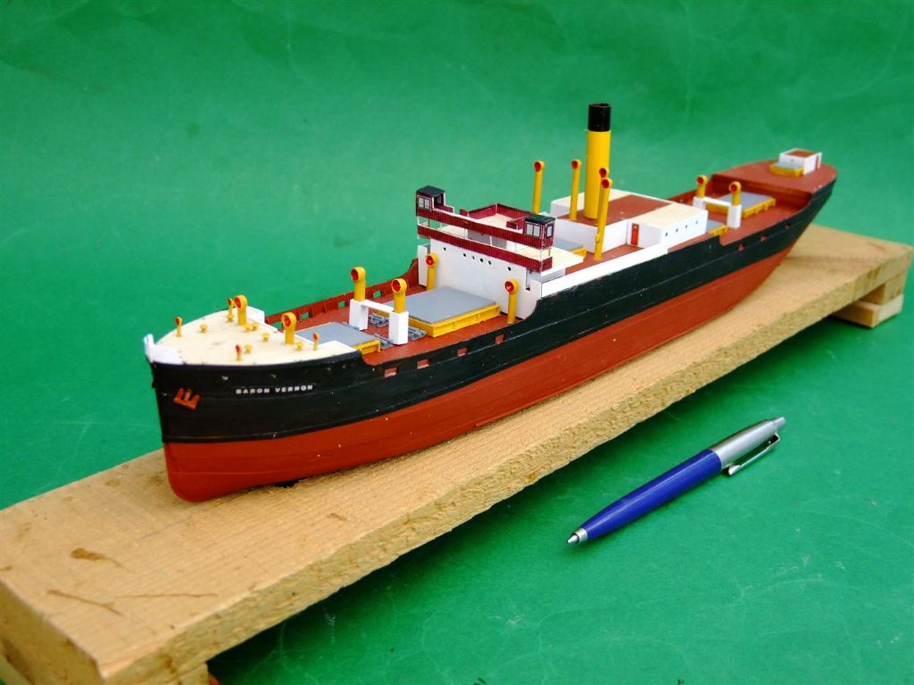

                    Some of the larger cowl ventilators. Brass rod, and the hollow cowls turned on the lathe and soldered to the top of the shafts.

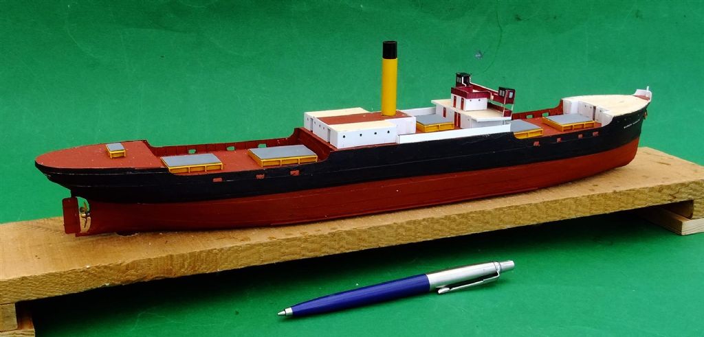

                      On studying the original plan, I could see that I had made the six hatches too high, the tops actually came lower than the bulwarks, so I discarded the originals and made another six. I also decided to have the coamings painted mast colour rather than red oxide. I have no idea what colour they were in the original ship, but mast colour livens things up on an otherwise drab ship. I did not add the time it took to make the replacement hatches to the total building time. I also fitted the funnel mounting. This is just a wooden peg glued in the top of the engine casing, that the funnel will be glued over eventually. Nothing is fixed down yet.
                      I have also been making lots of small cowl ventilators.

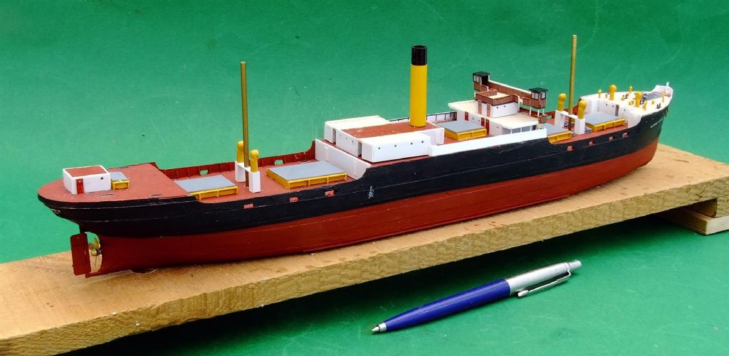

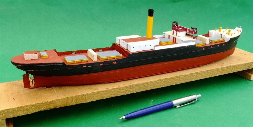

                        The poop deckhouse and the two mast-houses have been roughly shaped, and all the ventilators fitted to the forecastle heard.
                        I have also made a new rail-winding jig.
                        I will be glad when this one is finished, and I can withdraw from the public gaze as far as build logs are concerned. I intend to do more writing after this.

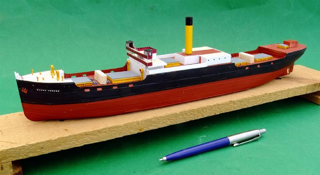

                            Today, I added the poop deck house, and Nr 6 hatch, also on the poop.

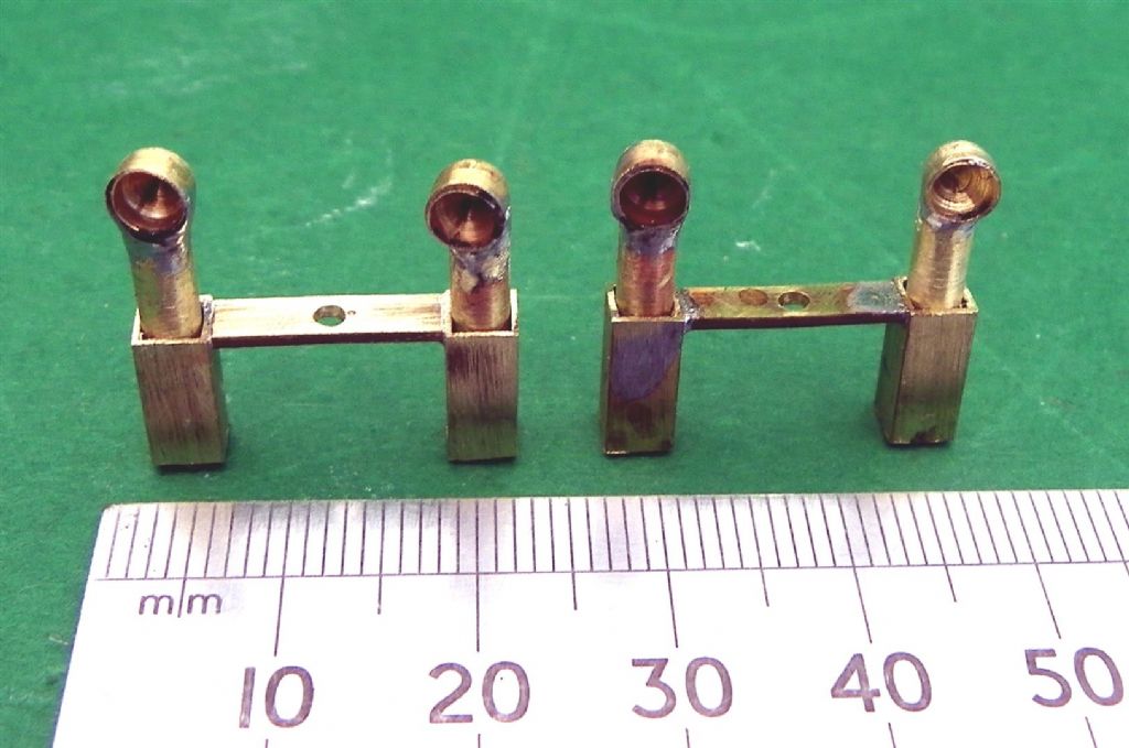

                            When it came to the two mast houses, things were not as straight-forward. A very close inspection of the original plan (very faded) and a photograph of the actual ship, showed that each one actually consisted of two square structures with a large ventilator in the top of each, and a platform between them, through which the masts passed. From above on the plan view, they at first appeared to be normal oblong deckhouses.
                            Making these out of wood was totally beyond my capabilities, so I got out the brass. The square parts are standard square section with the platforms soldered across the tops. the ventilator shafts were round brass rod with hollowed out brass cowls, soldered on top. These are a push fit in the square sections at the moment, but will eventually be glued in.
                            Not much point in me saying it is easy, although I had no trouble with it – matter of practice, I suppose. These models do not build themselves, and do require a certain amount of practice and work. But to me, that is the whole point of the exercise, to make every part myself. (An outdated idea).

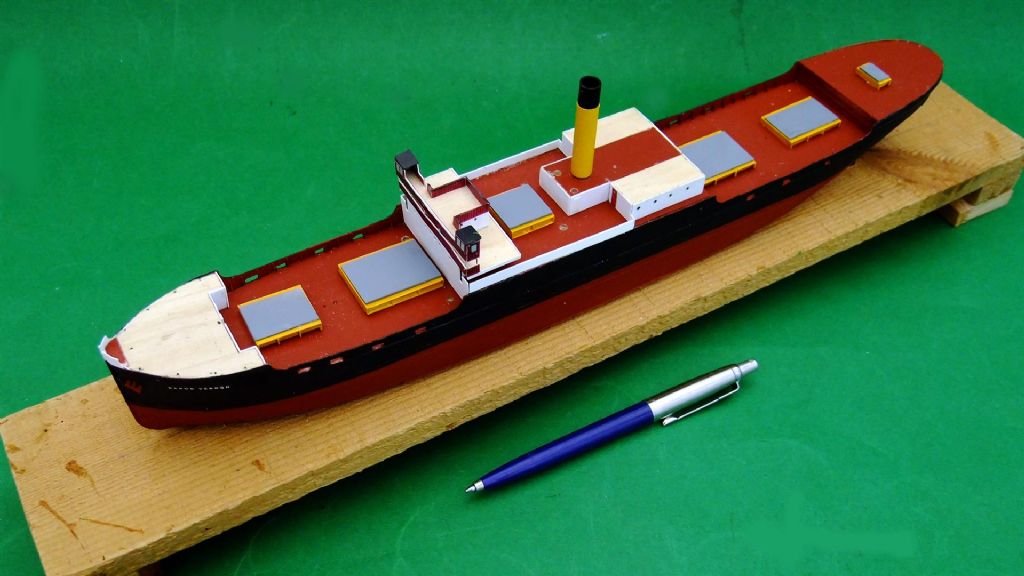

                              A few more items have been completed such as the ventilator assemblies at the base of the masts, four tall cowl ventilators forward of the funnel, and the poop deck-house.
                              There is still a long way to go, guardrails, make & fit more winches, midship bulwark panels, ladders, guard rails, masts, derricks, rigging, lifeboats, gig, various water tanks, engine-room skylights, wheelhouse, awning spars etc. The more that goes on, the better it will look.

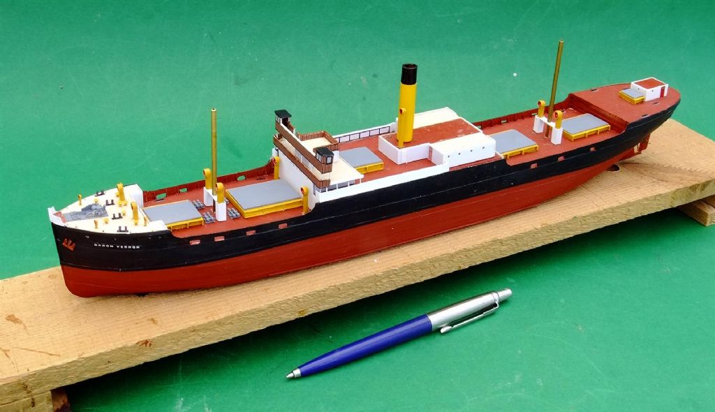

                                Work went backwards today. On considering the bridge structure, I decided that it it was not good enough, so I set out to make a new one, this time out of thin aluminium. It is now almost complete, and a lot better than the original.
                                When this sort of thing has happened in the past, I have usually been dismayed to hear people say they cannot see any difference. I guess a lot of folk are just not very observant.
                                A mediocre model I built 40 years ago, and sold for £16, turned up on Ebay for 99p with no reserve. It sold for over £400 to someone in the US. I contacted them with a photograph of a model of a similar ship just completed, but was amazed to hear that they could see no difference in quality. It made me feel that I had been wasting my time, striving to improve for all those years, only to find that most folk could not see any difference!
                                I am now ready to move forward again tomorrow, with the completion of the new bridge.

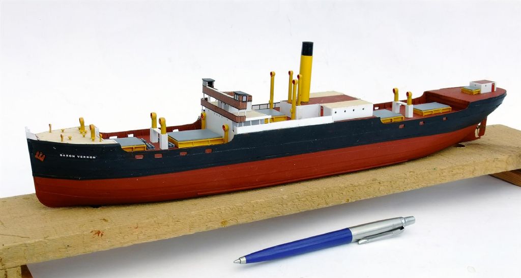

                                  @bobwilson59101
                                  Thursday, 26th May, 2022
                                  Baron Vernon

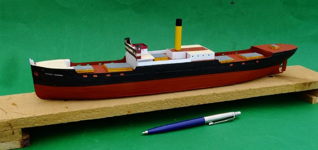

                                  The new bridge has now been fitted. In the photographs, it does not look a great deal different to the original, but in real life, it is considerably better.
                                  I can now move ahead with more fine detail.
