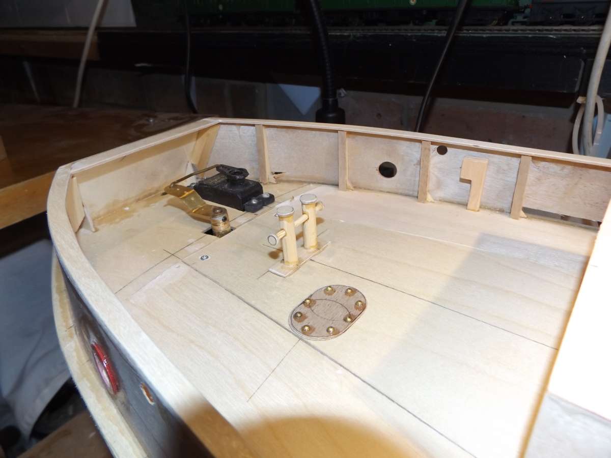

                  The worst part of the build are the bulwarks and capping rail as that’s the part everyone will see quite a laborious process supergluing the uprights to the deck and templating the 1/64″ ply before cutting seems to be going ok so far but a slow process !! racing DF65 yesterday, at my daughters for a BBQ today , It’s all go 🙂
                  Regards RayDSCF2906DSCF2910DSCF2909
                  #125978
                    You nailed that Ray, not a gap in sight!

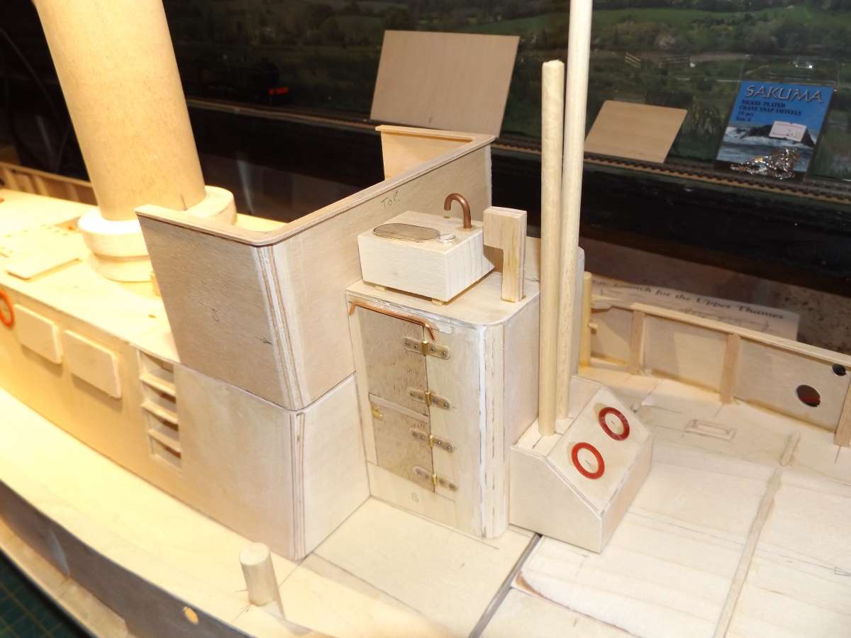

                      Thr TID tug is progressing now at a pace with the superstructure from mainly 1/16″ ply 🙂
                      Regards RayDSCF2914DSCF2915

                        Taking shape nicely.  Just a suggestion, I would get the paint on the hull and fit the plant with all the electrics.  Then take the model out and test it on the water.  This will give you the opportunity to see how everything works, whether you have all the access you need for maintenance and operation, filling, emptying etc..  Also whether performance and manoeuvrability is what you expect or whether anything needs modifying.  Then, if anything requires adjusting or modifying, you can do it before the deck and superstructure get too advanced.

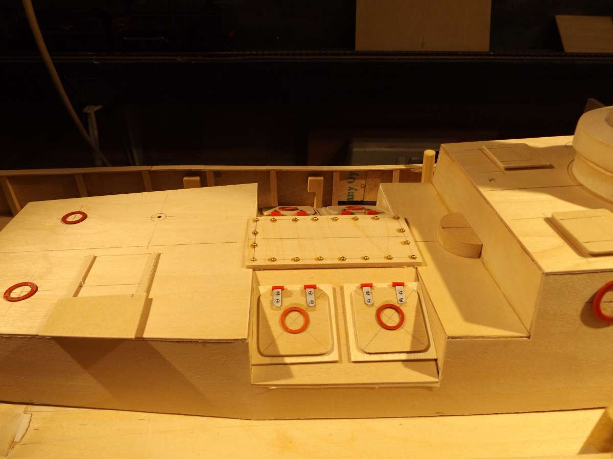

                              After a lovely weekend near Southwold in Suffolk , I’m back on the tug with renewed vigour 🙂
                              I was going to keep her simple, but as I won’t be building another tug for a while I have decided to do a proper job ! well as good as I can without buying anything !!
                              Bloomin gooseneck vents everwhere 🙂
                              Regards RayDSCF2924DSCF2922

                                #126133
                                  Lovely traditional build Ray.

                                    Please excuse the pun ! but I’m steaming ahead with this build I’d like to get back to building one of my own designs soon 🙂
                                    Chantry MBC open days this coming weekend, come along and join the fun !! All welcome at Bluewater
                                    Regards RayDSCF2930DSCF2933DSCF2931DSCF2934
                                    #126147
                                      I take it they are fibre washers?  Clever!
