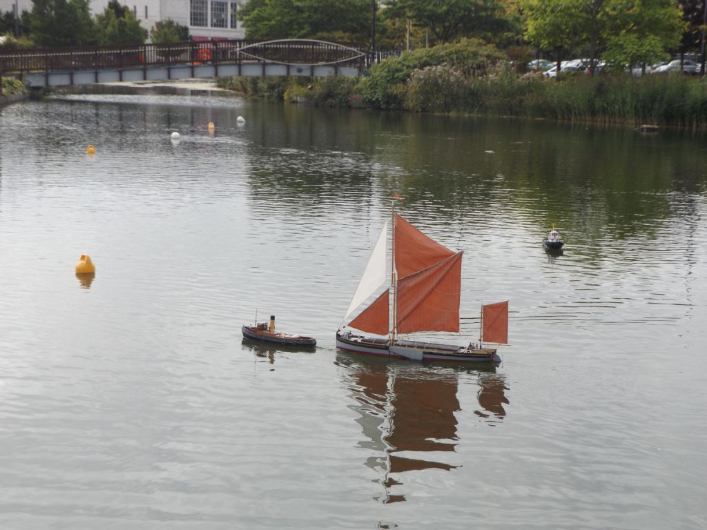

                      Hello Ray
                      Nice pretty picture of your barge being towed
                      But………Would a barge be towed under full sail?
                      Just nit pickin'
                      #79367
                      nick viner
                        @nickviner52422
                        It would if it was clearing harbour.
                        #79369
                          Hi Bob,
                          I'm sure the mainsail brail ropes would have the sail pulled into the mast in real life there was no wind that morning, I think the crew were still asleep !

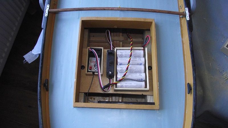

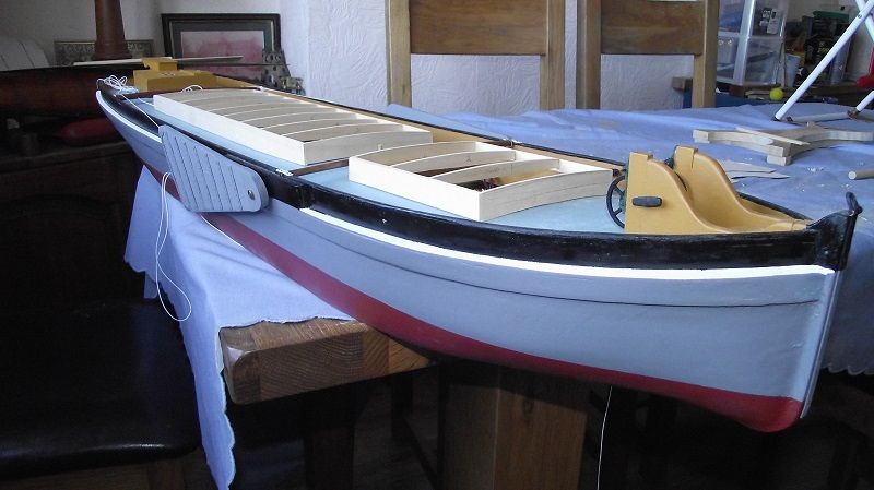

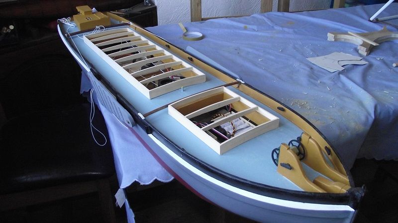

                            Hi. All, a bit more progress on my TSB Veronica,
                            The hull is almost finished,as you can see it is painted and some fittings added.
                            The hatch tops need to be fitted and then covered with cloth and the battens and hooks with the wedges.

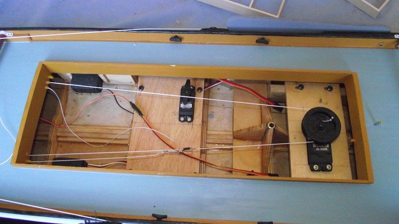

                            The main hatch holds all the servos. The servos are all on boards that are screwed to supports so that they can be removed if/ when anything goes wrong.
                            The rudder servo is under the back cabin. All the cords and sheets are in, all as suggested after my last post, I just need to fit an arm to the servo that controls the vangs.
                            Eddie.
                            #79486
                              Hi Eddie,
                              Your building at quite a pace!! well done all looks good I've started started drafting a Giralda at 1/24th scale for traditional plywood build and toying with the idea of a super lightweight version Epoxy/glass sandwich, It used to work for racing dinghies why not a barge??
                              All the best Ray

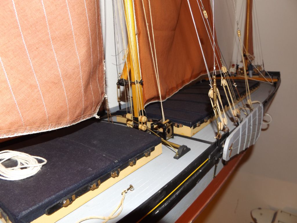

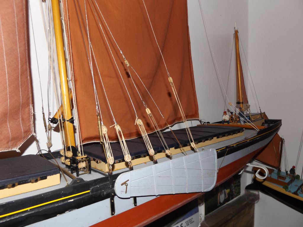

                                                #79601
                                                Eddie Lancaster
                                                  @eddielancaster
                                                  Thanks once again Ray, your rigging is all in front of the leaboard roller, I will do the same, on the drawing the topmast running backstay is located behind the leaboard roller about 130mm further back.
                                                  The masts are quite firm even without the backstays so they only need to take the pressure of the sails and to hold the forestays firm.
                                                  I have tried the mainsail in the wind today and all seems to be fine,with good control from the winch, I think I can also control the vangs from the same winch as suggested some time ago, so reducing the number of channels and servos needed.
                                                  As soon as I have tied up the last few ends, ( pun intended) I will post the results of my efforts.
                                                  Regards Eddie.

                                                      On a full size barge, the backstay aft of the leeboard roller is the Topmast Running Backstay, and supports the top of the top mast preventing the mast from bending too far forwards due to the pressure ( on a stays'l ) barge from the Stays'l. The real life crew have to let them off and do them up again whenever the barge tacks, and certainly of the they want to put the mains'l in the running position, otherwise the weight of the sail or sprit on the backstay will snap the topmast backwards….this is the reason they are not modelled on a functional sailing model.
                                                      As I think I've mentioned before my vangs are on the one servo, and I've just tested my leeboards – out of the water only, which are on another servo positioned with a wooden servo right across the bows in the void space I have there, I have a 3 position switch on my Tx which if you think about it is perfect, (Port one up and Stbd one down), (both in a mid semi dropped position), (Port one down and Stbd up )
