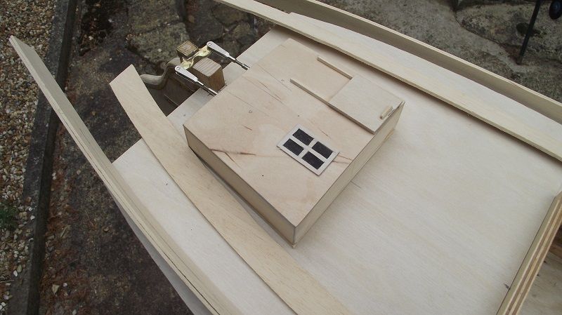

                                        Eddie Lancaster
                                          @eddielancaster
                                          Hi. Ray/Tom,

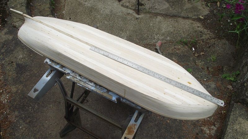

                                          The hull planked with 3/32" balsa, I have put my 24" rule on so that the size can be gauged.

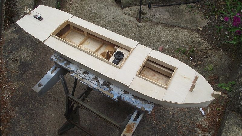

                                          The topside with the 1/32" ply deck pieces cut and laid in place, the deck will be planked with balsa the same as the hull, only with 1/4" wide planks.

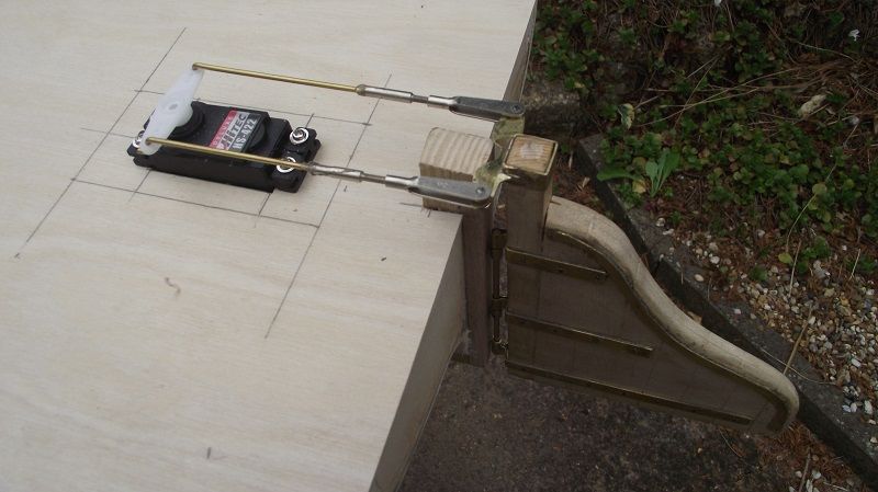

                                          The rudder and its servo and linkage.

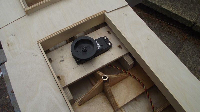

                                          The main sail winch and tube for the keel.
                                          The aft cabin and the covering boards and rails formed and ready for fitting.

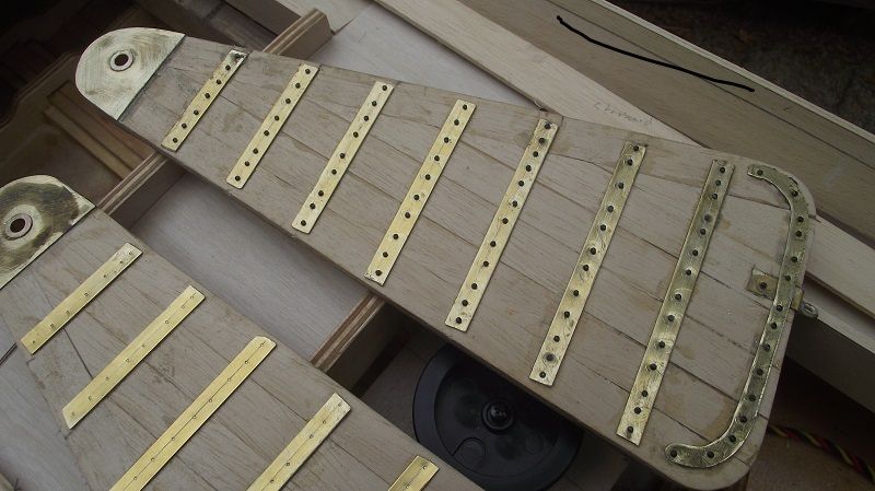

                                          The lee boards, one riveted with peco track pins, around .012" dia.!
                                          #78816
                                            Hi Eddie,
                                            Looking forward to seeing you tomorrow I'm taking Veronica for a sail, did you make the rudder blade hollow for the extension you will need? Bring a camera, I'm with Chantry MBC

                                                tomarack
                                                  @tomarack
                                                  .Hi Eddie,
                                                  very nice model construction !!
                                                  As I see it, I had to build my Gusty Cat model like you. Expanded polystyrene as a base for .fiberglass hull plating was not a good idea.. as I had to use a lot of putty..The result was not proportional to the work done, as I can see now.
                                                  I am not completely satisfied with my work, but after using more of the putty and then spraying the model in black, the model looks pretty good…mainly for non-professionals.. But end good – all good…
