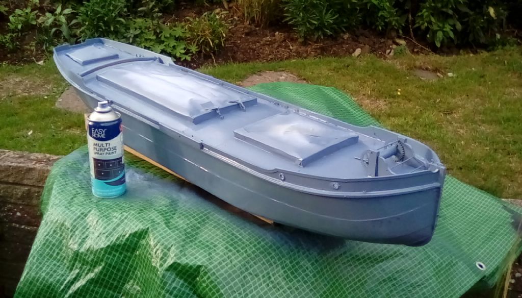

            Having completed Eventide to painting stage, Will get back into finishing Portlight, found cheap grey primer in Aldi £2.99 I have given her the first coats of paint, looking better already 😀👍⛵,

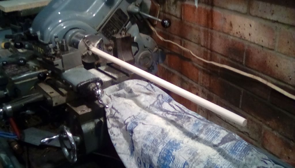

              Tonight we are making the main mast from a nice straight piece of 1/2" X 1 /2" pine in the lathe with the ever handy self centering 4 jaw chuck, I took the corners off with a block plane and then turned round with Hermes P120 paper, came out well and round with the square foot 😀👍👍👍
              I did have to take the tailstock off to get the length on the Super 7

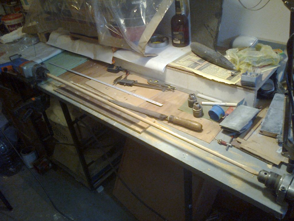

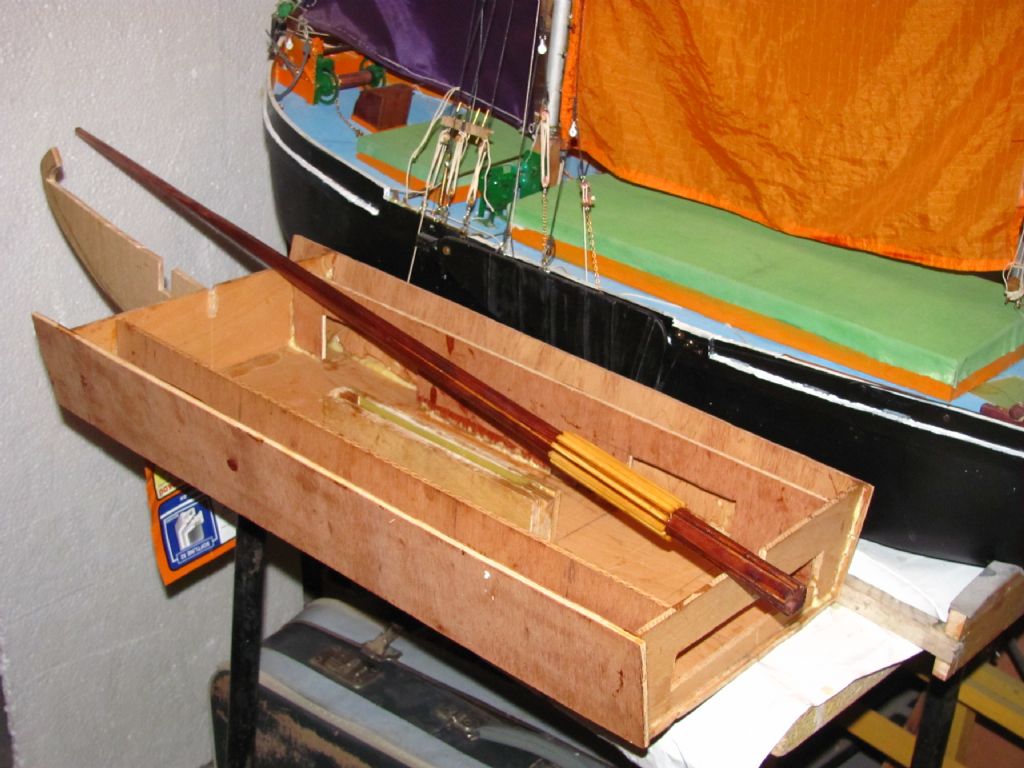

                Hi all,
                this is my version making yard for Caprice gundalow -90 cm long((cca 35" , 1,8 cm dia. In the middle of the yard is a spruce beam 10×10 mm, on the sides are glued beams 5×5 mm. One end is fixed in the jaw of the electric drill, the other end in the auxiliary jaw of the old drill. I had to grind both ends of the yard so that I could clamp them in the jaws of the ( electric) drills.
                For machining, I first used a coarse rasp, then continued with coarse sandpaper nr 60,glued to a plywood strip. I finished gradually with finer sandpaper. The narrower end should have a smaller diameter (6 mm). When grinding, however, the boom vibrated a lot, so I preferred to finish grinding at a diameter of 8 mm
                As the boom is flexible, I had to support it in the middle when sanding (I used an old leather glove). I then soaked the whole and soaked it in diluted epoxy..
                greetings
                Tom
                Caprice gundalow
                Edited By tomarack on 29/09/2020 22:58:08

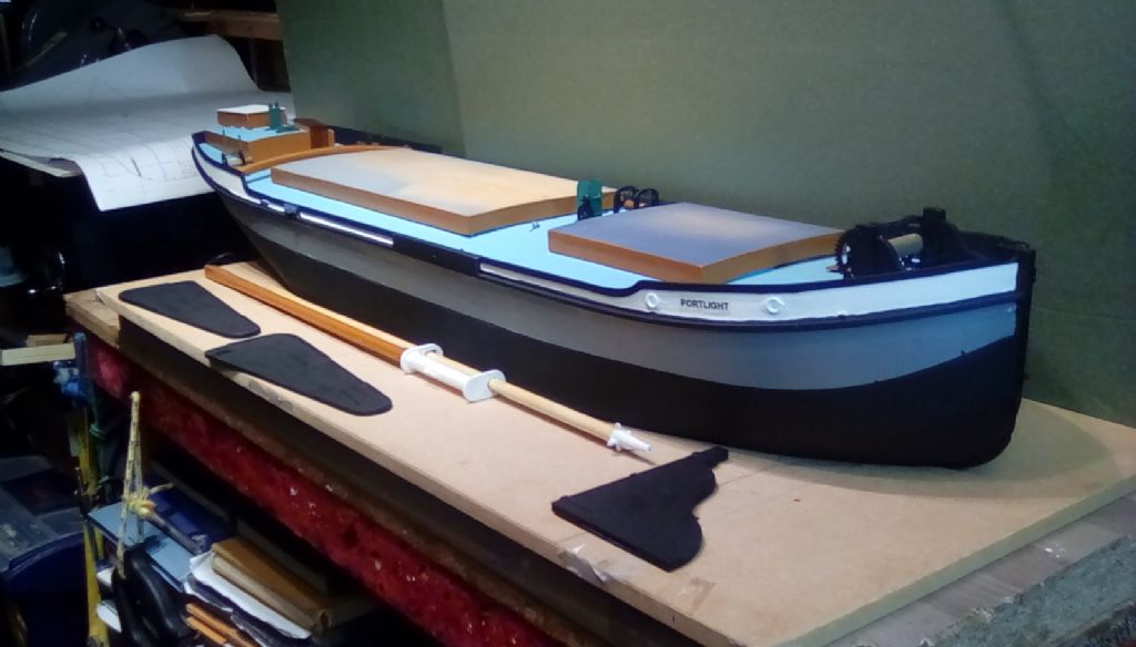

                      Portlight is in the paint shop now and a start has been made with the mast & top mast being prepared.

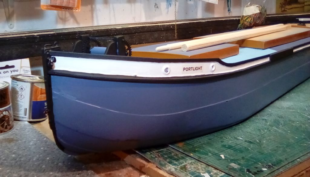

                              Back onto Portlight now getting close to rigging, must buy some deadeyes from my local boat shop at Chatham dockyard tomorrow , only 5 months to launch 👍😎😀
                              #92022
                                Looking very nice, Ray
                                I like the matching colour scheme……..Is it authentic?
                                #92026
                                  Hello Bob,
                                  Good to see your back 👍
                                  This the only photo I have of her sailing, but she is laid up at Maldon in a mud berth and in grey primer last time I saw her a month ago minus her rig, as she is steel construction I guess she is safe for the future.

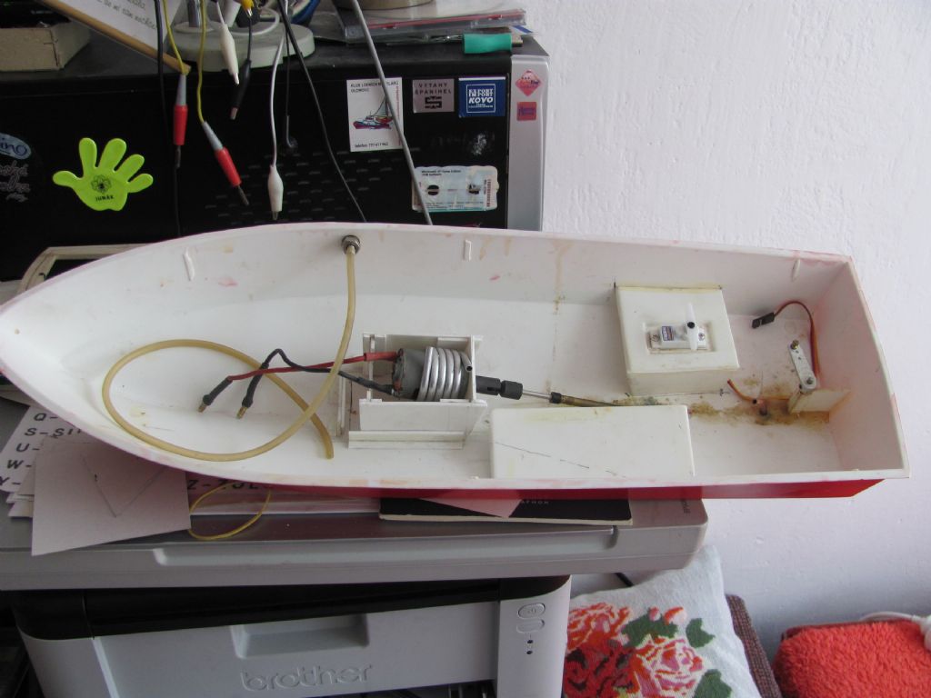

                                        img_3097.jpgHi Ray
                                        We also have a very real winter with snow, and we expect frosts around – 20 ° C .
                                        We haven't been used to such a winter in recent years.
                                        Here are currently a number of new posts on FB. Many modelers are no longer looking for topics on traditional forums, and go straight to Facebook.
                                        I'm currently trying to finish the wreck of a small electric motor boat I got from an acquaintance.
                                        I'm thinking of a suitable superstructure to make. I had to buy a new ESC and servos.

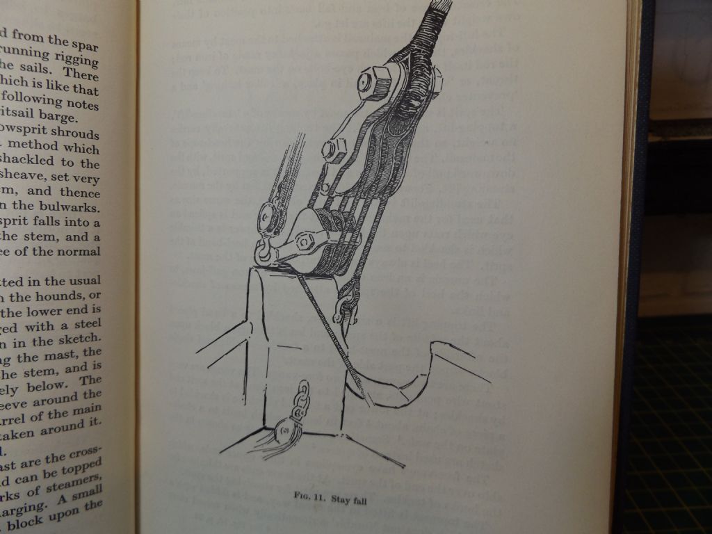

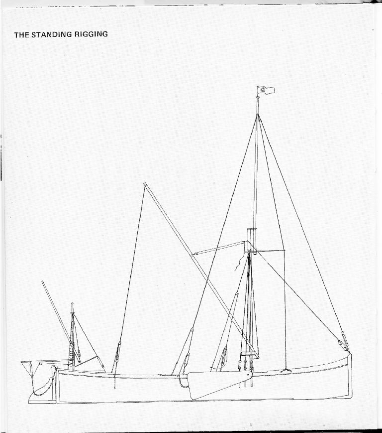

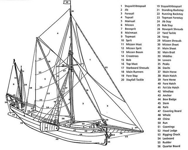

                                                  Hi John,
                                                  Thanks for you PM message, I think this drawings from a book I have which was written in 1933 shows the pulley's on the stem for raising and lowering the rig, and is called the Stay Fall.
                                                  The vang is the line which controls the amount the sprit can move out, very handy when running with the wind and can be controlled by it's own winch/servo to let the sprit right out for best performance
