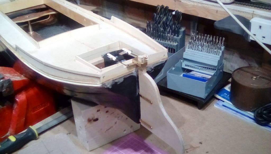

        Hi Dave,
        I learned a long time ago your only as good as your equipment & tools 😀
        Here is Portlights rudder a ply sandwich with 1/8" core and 1 /16" each side with a recess for the clear acrylic sheet extension for sailing, cheating really but they won't turn enough with just the scale rudder. The straps on the rudder & stock have 1 /16" diameter tubes soft soldered on, with a brass rod down through the gudgeons, this is in my view the most important part of the barge, I have seen other skippers loosing the rudder while racing 😲

          Are those holes in your Lathe casing?
          Or should I go to Specsavers?
          #89813
            Only the bracket that holds the motor on the back, all present & correct 😀

              Hi. Ray, very nice neat work, she is comeing along well now, when I had my fisrt lathe, over forty years ago, I couldn't afford two chucks so I bought only a four jaw independant chuck, using that for several years taught me to centre work very quickly by eye, and then to use a DTI if i wanted real accuracy, my current Harrison makes life a real doddle with taper turning, screw cutting gear box etc.
              I have just been to specsavers Bob and I hadn't noticed the holes!

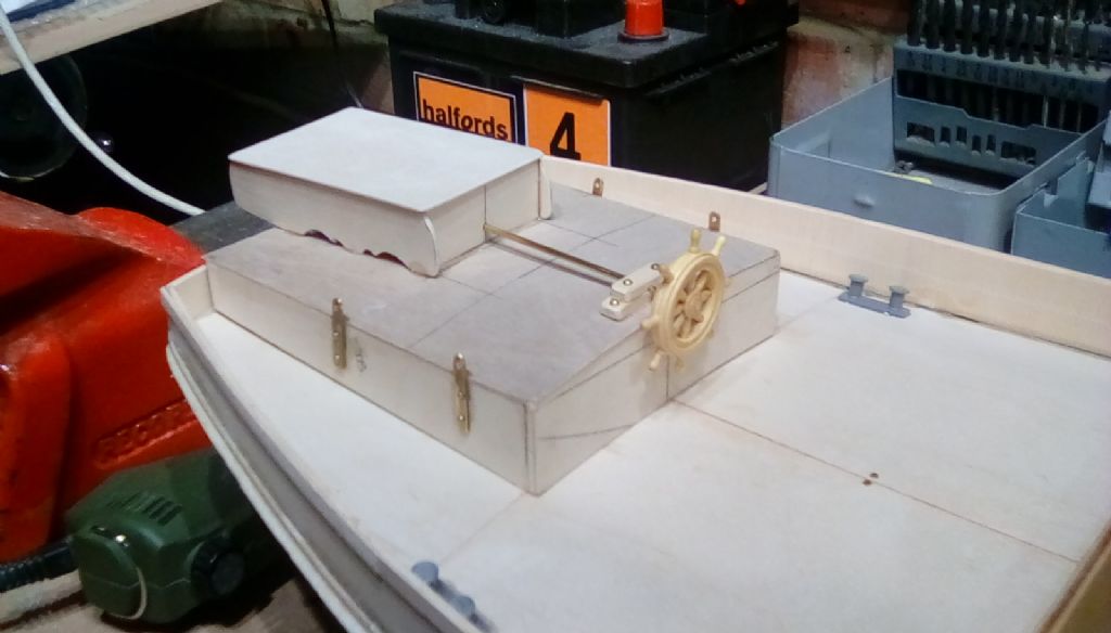

              #89851

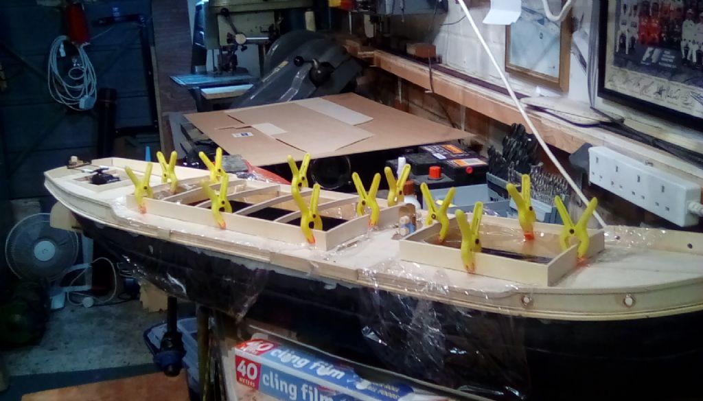

                img_20200708_184424.jpgHi All,
                Portlight has progressed well during my enforced holiday, but back to London for work on Monday 😀
                The rudder and steering servo in it's place, hatch covers built in situ using Clingfilm to help the release from the hold coamings

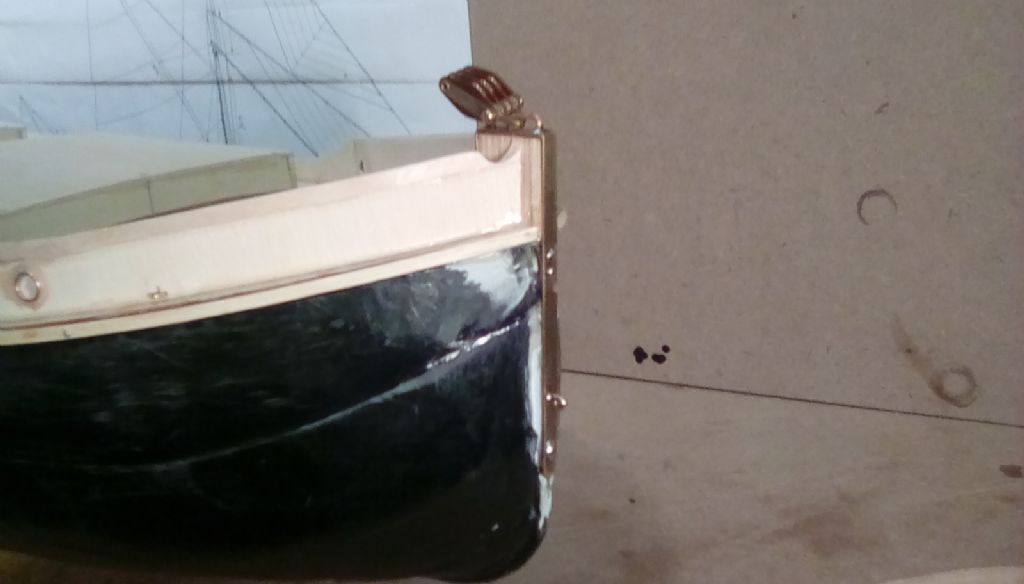

                  Going back to work after 3 months has brought back the enthusiasm for being in the workshop in the evening and on with the stem brass and various attachment points for the forestay soft soldered on, the triple sheaved block I bought in 1972 , just knew I'd use them some day 😀 they cost £2.33 each back then, a lot of money when I only earned £10 a week as a traineeimg_20200716_214048.jpg !!
                  #90063
                    That’s a stupendous cost Ray! As you didn’t use it then it was either a compulsive extravagant purchase, or an astute one for years ahead….
                    Nice to see that you have invented a use for it after all these years. 😎
                    Are you going to leave the nice strip brassy or splash paint over it? Could be a nice feature at the bow.
                    #90065
                      Very nice Ray
                      But, I`m slightly disturbed by the plain glossy hull?
                      OK on a yacht of course, but a Barge?
                      Ooooooooo ………Sharp intake of breath
                      No offence, Ship Mate
                      #90070
                        Hello Bob,
                        Have no fear it's only the GRP hull, she won't be shiney plenty of bits and winches to fabricate yet before she goes to the paint shop (The Shed) Then the trickey part masts & spars

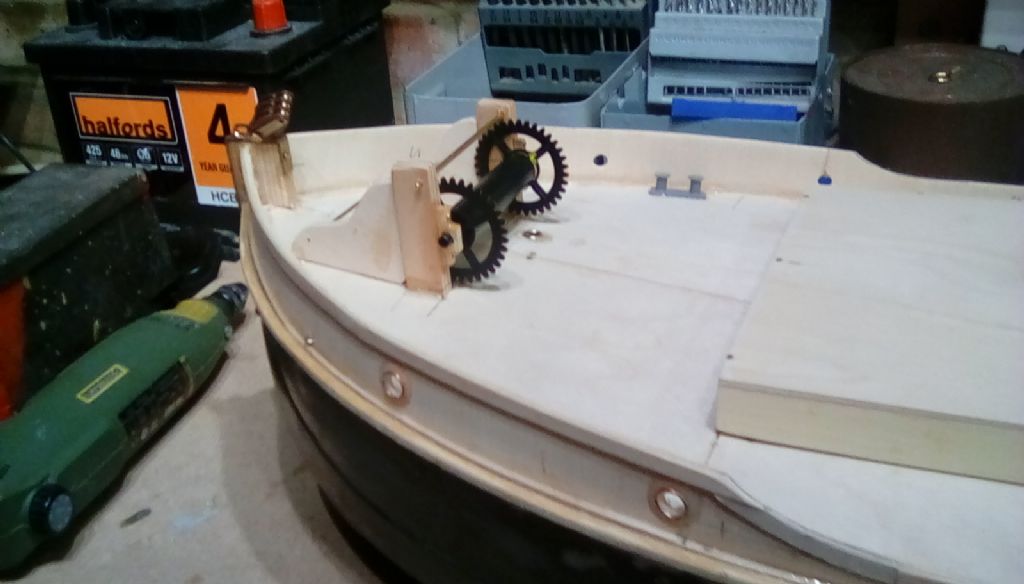

                          img_20200719_205639.jpgHi All,
                          Veronica & Gertrude out for a gentle sail this morning at Bluewater, why is it that there was always a good breeze yesterday 😀 but it did rain 💧

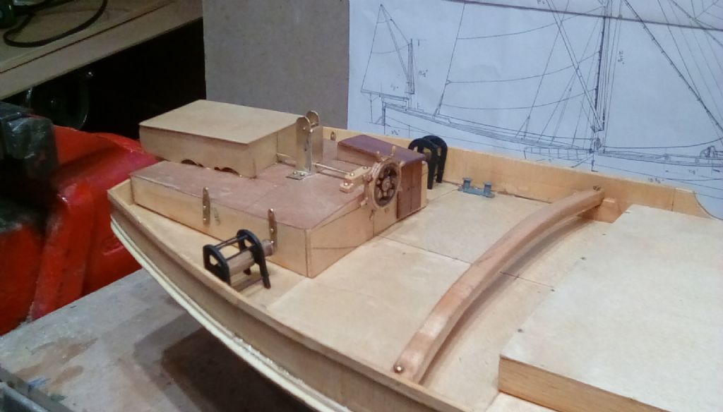

                          Portlight's anchor windlass cobbled together from various odd bits and went to see Rob at Chatham dockyard model shop for materials and a ships wheel 👍
                          #90183

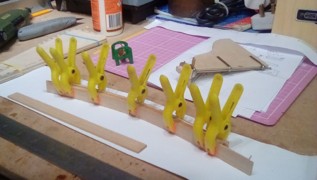

                            We are trying to organise a barge match at Chantry club (Bluewater) Dave Watts AKA Mastman is on the case 😀👍
                            Meanwhile I am laminating the main horse for Portlight which curves both ways to follow the deck camber and the radius of the main sail, I'm enjoying this build 👍😄 also the brail winch.

                                    Its a conundrum about the curves on the horse. In reality it is one curve that is shared between the radius and the camber.
                                    I did the same thing some while ago and at first wondered how I was going to make two curves in the same piece of brass tube then it clicked. In the end I found that a radius only ned to be a fraction shorter to account for the camber.

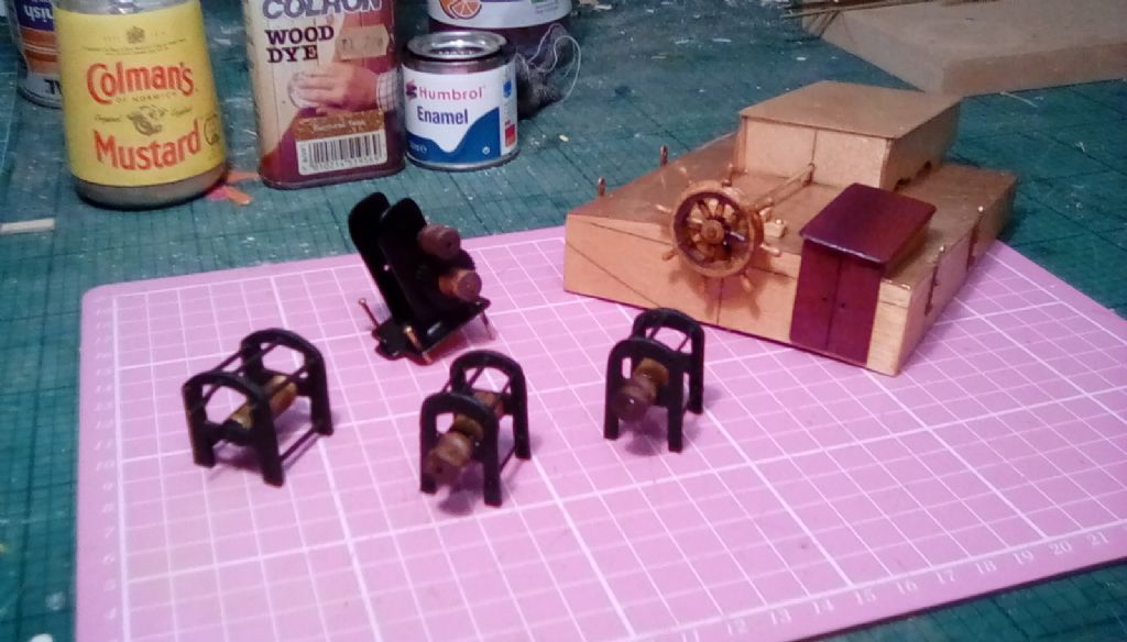

                                        The Lee board winches are plasticard frames, dowel & brass for superglue together will look the part 😀 some brightwork mahogany img_20200725_202433.jpgfor the companionway hatch and doors.

                                          Where does the Colman's mustard get used LOL
                                          Nice job Ray
                                          Dave IOW
                                          #90351
                                            Hi Dave,
                                            I use it to keep me keen as…………

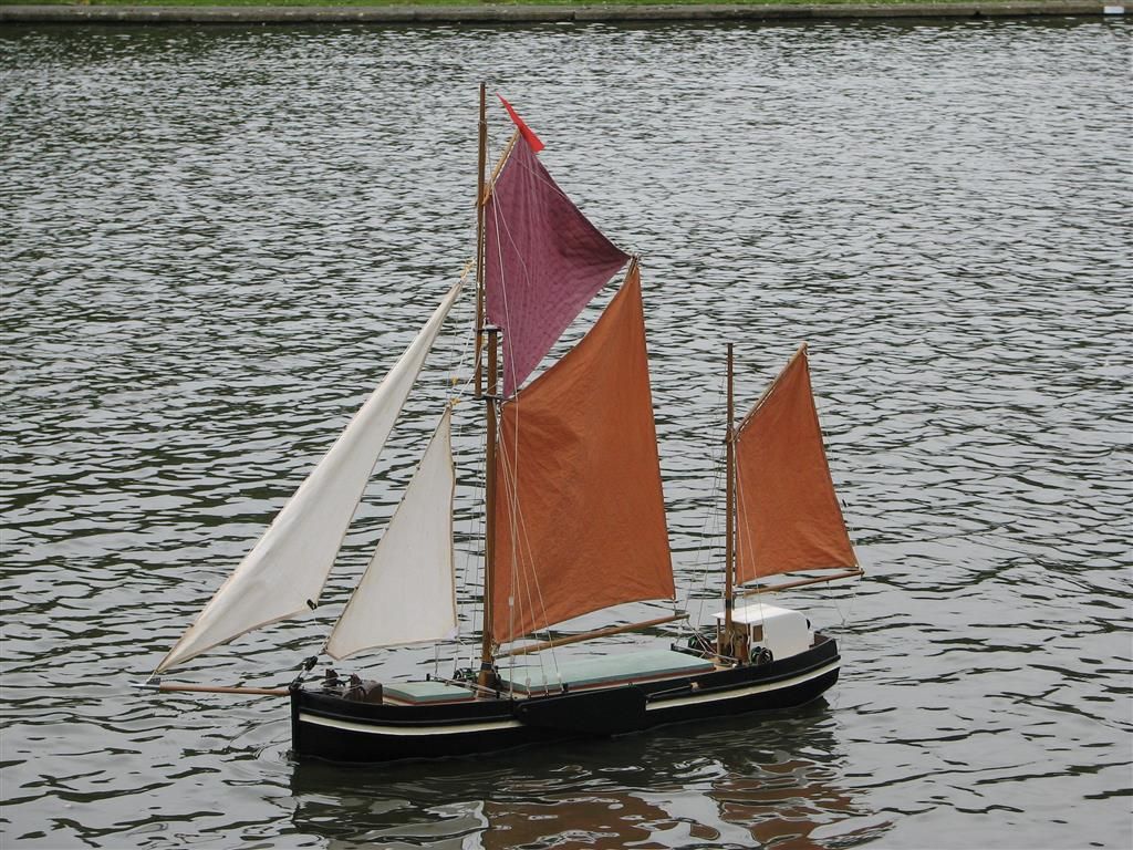

                                                    Please may a newbie ask for some help? I knew nothing about Thames Barges (I race IOMs) but a few years ago, on impulse, I bought a used model barge – Celia Jane. It was complete but tired and needed some TLC. Apart from a repaint it looked as though new sails would be a good idea. ­­­­I got in touch with Models By Design and they helpfully sent me a deck layout drawing and a sail drawing. It has waited until now for me to make time to begin work on it.
                                                    Now I find some puzzles. The top sail, as fitted, has a gaff which won’t fit the sail shape shown on the drawing I have. I don’t have a hull or spars drawing. The mainsail is not free footed but has a boom; the sail plan shows somewhat different shapes from those on the boat. The sprit is pivoted from the fore end of the boom – not on the mast.
                                                    The barge is about a little over 50 inches long with rudder fitted but without the img_0507 (medium).jpgbowsprit.
                                                    I’m uploading a picture of the barge on the water just before I bought it.
                                                    Please can anyone tell me whether I have a DIY modified version of Celia Jane or is it an earlier design of the same boat? Where could I get a copy of the rigging plan/instructions?
                                                    Any thoughts or help on what to do would be very much appreciated.
                                                    Richard

                                                      Put the request on AMBO Facebook page
                                                      There's some guys on that site will give you all the details you want to know
