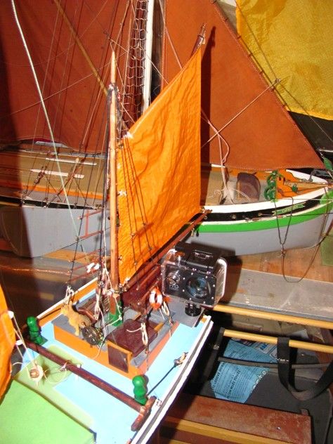

            today I struggled with installing and reviving the receiver in the model.
              But it worked at home … so maybe tomorrow …

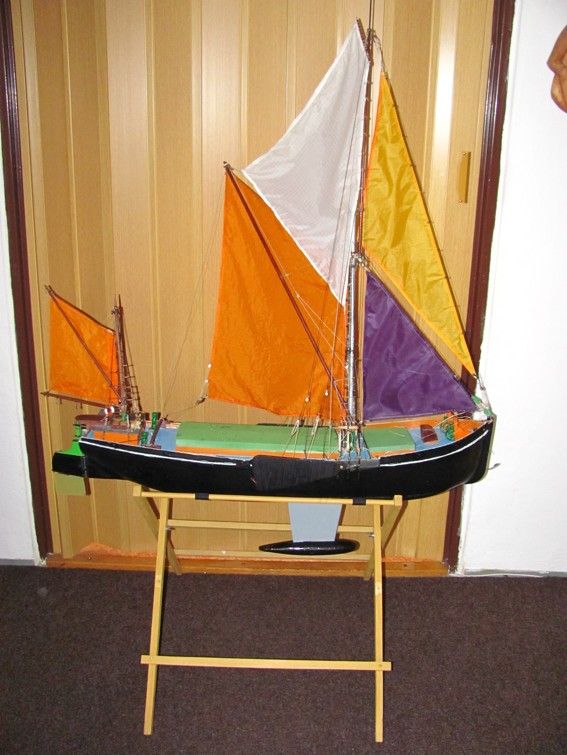

                Hello Tom,
                Well done for Gusty Cat she looks good and fast 😀 are you using nylon sail material ? We have to use cotton here for the racing. This weekend is AMBO racing in my home town of Maidstone on Sunday, although it clashes with the F1 Grand Prix at Monaco, I'll be watching it later.Regards
                The fin looks in the right place to me.
                #82391
                Eddie Lancaster
                  @eddielancaster
                  Hi. Tom, It's very colourful, should look good on the water.
                  I would have liked to have been with you this Sunday Ray, but we have our Mayhem weekend at Wicksteed Park.
                  Regards.
                  Eddie.
                  #82395
                  tomarack
                    @tomarack
                    Hi Eddie,
                    oh yes, she is too colourfull. The foresail will be yellow too..I am searching for somewhat better material,
                    This blue-violet foresail is proper material (from my umbrella) but with improper colour…
                    Tom
                    #82396
                    tomarack
                      @tomarack
                      Hi Ray,
                      sorely I have no proper thin cotton at present . The red brown sails are made from old parachute,badly held shape and wrinkled – it can't be ironed..
                      the yellow jib is made from ripstop (or polyester)material — i am not sure ,I only got leftovers ,I still have a piece of white fabric .I will decide what to do after the trials on big water…
                      greetings
                      Tom
                      Edited By tomarack on 20/05/2019 22:22:16

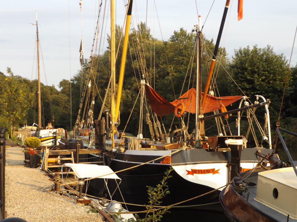

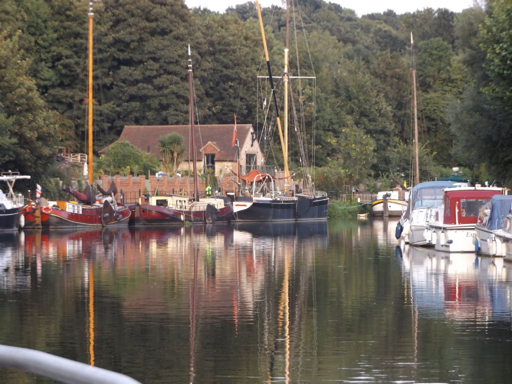

                        defiance may 19.jpgHi All
                        Another Bank Holiday Weekend and the forecast is good for Barge Racing on Sunday at Mote Park Maidstone 10.00am first race, wind permitting
                        In keeping with this thread here are some shots of SB Defiance new build steel 2008, on the river Medway above the lock the other evening.

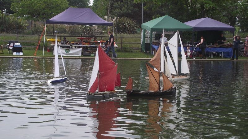

                                    Good racing today, 5 races for each class, good breeze for some close racing, Richard Chesney doing well with a Veronica, which is good as it's his design 😀 my little Gertrude 30" had it all her own way today in all but one race, where her driver made a badly positioned start 😮 i
                                    Good time had by all, happy days

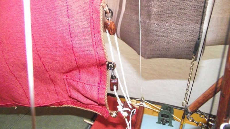

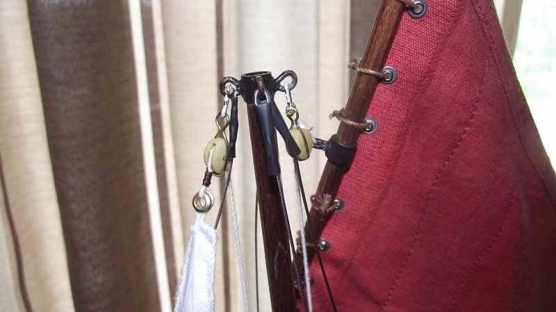

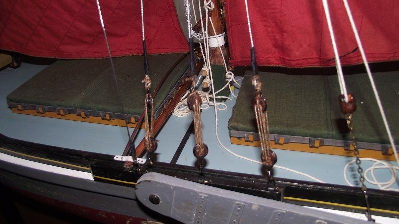

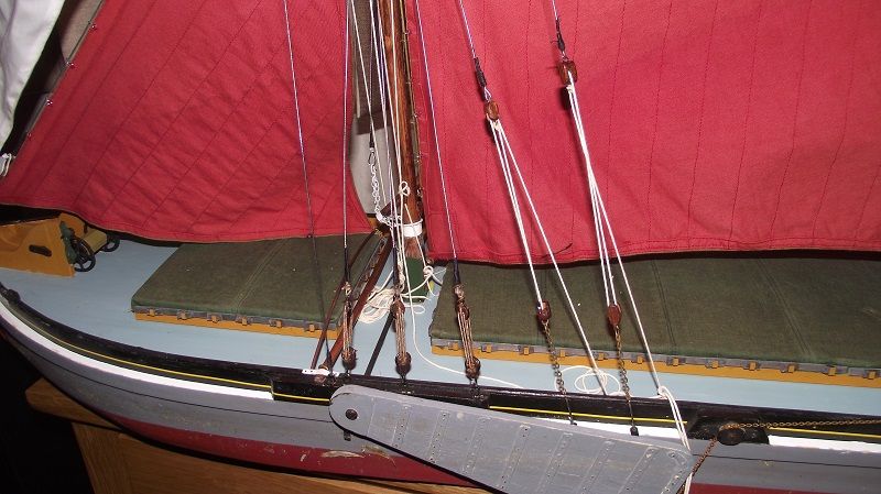

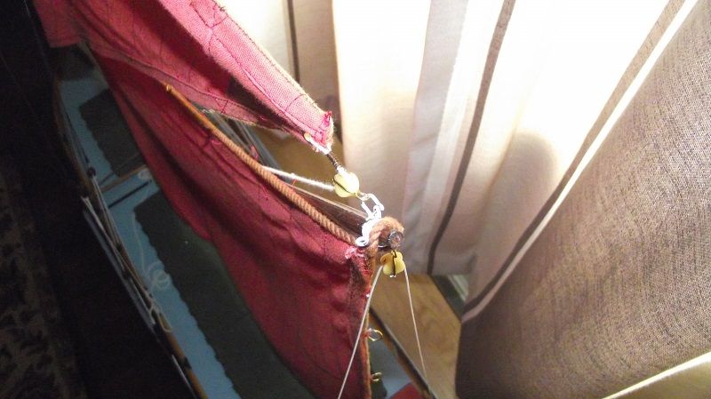

                                        Hi. Roger. the pictures of my TSB rigging blocks.
                                        The top of the top mast. 2 single blocks, one for the topstay forsail, the downhaul is made off at the bottom of the main mast,the second is for the topsail head stick the downhaul is also made off at the bottom of the main mast. dscf3533.jpg
                                        The top of the sprit one block for the topsail made off at a cleat at the bottom of the sprit, the second takes the vangs.
                                        Three pairs of deadeyes each side, attached to the main mast shrouds.
                                        The two topmast backstays have two single blocks one with a single strop or eye, and the other with a double strop, an eye at the top and the bottom.
                                        The mainsail has two single blocks and double block to attach it to the ring on the horse.
                                        I had difficulty getting my head around the rigging but when I started to rig the boat everything fell into place,and | am sure you will find the same.
                                        Regards.
                                        Eddie.

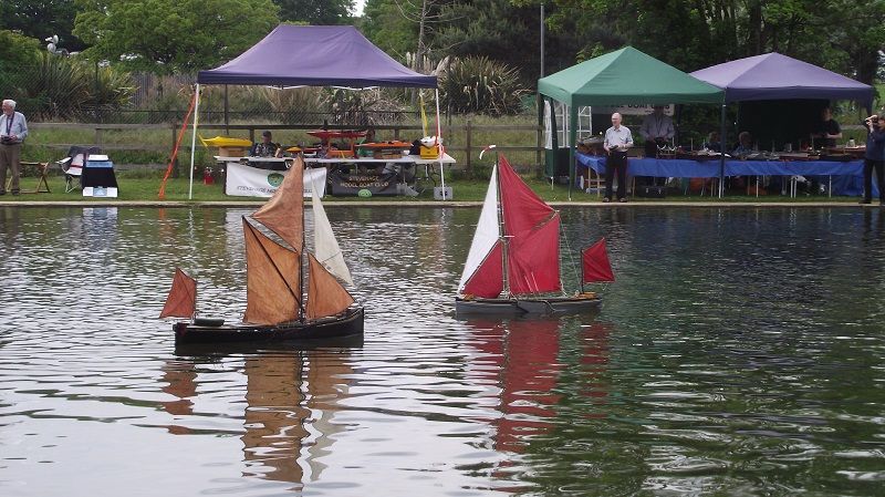

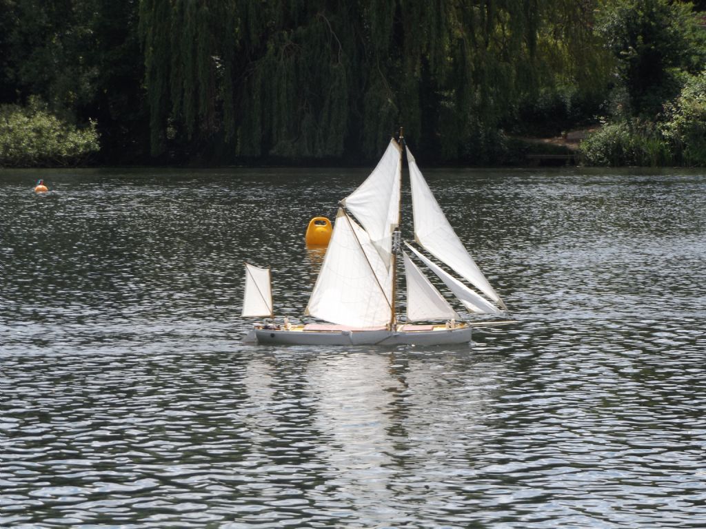

                                              Hi All
                                              For all you Veronica Fans out there, here is Dave (Mastman) Watts's GRP Veronica with the big racing rig on Sunday,
                                              He did struggle slightly as the wind increased during the day with over powering and massive weather helm in the gusts!!
                                              As it's in the Bowsprit class, I didn't get a chance to see how it compares with my Staysail Veronica.
                                              Richard Chesney has acquired another Peter Simmonds Veronica like mine and did really well winning races on Sunday and has got me worried to the point where I may have to install a secret motor to keep up !!!veronica big rig may 19.jpg
