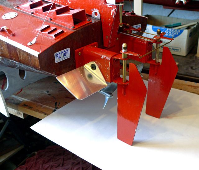

        Here is latest development mod……………The Snowplough Deflector!…………And to cut a long story short for the sake of newcomers …..(If any)……..because the motors are struggling to get on the plane……..due to the extra wide bow wave………….the mod is designed to split the wave sideways
        Here`s fingers crossed for next Tuesday………………..Bob

              #26105
                This looks like a worthwhile improvement?
                Fully adjustable Elevators……..to prevent the tail end getting too low and will also restrict aeration of the props………Roll on Tuesday!
                #26106
                Phil Winks 1
                  @philwinks1
                  thats the one Bob! nice job

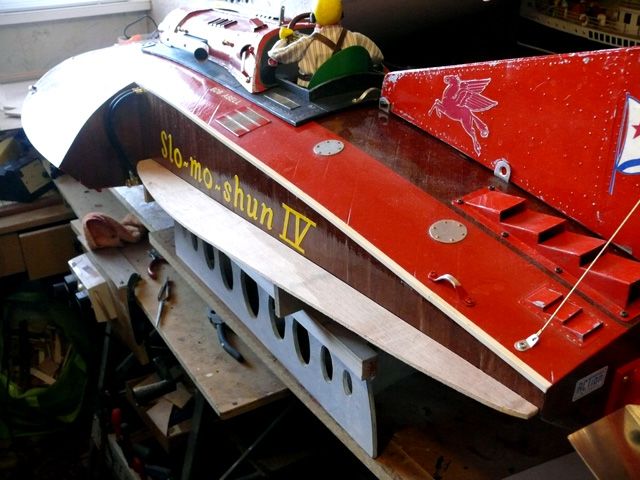

                        What d`yer reckon, Phil?
                        I`m calling these….”Running boards”
                        They`ll look very nice all veneered, with an Ali trim!
                        #26110
                        Phil Winks 1
                          @philwinks1
                          Looks good mate! Are they flared into the chine underneath? To help lift the stern.
                          Phil
