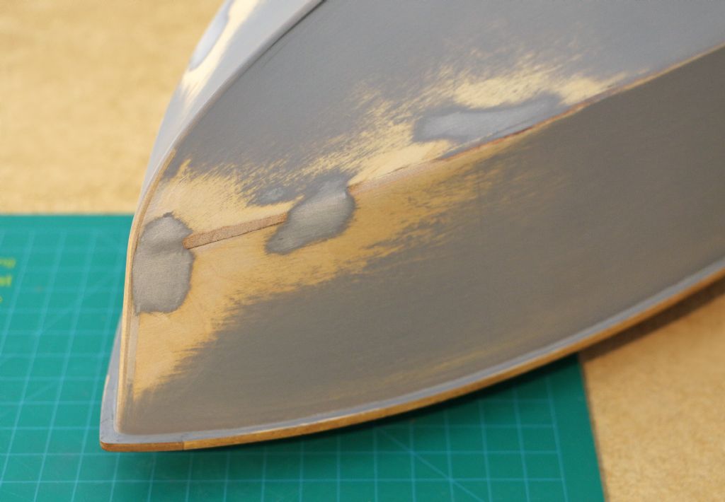

                    Well chaps, I haven't been completely idle, although I have been suffering a bit of teething trouble with the spraying of the hull that resulted in me applying the first coat of gloss, deciding it wasn't good enough, then rubbing most of it off (along with some primer) to correct a stupid mistake. Finally happy, I reapplied the primer (which then pickled), sorted that out and, eventually, added a fresh coat of gloss, which has gone on much better. Second coat soon and then I'll decide if she needs a third, but I'm thinking probably not.

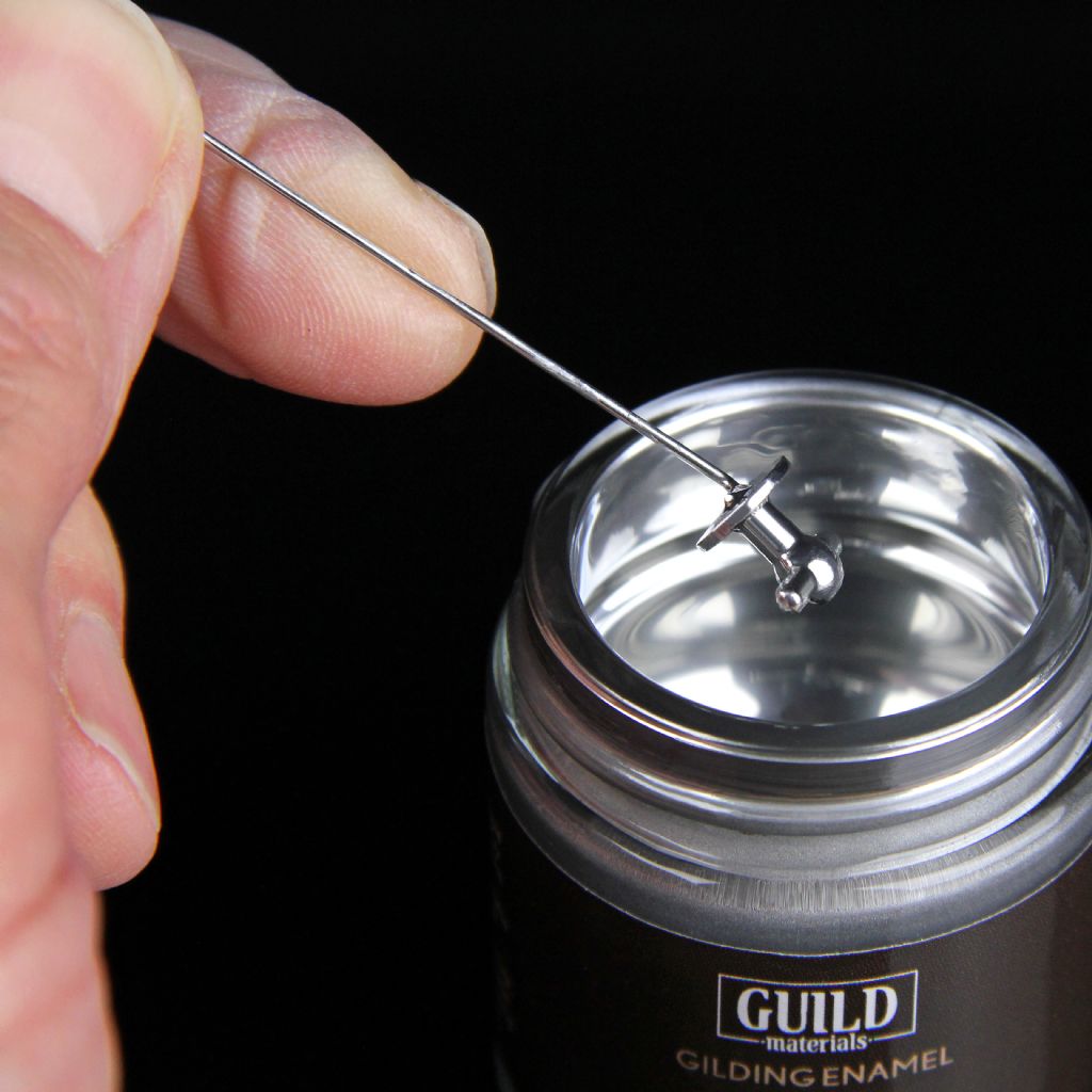

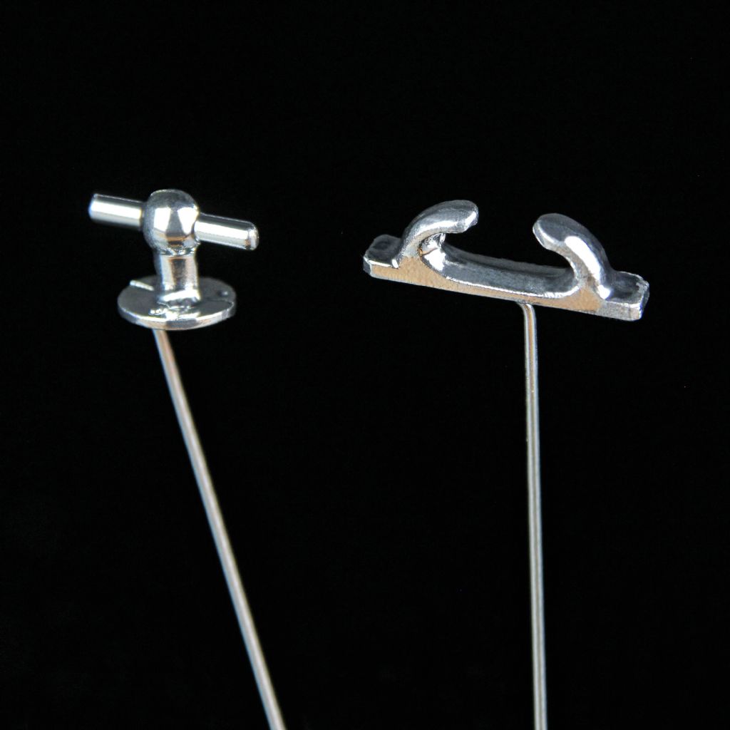

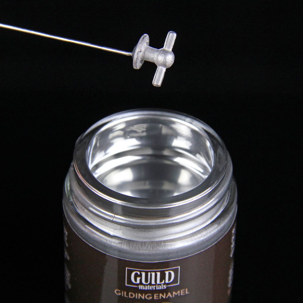

                    Anyway, in-between making a right meal of that I had some success with a new paint that we have at work – Guild Materials Silver. As you can see it's cracking stuff (not cheap, mind) and makes a lovely job of turning the kit's white metal fittings into something that resembles polished stainless. What-do-you-reckon? A quick dip and the job's a good'un. I was quite chuffed with the stuff.

                      Looks very good, Graham. Did you use any primer, and where can this magic potion be obtained?

                        That’s mightily impressive Graham. It is amazing what’s out there.

                            No primer used Dave, just dip it in, or brush it on. It's cracking stuff. At the risk of sounding like a salesman it's available from any Perkins stockist. Not cheap but it goes a very (very) long way. Maybe we could share a bottle, hee hee!
