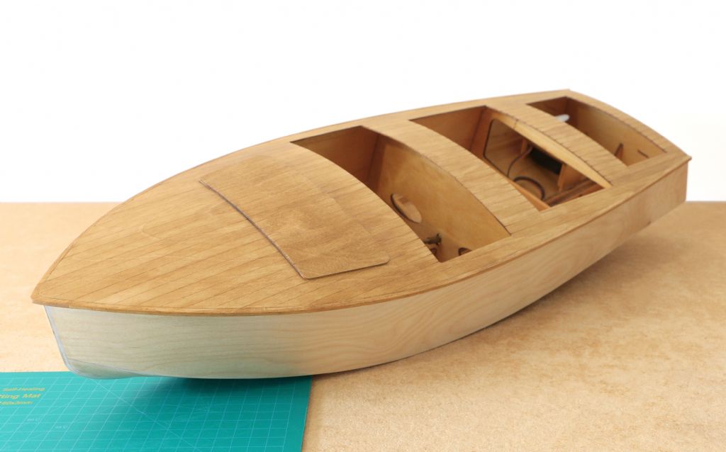

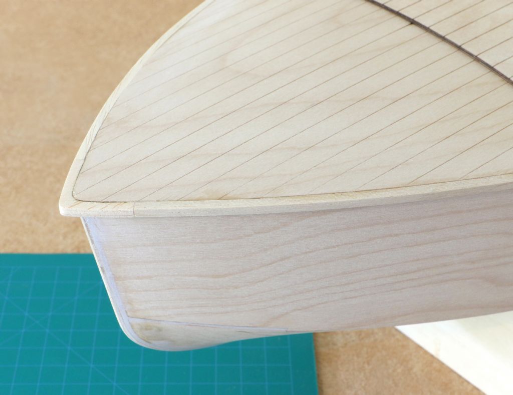

          I do believe I've finally used all the bits of wood from the kit. Hurrah!! Added the rubbing strip over the last day or two but had to improvise with a home-spun bow piece as the detail isn't mentioned in the kit. I should also say that I'd forgotten how fab P.38 filler is. Wonderful stuff. Sanding sealer's in the post and I'll be staining the deck before the weekend. Question is, what colour? Mahogany or a light-ish oak? At the moment I favour the oak simply because the darker mahogany tends to hide the laser etched plank lines. Any thoughts chaps?

            It looks very pretty

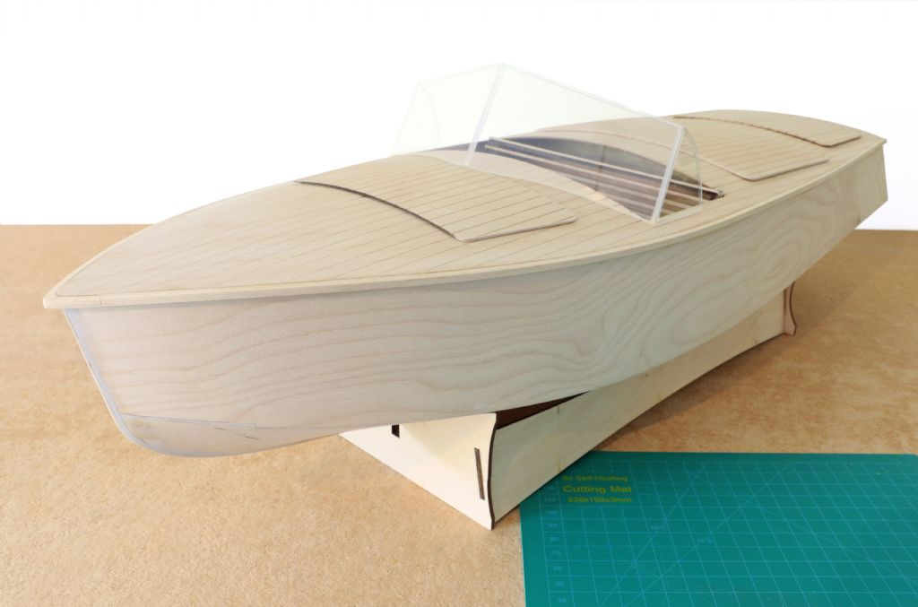

              Hi Graham,
              The windscreen looks the part, I'm sure you would have some canopy glue
              #76892
                Looks very nice "in the wood".
                Personally not keen on staining wood unless I know that there is absolutely no glue on it whatsoever.
                ​I use ordinary epoxy resin glue on transparencies, but a personal preference…

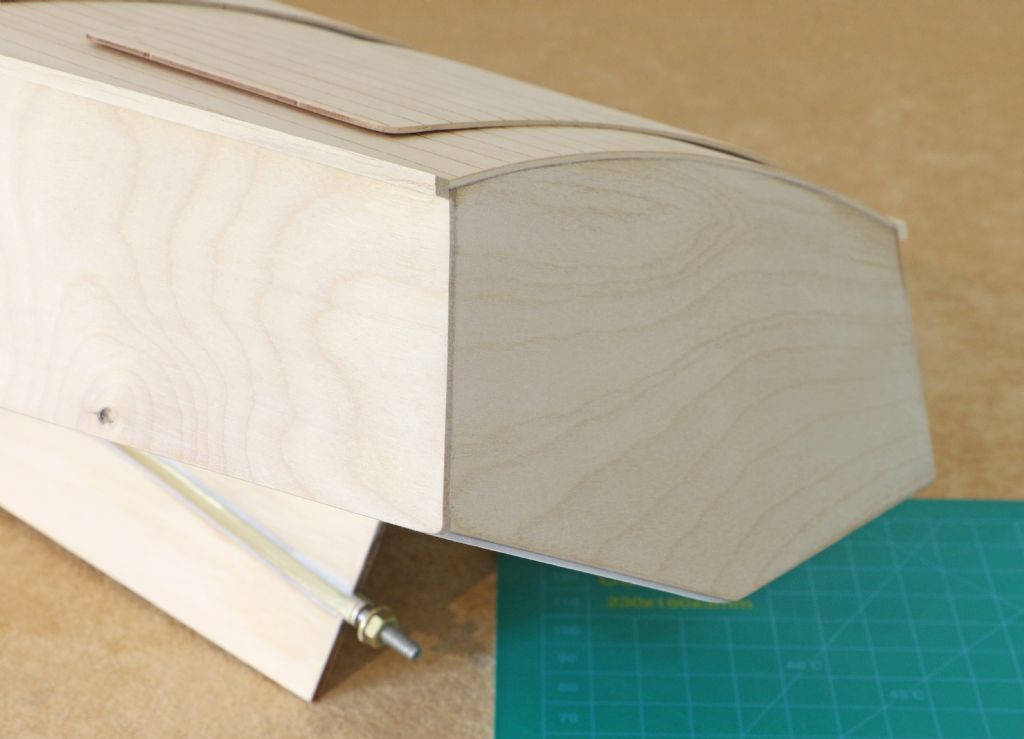

                Please adjust the prop locknut before sailing.
                ​Ashley

                  Canopy glue is definitely my preferred option Ray, although I'm still considering some sort of deck-level channel section to hold the screen. I'm not keen on a simple glued butt joint because I'm not sure I can make it neat enough.
                  No glue on the deck as far as I'm aware Ashley but I'm going to double check now you've said that.
                  BTW, the chosen colour scheme is No.2 – the most popular and, as luck would have it, my favourite.
                  Graham

                    Hi Graham, lovely build, i would favor the oak finish, have you considered the screen surround? some fine chrome effect trim strip on eBay, looks very nice and for you it would mount the screen to the deck as well
                    Mark

                      That looks really lovely now, nice job. I have used OO/HO railway track (Peco Flexi) to make screen surrounds. (Just the metal rails) File one side so the top and bottom of the rail are parallel, drill some small holes for pins and along with a little epoxy fit the track to the deck. (Track pins or cut down dressmakers pins work well)
                      The screen fits in the groove on the other side and can be a 'click' in fit if you make a soldered frame all the way round. It's easier than it sounds but look lovely, almost like the real thing.
                      Cheers…….Ron.
                      #76899
                      Byron Rees…(Ron)
                        @byronrees-ron
                        Further to my last post, to get the curve, anneal the frame till its red and quench in water, this will make it easy to bend a couple of times.

                            Hi Mark, I'm with you on the oak finish, that's the one it'll be. I'll also check the chrome effect strip, many thanks.

                              Thanks Ron, I'll take a look at that too. This is worth taking some time over because if I get this bit wrong it'll bug me forever.
