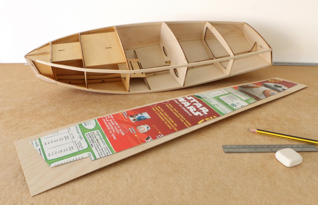

        Graham, what thickness is the warped bit of wood? Are you going to fit the running gear before going much further as advocated by all and sundry while you still have good access and so on??
        Difficult to get ply that's dead straight. I usually sort through the bits and get as good as I can. It doesn't matter much with very thin ply in any case really, but there can be a big difference in sheets of 4mm, and these I find need to be carefully selected.
        Different proposition with PROPER man-made board of course, its always nice and flat. wink
        ​Ashley
        #75876
        Graham Ashby 1
          @grahamashby1
          Hi Ashley, it's 1.5mm, although (as you say) it being warped one way or the other doesn't really matter, I was just chuffed that it had warped perfectly to suit the hull shape. Mind you, it will make it easier to pull in at the front.
          smiley
          Crikey, yes, 4mm wouldn't be so easy to flatten!
          As for the running gear, I'm a bit undecided (there's a lot of access even with the deck on) but I'll probably fit it before the deck and finish varnishing the inside too.

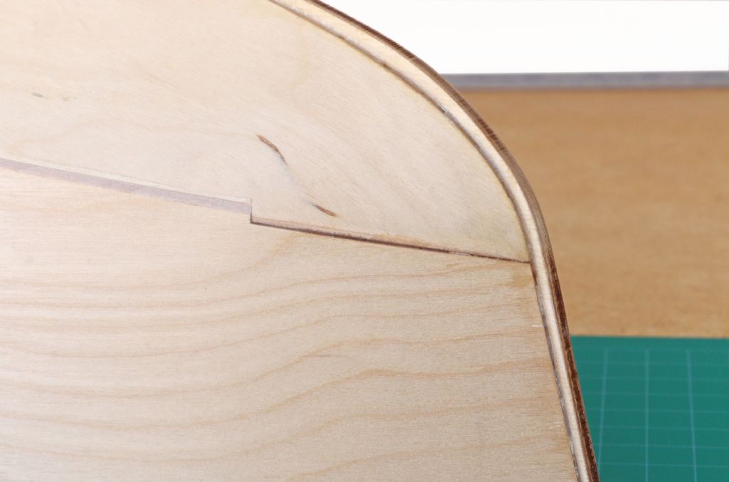

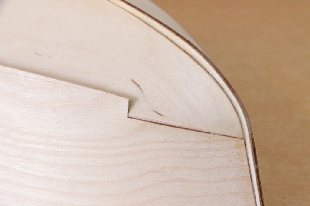

                      Hi All, a few snaps of today's side skin sanding job. Another massively satisfying process that's left me with the makings of a hull. Much happier with the joint on this one than the other side so I can only surmise that the practice is paying off. Motor and rudder this week, then it's on with the deck. More next week when we've booted the April issue out the door.

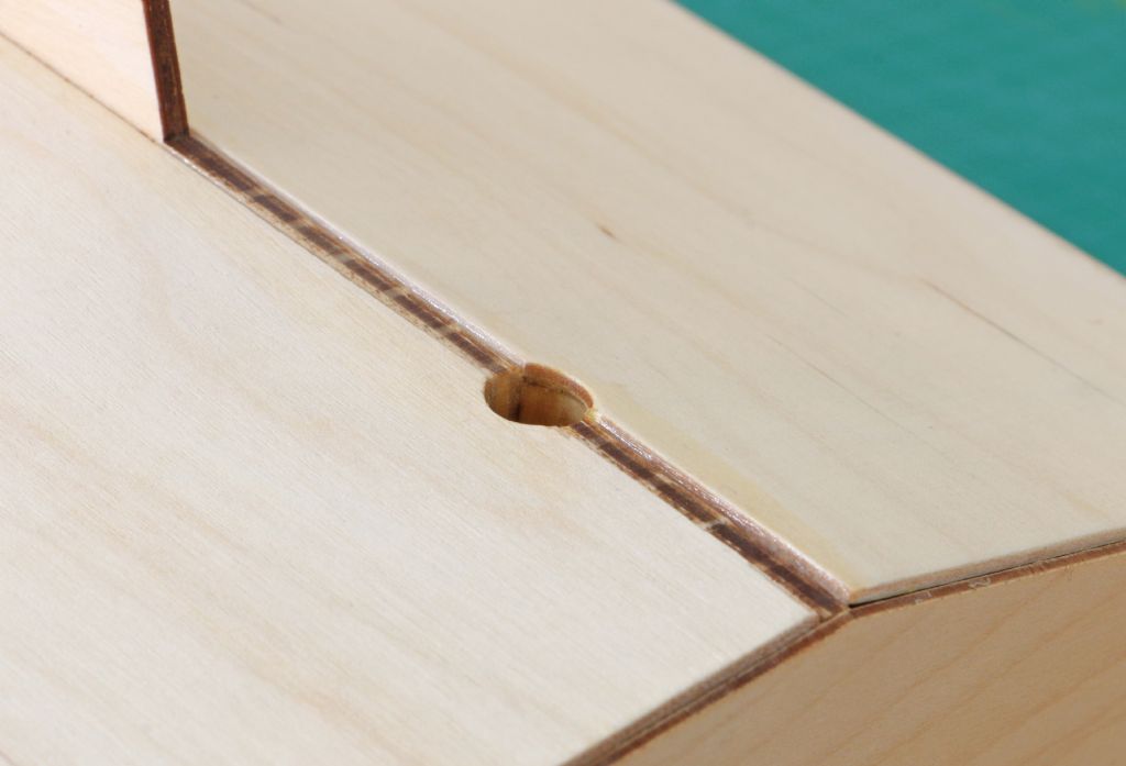

                        #76030
                          Wow! That is one neat joint, Graham. You've done this before, haven't you?

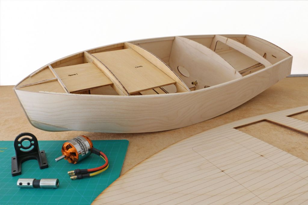

                            Hi Graham
                            It's a good job your a pilot ! because with that motor in your little boat not much of it is going to be in the water
                            Seriously are there chine/spray rails as designed ? she will be horrible and very wet without them.

                              Ray, it's a fair point, mind you at 600mm it's the same size as Dave's Huntress (I believe) so I've gone for the same motor and controller / 3S combo. No chine spray rails as designed but it wouldn't be any trouble to fit some so I think I will. Good thought… I guess I can always rate the throttle back at the Tx too.

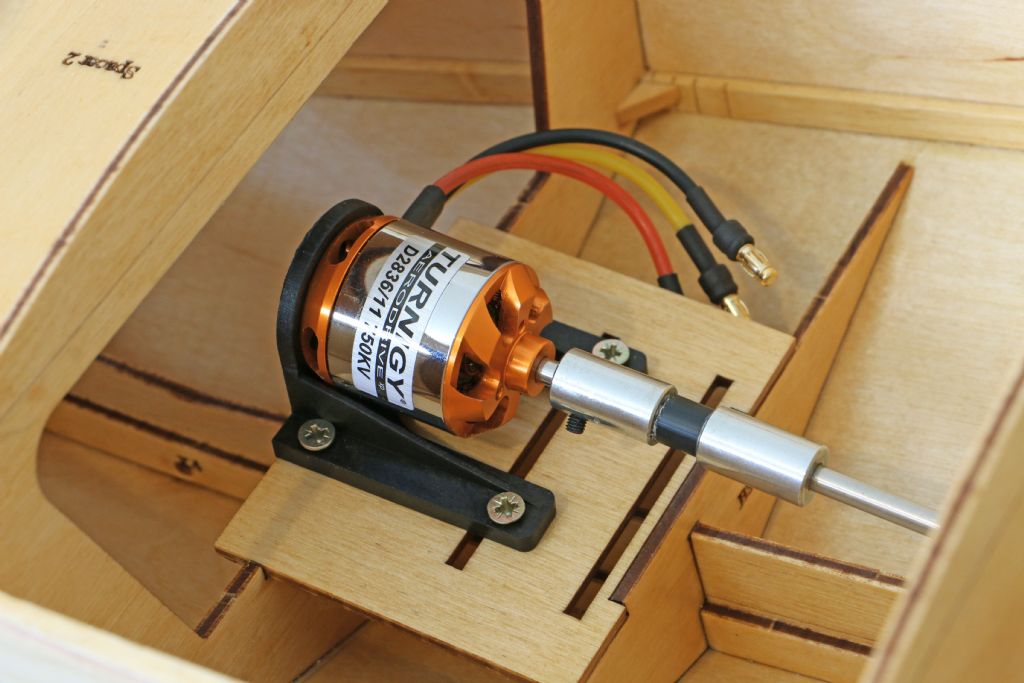

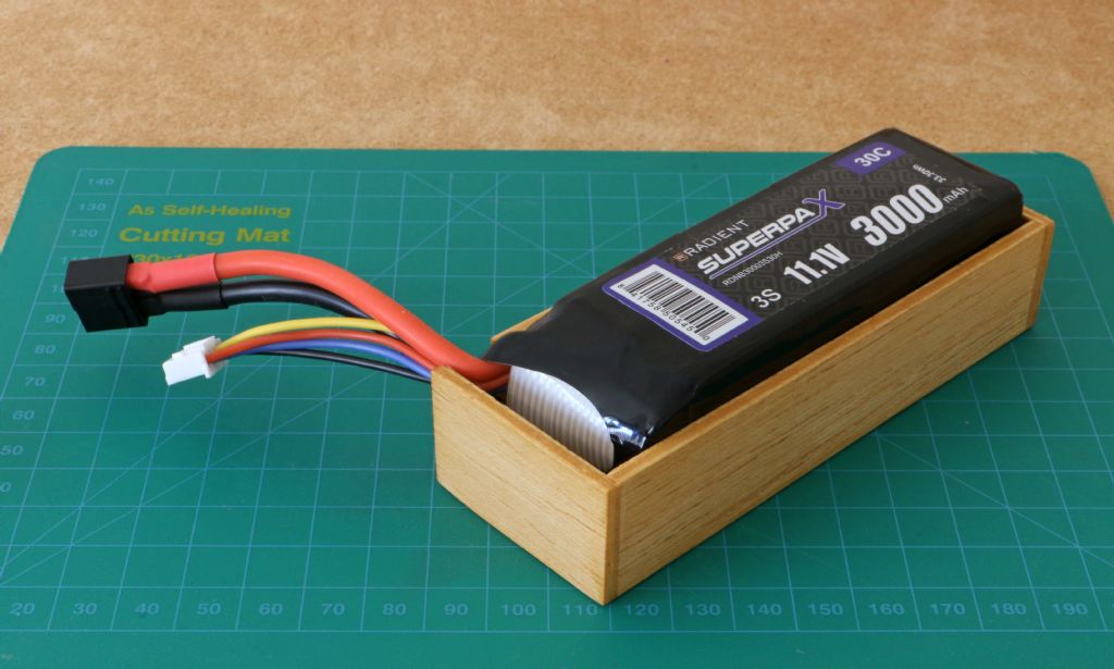

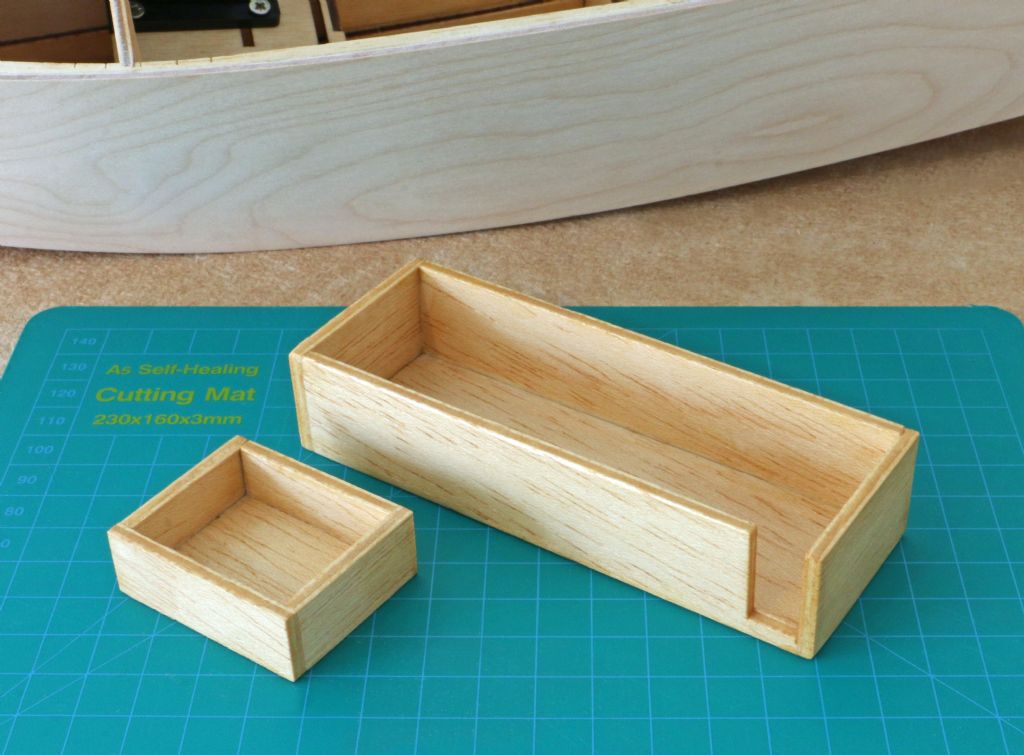

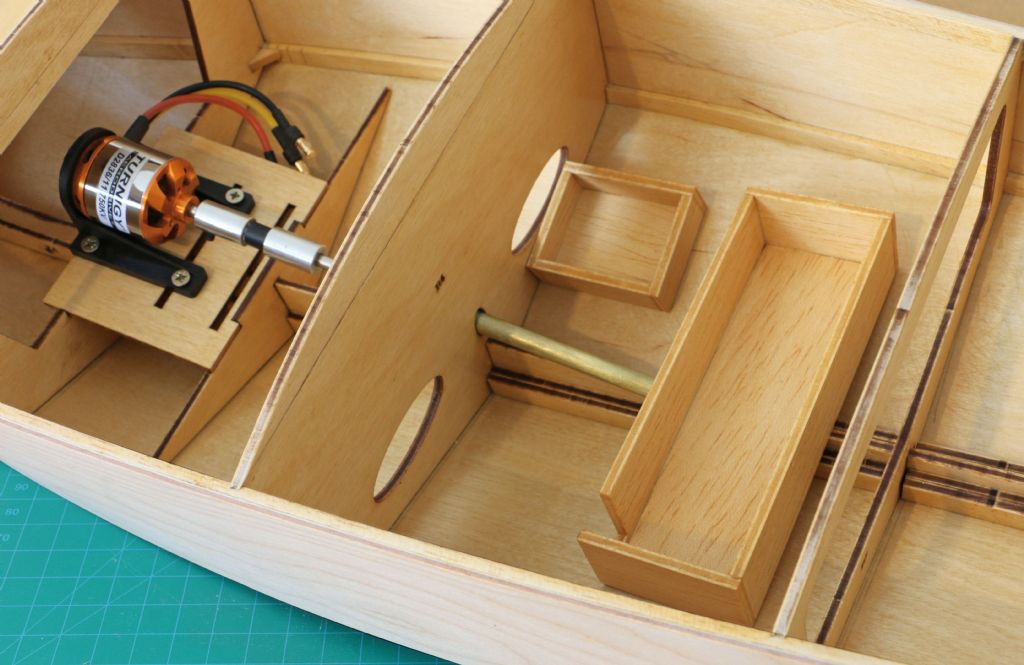

                                          Hi all, just to prove that I haven't been completely idle, here's a little more. I still can't quite believe that the motor and shaft were in perfect alignment without having to use shims but, honestly, they were bag on.
                                          The battery tray suits all my existing 3S packs and she's had another two coats of varnish inside. I think it's time I fitted the deck.

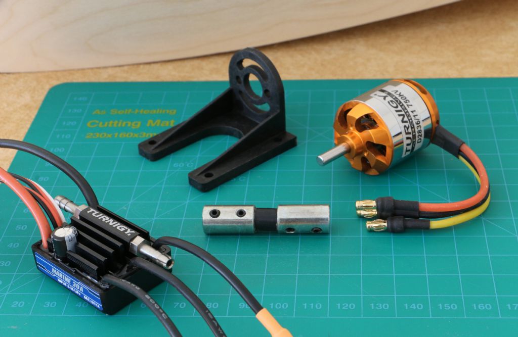

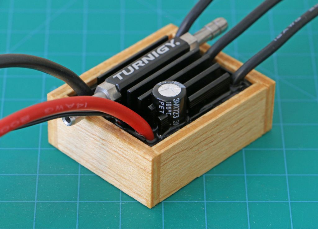

                                              Hi. Graham, that's a neat installation, is that water cooling on what I assume is the speed controller? everything in boxes seems a much neater solution than double sided tape or velcro, provided you have the capacity.

                                              #76408
                                                Eddie
                                                Yes, those are inlet and outlet connections for water-cooling the 30A ESC but in my own experience with this same set-up it's not necessary to use it. Even after fifteen minutes thrashing round the pond at full steam nothing gets more than just warm.

                                                Graham Ashby 1
                                                  @grahamashby1
                                                  Thanks Eddie, yep, as Dave says.
                                                  I copied his Huntress installation and I'm copying his thinking on the water-cooling wink
                                                  I'm not keen on Velcro or double-sided tape although I will probably mount the receiver on the stuff, unless I can think of a neater way. The box idea doesn't really work because the Hitec Optima 7 has sockets on either end.

                                                    Byron Rees…(Ron)
                                                      @byronrees-ron
                                                      That Turnigy 30A. Speed controller is amazing and exactly the same as the Alex Engel ones from Germany I used to use. (Cheaper now from HK) I've been using them for over 2 years now and have never needed to connect up the water cooling as Dave has said.
                                                      Very neat installation Graham, it will go like a rocket. Nice one.
