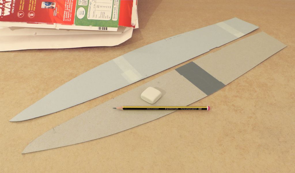

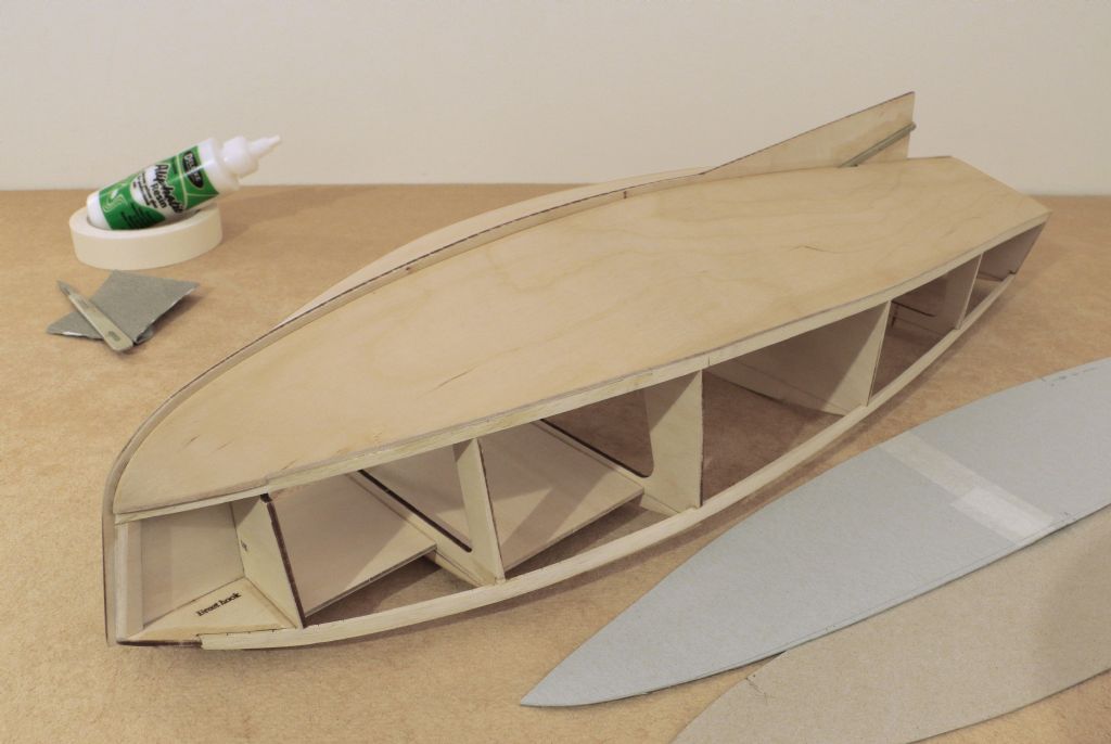

                Slow progress but it is, at least, progress! Just been cutting card hull skin templates. If the skins fit like the templates I'll be a very happy chap. Hmm…

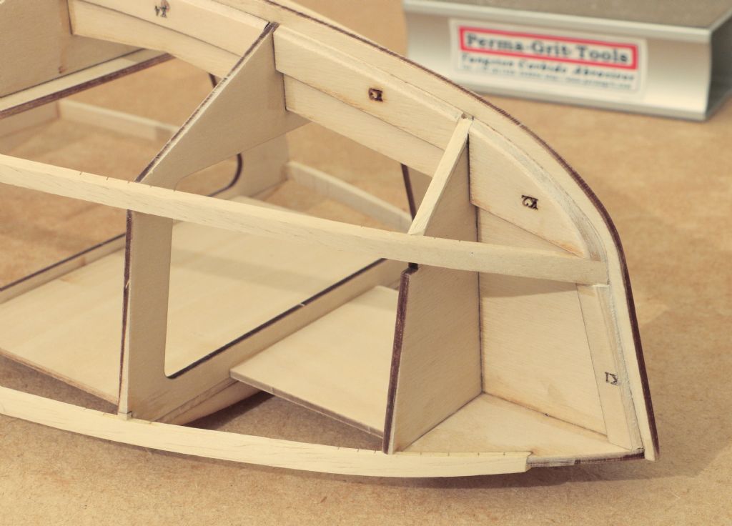

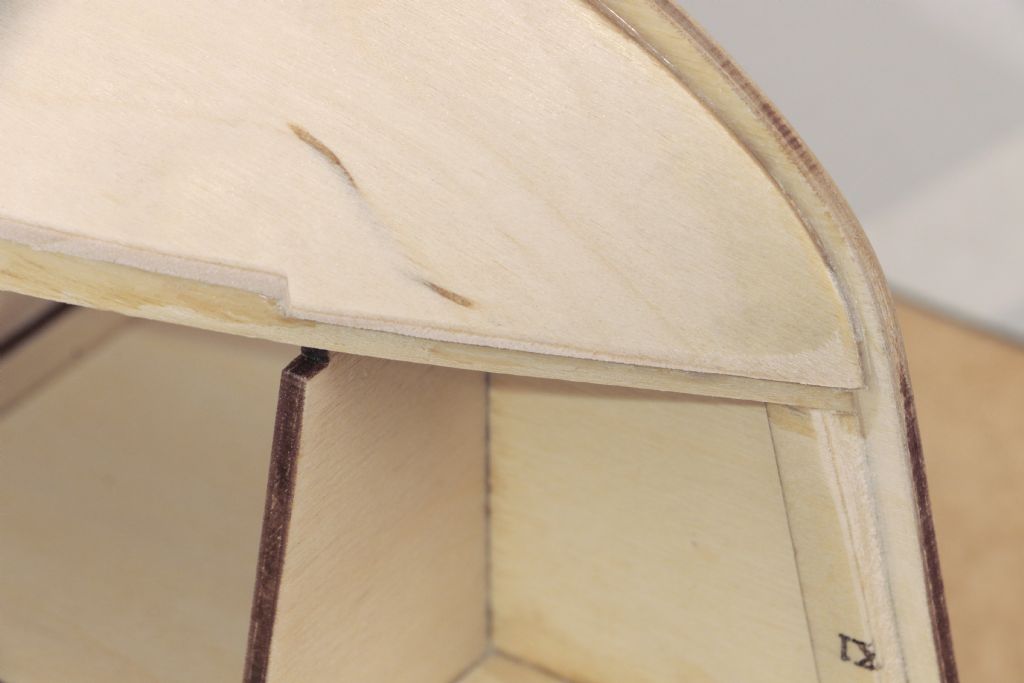

                    That front frame has had a fair old bit of fettling done, Graham. It looks to be about 1/8" too short. Why not save up details of all such minor errors and let SLEC know? It's a matter of a few minutes to amend the CNC file. The model is coming on nicely.

                        Posted by Dave Milbourn on 07/12/2017 10:55:20:
                        Good spot Dave, yes it is a bit short. I spoke to Ian at Warwick about it briefly and did mention at the time that I'd make a list of anything I found. To be honest, that's about the only slight glitch so far.

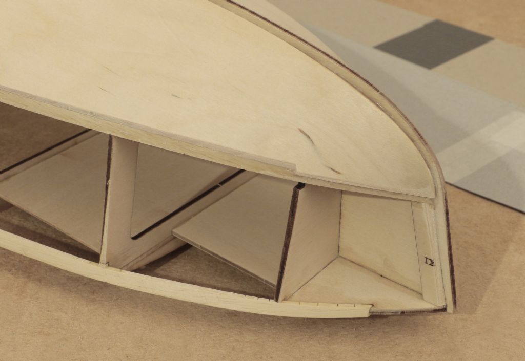

                            Well, fortunately the bottom skins fitted almost as well as the templates so, on the whole, I'm pretty pleased. A very satisfying build so far. More soon smiley

                                Hi Graham
                                Good precise works, That's the most interesting joint and line to make work on a chine boat hull Good Luck
