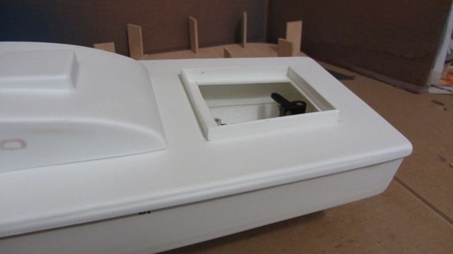

        Just a quick question. I am about to cut the holes in the deck and have noticed in your picture that you appear to have cut the rear hole smaller than the full size is there a reason for that as I don't want to mess it up thank you
        #103759
        Dave Reed
          @davereed72029
          No real reason for the smaller hole – I cut out just enough to access the servo and rudder.
          I cut strips about 8mm high and glued them in using the indentation in the deck as a guide. Will make a cover slightly bigger to fit over the top like a shoe box.

            Tim, it's just occurred to me that if you plan to use a flat panel to fill the space (as per instructions) you will still need a small lip to attach it to.
            Not a disaster if you've already cut to much out – you could glue plastic tabs under the edge of the deck to support the panel.

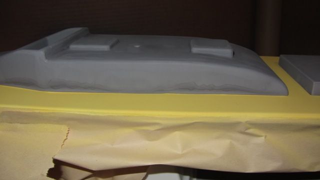

            You may also notice from the photo that I've cut the superstructure up to the edge and not left the recommended flange. On my kit it didn't fit very well and I didn't like the look. Fits much better like this, held down with small magnets inside the superstructure and matching ones under the deck.

              It does look better without the flange. Never thought of using magnets. Thanks for your help again.
