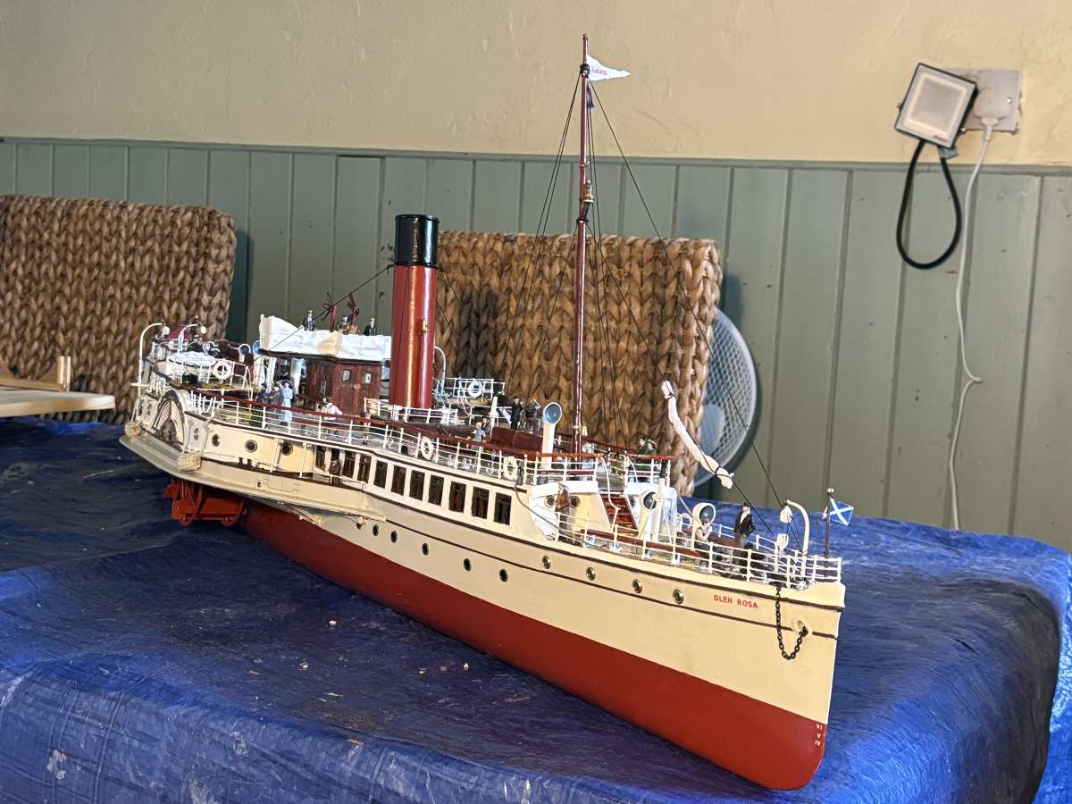

        Glen Rosa is now essentially complete, bar a few human figures and some steps up to the bridge. My work doesn’t give me much spare time, but I have managed this build in about 15 months. After trimming ballast in the bath again, it’s sea trials on the pond. Any reader in the Edinburgh area who wishes to join me is very welcome. I have waders, but am hoping they will not be required!

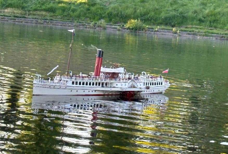

                  On the pond at last! Took her on her maiden voyage this evening!
                  #120544
                  Alasdair Allan
                    @alasdairallan37423
                    The idea of a removable keel seems to have resolved ballasting issues, at least when going ahead, though she is still not keen at all on going astern! very pleased with the results though.

                          Looks great Alasdair, really captures the charm of the prototype. How deep is the removable keel?

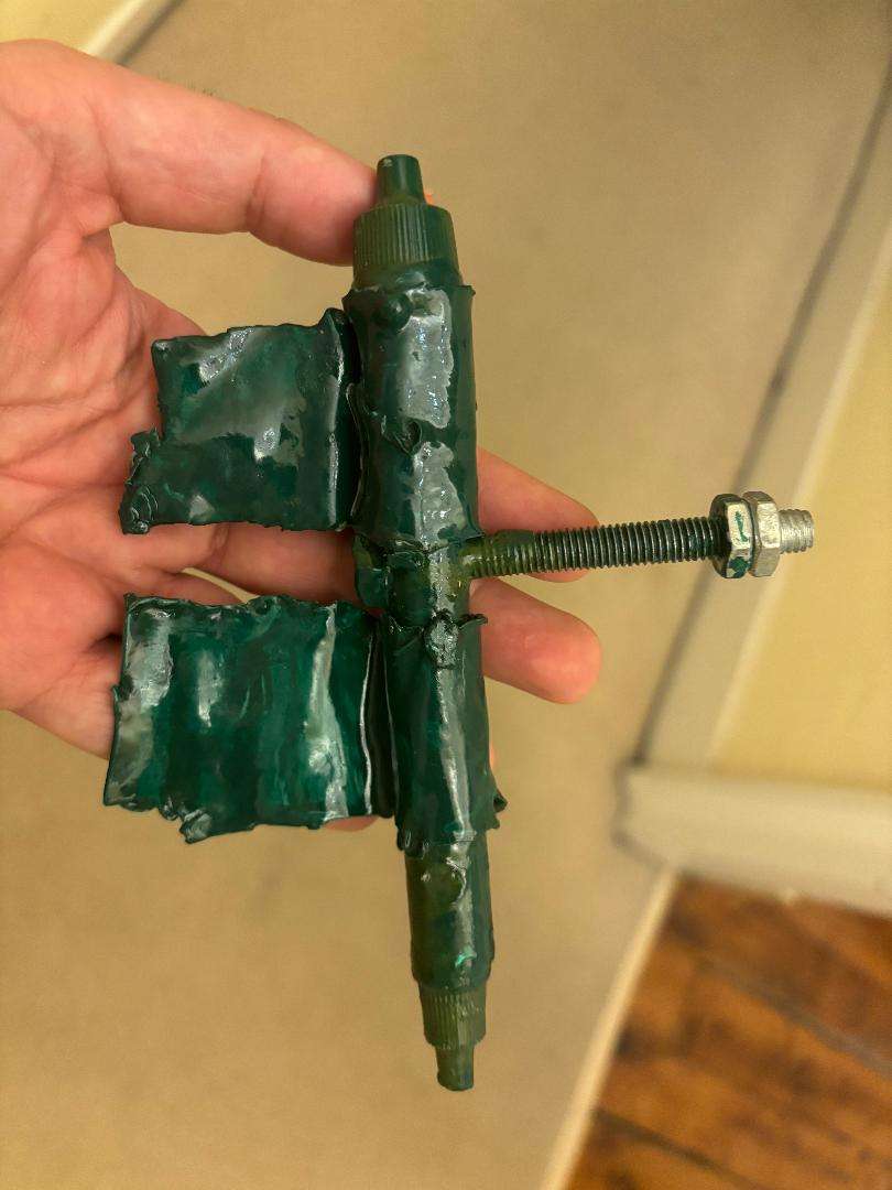

                              Thanks for the kind remarks! Will post a photo of removable keel – though please don’t laugh at it.  I suspened an 8cm bolt with a 15cm plastic tube full of lead shot sitting lengthwise on the end of it  Realised that was not deep enough though and so glued some lead flashing to hang a further 10cm further down. If this was not so experimental it would be more elegant than that.

                                    Returning to ballasting, I found that when the boat goes ahead she is very, very stable, even when steering. When she stops though, she is prone to heel a wee bit in the breeze.  What she really, really does not like doing though is going astern, even slowly. This always makes her list – sometimes to port sometimes starboard. It may be that if I had a remvable keel that was deeper or longer I would not not have this problem, but for the moment will stick with what I have invented!

                                        Told you it was not elegant!
