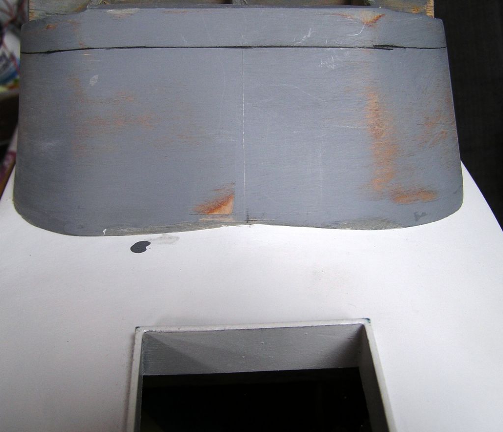

        #72655
          Hi All
          Repaired the other side of the forward cabin and sprayed on under coated/ filler.
          Harry

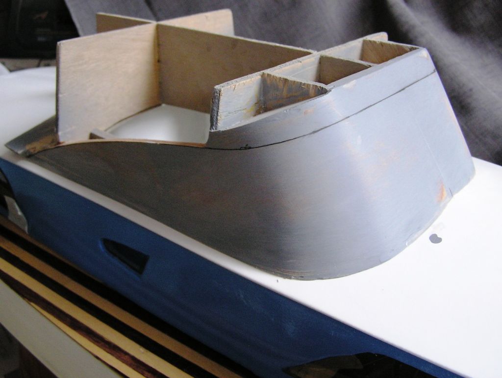

              #73354

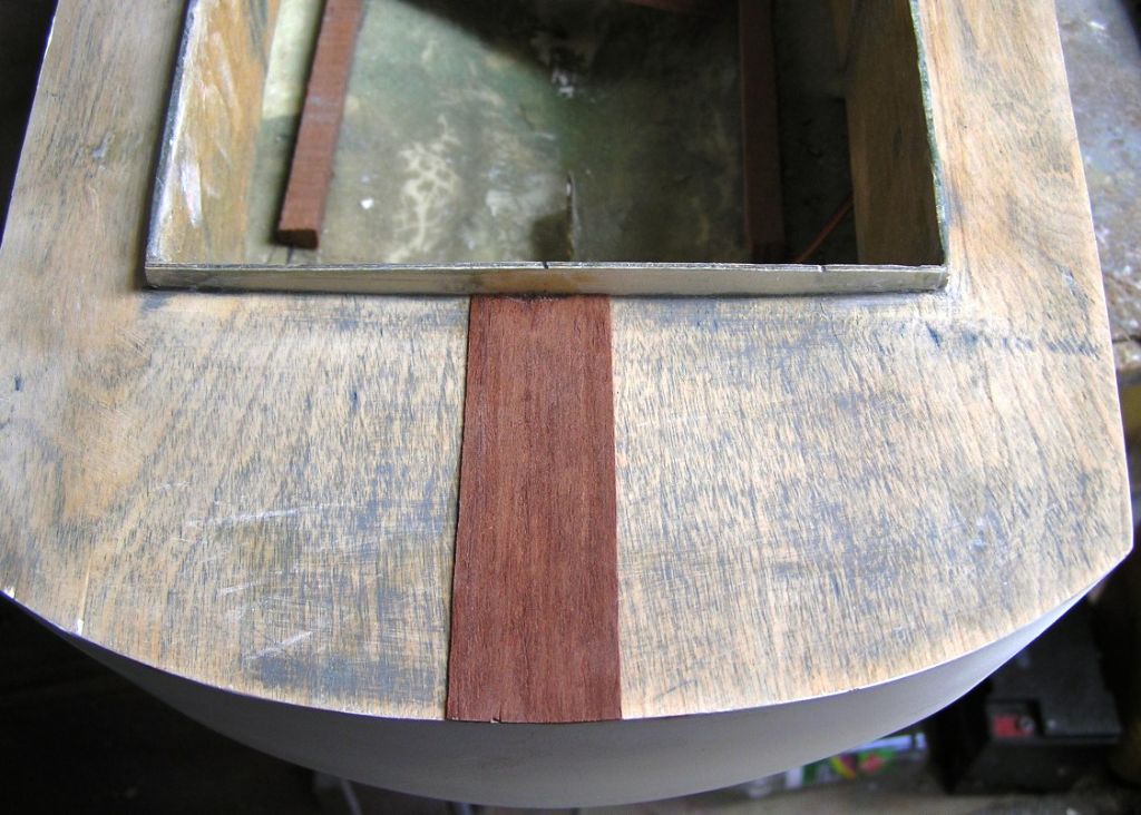

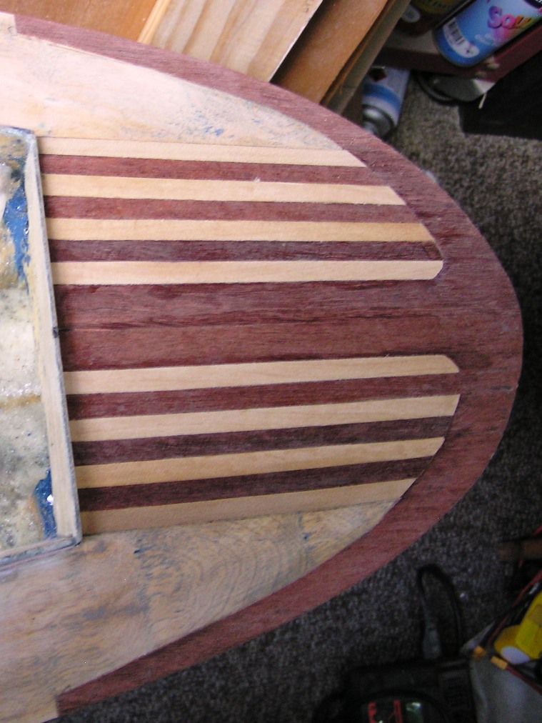

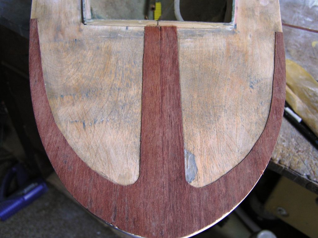

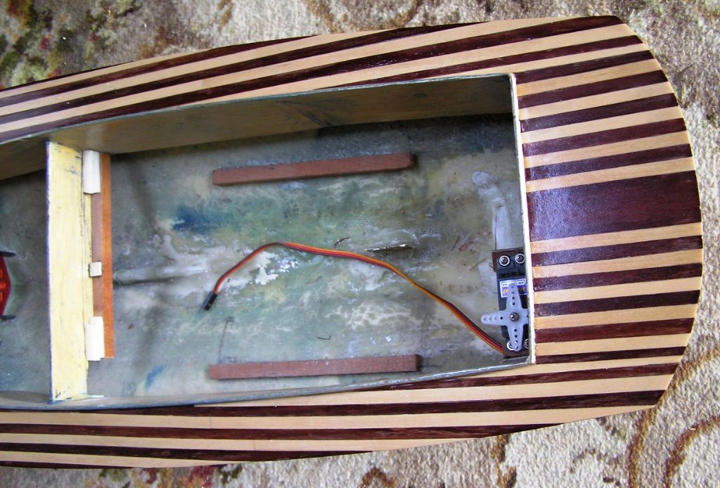

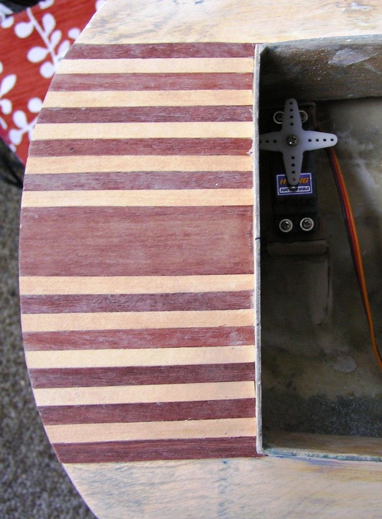

                stern planking2.jpgstern planking 1.jpgbow planking2.jpgHi All
                Started the deck planking !!!
                #73377
                  stern planking3.jpgHi All
                  Still Planking !!!

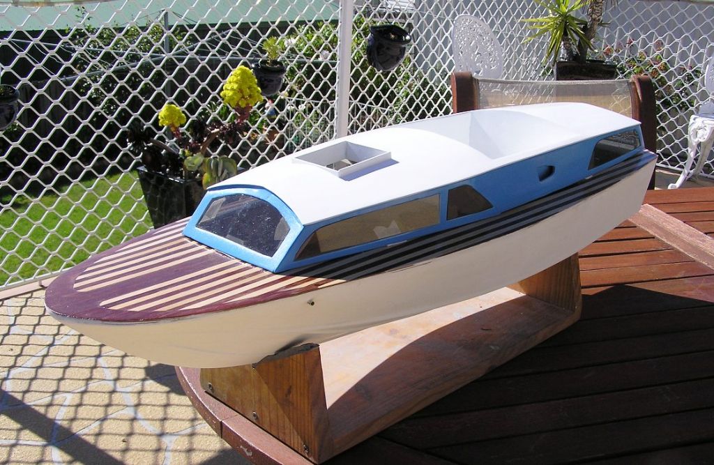

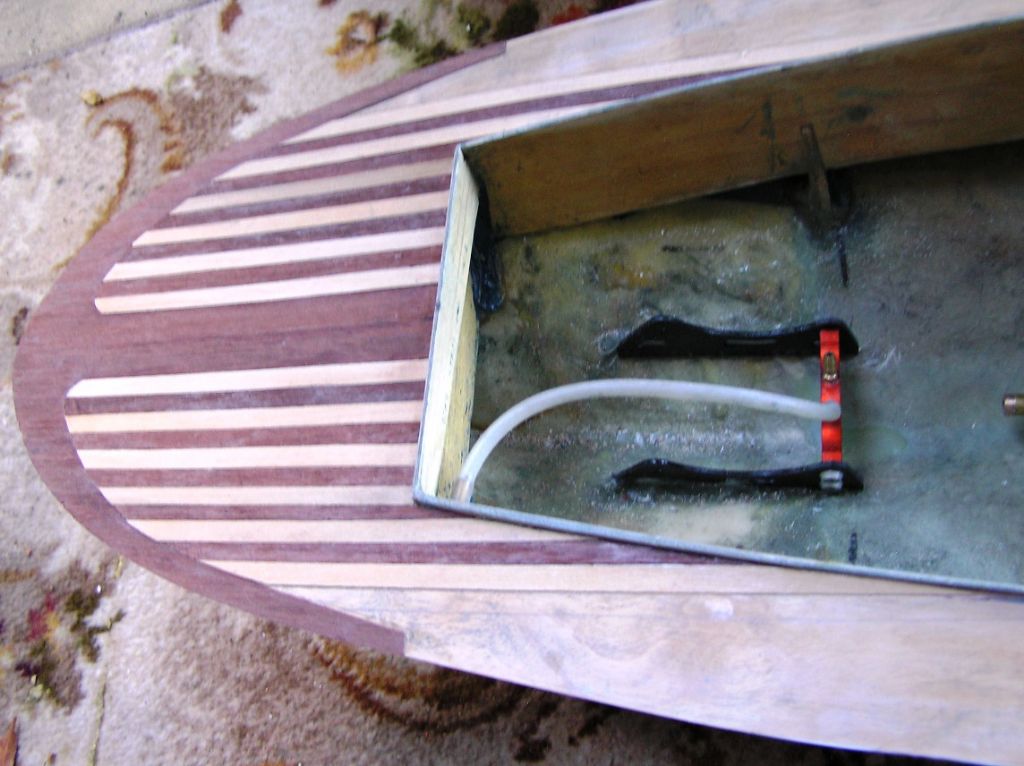

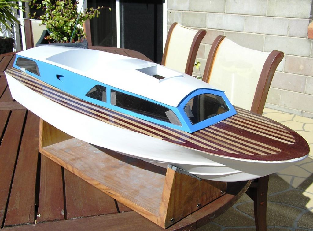

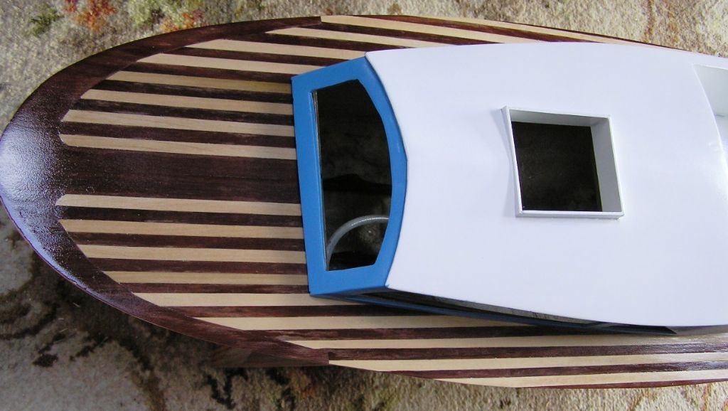

                  #73640
                    stern planking 5.jpgHi All
                    Well I finished the deck so onto the cabin and install the rudder.

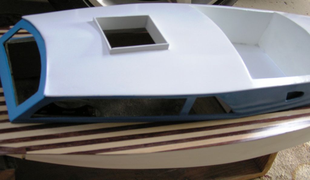

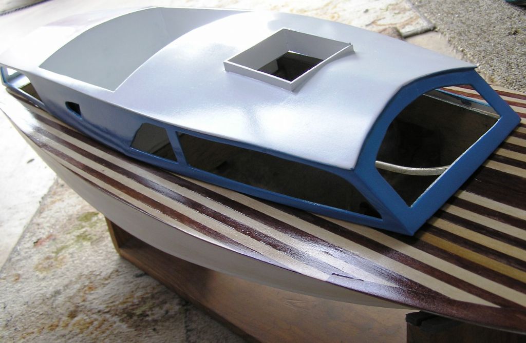

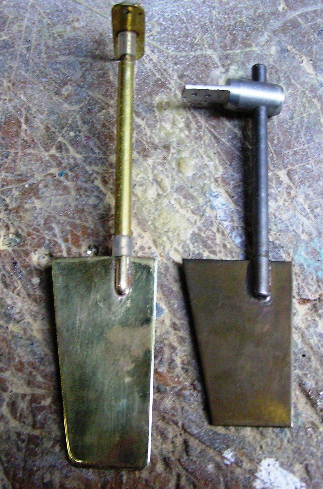

                    #73785

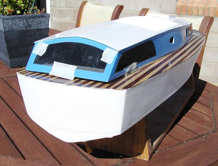

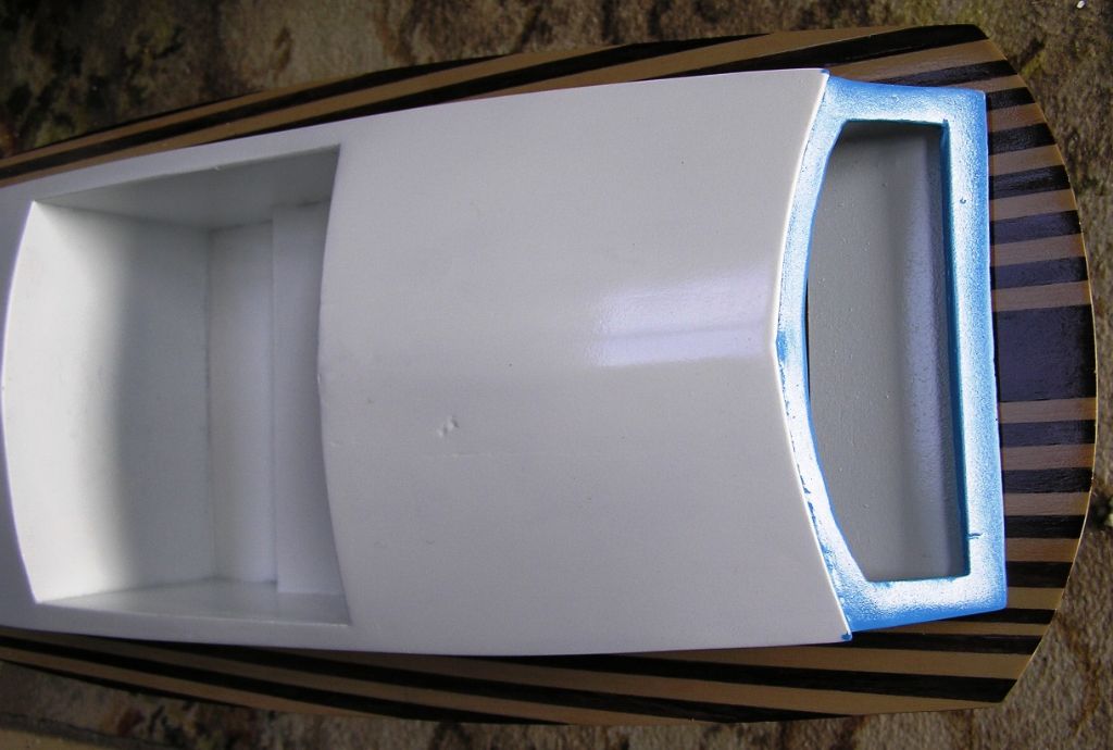

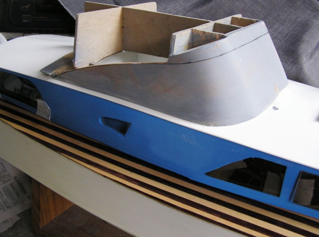

                      up size rudder.jpgcabin 4.jpgcabin 3.jpgcabin 2.jpgHi All
                      Painted cabin white on the roof with blue sides.
                      Also installing a bigger rudder!!!

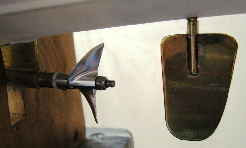

                      #73787
                        Harry
                        I'd keep the rudder as 'shallow' as possible (i.e. distance from the top to the bottom). This is a deep-vee hull and rolls in a turn. The longer the rudder then the more turning/rolling moment is applied, to the point where the boat will flip. Also you don't need much rudder deflection – mine all use about 20° each way.
                        It's certainly a drastically different boat from the wreck you started with. Now don't leave off the windscreen or pulpit!
                        Edited By Dave Milbourn on 24/10/2017 09:45:33
                        #73789
                          That deck looks stunning Harry, can see the contrast now the top is on.

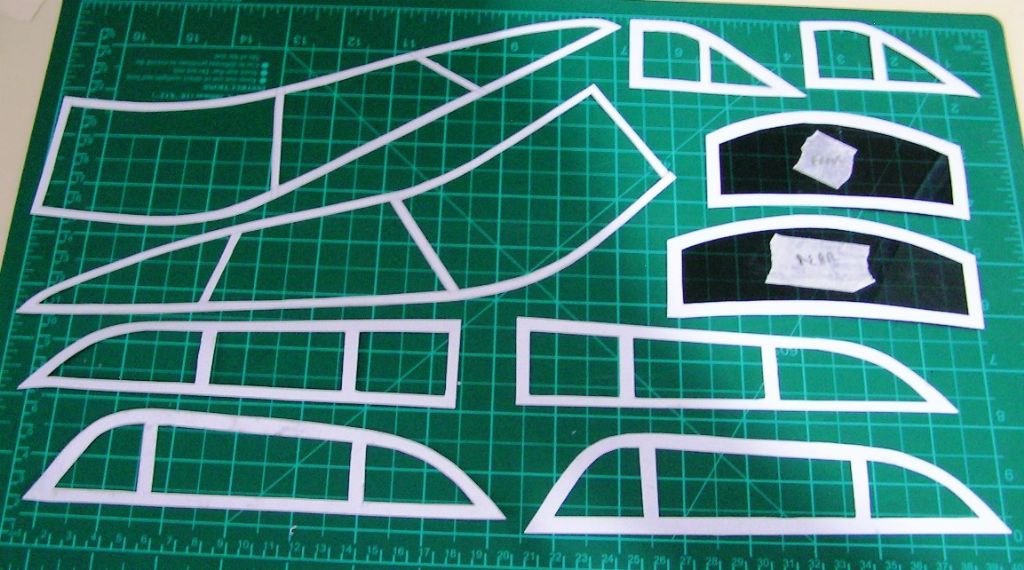

                            Hi Dave
                            The wreck that was not finished and a motor which had not been started in the boat !!!
                            I am working on the windscreen, but, as I think I require a former to get the shape.
                            The rear steps in the kit are rubbish, so I will redesign them.
                            The dash in the kit is non scale like, so that's been redesigned to look a bit more scale.
                            The last two days I made all the blacked-out windows, but, have not started on the white frames.
                            The original ones are thin plywood and have a few bits missing, so it's plastic card for these.
                            The forward hand rail is missing, but my go to guy said he will make it for me if I buy the stainless.
                            Lucky the air scoops were in the box of bits!!!
                            I got 20 white LED Christmas Fairy lights with battery holder and switch on 1.9 metres of cable from the cheap shop $2 AU.
                            I think that light up the interior at night.

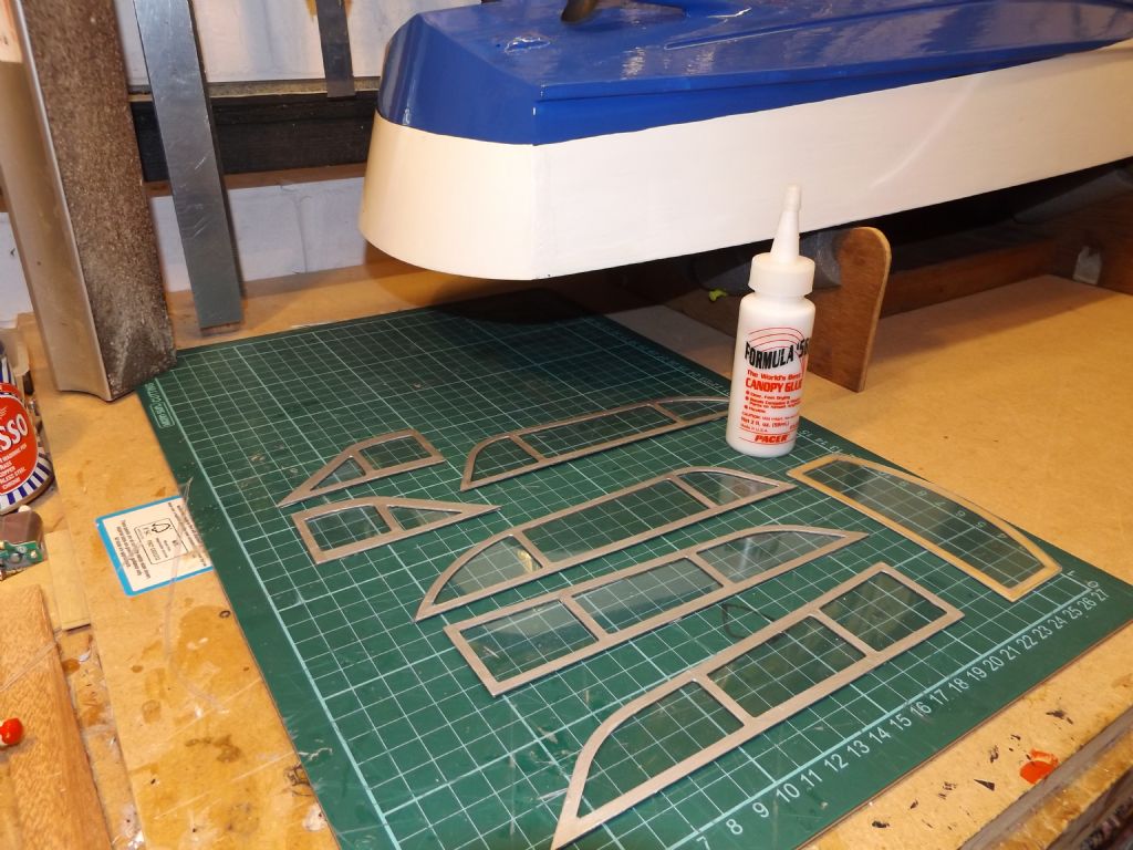

                            Harry
                            #73848

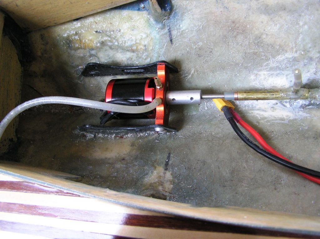

                              windows 3.jpgwindows 2.jpgwindows 1.jpgprop and rudder.jpgHi All
                              A few pics !!!!

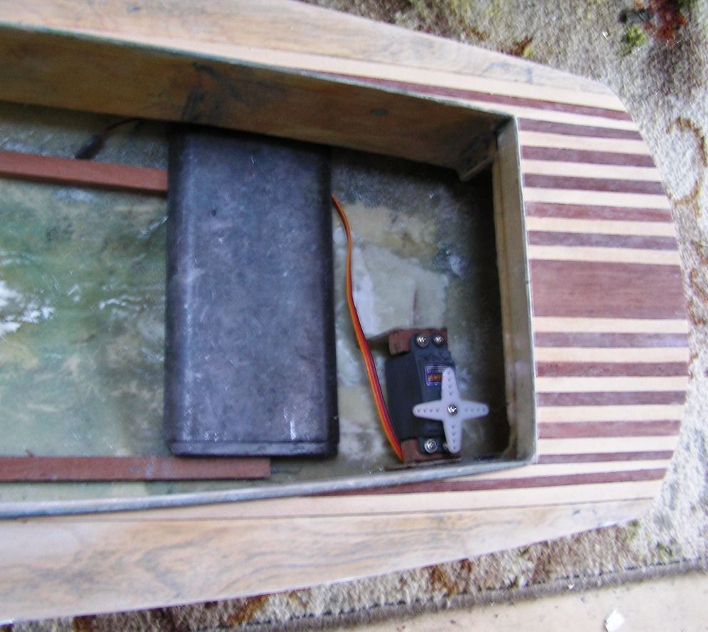

                              #73910
                                Hi All
                                Float test on the weekend and repositioned the battery.
                                The guys said to give it a run, so I ran it without the cabin.
                                Sits very well and turns very well both ways.
                                Only ran on 3S Lipo battery, but it was very quick.
                                In to making the windscreen.
                                A two piece one to start with and may make a one piece if I can find to right stuff.
                                Harry Smith
                                PS. IF Dave M trips down under he can have a free play with the boat( I will turn down the throttle for him).
                                All a head 1/3 sir!!!

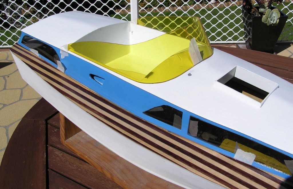

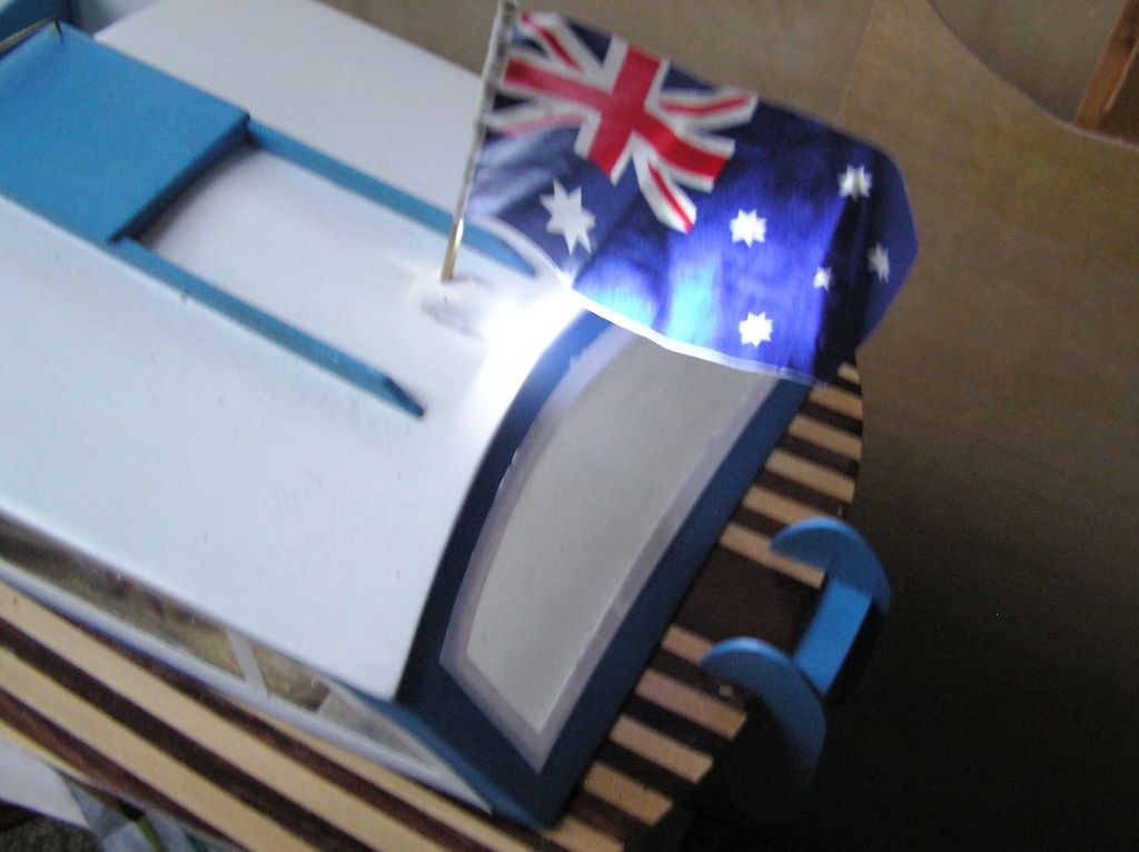

                                  #74061

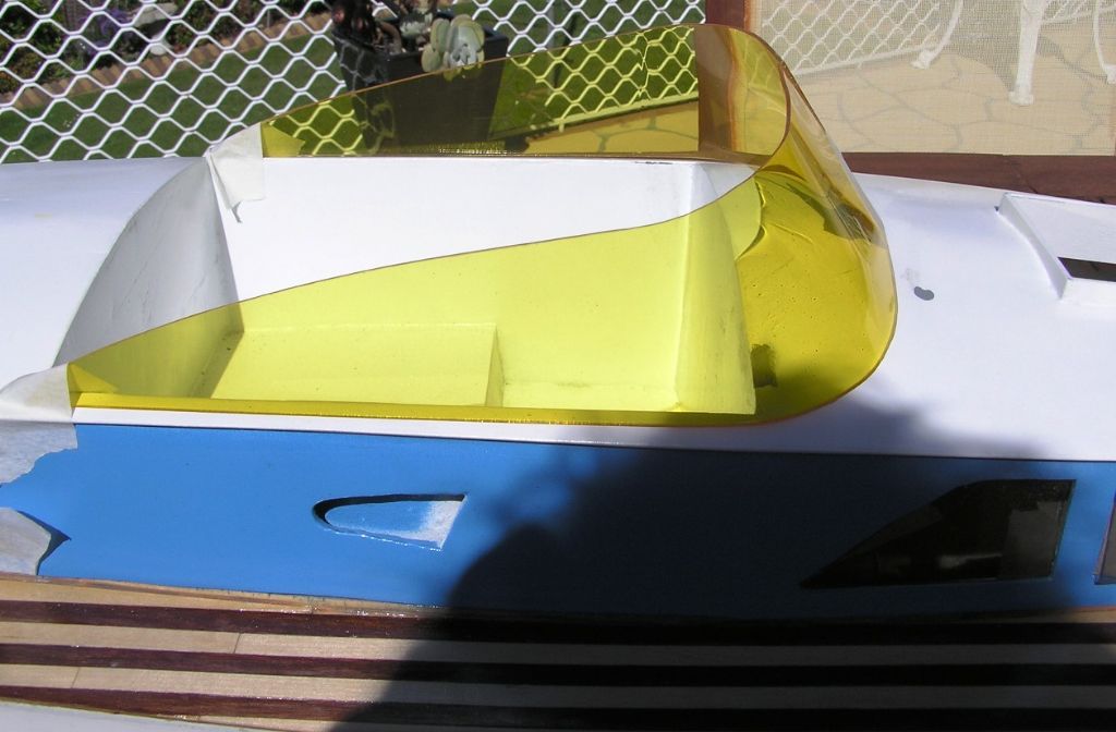

                                    main windscreen 5.jpgmain windscreen 4.jpgmain windscreen 3.jpgmain windscreen 2.jpgHi All
                                    Finally finished the mould for the windscreen which has taken a bit of time to get it right.
                                    Made the windscreen in two halves and looks pretty good sitting on the boat.
                                    The yellow tint looks great with the Heritage Blue from British Paints.
                                    #74146

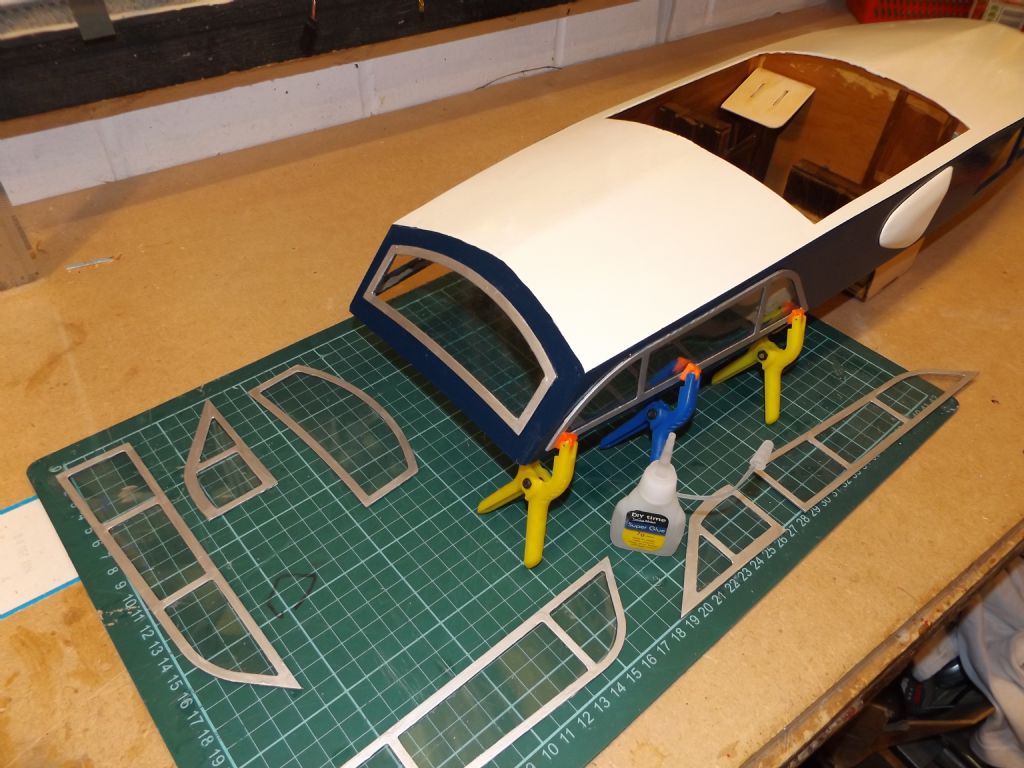

                                      HI All
                                      Make the window frames and windscreen frames today, oh what fun I have not cut this styrene plastic sheeting before!!!
                                      A number of hours later in 27 degrees of Tassie summer all finished !!!

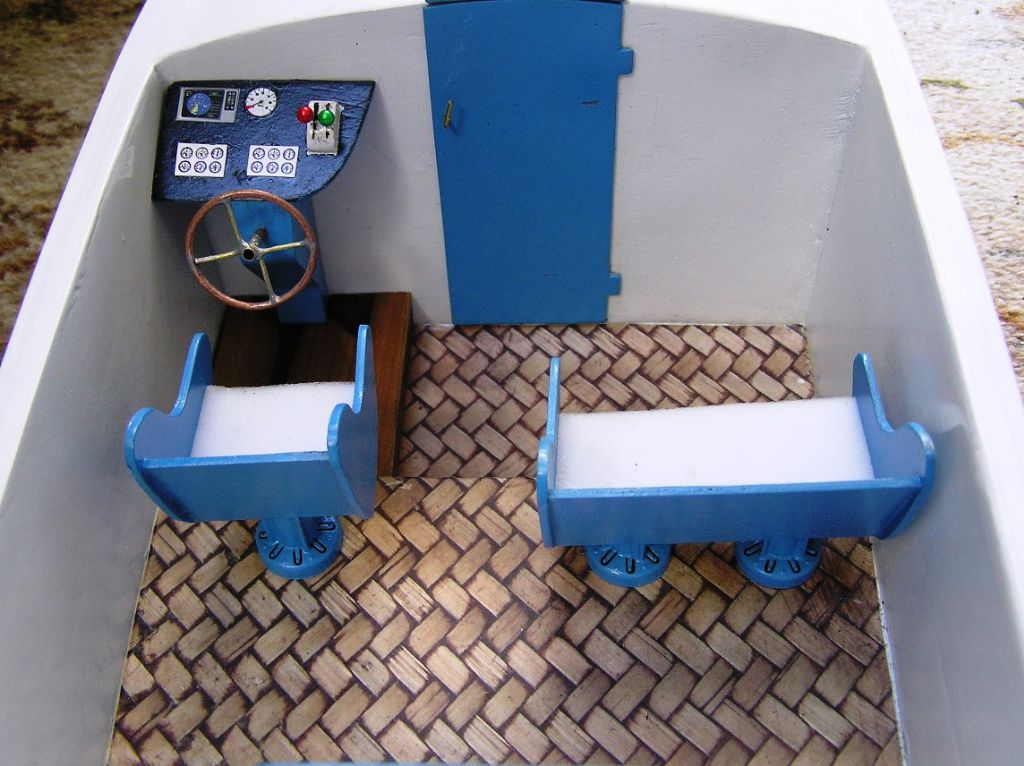

                                      #74562

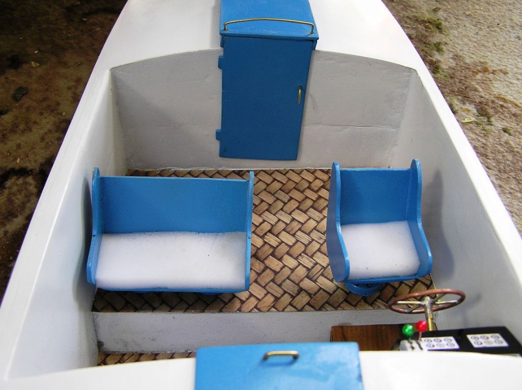

                                        cockpit aft view.jpgHi All
                                        A bit of work on the cockpit area, before installing the windscreen.
                                        Hand rails are made as well.
                                        #74568
                                        Noel
                                          @noel26080
                                          Looking great, is the floor a colour print of something?
                                          #74594
                                            Hi Noel
                                            Yes you are right, it's a colour print used in doll houses with a clear coat of vanish.
                                            Harry Smith

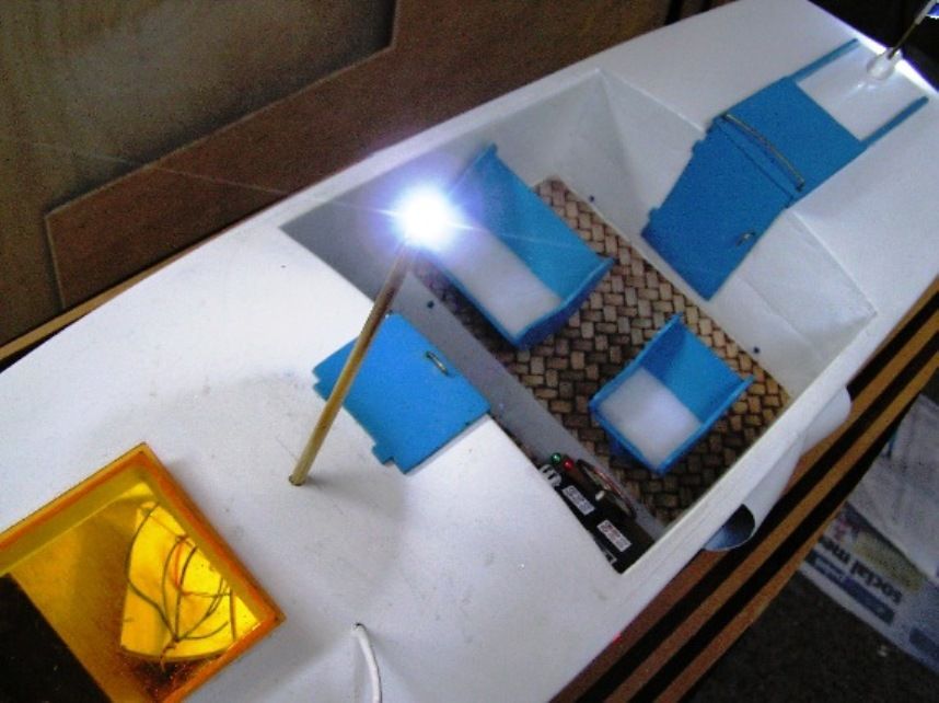

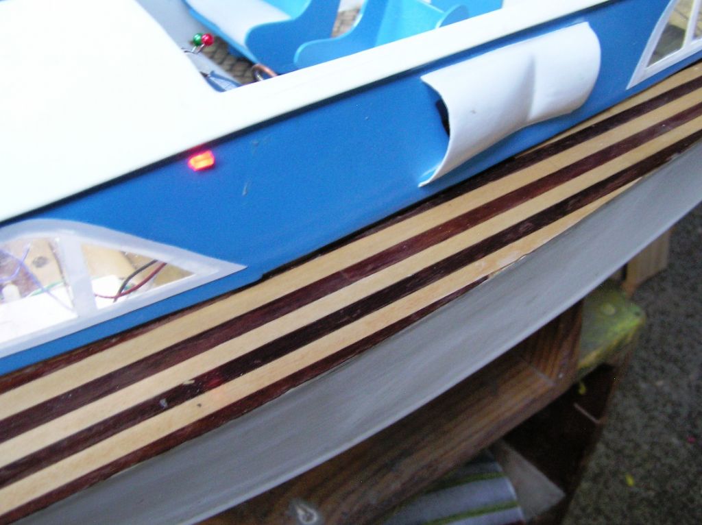

                                                #76177

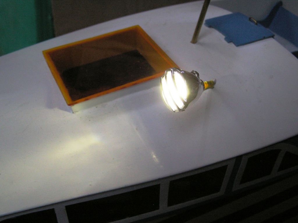

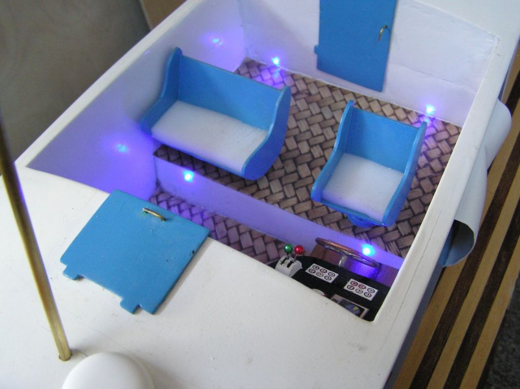

                                                  top view lights.jpgtop view lights.jpgsearchlight.jpgside scoop with light.jpgstern light.jpgHi All
                                                  I have been Fairey slow with my up dates on the boat.
                                                  I have Fairey cracking along with my light set up, also my go-to-mate made the side scoops.
                                                  These are my version of the Super Swordsman ones as the Precedent side scoops looked to small.
                                                  I modified channel five on my Turnigy IA6 from a variable pot to a six position switch from Banggood.
                                                  Position 1 HOME, 2 Wheelhouse lights, 3 Forward cabin, 4 Aft cabin, 5 Nav., Mast and Stern lights and 6 Searchlight.
                                                  As for the connection between cabin top and hull I used a computer LAN. cable and wall socket.
