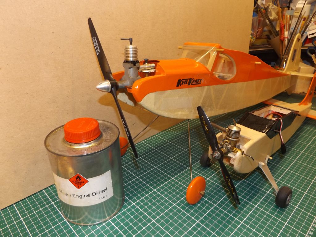

                    deisel mtb 71 nov 16 007.jpgHi John
                    Diesel's are lower revving than glo and have more torque, my old time Eaglet & Mini Tyro make a more sociable noise. I would keep the old radio installation in the boat (non functioning), it makes the boat interesting, MTB's are ten a penny even I'm making one

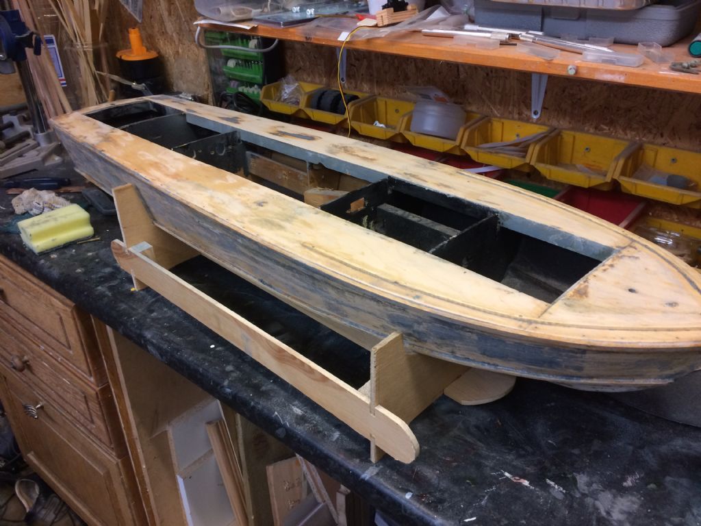

                              I will go to the Crewe Club lake and see if I can launch Smit and Scrappy there. I know a chap I sold a yacht I built to sails there so it would be nice to see that on the water as well.
                              The hull is getting there with the stripping back and I have left the water scoop in place as I will try and source a small pump and a smoke generator to use the water and engine exhausts at the stern.
                              Stripping the superstructure will be time consuming but it has to be done.
