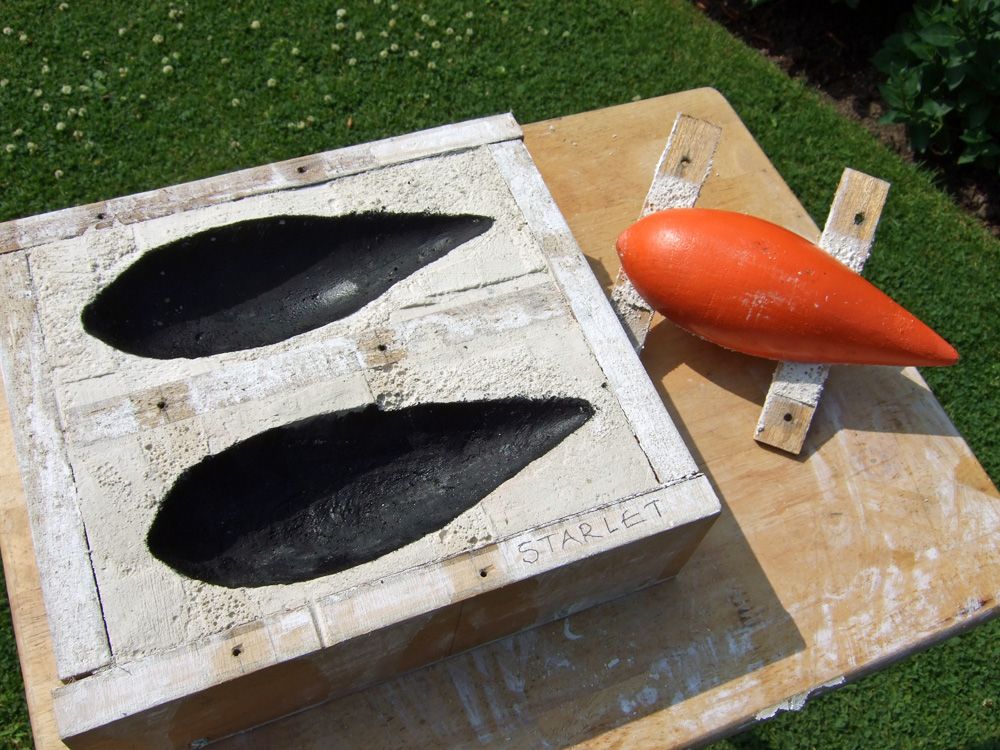

              Hi chaps
              Continuing with my personal nostalgic venture into my engineering past……With apologies for members who bored with it
              The moulds in the sand foundry were painted with Blackin` or Smut to seal the sand grains, so I have done the same with the keel mould, using water based acryic paint
              I realise I`m "Guilding the Lily" a bit, but this is my way of amusement and hope some of you will go along with it?

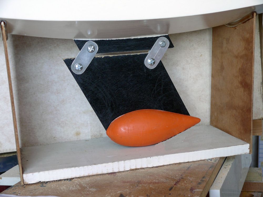

              #42245
                In order to gain access to the inside, I had to perform a little surgery………
                No harm done really, plenty of easy access to the gear and motor……What motor?
                The keel is glued into the hull and makes handling very awkward and will really get in the way with a 5lb ballast blob stuck on the end of it!
                Decided to make it detachabell

                  Hello Bob
                  I am happy to go along with you on this trip down memory lane…..and I do have a question….presuming that you are casting in the traditional way how are you going to achieve a perfectly sealed joint when you put the top half of the mould onto the lower half.
                  #42249
                    Hello Paul
                    No need for sealed joint
                    Just a gerneral clean up and bolt together, followed by good old P38!
                    It they turn out too heavy, then I could bolt them to a sturdy nut and bolt and face up in the lathe, which would be great fun?
                    #42250
                      I understand…..I thought that you were doing the keel in a single pour and not in two halves.
                      Lead in your lathe….that will be fun, all of that heavy and soft metal spinning at high speed.

                          #42263
                            Novel method of retaining the sawn off keel
                            Fully adjustable……..Might be handy?
