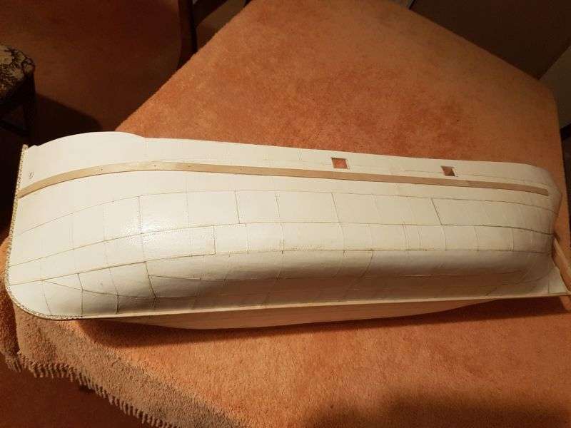

          Having another go at posting pictures on the new system. Using these as a test after getting it wrong yesterday.
          Jim.20231020_195131s20231020_195345s20231020_195408s

            Photos should be visible now. The intermittent moderation is a nuisance as there is no good reason for it and it has been flagged up as a problem with Mortons. Some people seem to be targeted more than others!
            When it happens I get sent an email warning that the post needs to be cleared but I’m not online 24/7 so it can sometimes be a while before I pick it up.
            The various stringent security procedures should be relaxed as the sites ‘bed in’. The priority over the last few days has been to deal with the ‘go live’ problems experienced.
            Plating effect looks very good!
            #112886
              Plating has come out very nicely.  If you can enhance the effect with the paint job it will look superb.

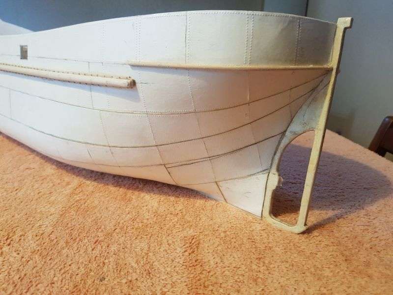

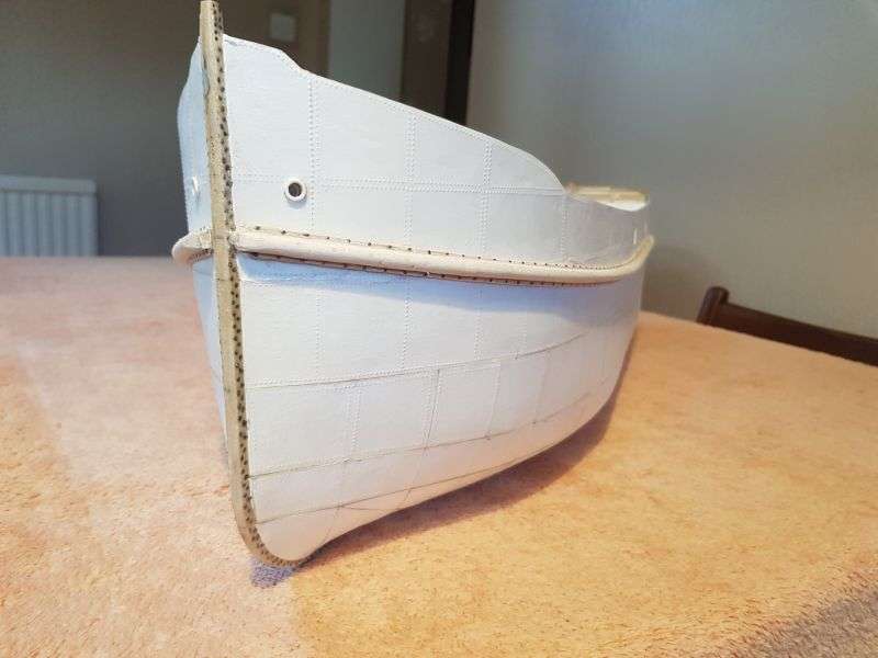

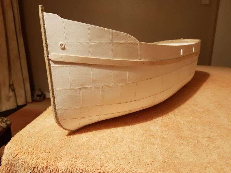

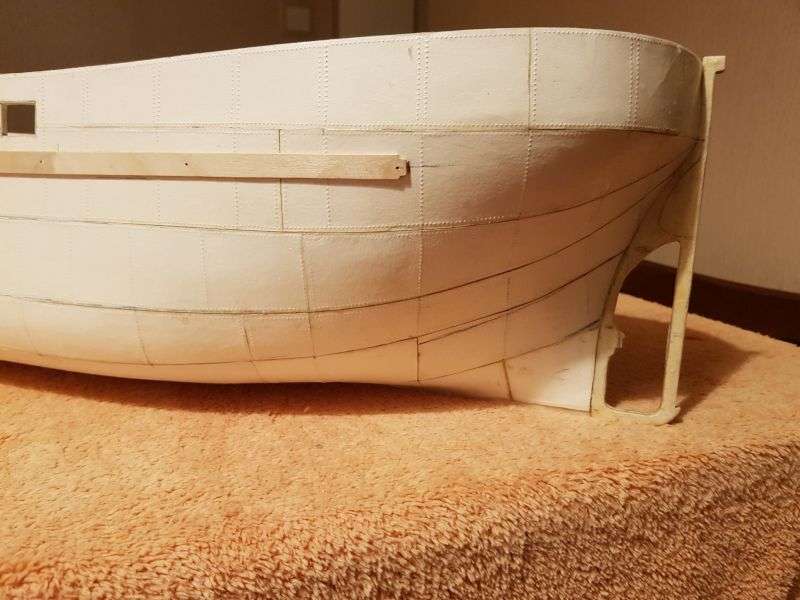

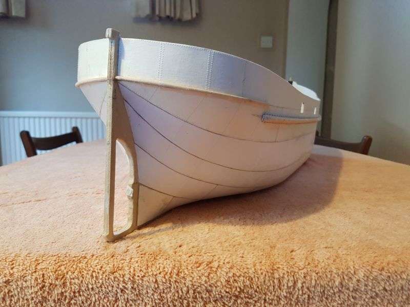

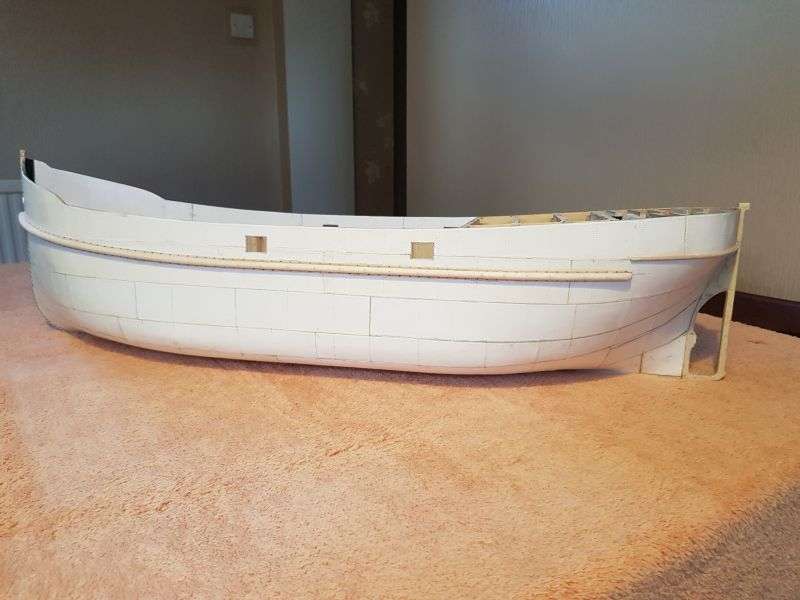

                  Managed to fit a few more bits, mainly the rubbing strips.
                  I had to cut the back of the dowel to help with the bending after sanding a flat on the surface to help with glueing and I`ve simulated the rivets using what they call ” Dimensional Fabric Paint. I just put a blob on some card, apply it using the point of a cocktail stick It comes out of the tube like a thick cream, but dries hard.
                  Next, I want to try and simulate the random plates that some of the photographs show ,where repairs appear to have been carried out at sometime. Hopefully this will give the hull a bit more of a well used appearance. I`ll see how it goes.
                  Jim.20231026_155621s20231026_155633s20231026_155720s20231026_155808s20231026_160052s

                    Excellent job Jim.
                    Len

                      Thanks Len.
                      I think it always helps if a bit of detail can be added now and again. It starts to bring things to life a bit. I have to say I`m enjoying your old school construction.

                        Now Ive almost completed the outside of the hull, Im tempted to paint the outside, just to see where there will be any blemishes or mistakes to rectify, and to see how much of the rivetting will show.
                        I only managed to find a water based black gloss ( in a small tin size ) so it could probably need two coats.
                        I was just curious to see what others would do when reaching the same point. I realise it`s a personel choice.
                        Jim.

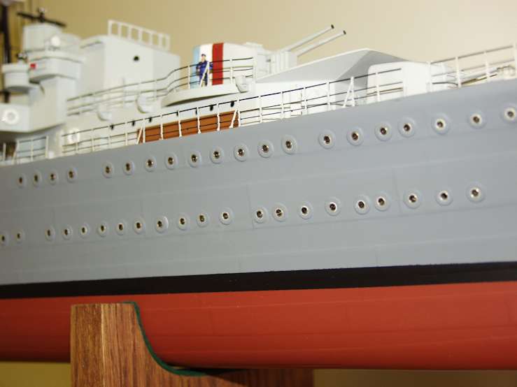

                              Always the best idea Jim.  I do test pieces for most things I do paint wise, not just to prove the finish is what I am after but also to check compatibility.  Sometimes the time between coats is very relevant as well and, if proven by the test piece, should be repeated in the actual work.  i.e. if you leave a base coat for a couple of days before applying the top coat on your test piece then repeat this timing when you do the actual paint job.
                              I’ve been convinced now for many years that some declared paint incompatibilities you see on line are as a result of not waiting long enough for all the volatiles from previous coats to have completely evaporated.  Not a guarantee but a point worth remembering.
                              And I’m with Colin, Halfords satin primers in black, grey and red are excellent paints and I’ve used them on many a model!  This is just one.  Please excuse the washers around the port holes I didn’t build it!

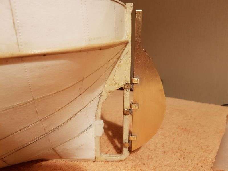

                                              My attempt at a rudder installation.
                                              The hinge points on the keel are a tight fit with a spot of araldite to help. When cured Im thinking of putting a small pin through just to make sure nothing moves. The top needs extending slightly to be able to fit some sort of tiller arm that Puffers seem to have. Once Im happy it`s all ok I can then start looking at connecting the chains to the rudder and the servo.
                                              The picture seems to have come out rather large for some reason.
                                              Jim.
