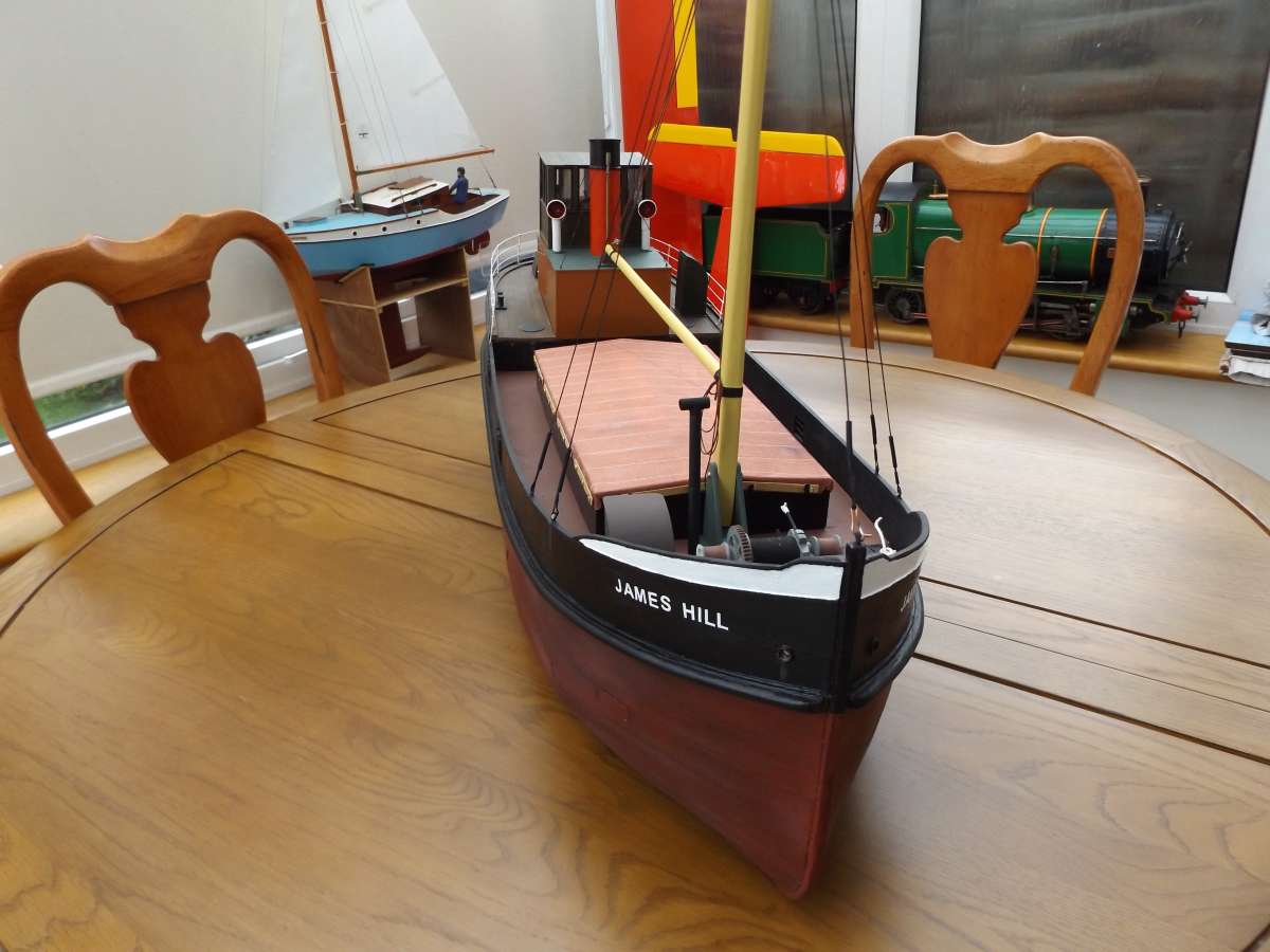

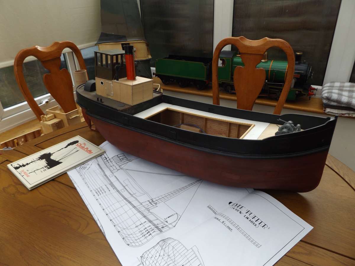

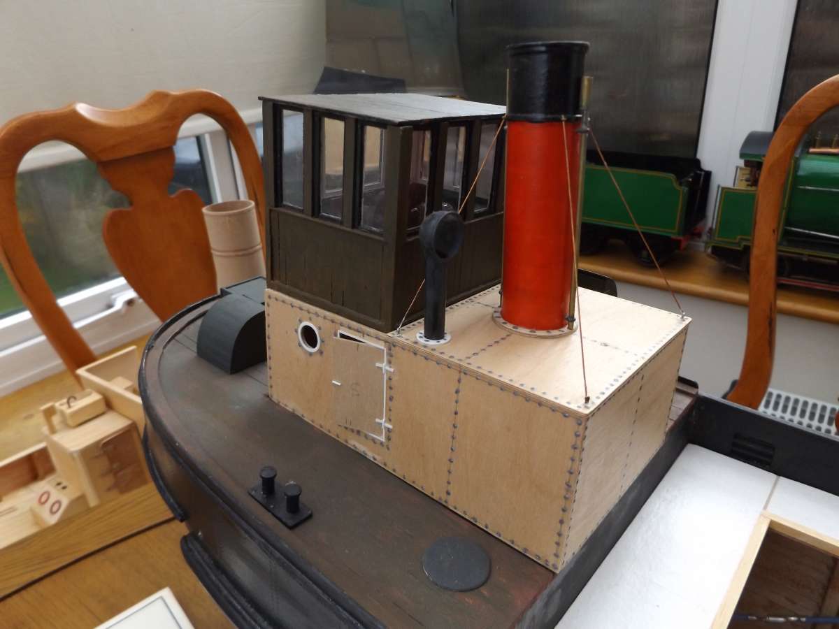

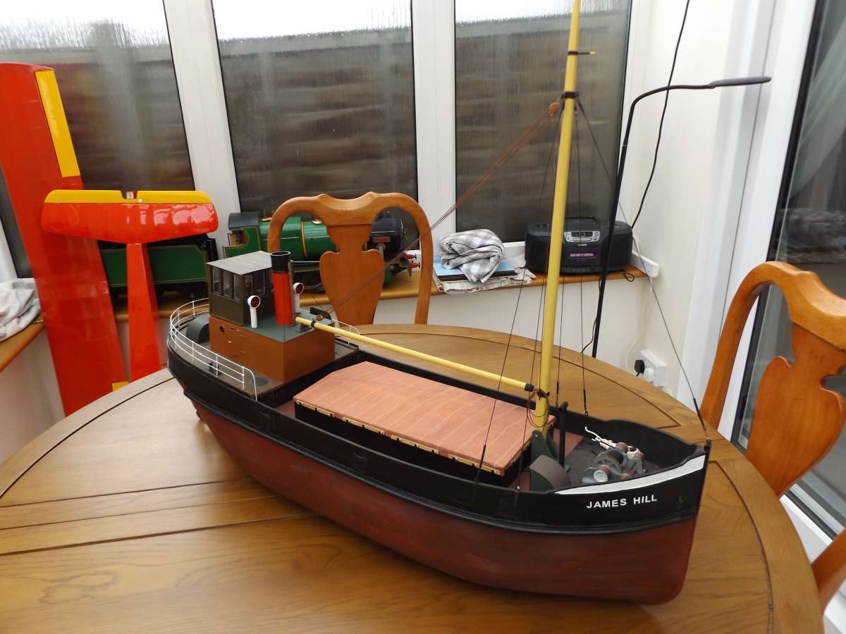

      Well done for making your own bits Stephen. I know when I’ve made bits in the past on other models, they may not look particularly accurate, but they serve the purpose.
      I made my funnel by rolling thin ply, after a good soaking in water, around various diameter bits, until I got down to the size I wanted, then glued the edges and glued re-inforcing strips inside. Like you, I will use small split pins to locate funnel pipework. I just need to find where you can obtain them from. I’ve painted a few bits , but I might change the colours a bit before things are finished.
      Looking forwars to seeing how you progress,
      Jim.

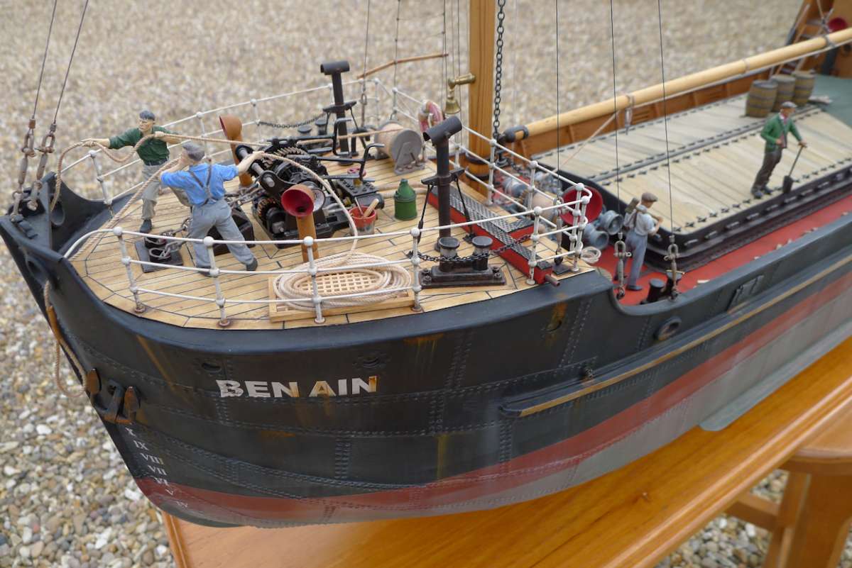

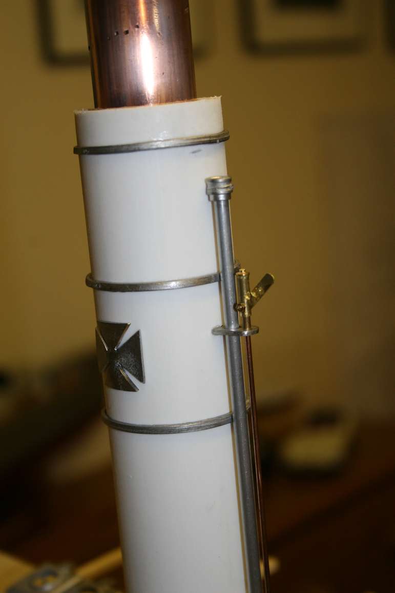

        I have a bag with various bits and pieces of chain in it, collected over the years.  This is not only useful for when I might need a piece of chain but it is also very handy for eyelets for rigging.  I have some chain that is simply a circular brass link so all I do when I want to put together a rigging anchor/bottlescrew/fixing etc. is to remove a link and fit it to whatever is appropriate.  I also have a good selection of eyes from various model suppliers that I simply fit into a drilled hole with a spot of glue as an anchoring point.
        Mountfleet do some very nice cast white metal padeyes but they are a bit soft if you want to put any sort of load on them.  I replaced the eye with a brass machined eye, to give more strength, the result you can see on the deck fitting.  The anchors on the gunwhale are just more of the same brass screwed eyes.  Funnel fittings again are from Mountfleet although I scratch built the whistle from scraps of brass.

          Thankyou for posting those pictures Richard. It’s always trying to get the small detail as near correct as possible that causes the most frustration I find.
          Your BEN AIN always amazes me when you look at the amount of detail you’ve managed to get on board.
          You have the advantage of having actually worked on ships and have seen that sort of detail close up whereas bog standard modellers like myself either search the web for bits or study pictures like yours.
