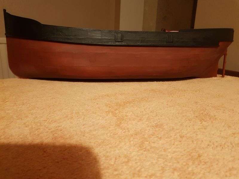

          Given the oxide coating a thin black wash to tone it down a bit. Might give it bit more weathering marks yet but I don’t want to over do it. I need to look at a few more coloured pictures to get some ideas.
          Jim.20240317_191315s

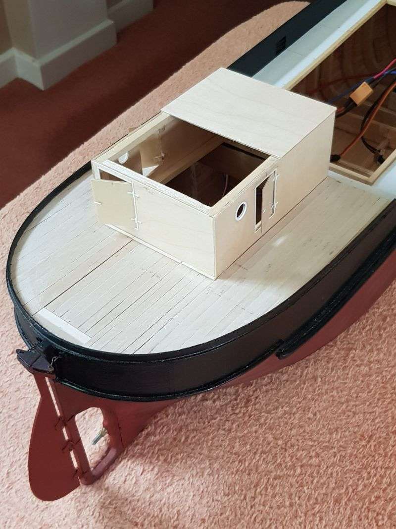

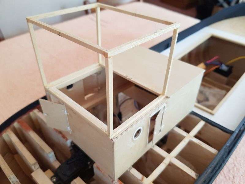

            Managed to get back on the Puffer again.
            The engine house been completed with the roof on and I’ve fitted open doors, just to make it look a bit different. I may add a bit more detail to the engine house as it looks a wee bit plain, although from some pictures, they were. There doesn’t seem to be a lot of rivetting showing ,so maybe they were a welded construction. The wheelhouse framework is on top, ready to be planked, but I’m going to plank the rear deck first. Nothing is glued down yet.
            Jim.20240417_151148s20240417_151202s20240417_151238s20240417_151328s

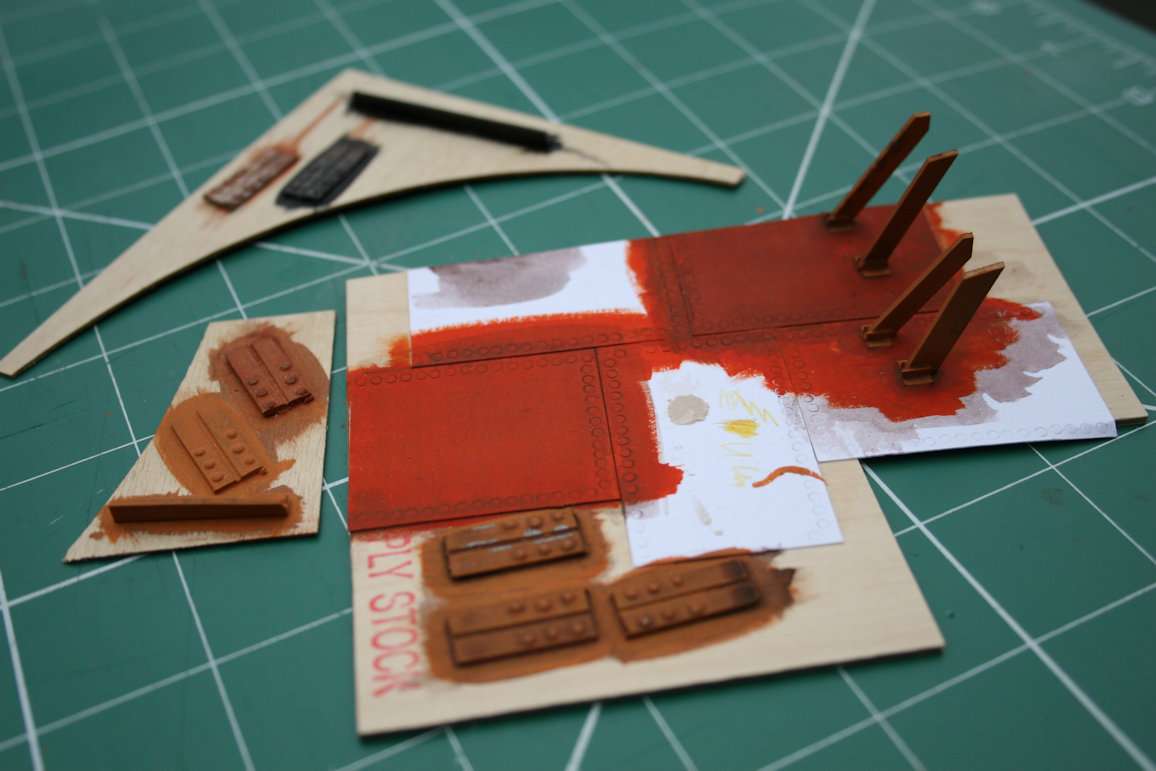

              Nice neat woodwork, you’ve given yourself a stout framework on which you can now plank.  The wash makes a big difference to the hull.  Just tones the solid colour down a bit and adds a bit of tonal difference to make it more interesting.
              I would definitely advise creating a test piece.  Get yourself a reasonable sized piece of ply, prime it and then paint it with exactly the same paints that you have painted your hull.  You can then use that to try out any other weathering processes that you might be considering.  Far better to make a mess of a scrap of ply than your pride and joy.  Only when you produce something you are really pleased with can you then try it on the model.
              These are the type of things I do with specific things such as gunwhale stays etc.  For a hull side you might want a bigger peice.

                Thanks Richard,
                I’ve noted what you did on your coaster build, plus, like you, it helps having done some weathering on locos that I have. Something to look forward to eventually.

                      Nice job Jim.  Wonder about water getting in through your open doors.
                      Len

                        Hopefully not Len, but if it’s a problem in the future, it’ll need looking at again.
                        Everything above the decking will be made to be removable, so if the open doors don’t work it shouldn’t be too difficult to put right.

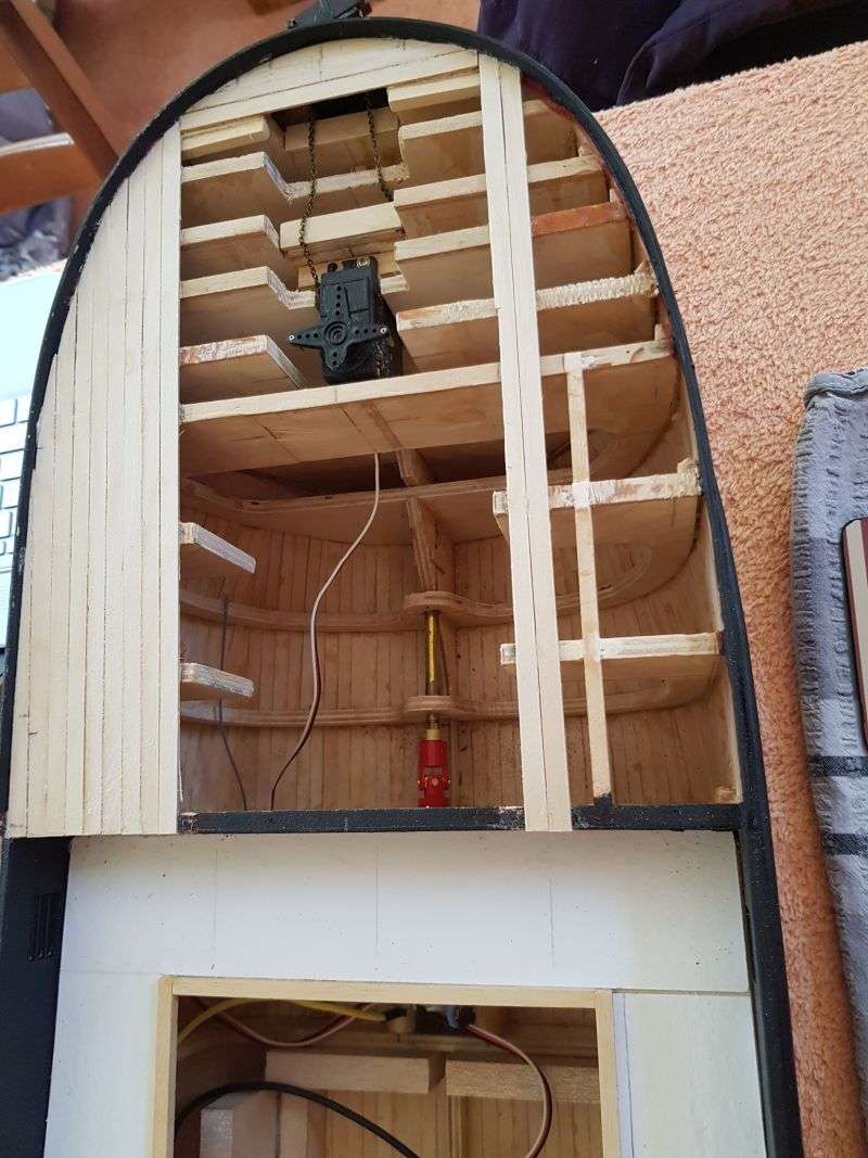

                          I started to plank the rear deck, but after getting this far, realised I’d made a couple of stupid basic errors. I’ve no idea why, other than not concentrating properly, so what’s already started is coming off, and then start again.It’s no good trying to get round an error, it would niggle forever.
                          So it’s planks away and clean up time.
                          Jim.20240508_125927s

                            Jim, just something to think about, not even a suggestion.
                            If you plank directly onto the edges of the frames like you have then the individual planks could lack strength.  Movement with age could lead to joints opening up and there is a possibility that you might not have a perfect glued joint around every plank edge.  Also the strength is only in line with the grain.
                            I would cover the deck first with a piece of ply, it doesn’t need to be thick, which will tie all the frames together to give a stronger structure, in two different directions, before adding the planking on top of the ply.  This will provide a much better sealed surface and a much stronger structure.
                            Just food for thought, it would be interesting to hear other opinions.

                              might also make removing the deck easier if the ply wan’t glued, but just fitted in place?
                              complete noob so please ignore!

                                Your suggestoion makes sense Richard. I’m using a thinner ply this time so another thin layer would help. Not something I had considered before, so thanks for that.
                                MM. The centre section behind the engine house will need to be removable to access the rudder servo etc. so that needs thinking about.

                                  That’s exactly how I’ve done mine for exactly those reasons.

                                    On my Puffer I have a 10mm wide horseshoe shaped flange running around the stern bulwarks.  The deck screws to that.  Easily removable to leave the hull completely clear.   The planking, engine room and wheel house all fix to the deck.  Just found it made things a bit easier to work on clear of the hull.  On mine the wheelhouse roof lifts of and the floor comes out to give access to the servo and rudder chains for any quick lakeside adjustments.
                                    Len.

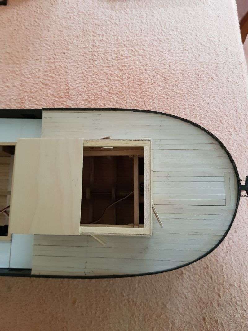

                                      Managed at last to get the rear deck planking done. It needs tidying up a bit before I sand and seal it.
                                      I took Richards advice and layed a thin sheet over the bulkheads and then planked over the top of that. On my plan, it shows a raised hatch between the engine house and the stern, so that will act as a way of lifting that piece out for access to the servo and rudder chains. I want to use some brass rod inside brass tubing to make location points for alignment. Once done, I can move on to planking and glazing the wheel house. After that, chimney and vents and assorted deck fittings and move slowly forward.
