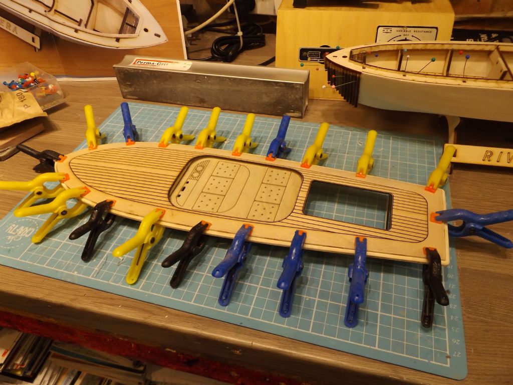

                                      Hi Phil,
                                      Yes if you can lay the warped subdeck onto a stout board covered by clingfilm to keep it flat and not to get glued down you should be able to pin the deck down over the sub bulkheads until the glue dries.
                                      The deck assembly relies on matching the hull and upstand coaming for being watertight, so it's worth checking how flat the top of the hull has turned out so they match.
                                      The Riviera launch I built on the same hull has a varnished wood deck as a feature so I had to use clips as per the attached as I didn't want loads of pin holes but your deck will be painted so easier to fill the pinriv 7.jpg holes. The whole design works and is well drafted and cut out kit but I doubt the designer ever built a model boat before OMHO !
                                      Hope that helps

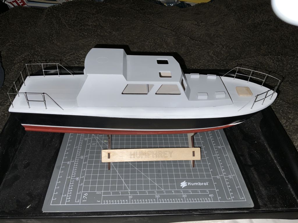

                                            #94548
                                            Philby
                                              @philby

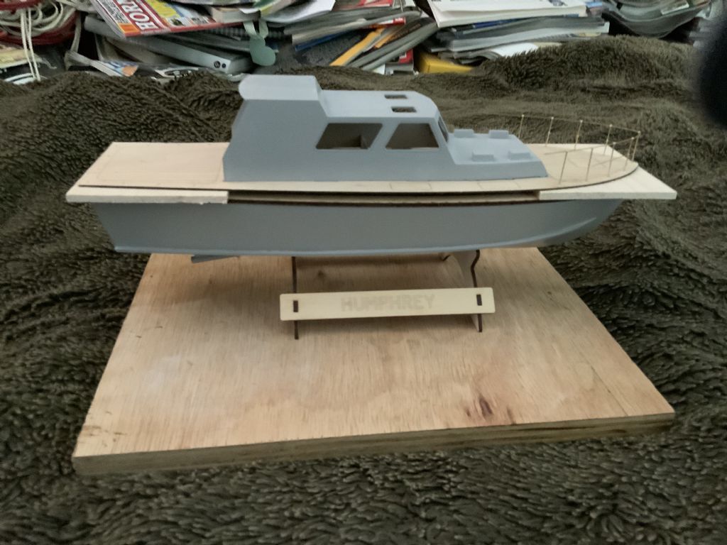

                                              So this is my boat at the present
                                              .6f4bcd8d-aadc-464f-98a8-a40208ccd609.jpeg.
                                              The problem that I am having is where the waterline should be located
                                              As the instructions do not indicate the location only have the pictures (see start of thread)
                                              question is how too find position of waterline
                                              TIA
                                              Phil
                                              #94550
                                                Phil. Position of the waterline is not as critical in a planing vessel as it is on a displacement hull, as the boat rises out the water when in motion by quite a bit.
                                                I would go with the picture, roughly….andestimate…you can’t go far wrong?
                                                #94689
                                                Philby
                                                  @philby
                                                  Ashley ''
                                                  so I went with the drawing,
                                                  and this is where I am with it at the present
                                                  Phil

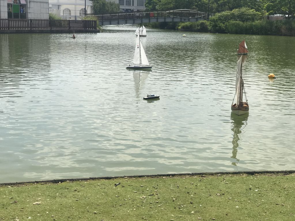

                                                  Philby
                                                    @philby

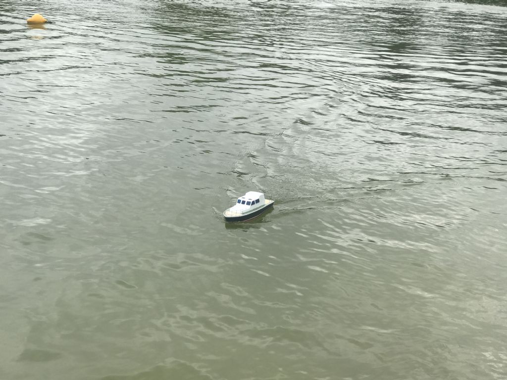

                                                    So a little bit more has been done to make it ready for a test on the water
                                                    Project not complete yet but it floats and the bow does plane
                                                    Two pictures taken while testing at Chantry Model Boat Club Bluewater
                                                    Phil
                                                    #97085
                                                      Hi Phil,
                                                      Your boat looks very good, glad to see it went well I think that your Police Boat & the MTB are the best superstructures for that hull design, but I'm still dubious of the deck coming off for access ! I don't think it was designed by a model boater !!
