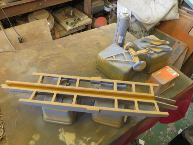

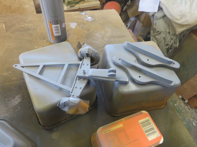

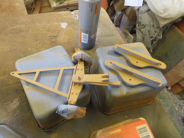

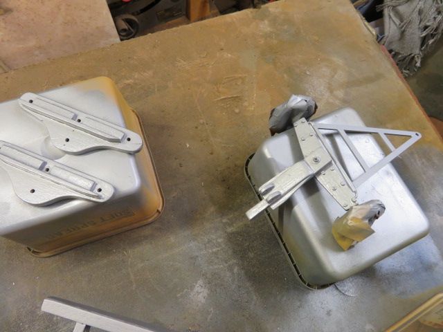

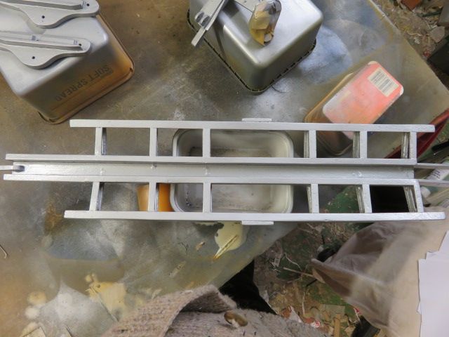

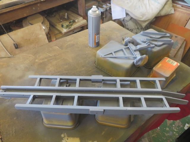

      back to the carriage….
      the 3 different coats have been added today starting this morning with the yellowish filler primer, and then after noon i put on the grey primer, and left to dry with a hot fan blower to warm up the workshop to a nice warm atmosphere before adding the topcoat of Hannerite hammered silver, which actually dries like galvanised steel……..
      however, unlike the halfords primers which in the warm atmosphere have dried within a couple of hours to repaint, i sprayed the Hammerite at around 18.00 hours, and have just checked it, and it is still slightly tacky,
      so will finish spraying the "B" side [underneath] tomorrow once the garrage has gained some warmth, and can then be left untouched for the day

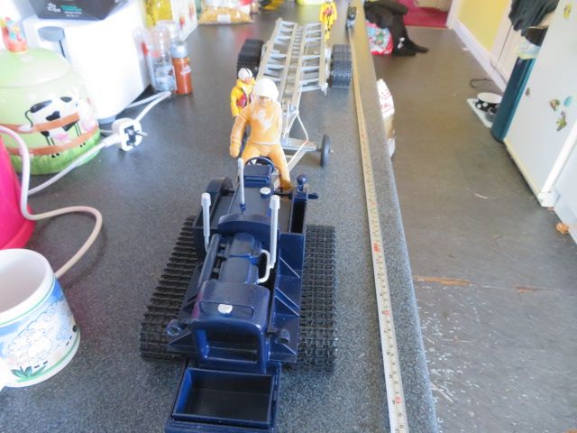

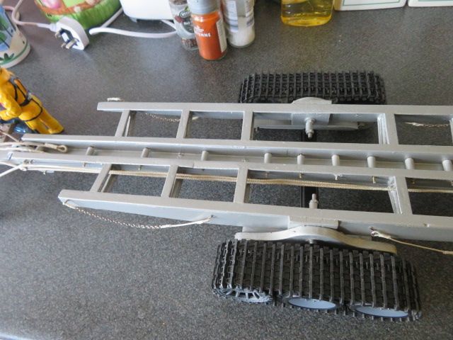

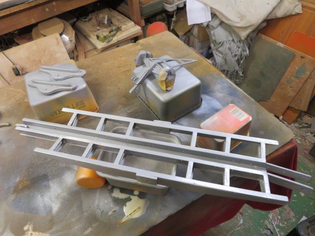

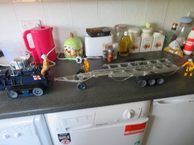

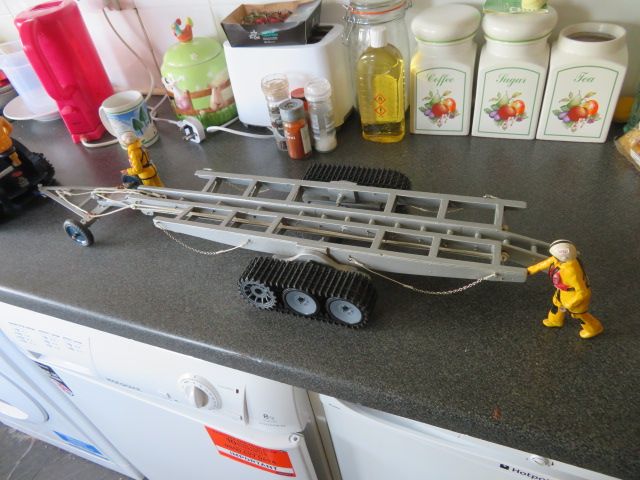

            ahhh, relief………now i can tidy up at home and tidy up in the workshop……..then get on with my Tyne……….
            for i have finally finished the carriage to attach to the tractor that pulls my new [ when i have built it] Metcalf Models Liverpool class lifeboat, to be named Edgar George Orlando and Eva Child whilst stationed at Blackpool.
            having never built such a model, i have really enjoyed the challenge, and dont think it looks too bad.

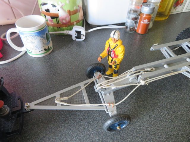

            All lines and strops have been added for both hauling and holding to the carriage whilst in transit from boat house to sea.
            hope you like it………..i do……….might not be 100% accurate, but looks the part from ten paces with a boat sat on top, lol…And before i started i didn't have an idea as to how long it actually is………48"…
            bigger than one of my lifeboats, as was………..no where to put it lol.

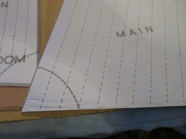

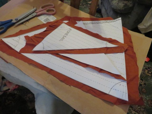

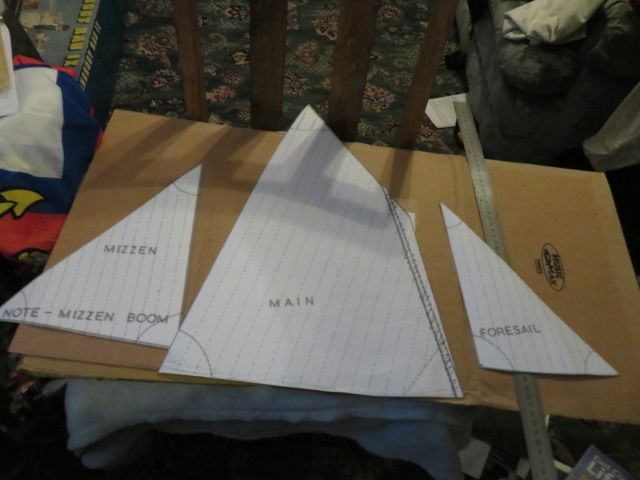

                          anoher job done whilst i get my workshop tidy during the day………..just made the templates complete with stitch markings for my 3 sails for the Liverpool class lifeboat, when it comes to being built.
                          my younger daughter is going to sew them for me…………………
                          no way am i going to go anywhere near a sewing machine………..bad enough with a swann morton scalpal, lol.
                          #98172
                            now been mounted on the dyed cotton that will eventually become the sails

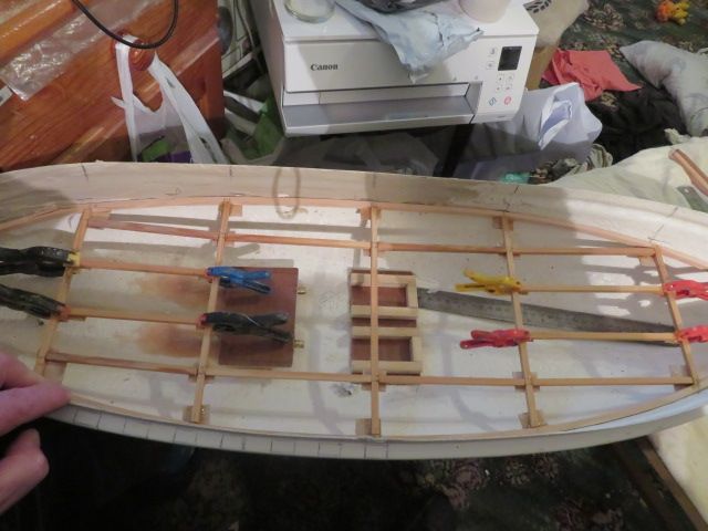

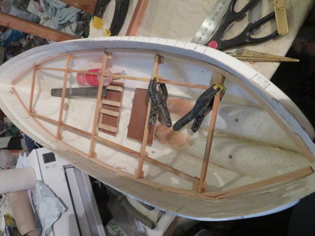

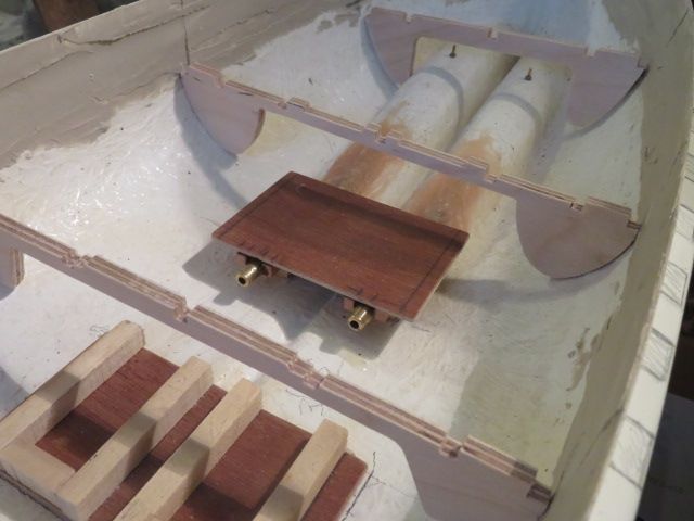

                              i just had a look at my buld blogg and cant believe that i havent posted on it since october..
                              things went a bit awry with the build in late October/early November and fell out of sorts with it, but not disinterested in it…..but my stupid mistakes were due to my arrogance and manhood in not reading the instructions that make the job easy for the builder.

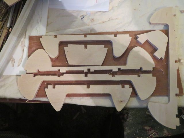

                              my big mistake was going ahead with making the support deck frames for the boat, and not realising that all those years ago i had actually made frames with cut outs for more support and drawn those to actual size and given to Dave to develope as lazer cut timber…
                              my stupidity at times knows no bounds……..and i ended up with a frame that, was totally unworkable with regards to the support of the deck. the picture below, was my original miserable attempt.

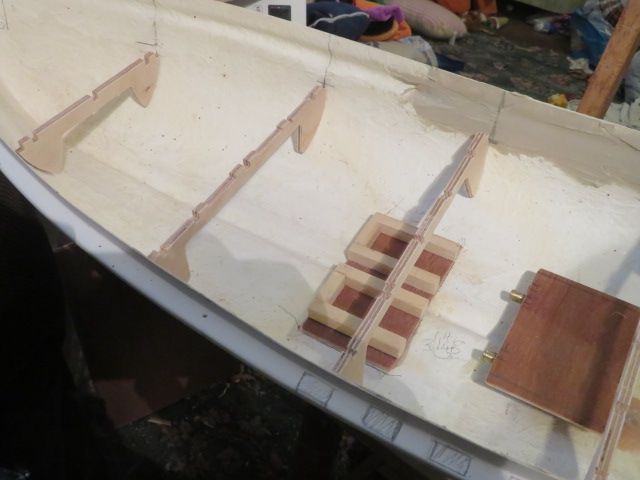

                              but then i discovered the proper cross frames by actually overcoming my fear of actually reading a set of instructions that Dave Metcalf had written to actually aid the builder…….and came up with the proper beams
                              and glued them into the hull at the specific measurements given IN THE INSTRUCTIONS, and reinforced them to the hull by using P40 glass strand impregnated filler to the joints between frames and hull. this was of course after removing all the wasted timber that i had used to make the useless frames.
                              #98906
                                on the previous photos, you can, on the aft end of the boat, the belting around the boats bulwaks has been marked with pencil lines. these pencil lines mark the possitions of 9 cut outs in the belting that all but 3/4 of the early twin motor Liverpools had.
                                the reason why these cut outs were not included in the moulding of the hulls is, that it would have been nigh on impossible to actually mould the hull with them in. And as most lifeboat modellers actually pretty precise in which boat they want to build, the choice for them is infinate, and as such when Dave Metcalf asked me to design this kit 17 years ago i asked him about such a matter, and told him that the initial 3/4 boats didn't have them, as did none of the single engined Liverpool boats that came first……so they were left off.
                                but as i am bilding this model as a specific boat, i decided to back fill the inside of the hull area which was to be cut out and filed with small files, and then drill and cut out the holes. Which i did.

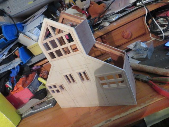

                                and it was here that i left the lifeboat as i realised i was running out of time to finish the candle lit house for my daughter, as she had started earlier this year started collecting the small tea light houses…………so i got on with that, and finished it a few days ago for her mystery christmas present.
                                the boat, i will get back to after all my christmas cheer has left me, lol.
