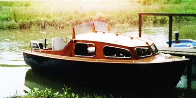

      I should really be building the Fairey Fisherman 27 motor sailer next but as has often happened I've been side-tracked by another Fairey!
      To be fair, it is a smaller and simpler build and I thought it would be a good introduction to plank on frame before I tackled the Fisherman. But of course I do have form for multiple builds! So who knows!
      The Faun is a little 16' 6" lake and river cruiser and utilized the hull from their Falcon sailing dinghy and was designed to be powered by an outboard motor. It does look plain and uninteresting as you can see but I'm aware of a nice inboard version with plenty of varnished hardwood which looks better (similar to the photo shown) so that's what I'm going to build. I was going to build the outboard version (to do something different after the stern-drive Huntress) but it's difficult finding a decent outboard at a scale of 1:12. I have bought a couple that may be suitable so maybe later.

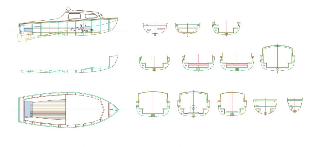

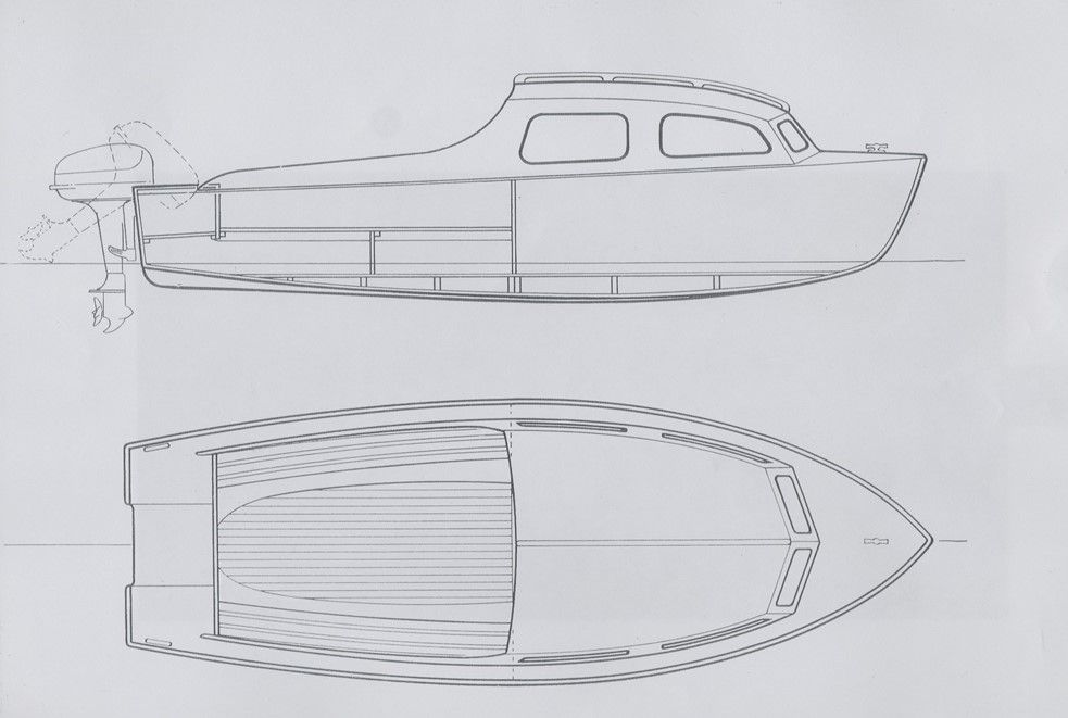

      I produced the drawings about 2 years ago from the side and top views taken from a brochure. But looking at them again before printing them out I've decided to make planking the deck and the build easier by following DM's example for his Huntress etc. by removing the sheer and camber from the deck, which in a small model isn't that noticeable anyway.
      So I'm now in the process of modifying the drawings in readiness for making a start.

                  Altering the drawings is more work that I thought, though I'm making some modifications as well. Progressing quite well though.

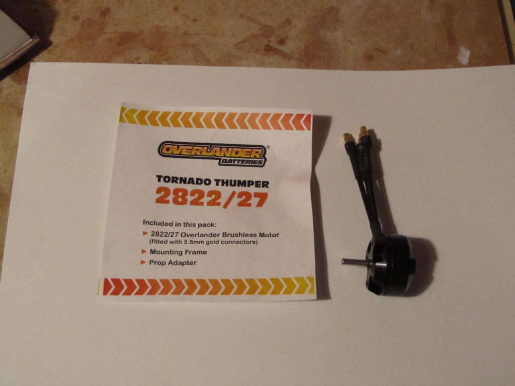

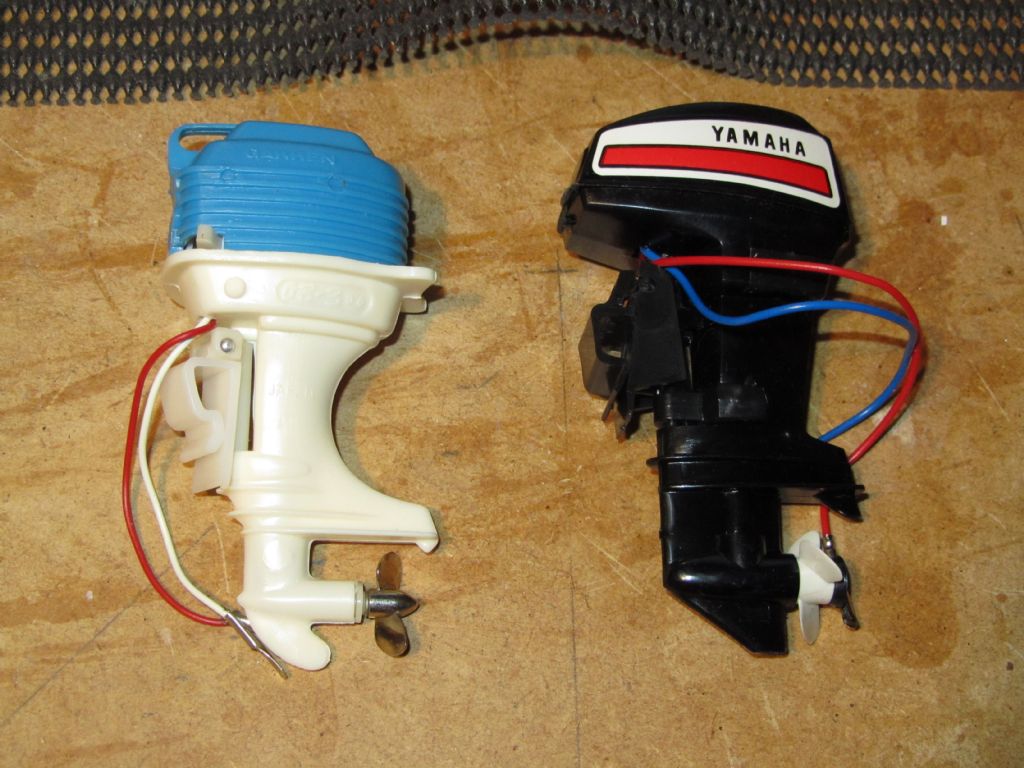

                  Here's the outboards I picked up which are about the right size. Might go down that route at some stage? They aren't the best quality though and would have to be modified to steer. Also fitting the steering mechanism isn't the easiest thing to do in a small model.

                    Been progressing the drawings on and off along with painting the other hulls. Made quite a few changes as I went along but I think I'm now ready to print off and then work out what I need in the way of timber.
                    As I mentioned on one of Ray's builds I'm going to plank with balsa, though I can use sheet adjacent to the keel, with balsa block(s) at the bow.
                    Looking forward to trying a new to me building method.
                    The motor is my usual Overlander brushless and it's titchy, so cute! Prop will be a brass 20mm three blade. Rudder will also be brass and is deeper than full-size, scalewise.
                    This is really about the build as it's not going to be the most exciting boat on the lake!

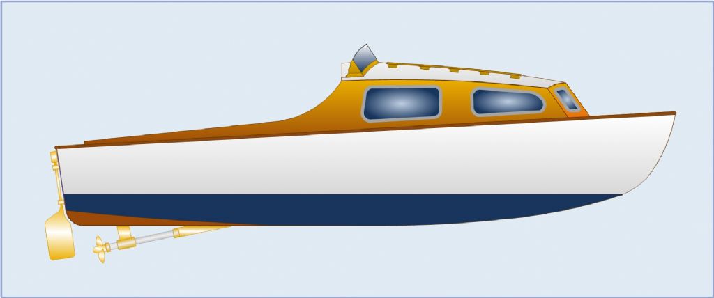

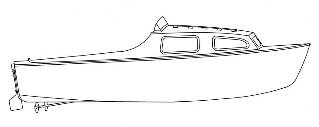

                          Finished off the drawing side of things with a coloured side view to show what I'm aiming for.

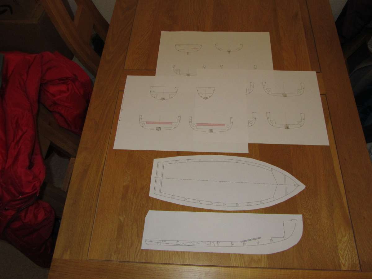

                            Printed off the drawings for the hull this morning. But that was it as went to the pub for lunch!
                            IMG_7014

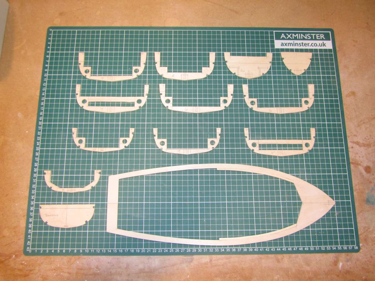

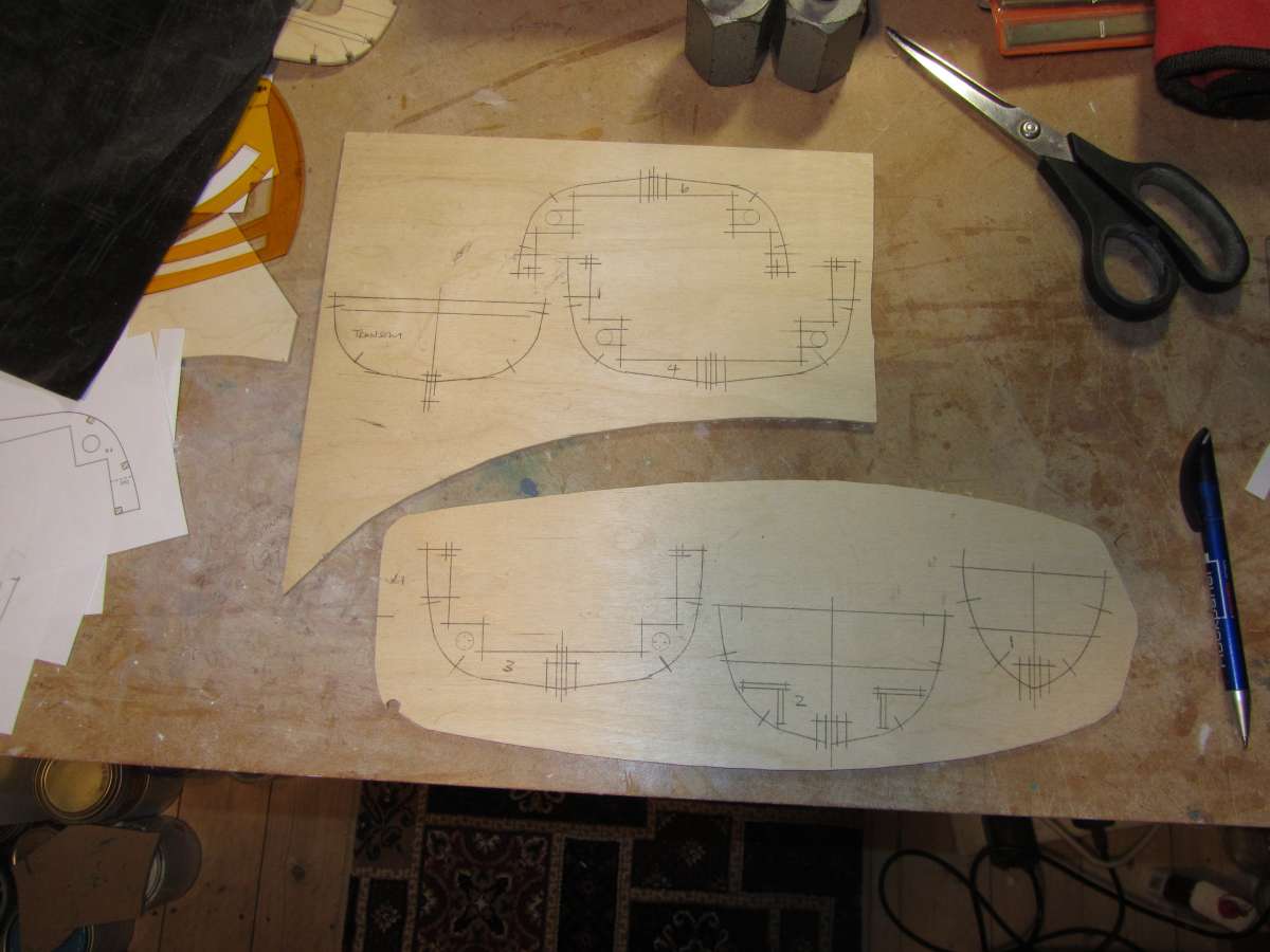

                                  Cut out all of the frames and gave them a sanding. Just got the keel to cut out and drill for the prop shaft and I’ll be ready to start assembly.
                                  I know some don’t like it but I like building hulls! Well, when they’re my own design and seeing how they tun out, probably not so much so if they were kits.

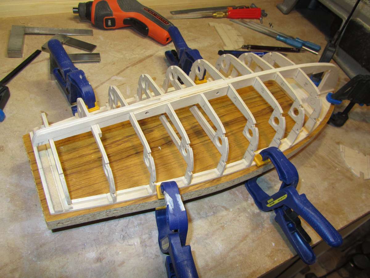

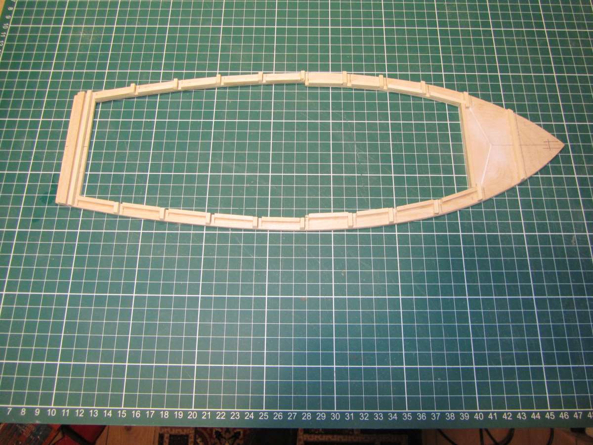

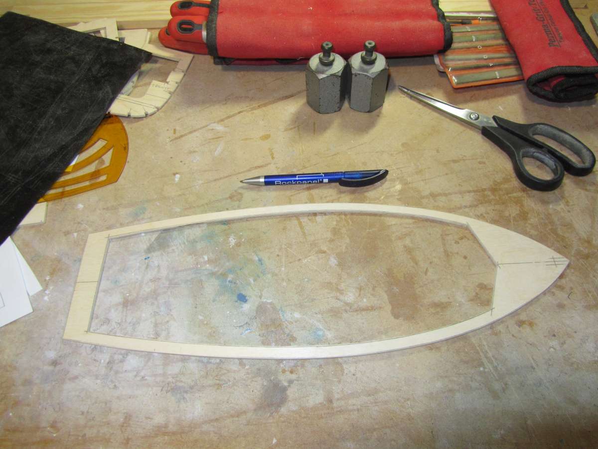

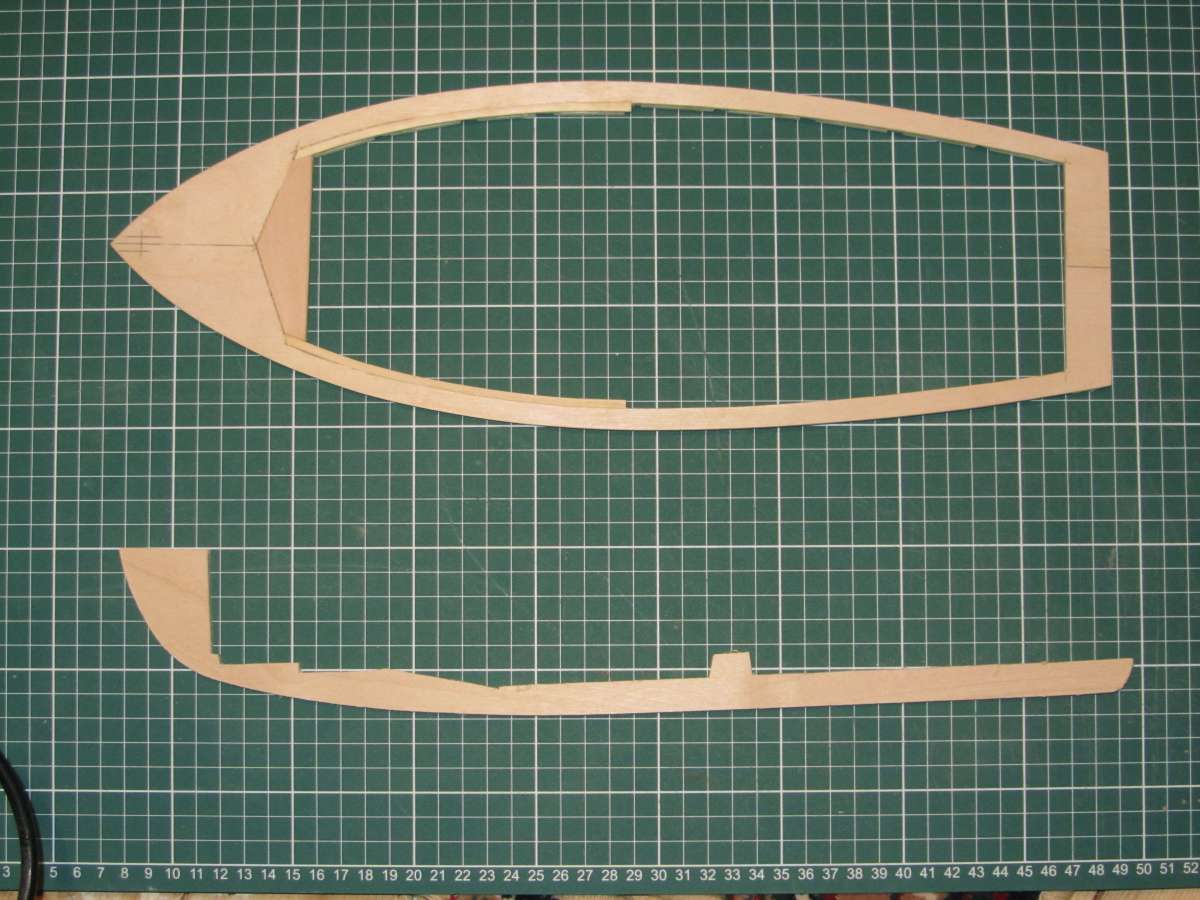

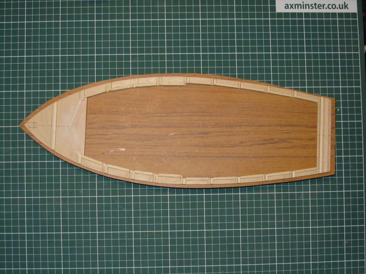

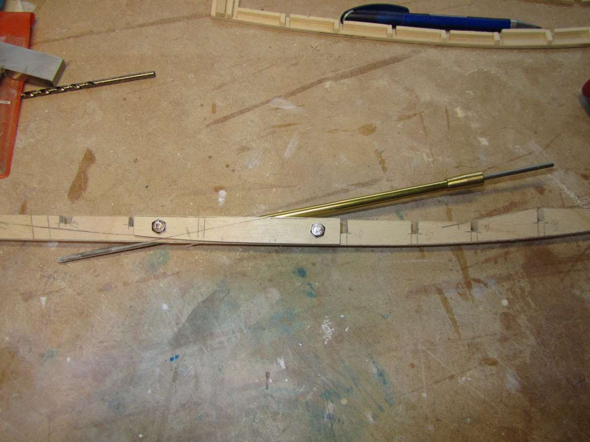

                                          Cut the keel out, which needs finishing off and drilling/fitting doublers for the prop shaft and fitting stringers etc. The Faun is being built in the same way as the Huntress i.e. upside down off the deck and so time was spent on the fiddley job of gluing small strips of bass to the underside for locating the frames and providing additional gluing area.

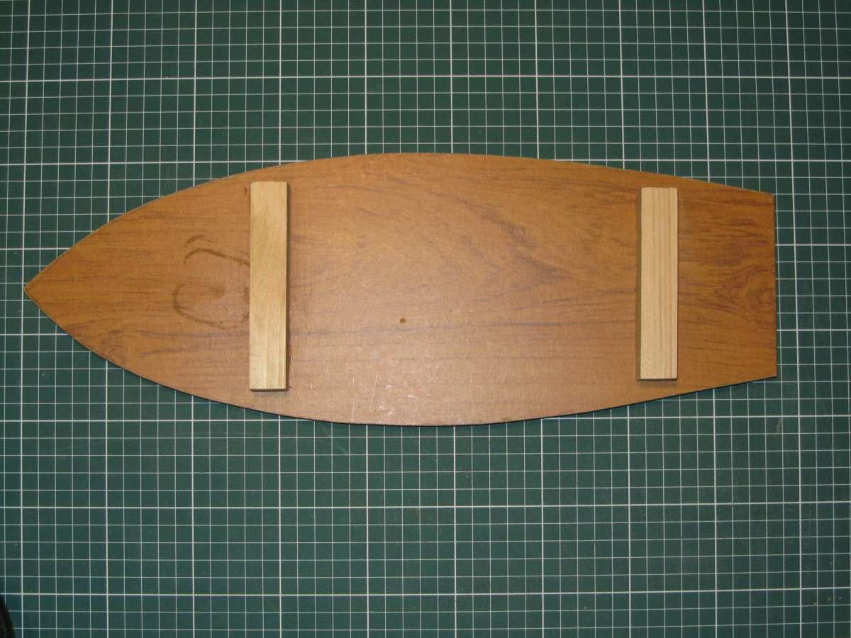

                                          The eagle eyed will notice that I’ve modified the deck a bit. As well as adding strips along part of the length to the inside edge, as the deck was too narrow taking the thickness of the cabin sides into account, I’ve also added a piece to the front to make things easier. This is the problem if you leave a project for too long sometimes as you lose your thread and despite studying the drawings I missed that the side decks were too narrow. I’m also making other modifications as I go along but I do that anyway as part of my build process. I did think about cutting out a new deck, but having sanded it thought I’d go the mod route – the top is going to be covered anyway.
                                          As per the Huntress I then cut out a small baseboard and glued spacers to the bottom for clamping the deck down. Photo shows the Huntress – the work top looked new there!

                                            Hi Chris,
                                            A very good idea to use a stout base board to hold the deck flat, a few years back I built a review model for Graham Ashby at J. Perkins a 16″ Riviera launch it was a little horror the sheeting on the hull wanted the deck to look like a whale back MTB  🙂
                                            That’s why I generally build inverted on extended frames, as most boats don’t actually have flat decks !!
                                            #123924
                                              Yeah, it’s only the Huntress, River Cruiser and now the Faun that I’m building with flat decks and as regards the Huntress and River Cruiser I followed Dave’s method on that. The bow etc. on the Huntsman 28 is the same as the Huntress/RC and I put some camber on that so I could have introduced some. Bow on the Faun is pretty small though so hardly worth the effort.
                                              #123968

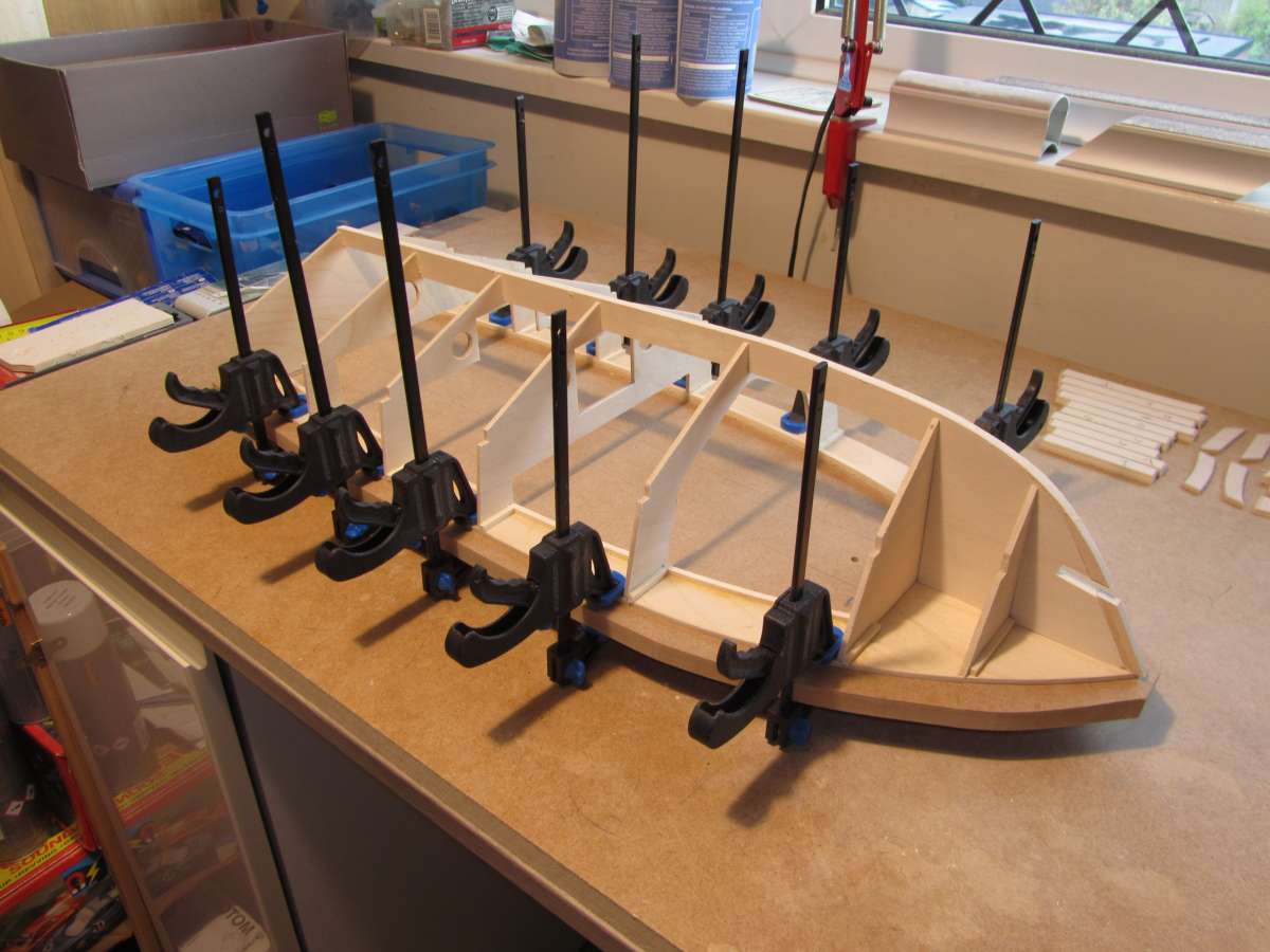

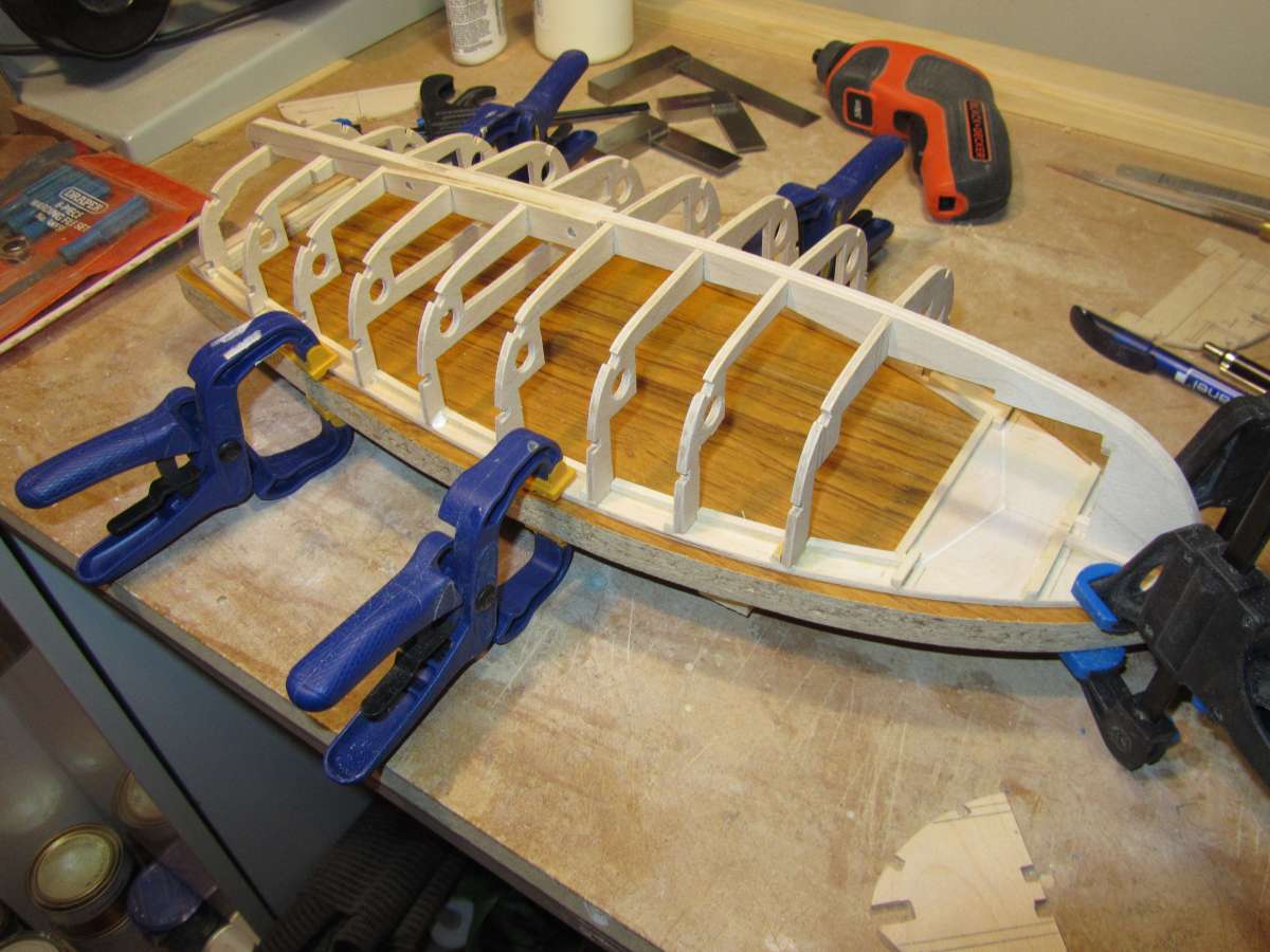

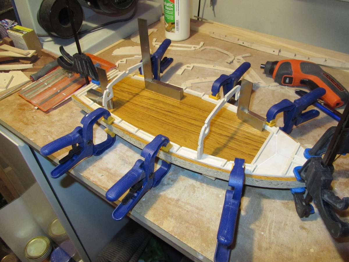

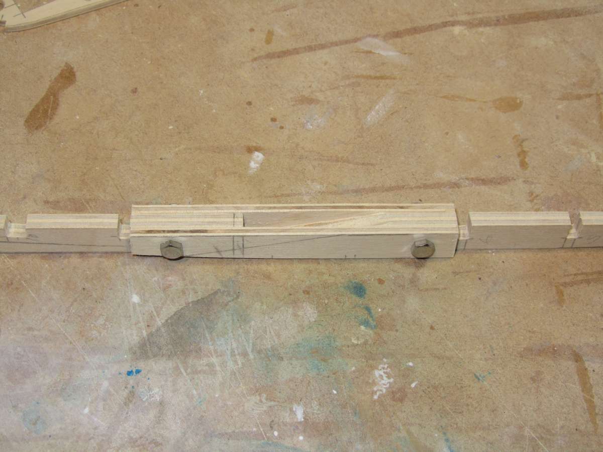

                                                Been away for a couple of days so work had to stop. Did a bit before I went though cutting and filing the notches in the keel and frames where they both fitted together. Also cut out the doublers and bolted them to the keel in readiness for drilling for the prop shaft.
                                                Today I started drilling (using the new Dremel toy) but had trouble getting even my smallest power drill in and so a change of plan and decided to cut it out with the scroll saw instead – hence why the doublers were bolted incase removal was needed. Then I drilled through from the bottom for the prop shaft. Once this was done I glued the doublers in place using the bolts as a guide and for clamping.
                                                I then did a trial fit of the keel and frames onto the deck and finished off by gluing a couple of frames into place.

                                                  Most of the frames glued in position to the deck now and is really taking shape. Will cut out and fix the base for the motor mount before gluing the keel in.
                                                  Might cut down the prop shaft and glue that in as well beforehand though it’s the one I bought for the Fisherman so I’m going to have to order another one whatever.
