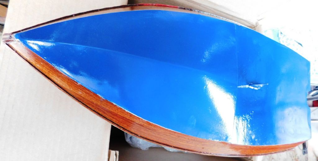

      spitfire 18.jpgHi All
      Finally painted the hull bottom after hours of sanding down the bottom.

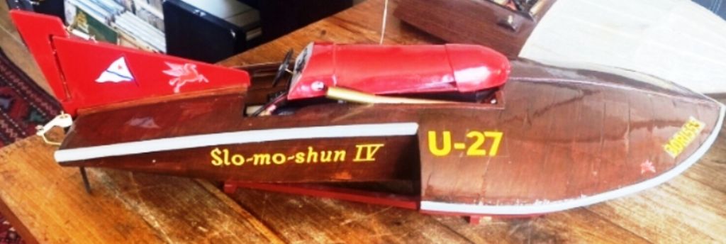

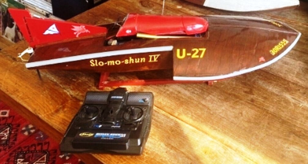

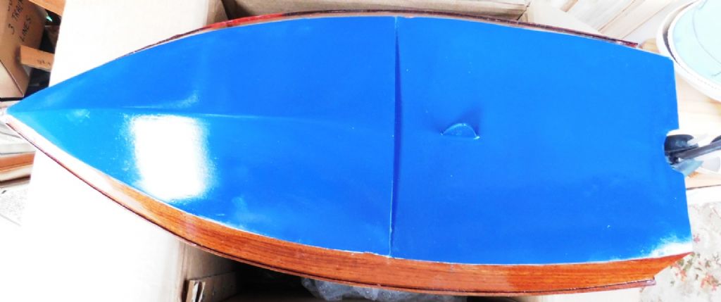

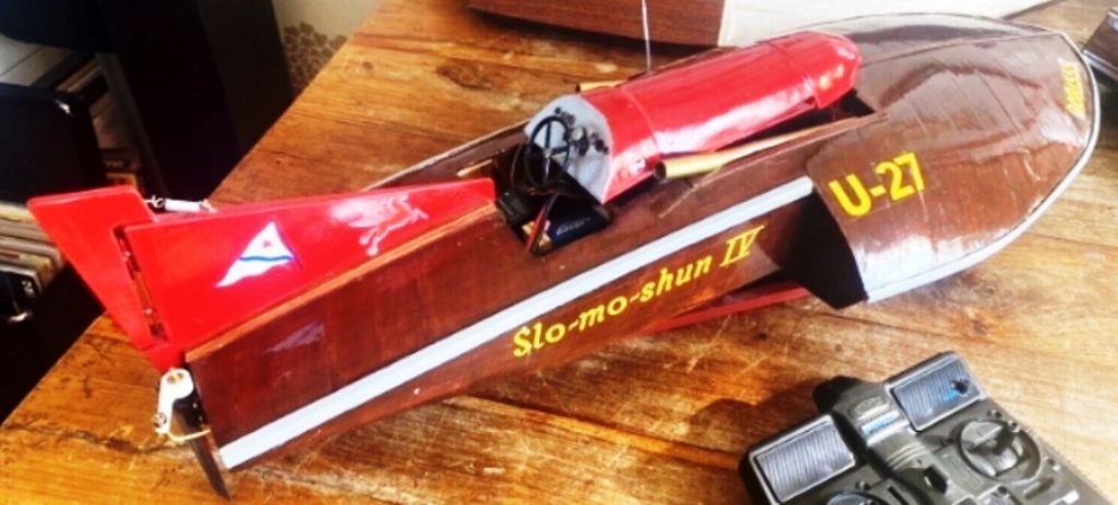

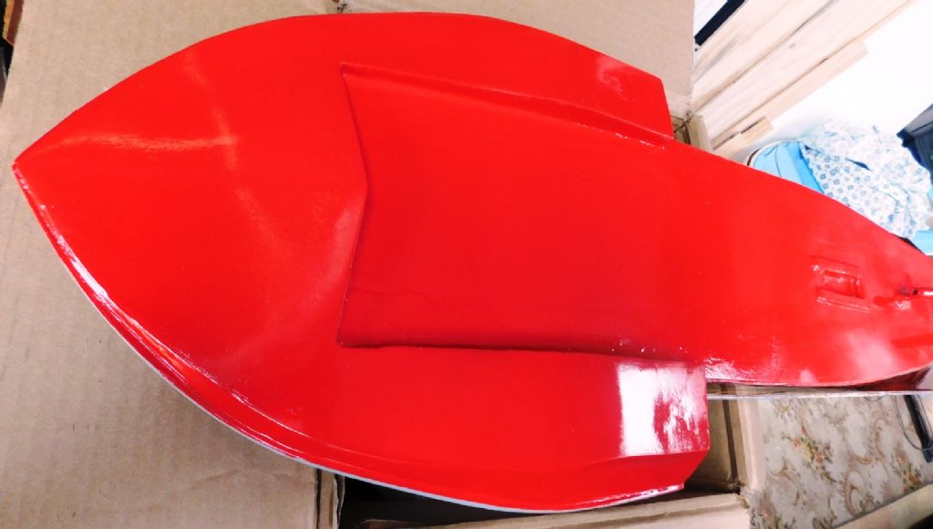

            smo 1.jpgsmo 3.jpgsmo 4.jpgsmo 5.jpgsmo 7.jpgHi Lads
            Been working on the Slo Mo Shun 4 which was OK on the top sides, but the bottom is not.
            A lot of fibre glass mainly around the step area.
            Finally got it painted.

              Nice job Harry……BUT….
              4 coats is a good primer for the veneer, when are you going to apply the next 10 coats to finish it?????
              Pictures of slo mo going fast, as and when please.
              #102615
                Hi Ashley
                The paint tin has 2/3 coats required.
                I sanded down with wet and dry sandpaper after the third coat.
                Added the fourth coat !!!
                Harry

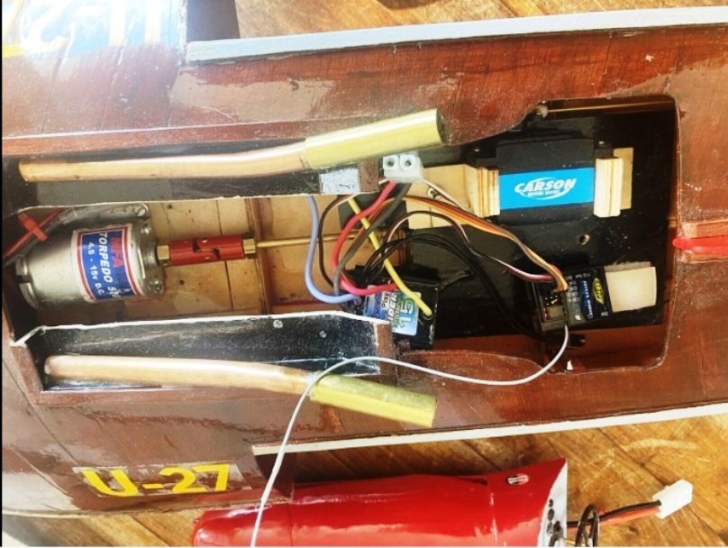

                  Hi All
                  The first run with the Slow Mo was totally disappointing .
                  Change the battery from 7.2 volt NIMH to a lighter 3S Lipo battery.
                  Just got it's nose up above the water a full power.
                  Back home and replaced the brush motor with a Banggood C3542-1450kv.
                  Next test will be on the same Lipo battery, but, plan on taking a 4S battery as well.
