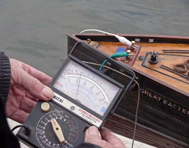

      The first test was with the meter…..and it worked!
      A full 12 volts…..Followed by the bulb test, which was ok

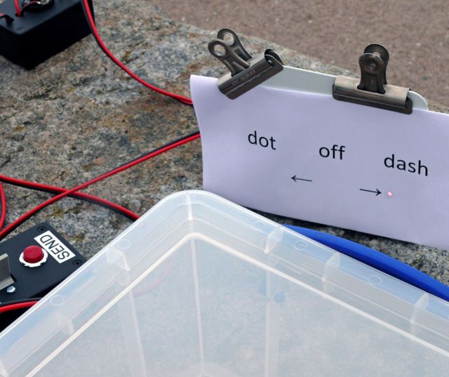

      Followed by the Galvanometer/ Morse code test…
      The light moved to the right of left……..Clever eh?

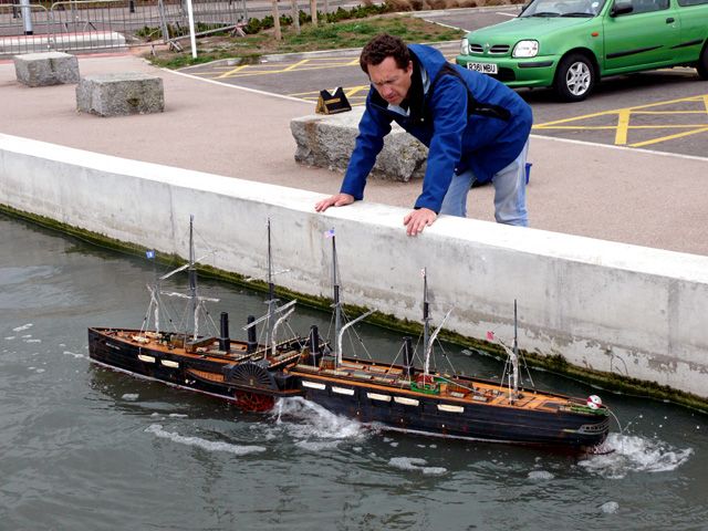

        Jonathan Hare of the Coast team watches GE make an impressive start!

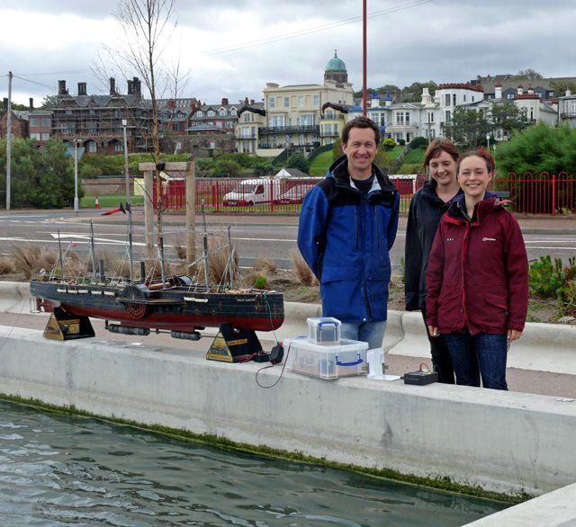

        We say goodbye to the Coast Team after a very successful trial run

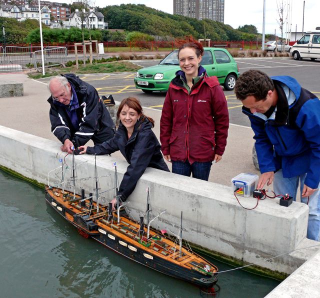

              Before the sea trials, we had a short test, to check out the wiring and equipment.
              And, sure enough…….Sod`s law!…..There was no circuit there!……..We blamed it on the hasty installation of the cable drum, while the boat was bobbing up and down like this, on the choppy water
              But, as already seen, all was well at Heart`s Content……Phew!….Was I on pins!
              Bob looking in total disbelief at the unlit bulb!

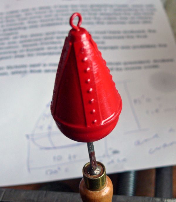

                                              Finished the crane and marker buoy now, which, considering the great occasion, and having removed number four chimney, and added winches and stern pulley etc just for authenticity……The big red buoy and crane was really an important item.
                                              So when you see the film next year, you can look out for all these lttle features and recall the story behind it all?

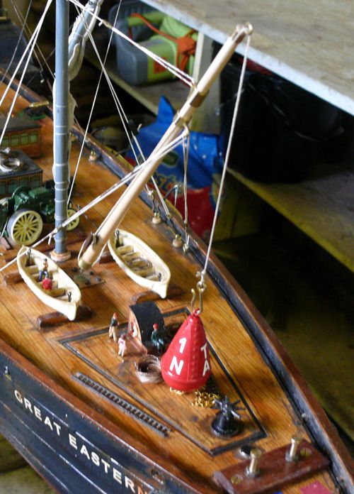

                                                    Should have done this earlier!
                                                    Completely forgot about the grappling equipment at the bows! Anyway, it`s not too late, and just in time for the film…….Phew!….. That was a close call!
                                                    Should have had five hooks, but who`s counting?
                                                    Can`t imagine, how they managed to snare the broken cable….in all that vast ocean!…….One mile and a quarter deep!………How did they join the cable with such a tremendous load pulling down?………How did they find the cable end without it slipping back?…..etc……etc…..etc….Endless mysteries!
