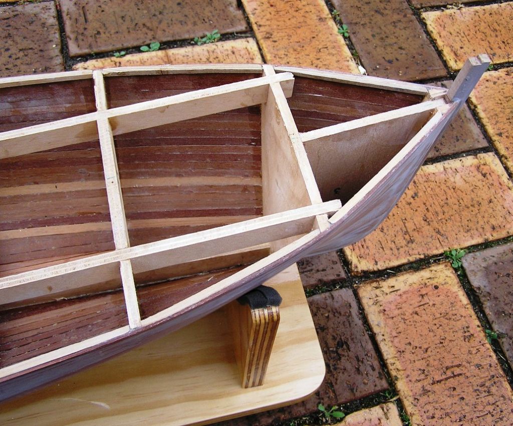

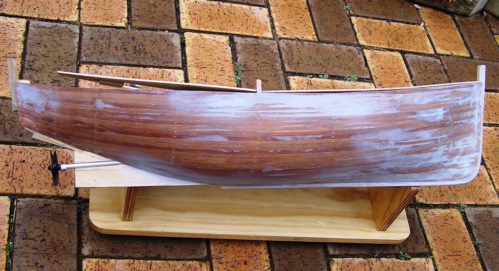

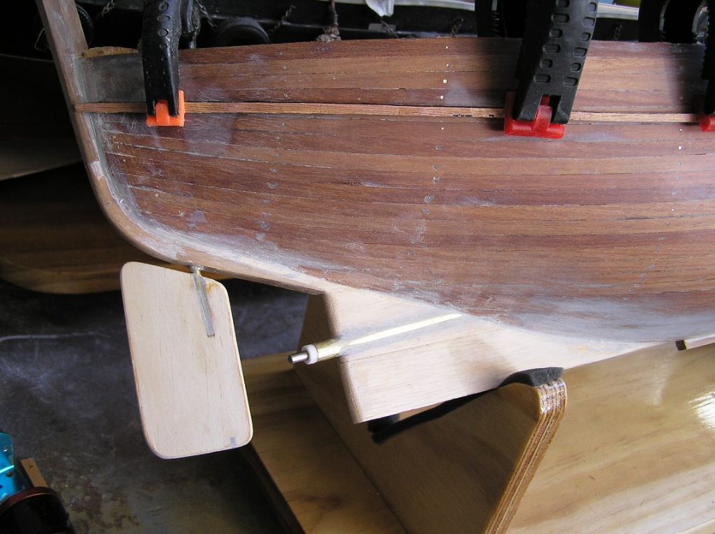

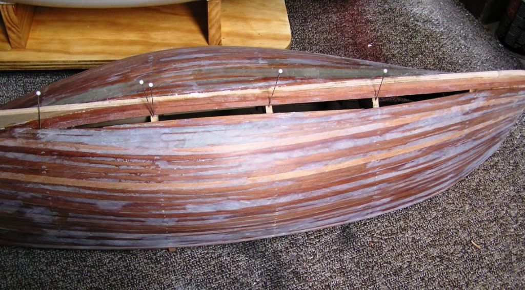

          #84330

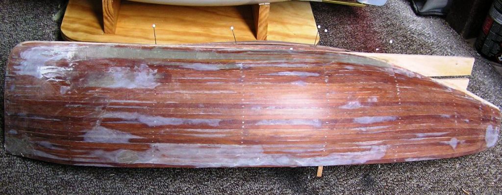

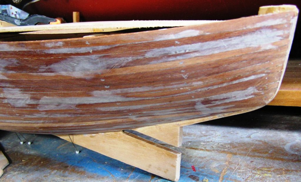

            At least most of the hard work is done i.e. planking the hull!
            #84333
              Hi Chris
              The last two planks, two dam hours to install !!!
              Never plank from the deck to the keel.
              Start at the keel because you can use plastic clamps to hold the next plank as the glue is drying.
              Also you can clamp onto the frames as well.
              Harry

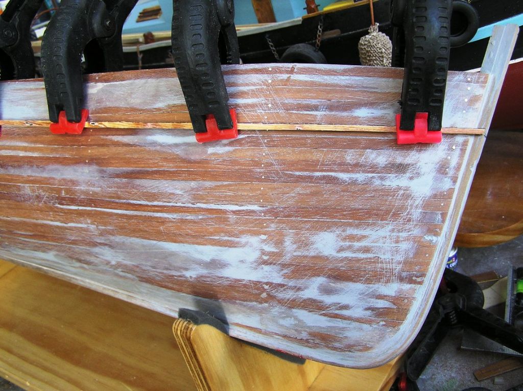

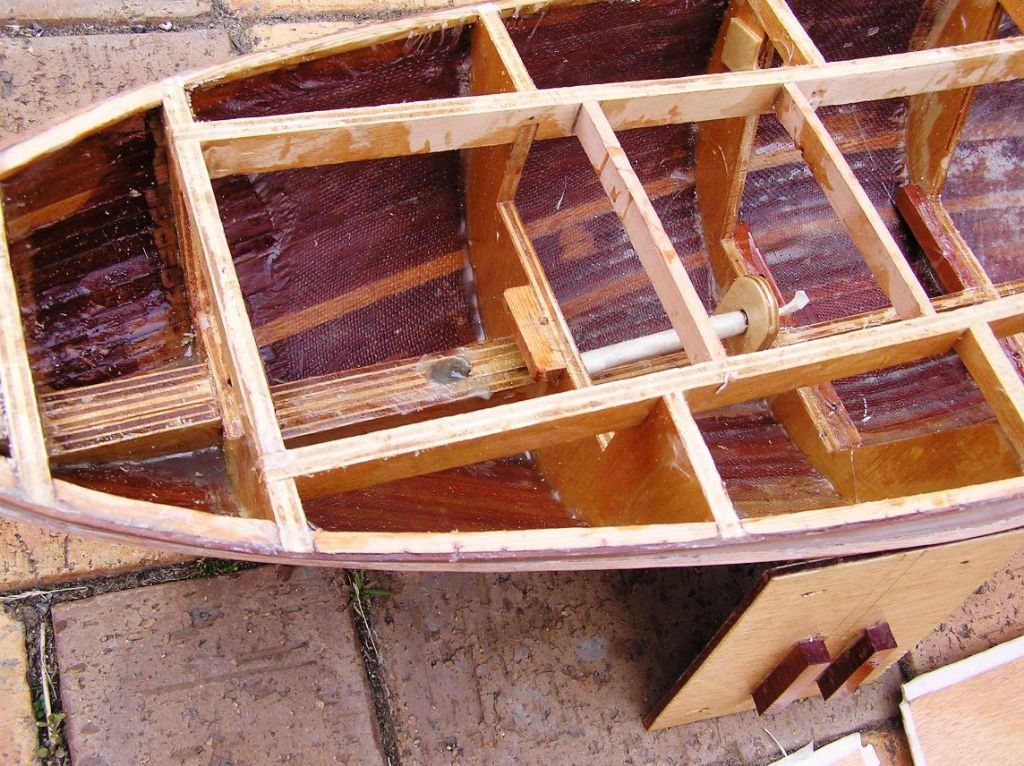

              #84517

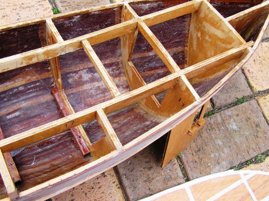

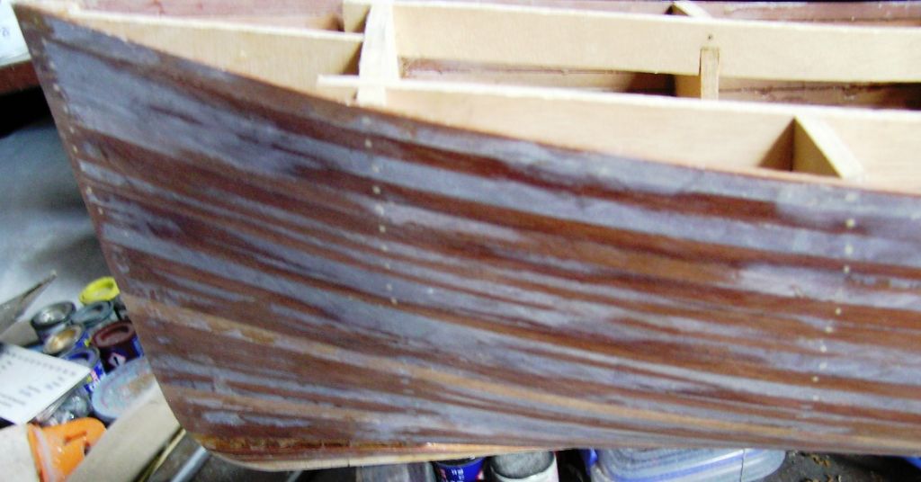

                Hi All

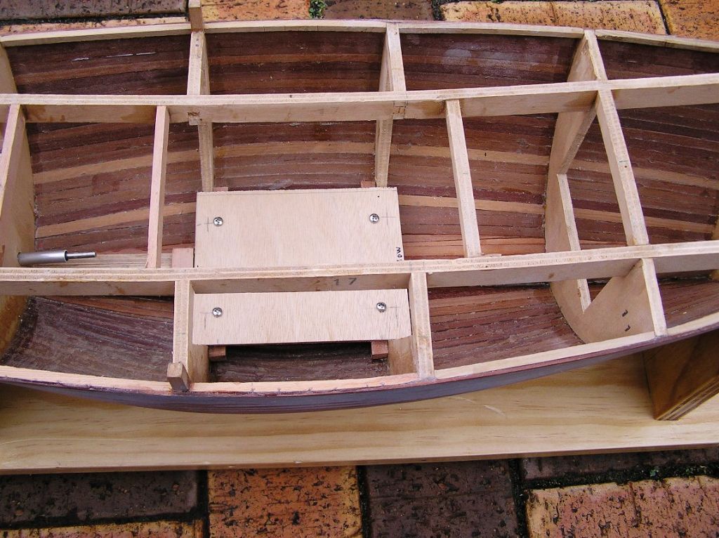

                A lot of diagonal sanding on the hull to get it smooth.

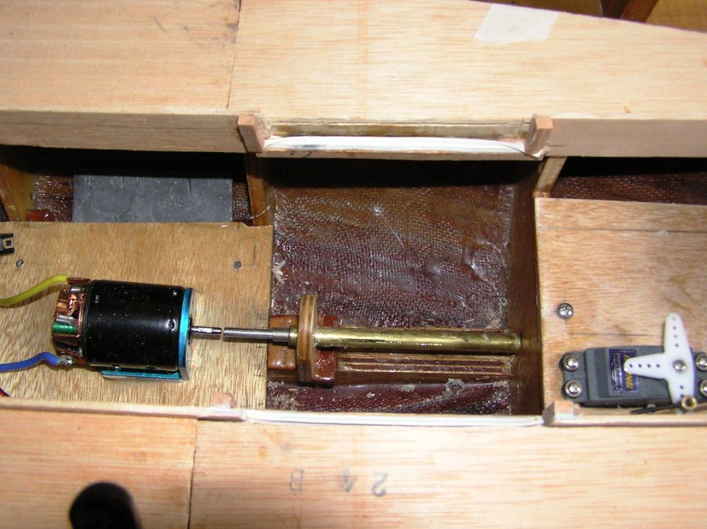

                Installed the prop shaft with a Teflon rear bearing and roller bearing at the motor end.
                Setup the motor mount with my alignment tool .
                The Raboesch 60mm 3blade D type prop( looks better than the plastic one) , the ESC and 80 turn 540 rock crawl motor arrived.
                Made and installed rudder which I added a bit more area to and carry the hull lines onto the top of the rudder.
                Lovely smelly day fibre glassing inside the hull and with a 32 degree day coming up it will harden up nicely!!!
                I mask up the under sides of the deck where the frames glue onto and fibreglass resin the rest.
                Harry Smith

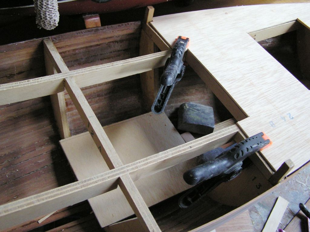

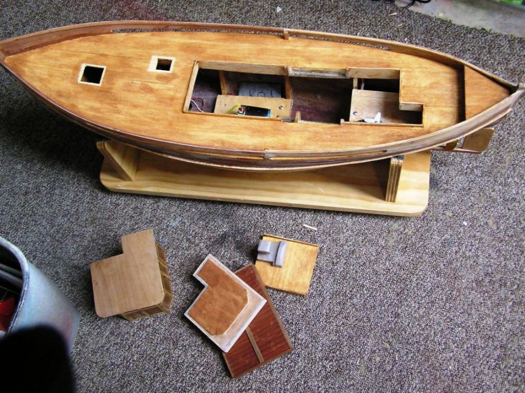

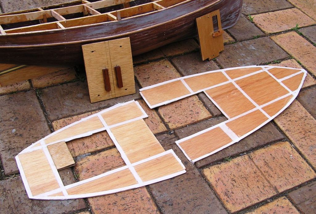

                    p1010137.jpgp1010136.jpgp1010135.jpgp1010134.jpgHi Chaps
                    Added the lower rub rail before installing the deck.
                    Fibreglass the inside with 2 ounce cloth and rein coated the under sides of the deck, motor and radio mount.
                    Heat wave tomorrow 32 !!

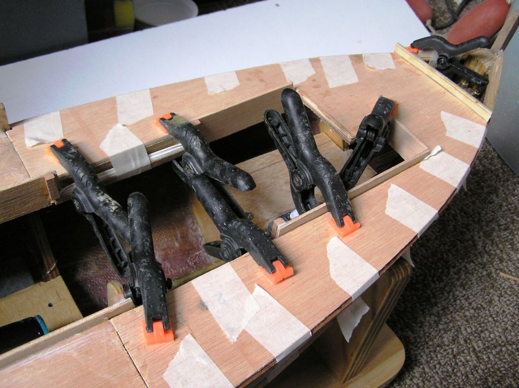

                    #84731

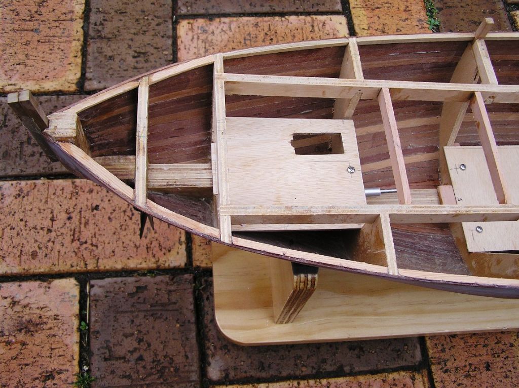

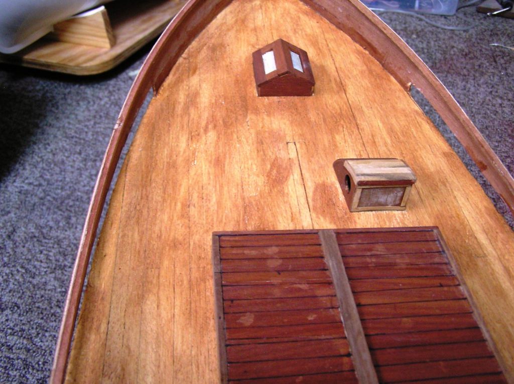

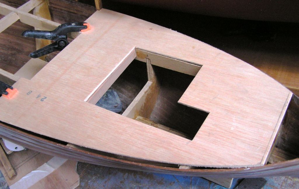

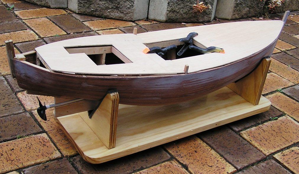

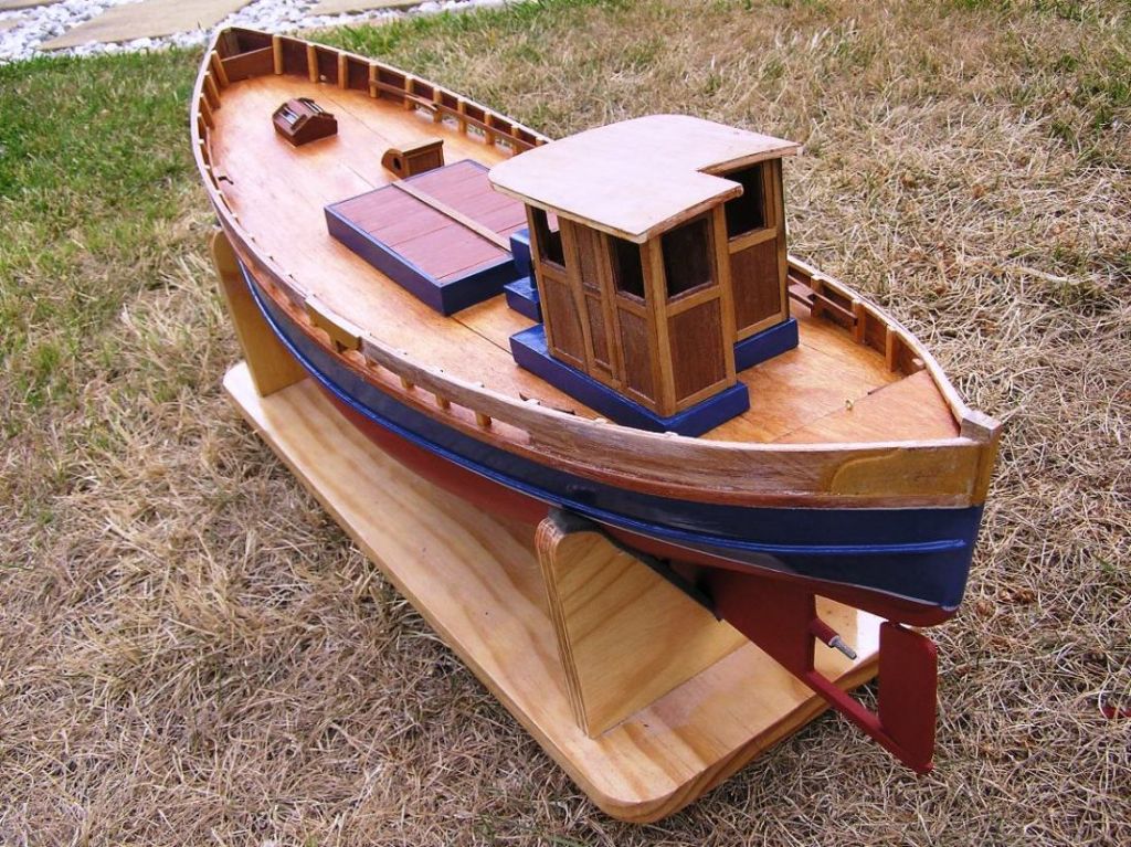

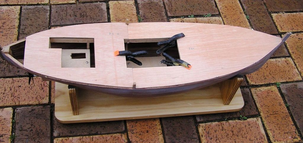

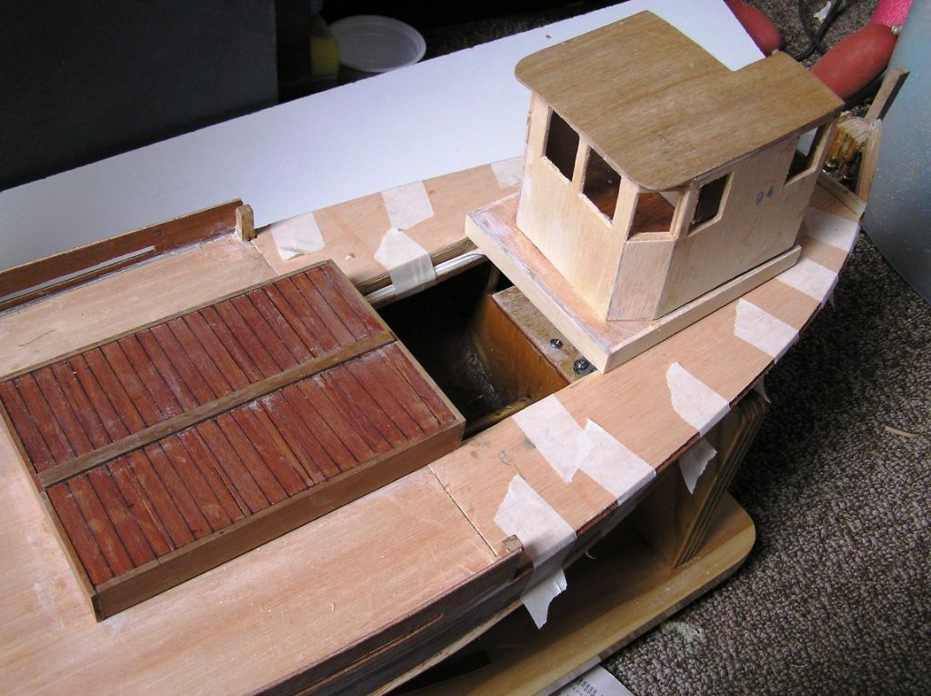

                      p1010144.jpgp1010143.jpgp1010142.jpgHI All
                      More work on the boat with the deck on and a start on the hatch and wheelhouse.
                      The forward bulwarks are on.
                      Next will be the stern bulwarks and rub rails.

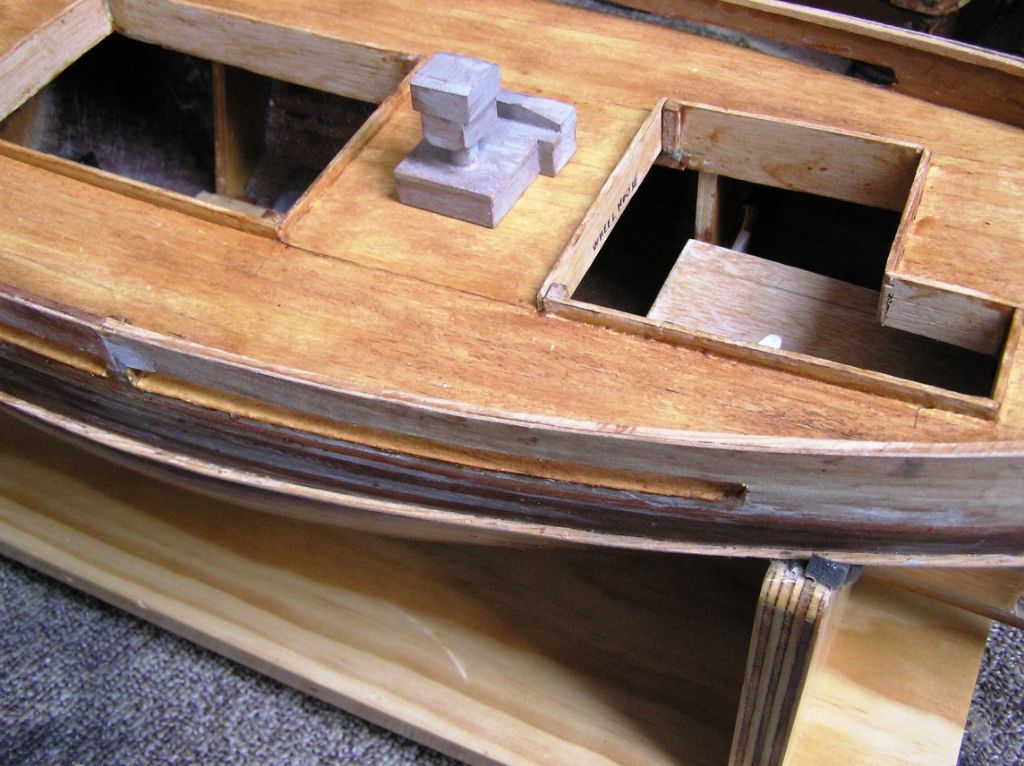

                        Hi All

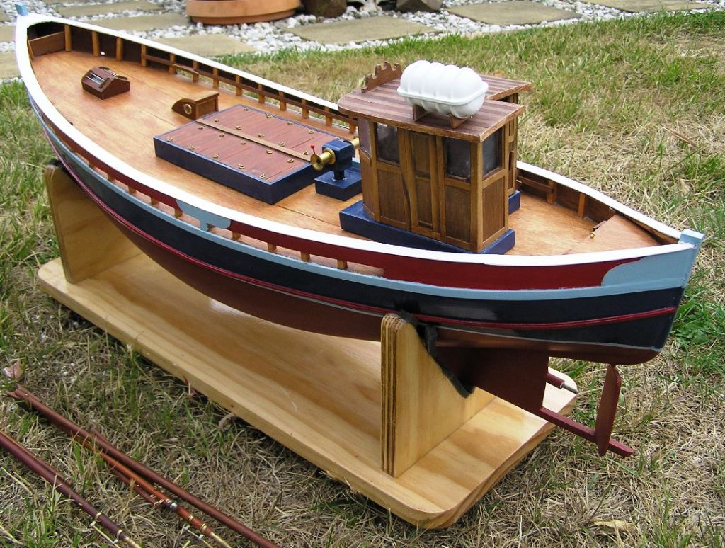

                        More work on the Eileen with the stern bulwarks installed and a 3mm square strengther on the inside.
                        All the deck planked done in three days.
                        Planks have had two coats of matt vanish so far.
                        Wheelhouse is all planked except the roof.
                        Still have the edge to put on around the outside of the roof.
                        The basic winch is glue together, also the skylight and forward access doorway.
                        Pics in a few days.

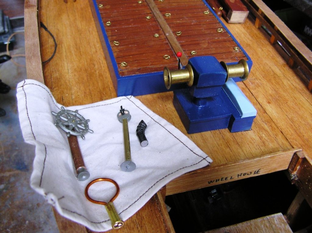

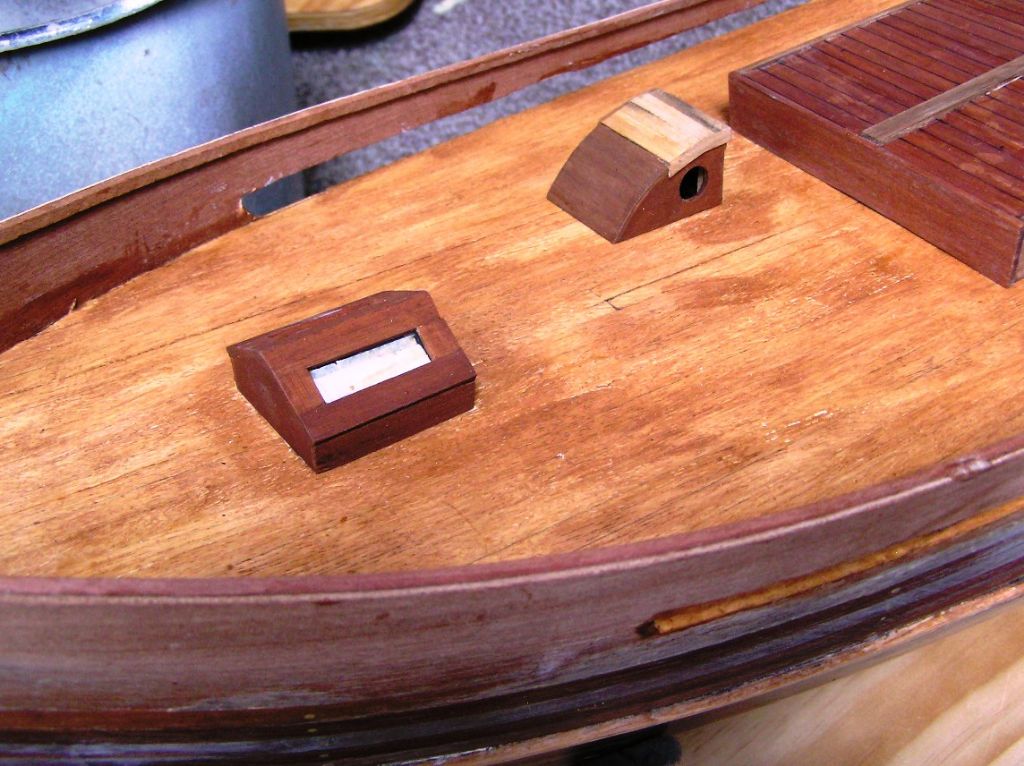

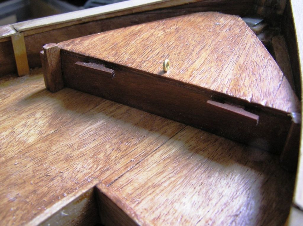

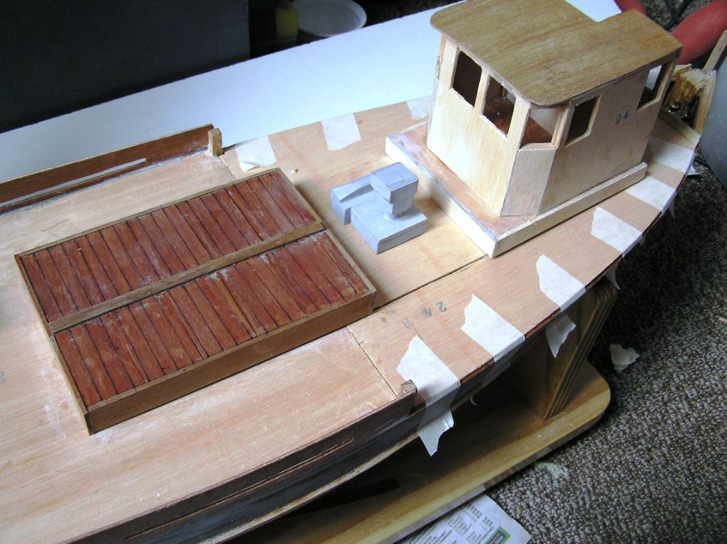

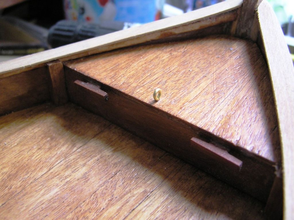

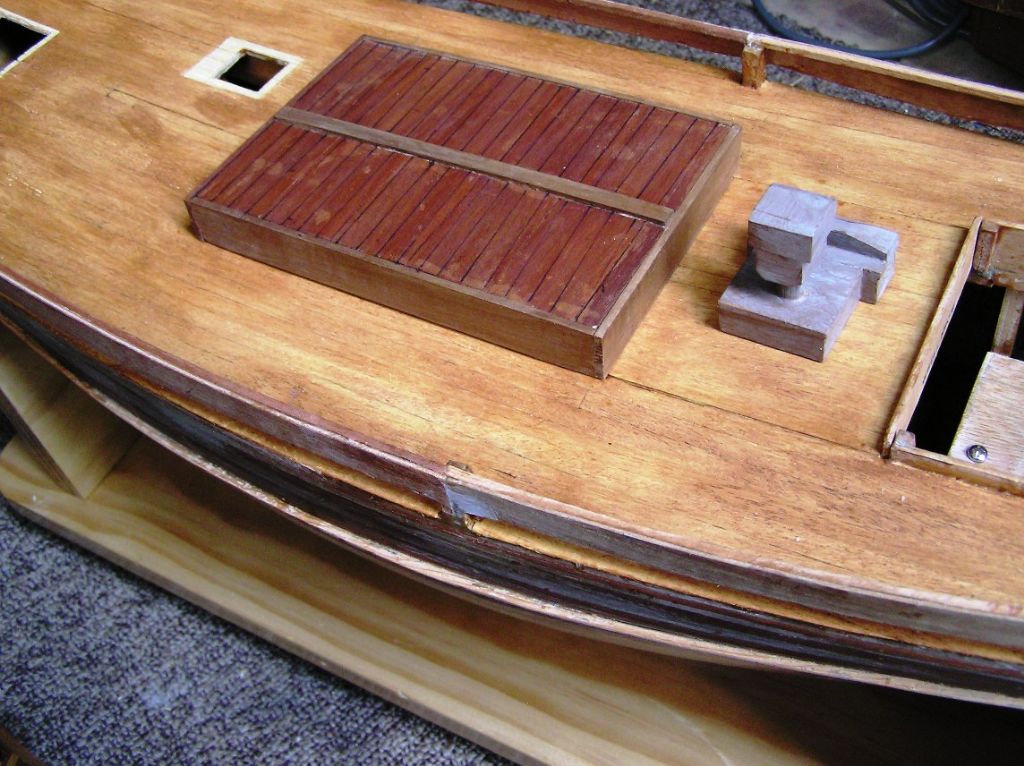

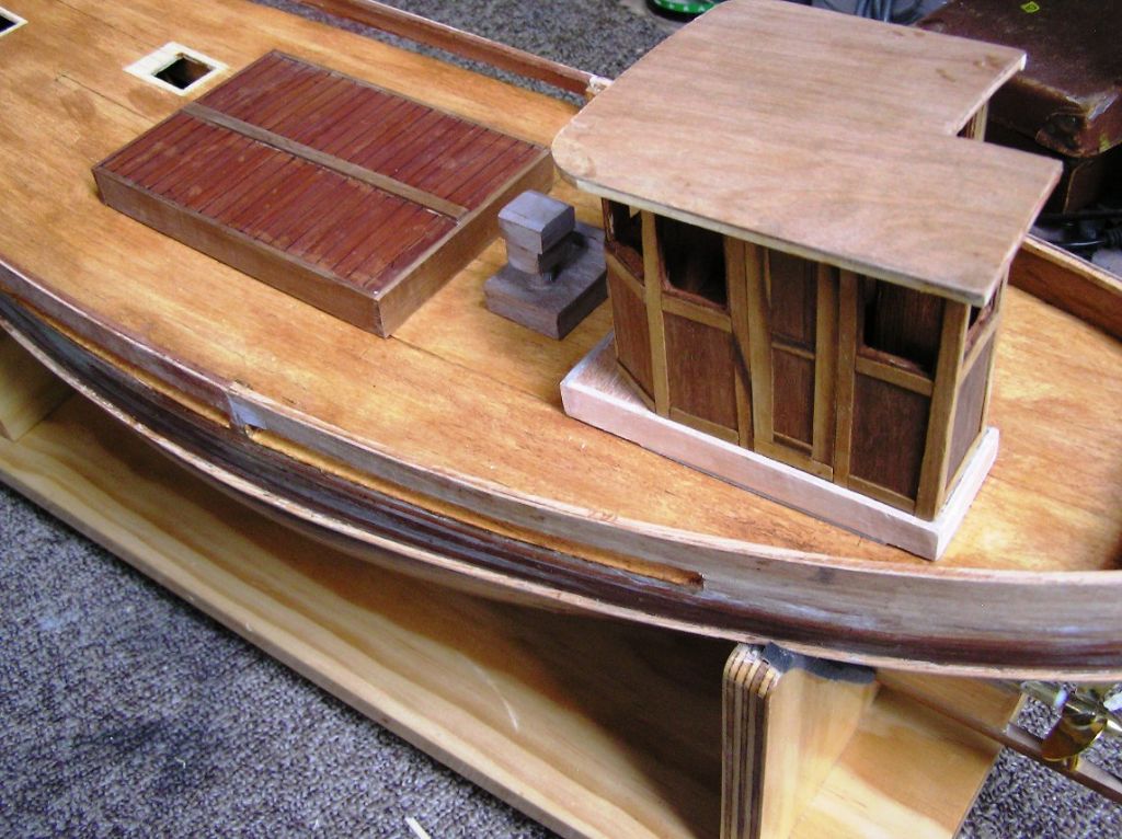

                          24.jpg25.jpg26.jpg27.jpg28.jpg29.jpg30.jpg31.jpgHI All
                          Started vanishing the wheelhouse, skylight and forward access doorway.
                          Also glue on one of the rub rails after steaming the wood and drying with a heat gun in 23 degree heat day.

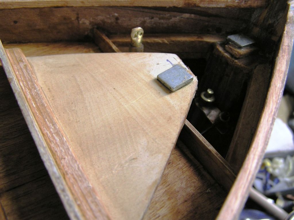

                          The stern deck is held down with 10mm double magnet and slides under the bulwark stringers.32.jpg
                          Harry Smith

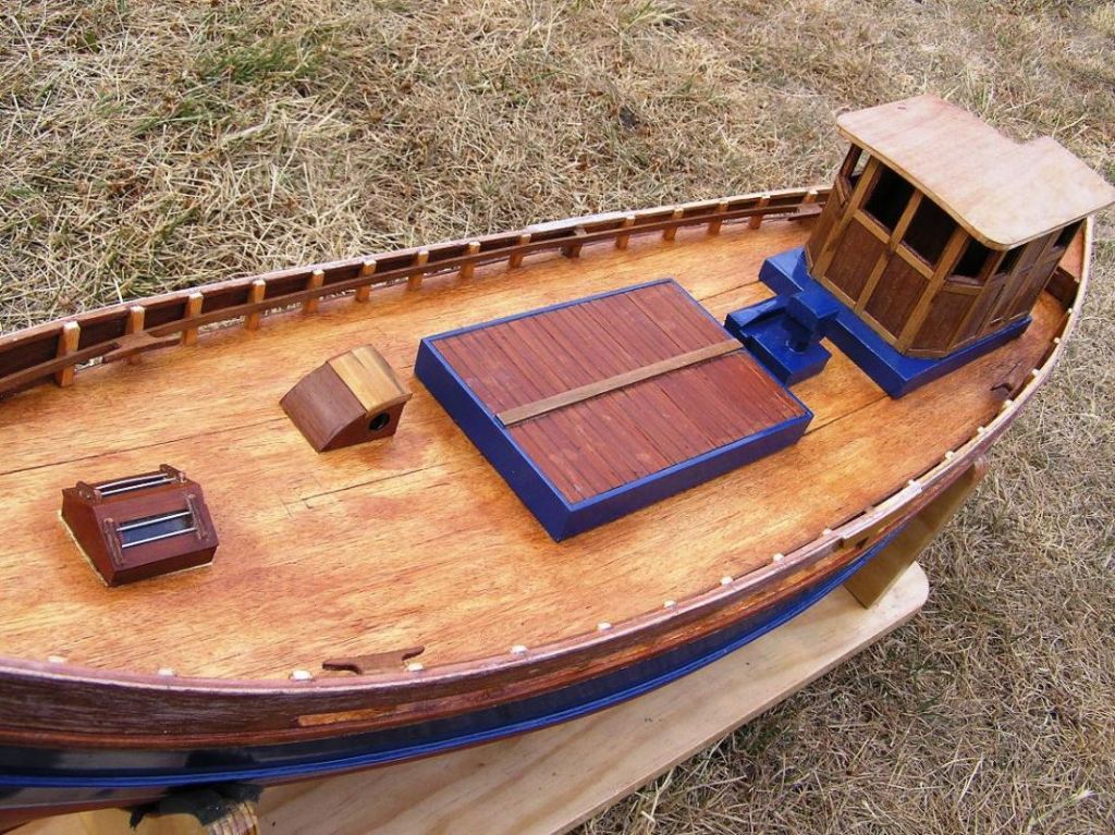

                            35.jpg34.jpgHi All
                            A bit more work on the hull with the bottom and sides painted.
                            The Red Oxide was spray painted in four coats and rubbed back between coats.
                            All in one day !!!!!
                            YES, it was 41 that day.
                            Painted the sides at one side with three coats and left for two days then painted the other side.
                            Still have the water trim paint and rub rails to do, also the top sides.
                            Added all the top railing today which was missing from the kit.
                            Started fast planking the wheelhouse roof this morning with Jarrah( a very dark wood) and the kit Mahogany.
                            It look a little boring with only the Mahogany strips.
                            Will post the fast planking in another post with pics of course.

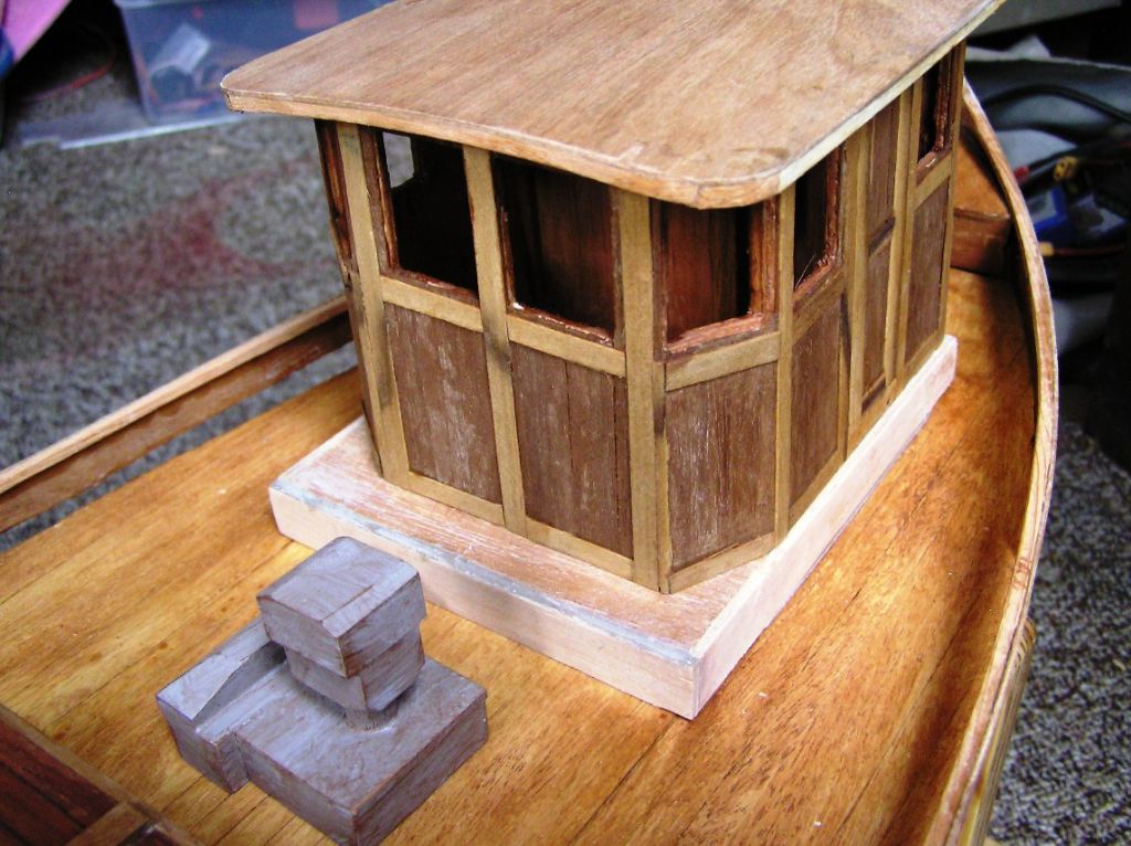

                              46.jpg45.jpg44.jpg43.jpgHi All
                              Adding some more pics !!!
                              Regards

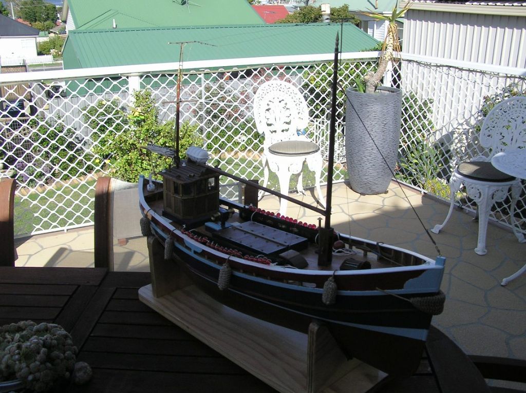

                                    #85539

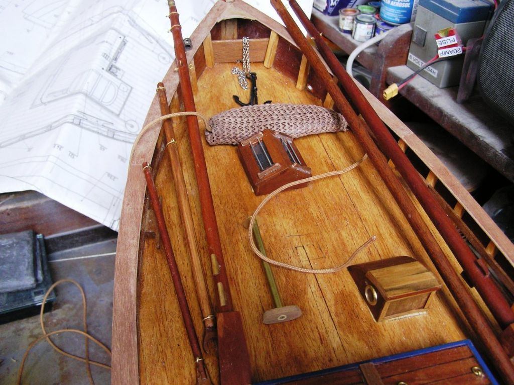

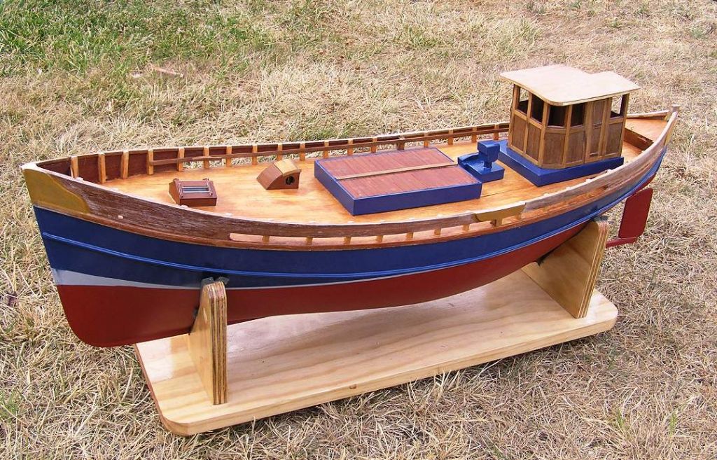

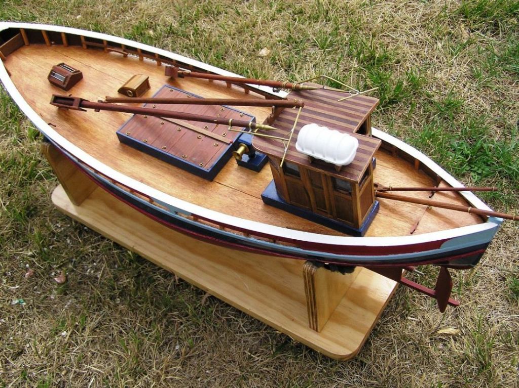

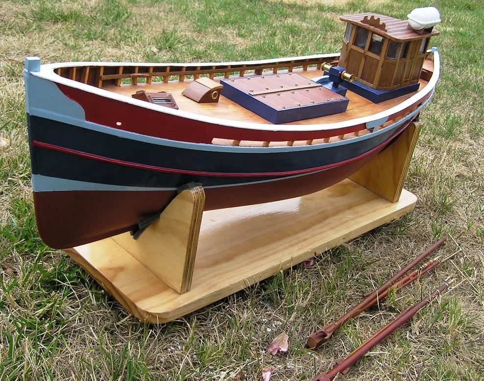

                                      49.jpg48.jpgHi All
                                      Ray I am staying in the warm weather !!!!
                                      More work on the boat with the hull fully painted.
                                      Started on the masts, added the wheelhouse windows.
                                      Still more bits to addon.
                                      Oh, I must connect the shaft to the motor and added the brass water stirrer !!!

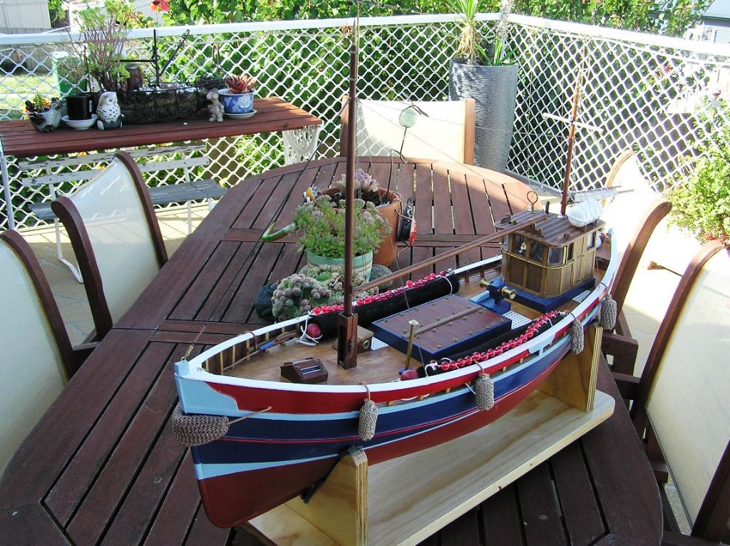

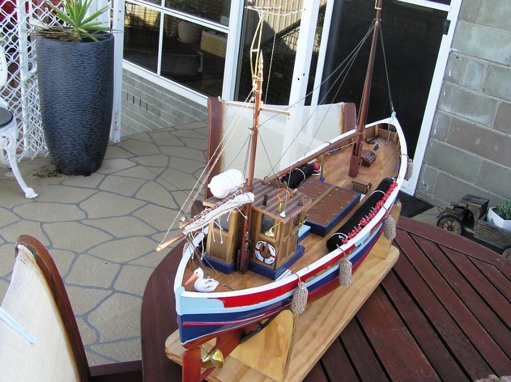

                                          Hi All
                                          The boat is finally finished with the radio tested and ballast added.
                                          Final ballasting and maiden voyage on Saturday.
                                          Also hoping to get a DM boat into the water for it's maiden voyage as well.
                                          Harry Smith

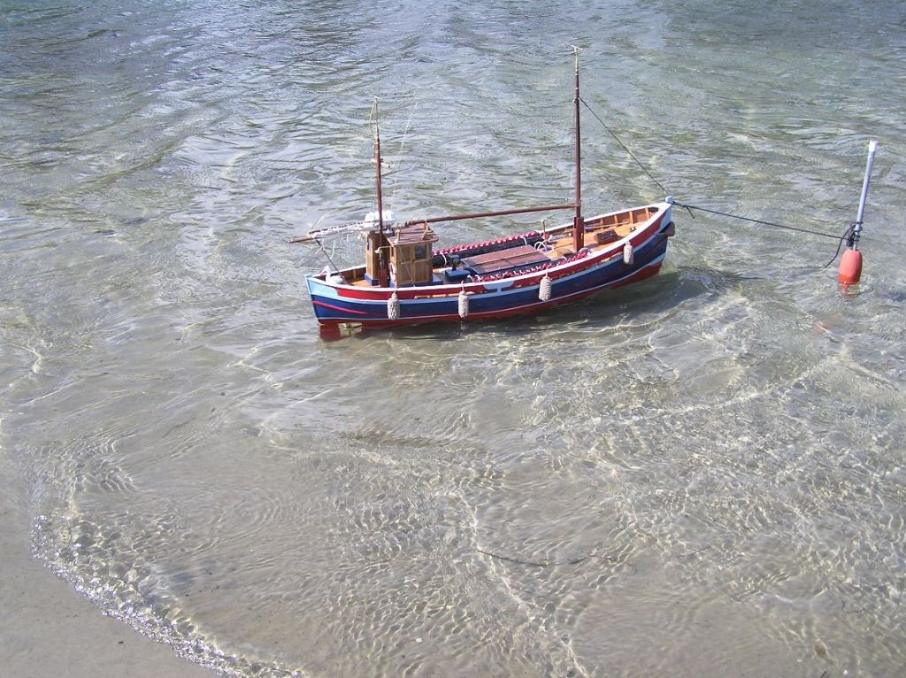

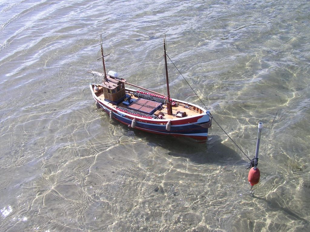

                                                    56.jpg55.jpgHi redpmg
                                                    I have two Precedent Perkasa's with the original booklets and the plan of the Brave Border.
                                                    So I will pass on your offer, thanks.
                                                    But I do have PDF plans of other boats and well as access to our club archives.
                                                    So back to the Eileen fishing boat.

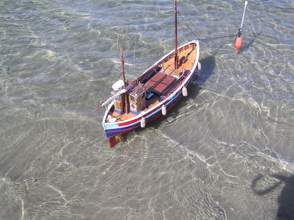

                                                    Had a ballast test this morning in the sheltered inlet at the canal.
                                                    As from the pics it was not good idea to test the boat out it the rough stuff.
                                                    Call into another more sheltered spot for the test voyage.
                                                    Will have to cut the throttle back to 70-75% as it's speed would out run a flower corvette !!!
                                                    The brakes (reverse) works very well and pulls the boat up very quickly.
                                                    Handy with some of club steerers!!!!

                                                      are you running the Eileen in the sea ? looks like it with the waves……….
