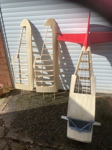

          At present I am working on a Top Flight Stinson Reliant that I bought off a very nice chap on ebay.
          Its a bit of a monster but I love working on these 1930s gullwing designs.

              Its a shame that I will never get to actually fly it but most of the fun is in building

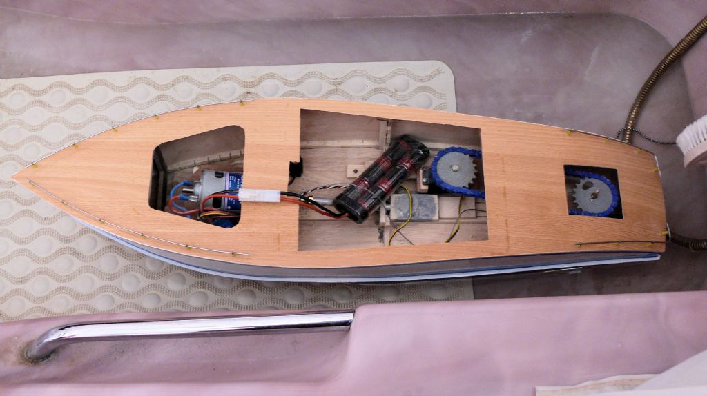

                                        Right then……Got the Motor and Rudder working well now
                                        There`s only one snag!
                                        The prop runs fast backwards than it does going forwards!
                                        Any suggestions you chaps out there?
                                        I`m thinking of making an opposite hand prop……..eh?

                                            The Bath Test
                                            The battery needed to be as the photo shows. which makes a mess of the seating compartment?
                                            Will sort it somehow
                                            The model dashes about bath fore and aft smartish like, so mod to the prop yet
                                            Next job is to sort out the battery position and have another trial run at Etherow Water
                                            The only snag with that is that I have difficulty getting into the Rescue Facility and even worse…..Getting out!
                                            But wait!……Do I hear the next door neighbours little boy, splashing about in their new pool?
                                            Back later, with more action shots and indepth ( Hope not ) report
                                            #95934
                                              Bob. I believe that esc has a half power reverse, so you need to swap something about…prop perhaps, so it turns correctly on the full power direction.
                                              #95936
                                                Reverse the throttle on the transmitter then swap the cables to the motor over.
                                                I've just saved you making a new prop!
                                                Edited By Richard Simpson on 04/06/2021 18:45:03
                                                #95938
                                                  Thank you. Richard for your excellent suggestion……..What a simple solution?
                                                  Now. why didn`t I think of that?……….You too, Ashley!
                                                  I recall now, somebody did mention last year, when the motors were installed in Brutus 11, that the Controller had forward and reverse speeds built in intentionally
                                                  So…….My apologies to the Trustworthy Dealer [ and they were Howes Ltd ]
                                                  Full report to follow, describing our escapade, testing the model in next doors swimming pool
                                                  I`m a bit knackered at the moment, after carrying the boats, up and down stairs!
