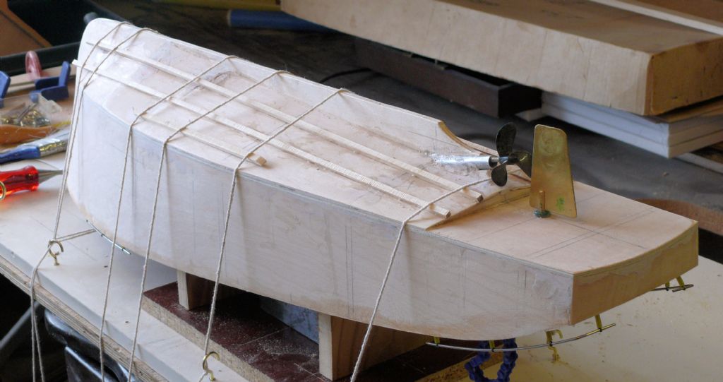

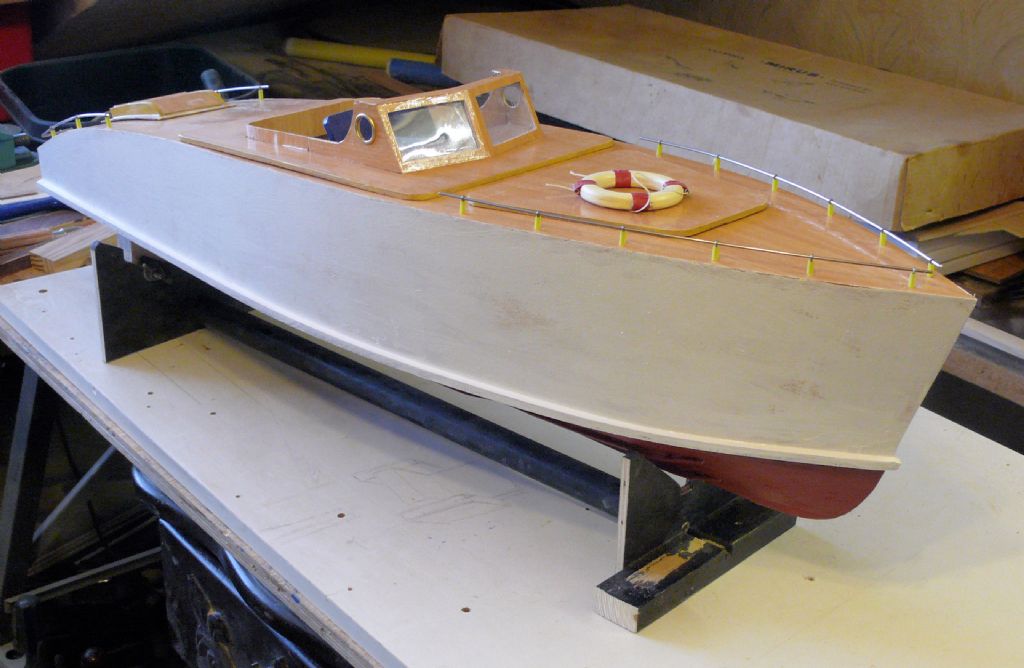

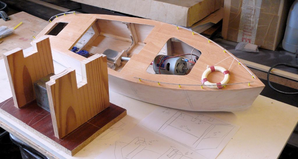

        It`s time to turn her over and finish off the hull, chaps
        But how can we do that, with all the delicate stuff topside?……I hear you ask?
        Easy!…….Make a special stand, taking the load on the sub floor
        See the pix and all will be revealed!

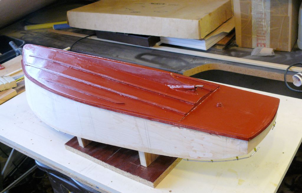

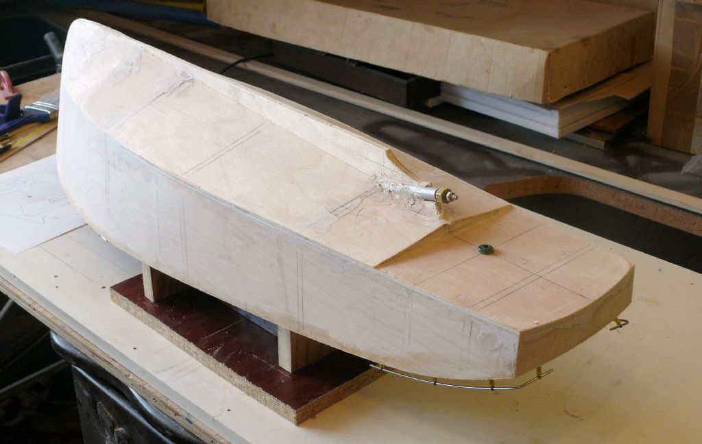

                            Anyway, here is the star of the show, having her bottom painted!
                            Edited By Bob Abell on 18/05/2021 19:46:40

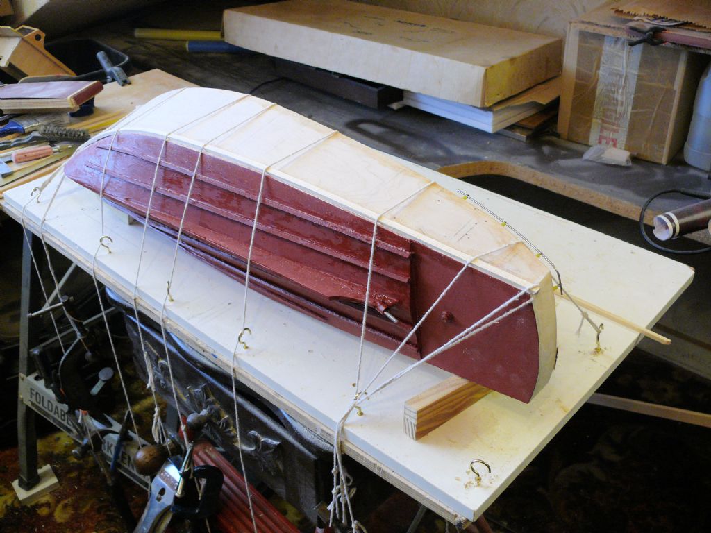

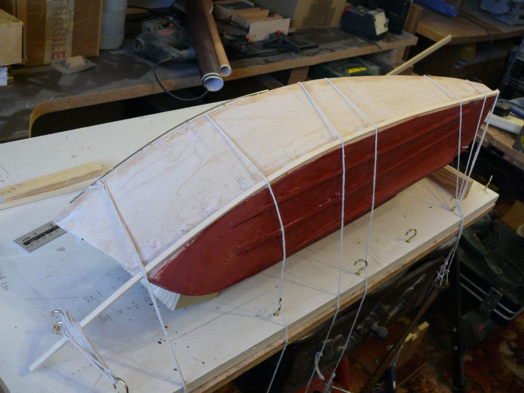

                                    My method of restraining the Rubbing Strips while the glue to dries
                                    (I got the idea from an illustration in the book…..Gulliver in Lilliput Land)
                                    Not really but it looks very similar

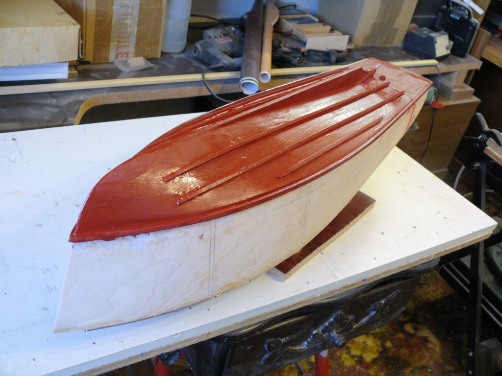

                                      Rubbing strips done and another coat o` paint

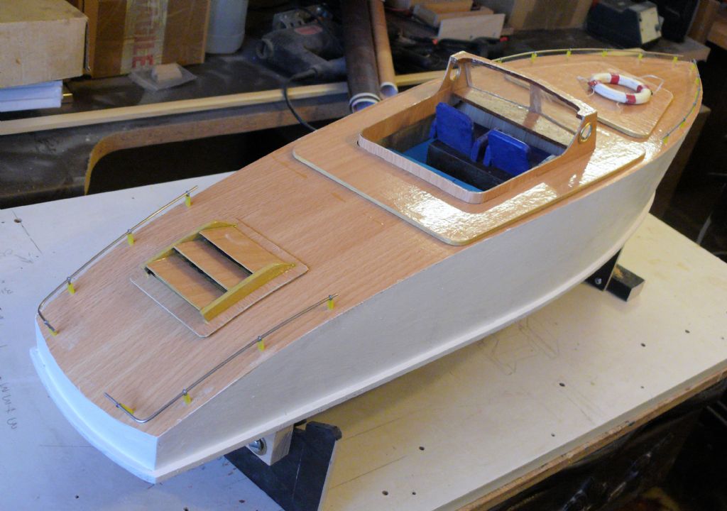

                                                The paint job so far, I like it myself
                                                Think the fender strip would look nice in Royal Blue, to match the seats>
                                                #95655
                                                  What I am talking about is having the royal blue (which would look very nice) coming above the lower rubbing strip by perhaps 1/2 or 3/4 of an inch so you can see it at rest, and continuing the blue underneath, as you will see this when it is on the plane.
                                                  In my minds eye a boat like this would not have a boot topping stripe, although as Paul (so correctly) says this is the easy way to do it. Paint the gloss white first, then use masking tape to get a good line for the blue.
                                                  You could of course use a white pinstripe, which would not show (just make the job look like a sharp edge).
                                                  Or Gold perhaps?.
