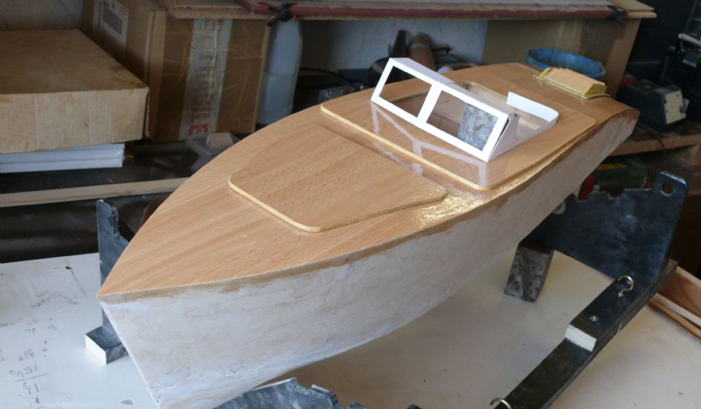

        #95379
          Windscreen card mock up
          Slightly pedestrian. but good enough for purpose?

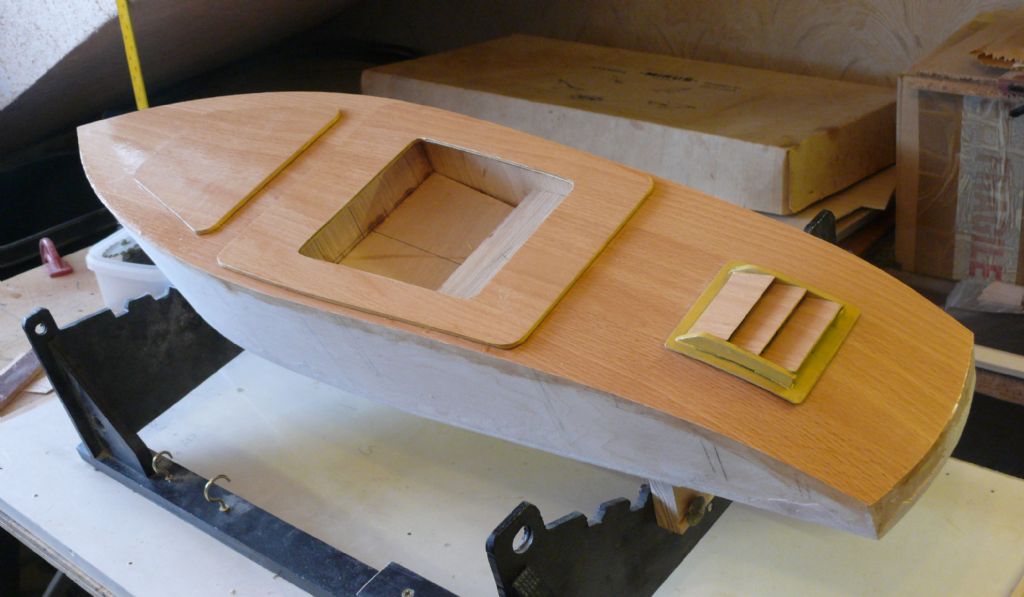

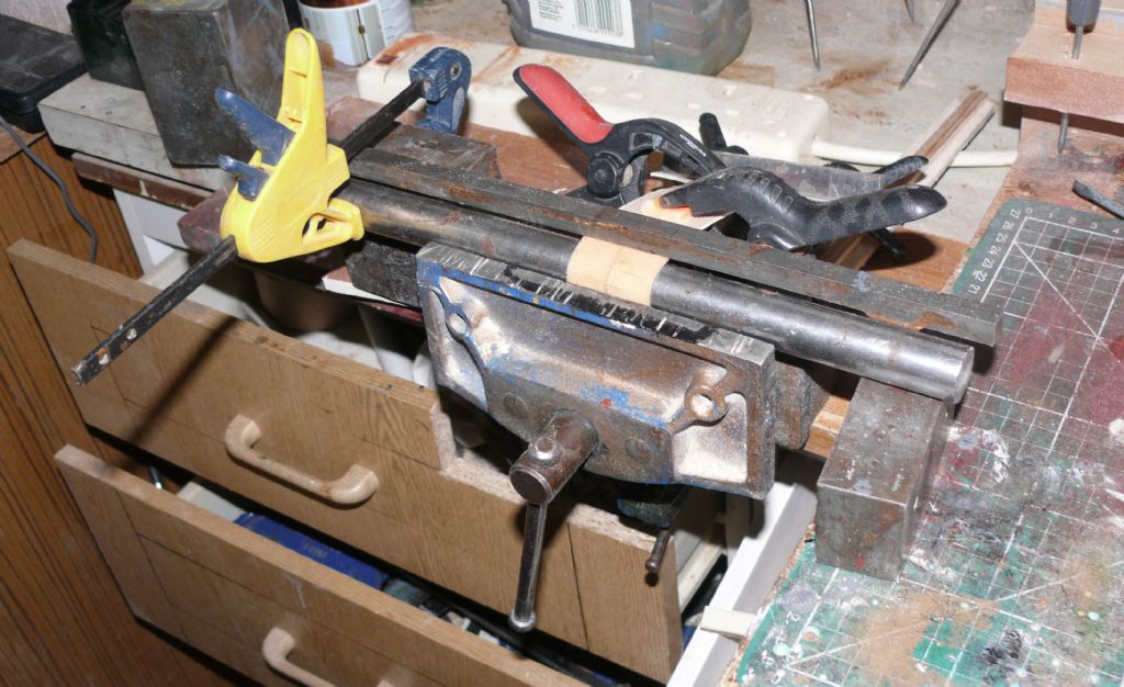

          #95388
            The seating area has a combing rim and needs the corners bending for a nice appearance
            I just thought that it may be of interest if I post a photo of the operation
            I like tydiness of the operation
            A steel bar is gripped in the vice and supported at each end
            The thin ply is soaked in water for a time, then gripped in the vice against the steel bar
            Note two corners are being bent at the same time
            Very carefully, bend the ply over the mandrel with the thumbs
            Press the ply down over the entire bend area and don`t allow a hint of a crease to appear
            The ply will surrender after a time
            Weights are placed in position to maintain the bend process
            It`ll be OK in the morning……Hopefully
            Did any of you find this little ditty of interest?
            #95395
              Yes good technique Bob.
              i use a hot air gun on thin ply, applying a water spray and then heat, However it still needs holding in place until cool.

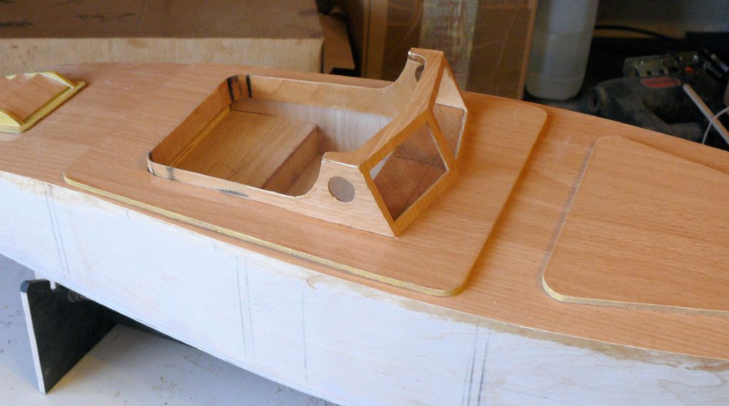

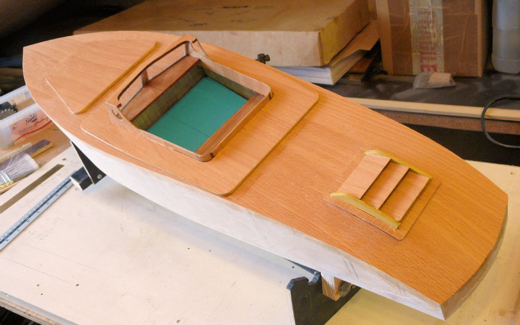

                An interim picture showing the Combing construction
                Just for casual interest
                Note the tubes keepng the curve in the corners and the start of the Slipper bling thing

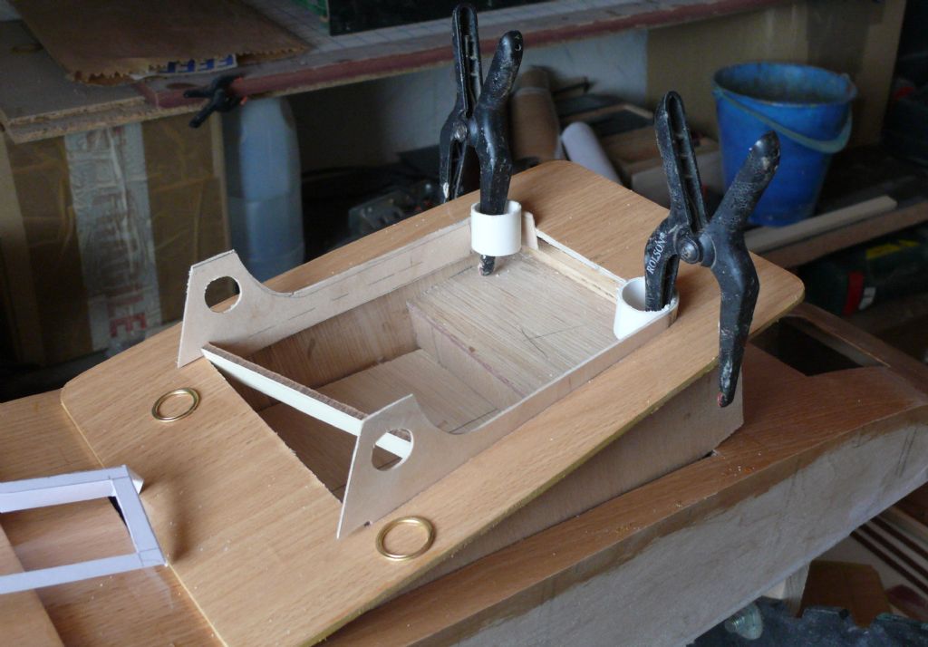

                #95413

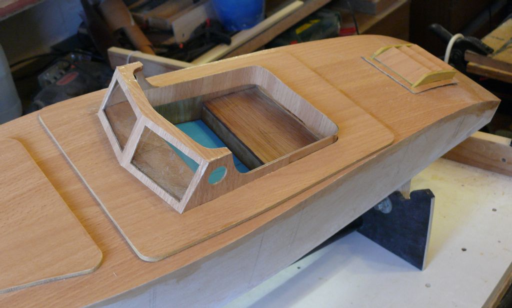

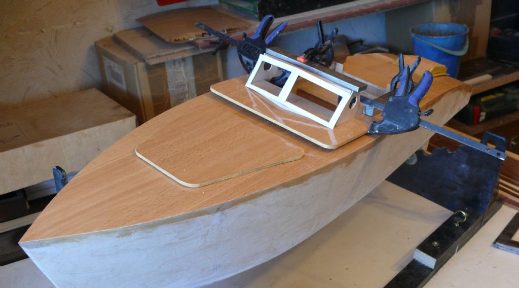

                  Working on the wind screen section at the moment
                  Having to make it up as we go along
                  The PVA glue takes ages to dry

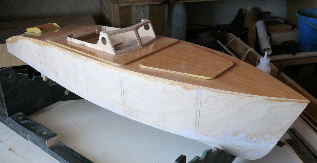

                          #95440
                            Work in progress
                            Cobbled the windscreen arrangement and looks quite nice?
                            #95461
                              Some progress made today
                              The black stains were caused by rust during the bending process
                              Not a problem really

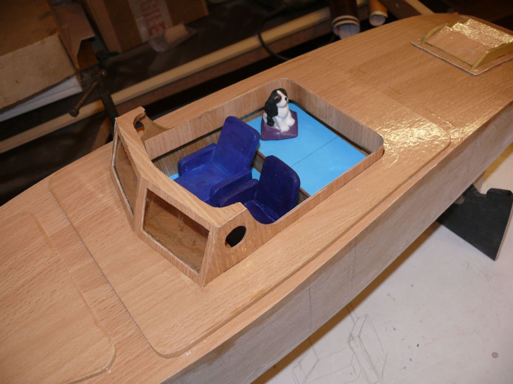

                              #95485
                                Still working on the cockpit
                                The Fablon finish is looking the Bee Knees!
                                The Windscreen is glazed now

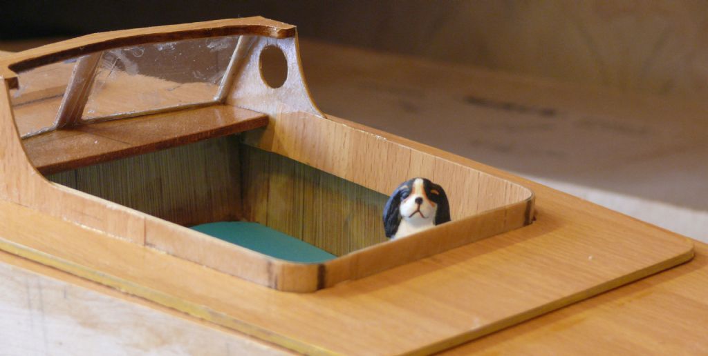

                                    #95501
                                      Blimey, Maisie didn`t hang about…..
                                      She`s in already……..Woof

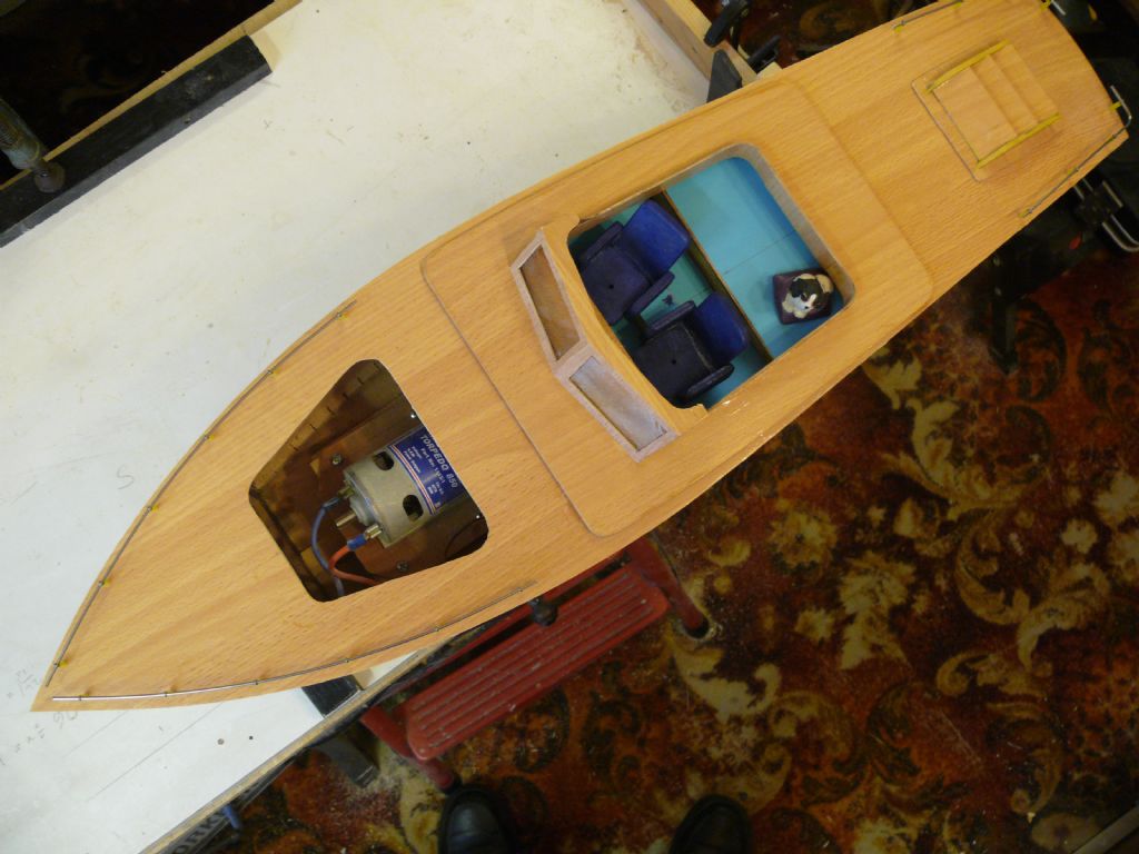

                                            Made up a couple of seats
                                            Just wondering what the scale of the model is? ……Now that I need two good men
                                            The hull is 6 " wide and would guess the scale is about 1" to 1 ft?
                                            Can we get 5 inch men these days? don`t fancy Dolls or Spacemen!….or Teddy Bears etc

                                              Personally Bob I think that the seats are a bit small and make the boat look enormous.
                                              BUT, thats just my opinion. With figures seated it might look different….?
                                              5 inch men in short supply. I wanted some 6 inch men for the Stalwart and could only find 135mm men, which were ok, but I cant see them on e-bay any more!

                                                Thank you, Ashley for your constructive comments, they are alway`s welcome
                                                I don`t know about the correct width of the seats, but what I did was , I used the available space as on the plan
                                                As they are on my model, it would be quite awkward. actually getting sat down! Due to lack of space available
                                                At the moment, that`s the best I can do

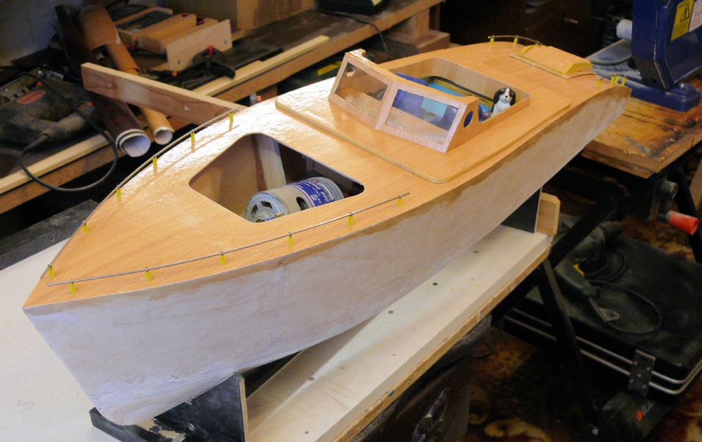

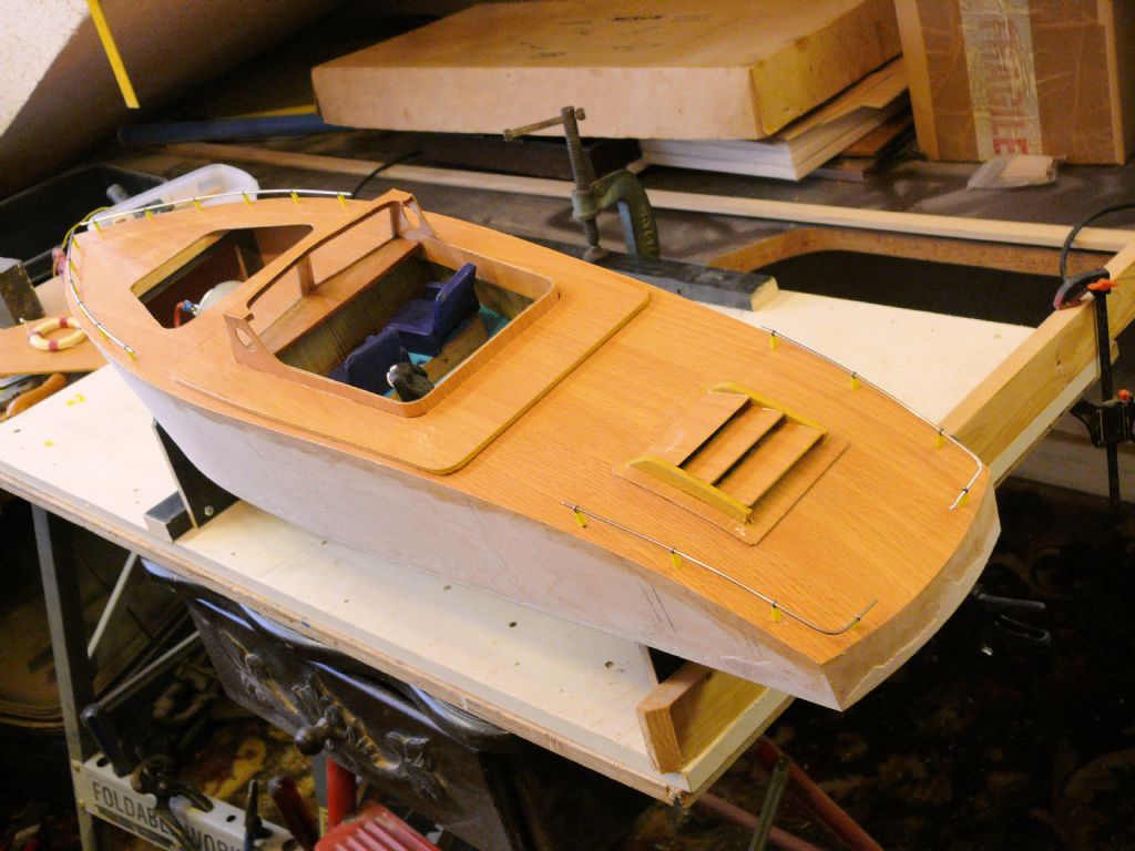

                                                    Fitted a few hand rails today…..A right fiddly job
                                                    Used bicycle spoke wire, No brass at the moment
                                                    Looking more like it now?
                                                    Still got the hull to finish off and tidy up the innards
                                                    #95560
                                                      looking superb Bob………lovely characteristics of the stern lovingly captured.
