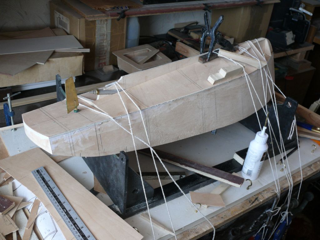

      A pleasure as always Bob to gaze upon your hold-down methods !
      Are you fitting a shiny brass prop or a performance twin blade plastic one? Or indeed using the one shown?
      #95170
        Thank you, Ashley
        It`s very satisfying lashing down the ropes where required. with any amount of force!

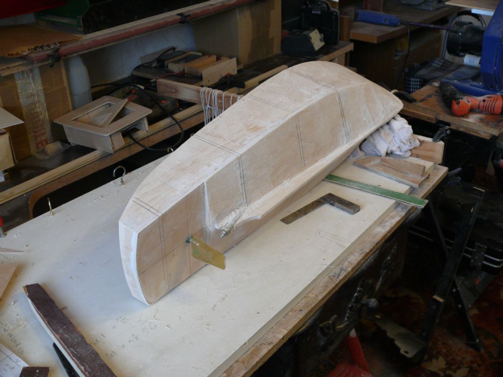

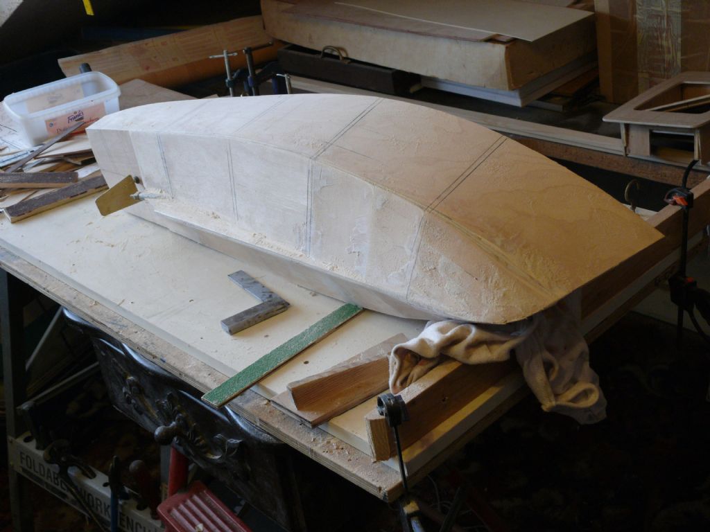

            Keel cladding in progress
            It may look very untidy, but we are getting there slowly
            The sharp end is a challenge

            #95200
              Be interested to see how you do the pointy end Bob… perhaps a balsa block just for the very front bit? It looks like a bit of heated ply might just form over the rest?
              #95201
                Hello Bob,
                Yes I'd agree with the blocks at the bow, depends what's in the scrap box really
                I think Ashley is suggesting a Mach 2 Slipper launch ?? Those boys at Bushey are speed mad I've heard
                Keep up the good work, not sure about Fablon !!

                    I`ll probably use a block of balsa to fill the pointy bit, the easy way out

                    #95220

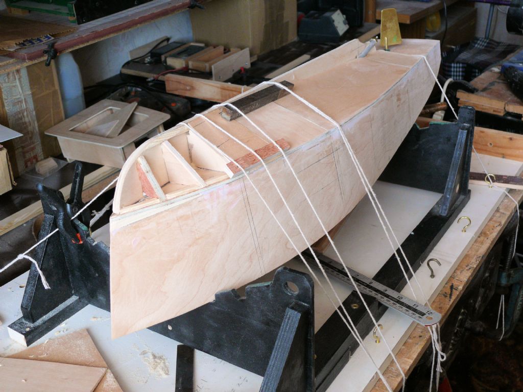

                      Now for the pointy area
                      Have fitted supports for vertical soft wood planking with filler to finish
                      Don`t fancy balsa wood as it`s in the firing line!

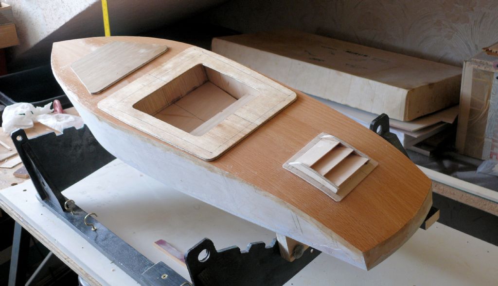

                      #95239

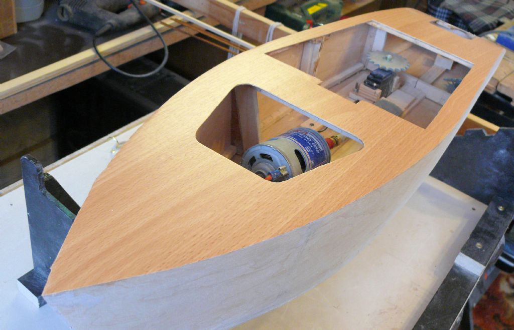

                        It`s alway`s great fun sanding down the hull carcass after the sheeting over and filling the joints etc
                        I can sit back now and enjoy the rest of the build
                        Now to decide the finishing off , Veneer decking and painted white hull will be acceptable
                        Don`t fancy sticking Fablon onto the curvy areas
                        #95275
                          Captain Bob
                          A planked deck and white hull is very acceptable and will look the dogs danglers. For myself I would have used old English white for the hull but that's just me being traditional.
                          The build is looking great.

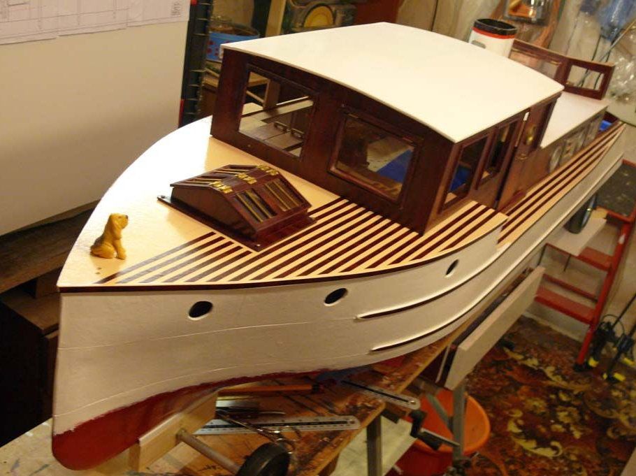

                          #95276
                            Absolutely agree with my learned colleague in that a white hull/wood topside is very acceptable. And yes an “old English” white might look nice.
                            Extra colour can be added by painting below the waterline using a contrasting colour…a nice British racing green or powder blue for instance (seen several examples here on the river).
                            Individual wicker seats might also look good in the cabin but may be tricky to make…
                            #95279
                              Thank you boys for your enthusiastic suggestions
                              Old English White hey?……Wasn`t aware we could get dark white and light white?
                              Can`t wait to get on the decor activity
                              Going to have a look round the local Toy Shops for possible plastic seats, steering wheels and crew etc

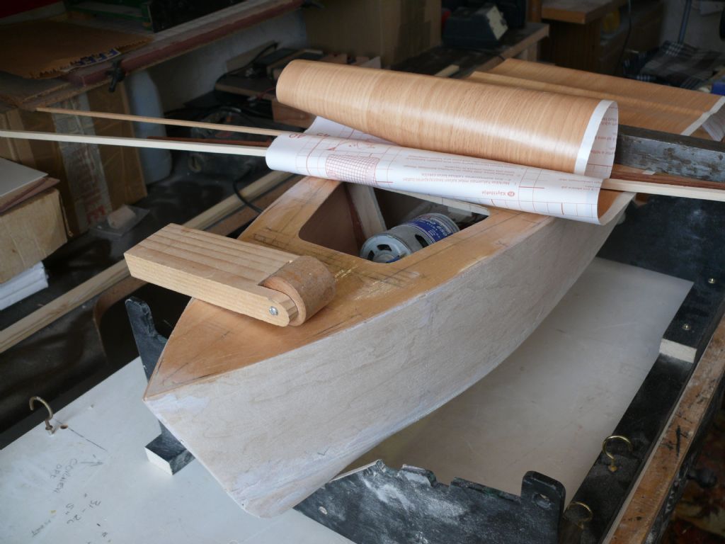

                                  Just about to the jump in at the deep end and lay the Fablon topside!
                                  It`s a bit nerve wracking for some reason, but it has worked out OK
                                  The sheet was laid laid out carefully on the hull, making sure it was lined up correctly
                                  About 12" was peeled off and carefully placed on the bows end and rolled flat
                                  Then another 12" was peeled off and pressed down with great care
                                  And so on
                                  Don`t start breathing a sigh of relief yet, as we`ve still got to trim off the surplus, very carefully
                                  Phew!……Job done
                                  I next gave the corners of the edges a good pressing down
                                  Now can stand back and admire the result
                                  Wow!
                                  Next job will be to apply a coat of Yacht Varnish to seal the edges

                                    Not telling you how to suck eggs but it would be advisable to test the varnish on a scrap piece of fablon just in case it reacts or doesn't stick to the vinyl surface.

                                      Paul, I`ve used this varnish method on my last three boats and there was no problem
                                      Thanks for the warning though, just to be on the safe side. I`ll try a piece, right now, just in case the varnish is any different from the last tin

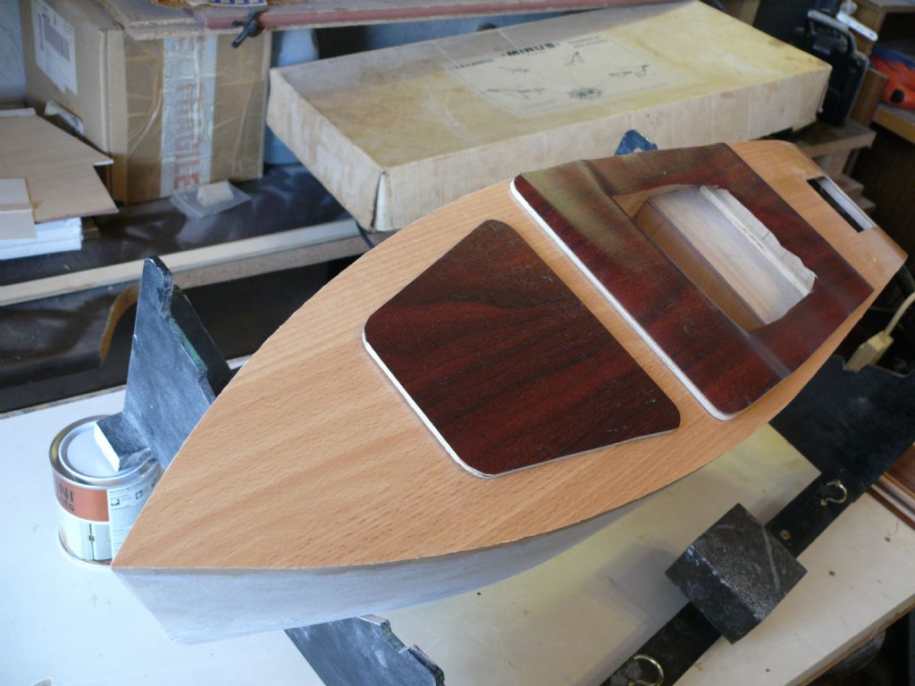

                                        Decision time once again, chaps
                                        The hatches and cockpit need to be Fablon covered
                                        The Fablon isn`t stuck down yet, but the contrast of colours look a bit severe?
                                        Any suggestions Ashley?

                                          That does look a bit severe Bob. How about cutting strips of the pale one and dark one to make a light/dark striped effect?

                                            I have to agree, I have decided to continue with the original Fablon wood pattern and add discreet white stripes, as required
