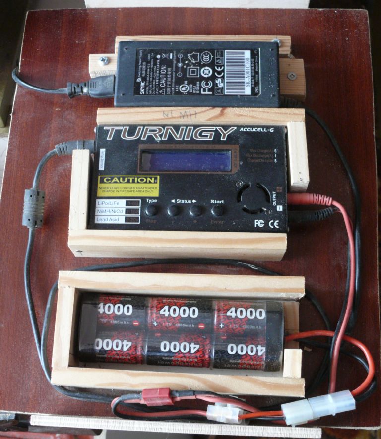

          Is this normal?
          I might have a problem with my charger?
          Today I charged a Ni MH rechargeable battery for the Slipper Launch with my Turnigy charger
          As I`ve done, dozens of times
          I left the charger running and returned about 3 hours later. knowing that the charger switches itself off, after charging
          Imagine my surprise, when I discovered the battery so hot, I couldn`t pick it up!
          It could easily have caused a fire!
          Any comments please?

                Just as a thought Bob…if one of the cells was duff, the voltage would never get to the cutoff point and the charger would continue to charge forever making the pack very hot…??
                #97319
                  Thank you Ashley……Brillo!
                  Your suggestion sounds plausible
                  But I`ve just checked the voltage of the two charged batteries and they read 8,10 volts and 8.5 volts
                  Mmmmmm?
                  The hot battery was the 8,10 volts
                  I still fancy your idea though
                  Will charge them again tomorrow and see what we get
                  Thanks Ash…..Bob
                  #97321
                    Bob, I would do a full cycle of a discharge and then a recharge. You can then see what the battery was holding before you started the process and what the charge is on completion.
                    Also worth checking all settings such as the charge rate wasn't inadvertently set too high or you had the wrong battery type set etc..etc..
                    Did the charger not switch itself off at the end of both charges or does it appear that just the one battery did not work correctly?

                          Mine is the same charger and like you I found it complicated at first and was nervous particularly as I was charging LiPos for the first time. I did wonder, as Richard said, whether any of the settings had been changed.
                          Having used mine quite a lot now, for different battery types and cell numbers, I'm very comfortable with using it now though some parts of the instructions are still gobblygook!
                          Could the "normal funny sound" be the fan which I find operates sometimes when charging NiMH? It only does it if the battery is pretty well discharged and not if it only requires a little topping up. The procedure it doesn't normally go though is puzzling though. Has it done it again since?

                            I think you need to check the charging rate as if too high (I use 2amp) then the battery will get very hot. Also how old is the battery? As they age the internal resistance increases which results in the temperature increasing more as they are charged.

                              If they are then it is likely that one or more of the individual cells have scummed to old age and failed.
                              For peace of mind and your safety it would be prudent to buy a new stick of batteries.

                                When I turn on my charger it shows the last used settings, in my case:
                                LiPo Balance CHG
                                2.0A 11.1v (3s)
                                For charging my NiMH I do this:
                                Press Type/Stop which shows BATT/PROGRAM LiPo BATT in the display. Use + & – buttons to scroll to NiMH BATT
                                Press Start/Enter which shows
                                NiMH CHARGE
                                CURRENT 2.0A
                                If not 2.0A or lower then press Start/Enter and the current will flash and can be altered using the + & – buttons.
                                Then press Start/Enter to set the value.
                                Finally hold down Start/Enter for 3 seconds and charging will commence.
                                It's a lot easier than it sounds and you can go back by pressing Stop or disconnecting the plug.
                                In theory you could charge at 4A or more but I wouldn't as that will make the battery hot. Does your charger (as older than mine) have a Discharge program or peak and cycle charging? Check the charge rate though first.
                                Hope this helps.

                                  Given that you said that the voltages achieved were 8.1v and 8.5v then that would support Paul's view.
                                  My battery is still charging and showing 8.51v and both the battery and charger are cool (not fully discharged from start of charging though) and should go to 9v for a 6 cell.
                                  The values you stated would indicate that full charge hadn't been achieved and why the charger hadn't turned off and why the battery got so hot.
                                  #97331
                                    Charging finished and showing 9.01volts. Battery comfortably warm.
                                    Looks like time for a new battery Bob!
                                    #97332
                                      I usually end up with around 9.0 to 9.2 volts at the end of a charge so I tend to agree that it is the battery on its way out.  You can sometimes recover them with a few complete cycles but you are probably only really delaying the inevitable!

                                        Just checked the two new batteries and they are still showing 8.2 volts
                                        The charging rate is set at 2.5 amps
                                        Please remember chaps, that the battery that got seriously hot yesterday was one of the newish batteries
                                        So we are "not out of the woods yet"
                                        Will be extra careful from now on. Will now charge the next newish battery and see what happens……In the garage of course!
                                        #97334
                                          Bob, one characteristic of NiMh batteries is the fact that the voltage drops off significantly as soon as charging is complete. Over night it will drop noticeably. You need to check the voltage as soon as you finish charging to see just what they get up to. If you leave it until the next day to check the voltage you may well see a drop of around a volt or so.
                                          A healthy one should finish at around 9V but there is also quite a variation in final voltages so that is only a guide.

                                            Just charged up the third newish batteries chaps and it took 24 mins and peaked at 8.91 volts
                                            It was still charging when I pulled the plug, as I was getting rather cold in the garage!
                                            The battery showed no signs of warming up
                                            Anyway chaps, panic over now that I`m charging in the garage again
