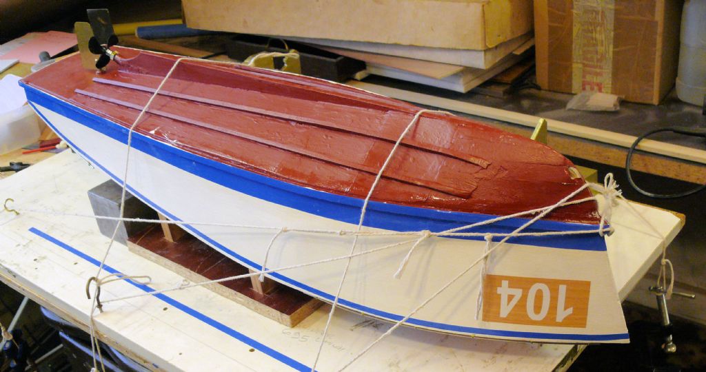

                      Got the hull lashed down in position for repair, but now realise that the lower hull is sealed off from the upper section!
                      Will have to turn her over and cut access holes in the top floor for a good dry out
                      Not much of a problem,

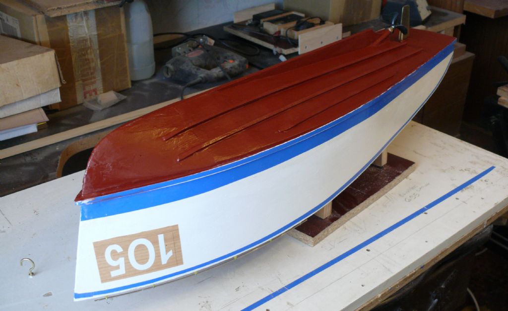

                                                No luck with history search on the Brutus 11 problem motor history and it was only July, last year?
                                                Any way. the hull is now water proof……Famous last words…eh?
                                                And can now get on with finishing the cockpit ensemble
