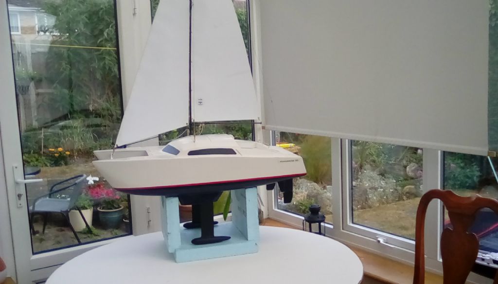

          Putting the removable fin keels together today and as each one weighs 2 lbs I was getting cold feet above how she would sit in the water relative to the scale waterline, but happy days she sits 3/8" above so some margin for the radio gear.

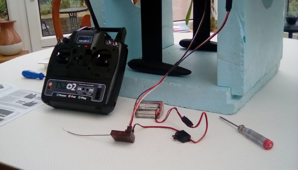

                        Getting close to having a sea worthy cat to sail 😎 just fired up my new wireless set and all is well, it's actually the Planet TS2+2 with the normal 2 function sticks plus 2 more proportional functions, only 4 AA's in the transmitter 👍 I have quite a few of this type of budget sets, the Duracell batteries will last for ages.

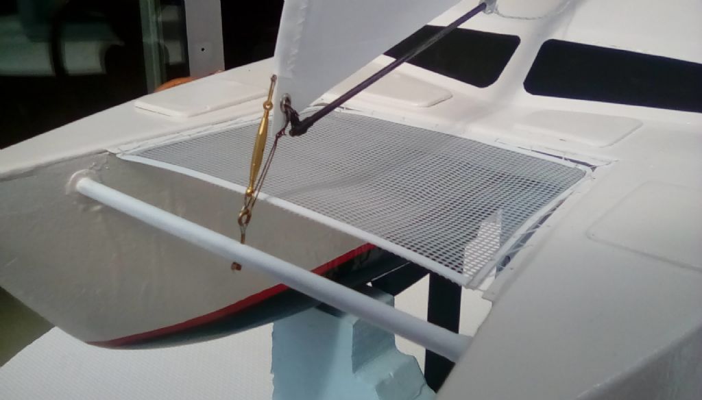

                                      It's not that often I think I may have had a good idea !! But here goes, for the trampoline between the hulls on a cat which enables access to the forestay and good sunbathing platform 😎I have used a non slip rubber mesh sold to go under rugs & mats to stop them moving, with glued on plasticard border drilled and laced onto the hulls 👍⛵
                                      Comanche has been sailing this morning I will post photo's this evening. ⛵👍,
