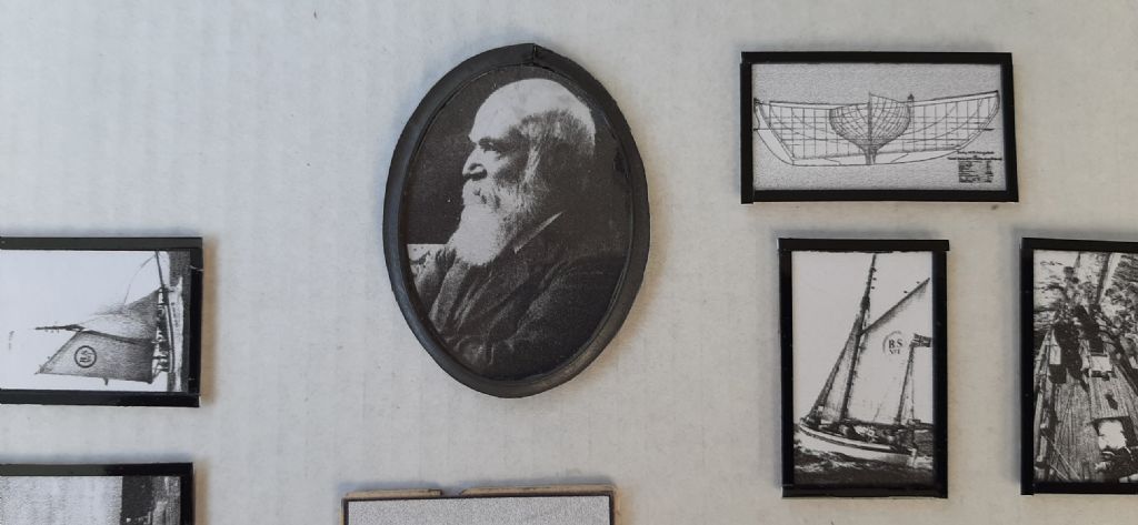

              This is the guy who's been causing all the 'trouble' recently. Colin Archer's parents emmigrated from Scotland to Norway in ca1825. He was the 12th of 13 children, which is probably why he and some of his brothers later emigrated to Queensland, Australia! Anyway back in Norway in 1860 he started studying boat design and construction. His mugshot – as on the fullsize- is going to hang on the saloon forward bulkhead. I've been buisy with the scanner and printer to reduce the size of photos/drawings and framing them with gloss black polystyrene strip. Frames shown are not trimmed off yet. The oval frame is made from car wiper-blade rubber. George20210828_152137.jpg

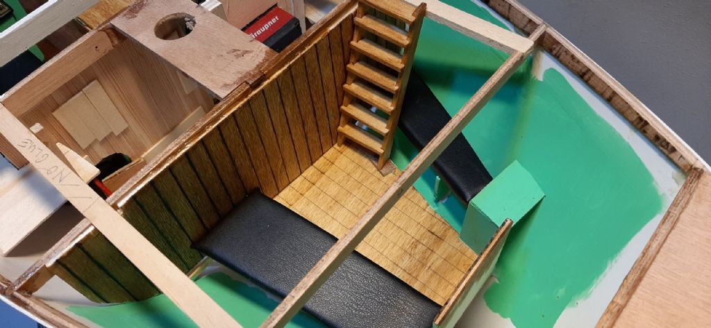

                      20210912_164649.jpg20210912_164711.jpg20210912_163245.jpgAfter much deliberation we concluded -for the second time this year- not to replace the flooring in the flat. The approaching subdued, autumn light will help to hide the scrapes and dings for at least 6 months!
                      So…. threw some more oak planks into the aft section. Companionway steps placed against the engine cover to which it will be glued after staining. The soldering iron is now up from the cellar so there will probably be some R/C installation during the week.
                      The workbench to port was cut .5mm too short so I had to hold it in place for the photo!

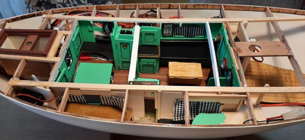

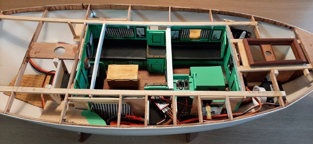

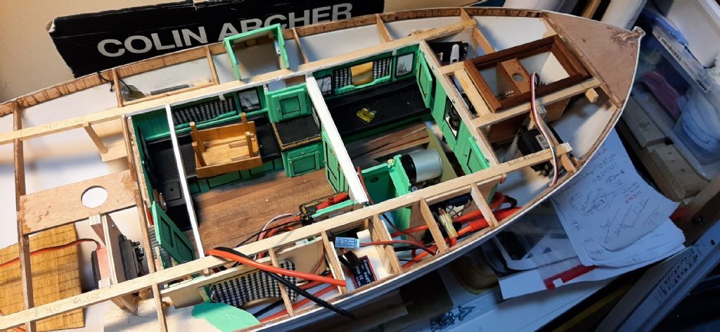

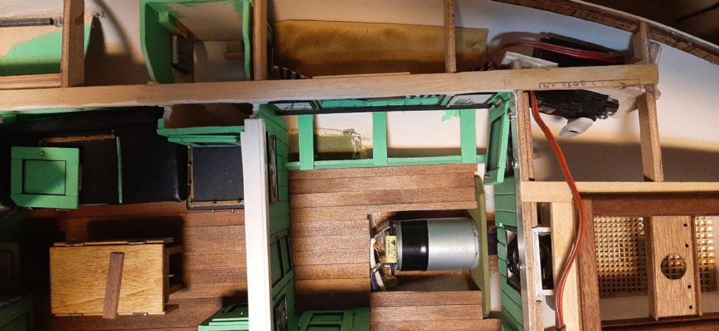

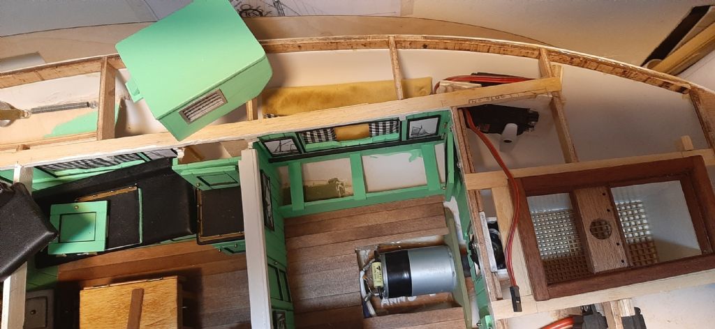

                                    20220114_154609.jpg20220114_154647.jpg20220114_154928.jpgManaged to get a little progress this week. R/C gear now installed in lockers and beneath benches. The dreaded soldering work is at last completed. Had to make several extension cables for servos and drive battery and motor.
                                    Colin Archer will be launched as Colin Hatcher I think. Hiding the R/C means that I need several extra deck hatches to give access to the R/C. Hope I can make them all watertight-ish.

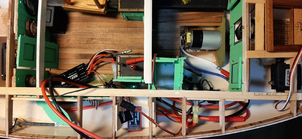

                                      20220114_154629.jpgDidn't post the right photo here -to show wiring. It's not actually much compared to a fully rigged 'Happy Hunter' or similar.I think it's just constructing the interior which makes me feel it's all been 'uphill' for a while. Be glad when the deck plate is on and I can start planking it…..oops, I see from the photo that there's still a forward cabin to imitate. This will be viewed only through a small hatch so don't need too much detail there. Forecabin sole is done at least.
                                      George

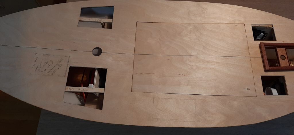

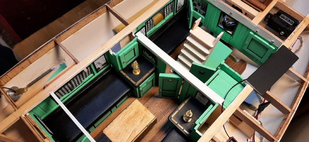

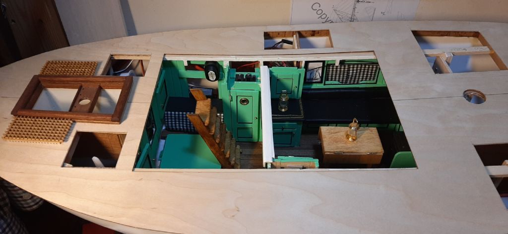

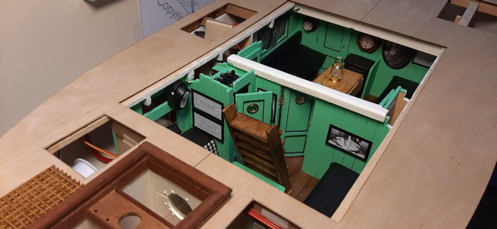

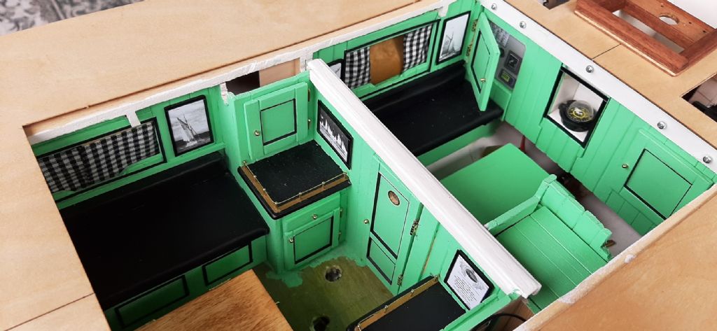

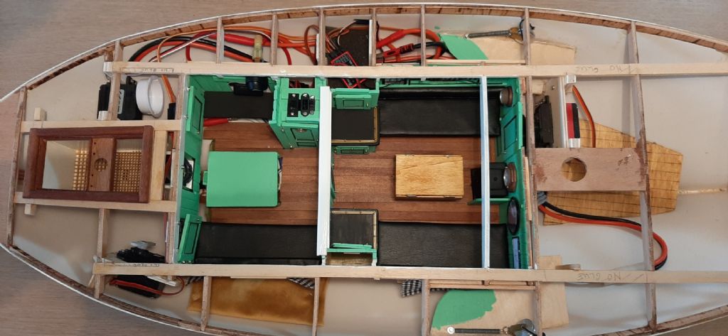

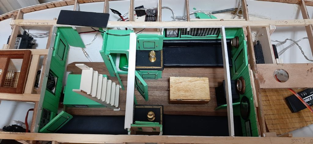

                                        20220115_143052.jpg20220115_143217.jpg20220115_143240.jpg20220115_145914.jpgIt won't be long now until the spagetti gets packed becomes obscured. The workshop is now called 'The Hatchery'. Any more hatches and I won't have a deck!
                                        Have to get the servos connected to rudder, boom-ends, and clews during next week. Then the deck will -I hope- get glued onto the hull. These will be the last of the interior detail photos you'll be glad to readyes
                                        The companionway steps look strangely placed, but they fit into a deck hatch which is removed when the main deck hatch is lifted off. The main battery switch and the fuse are a bit prominent above the aft workbench but these need to be quick-accessible. Maybe some green paint applied to the switch will help to hide it a bit?  PS. Last two pics are with main hatch frame removed. This lifts off together with the hatch of course…when they eventually get glued together! George20220115_150208.jpg

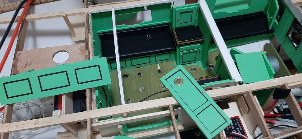

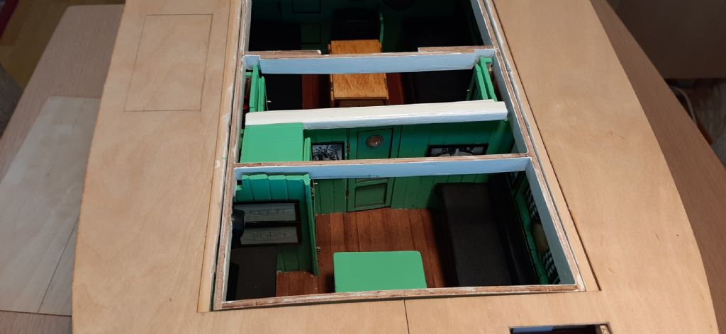

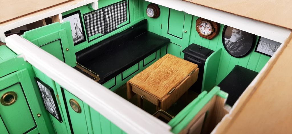

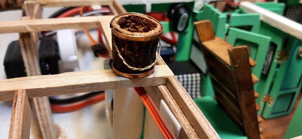

                                                20220120_163452.jpg20220120_163430.jpg20220120_163730.jpgJust as I thought that the detail was finished, a basic need cropped up…. The original Colin Archer of 1893 had a bucket placed beneath the main companionway steps. This bucket was called "SIRI" -haven't found out why yet. When the original CA was later fitted with an engine, a pump-loo was fitted into a heads compartment. My personal version has of course a motor where the bucket used to be! So that's why the bucket is now in the heads compartment.
                                                George

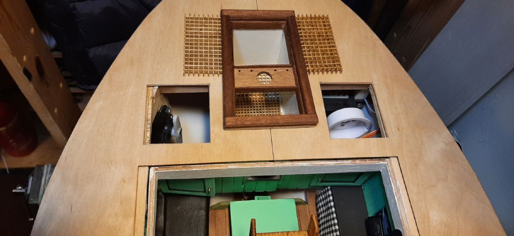

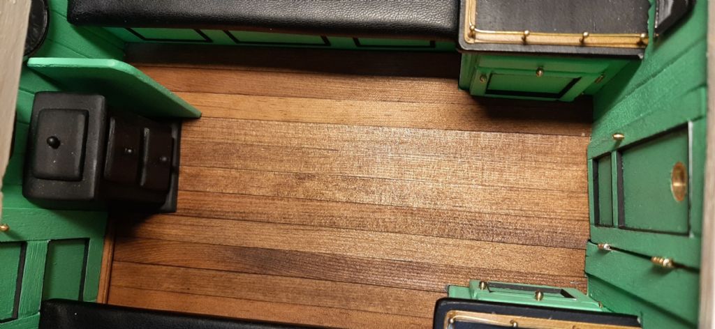

                                                  20220120_164029.jpgA basic forward cabin has been constructed,. This will only be viewable through the small hatch at the top of the forward companionway steps so very little detail has been added. Through the hatch I expect one will see the planked cabin sole, a bit of panneling and maybe a bit of black bench20220120_164035.jpg.George

                                                    gecon
                                                      @gecon
                                                      Hi Ray,
                                                      The removable, relatively large, deck hatch will of course allow some insight -when it's lifted off.
                                                      I'll take a few more close-ups before glueing on the main deck. This will allow me to see all the nooks and crannies later if I need to get at any feature for repair.
                                                      After the deck's on, it will be possible to make use of a mini inspection camera to lurk through the interior and show it on the PC. I don't think there will be a long queue to see this though.!
                                                      Trying to model the interior was not even thought of when I started the build. It's become almost an obsession to add more detail—-just so I can hide it! Although I have made the old bucket, there'll be NO further detail added to that! The wroughly cut (wine!) cork already gives the impression that there's something in there, but that was not planned.
