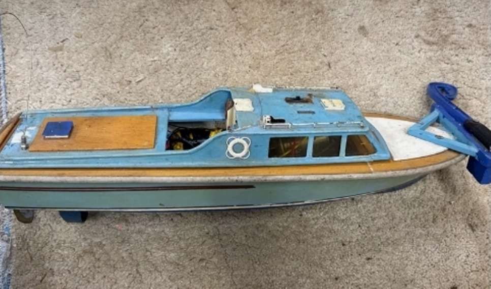

  • #124764

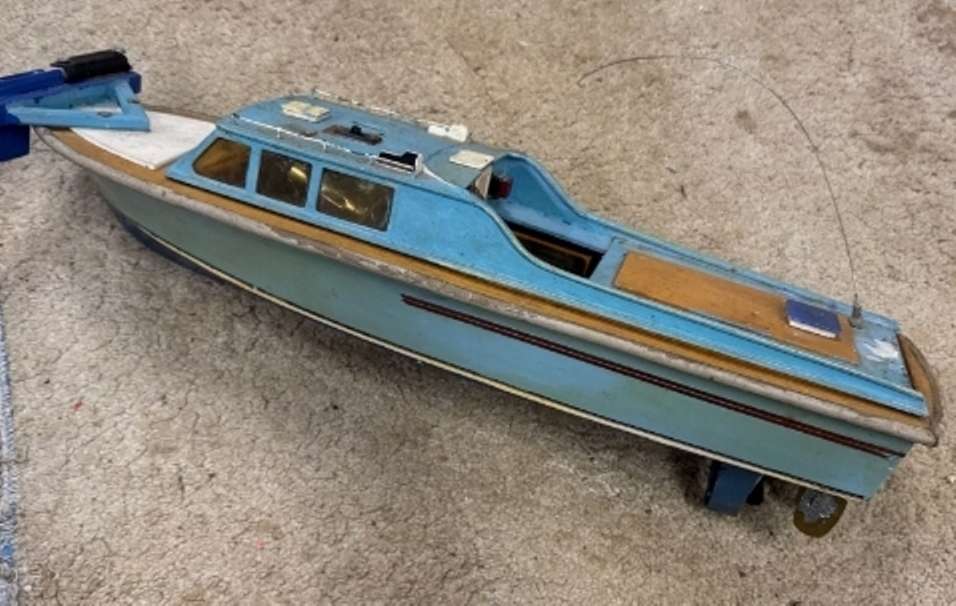

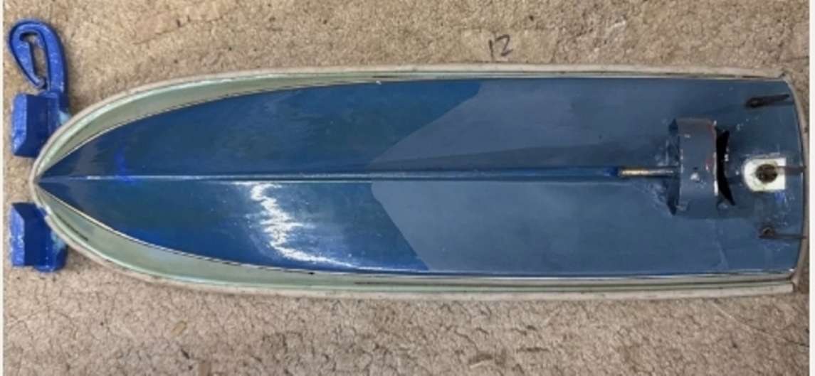

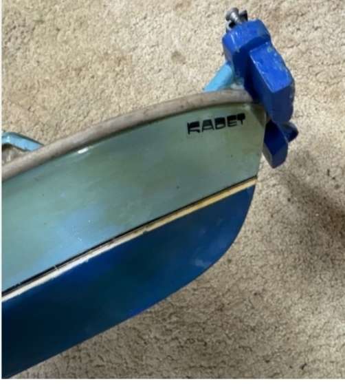

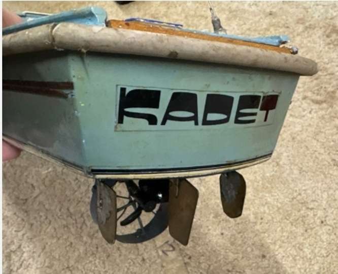

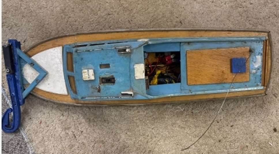

      Hi Lads
      I bought  the worse Kadet off Flea Bay!!!!
      I was one on my bucket list.
      So the pictures show how bad it is !!!!
      Harryk8k1k2k3k4k5k6k7
      #124765
        Looks like it has been used as a ‘rescue’ boat.
        #124767
          Hi Colin
          Looks like now it requires rescue-ing by far !!!
          Saved from a rubbish bin.
          I started removing all the bits.
          One lot to keep and the other in the bin.
          Old vanish over paint with vanish on top on ABS hull to be removed ??

          #124768
            Could be a problem. Might be best to sand it down and repaint. Paint remover could damage the underlying plastic.

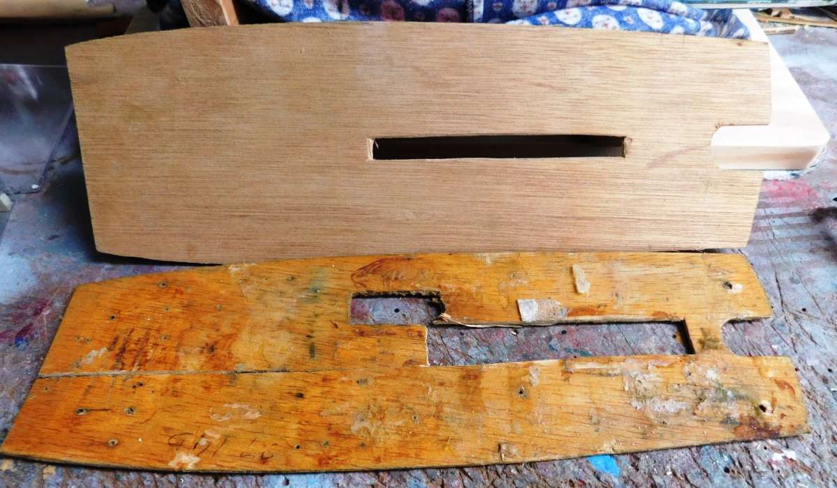

            #124788
              Hi Colin
              Yes, just what I thought !!!
              I have tested out scrapping with a knife blade and 80 grit sandpaper.
              It works, but it’s going to be a long job.
              But I will replace the inner floor and frames plus a few stingers to strenghten up the hull.
              HarryReplacement floor

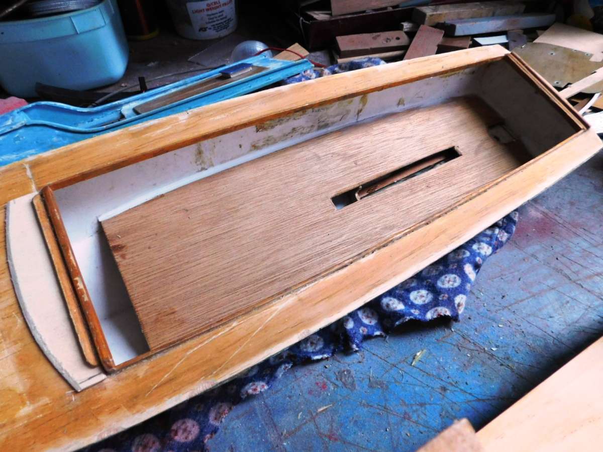

              #124846

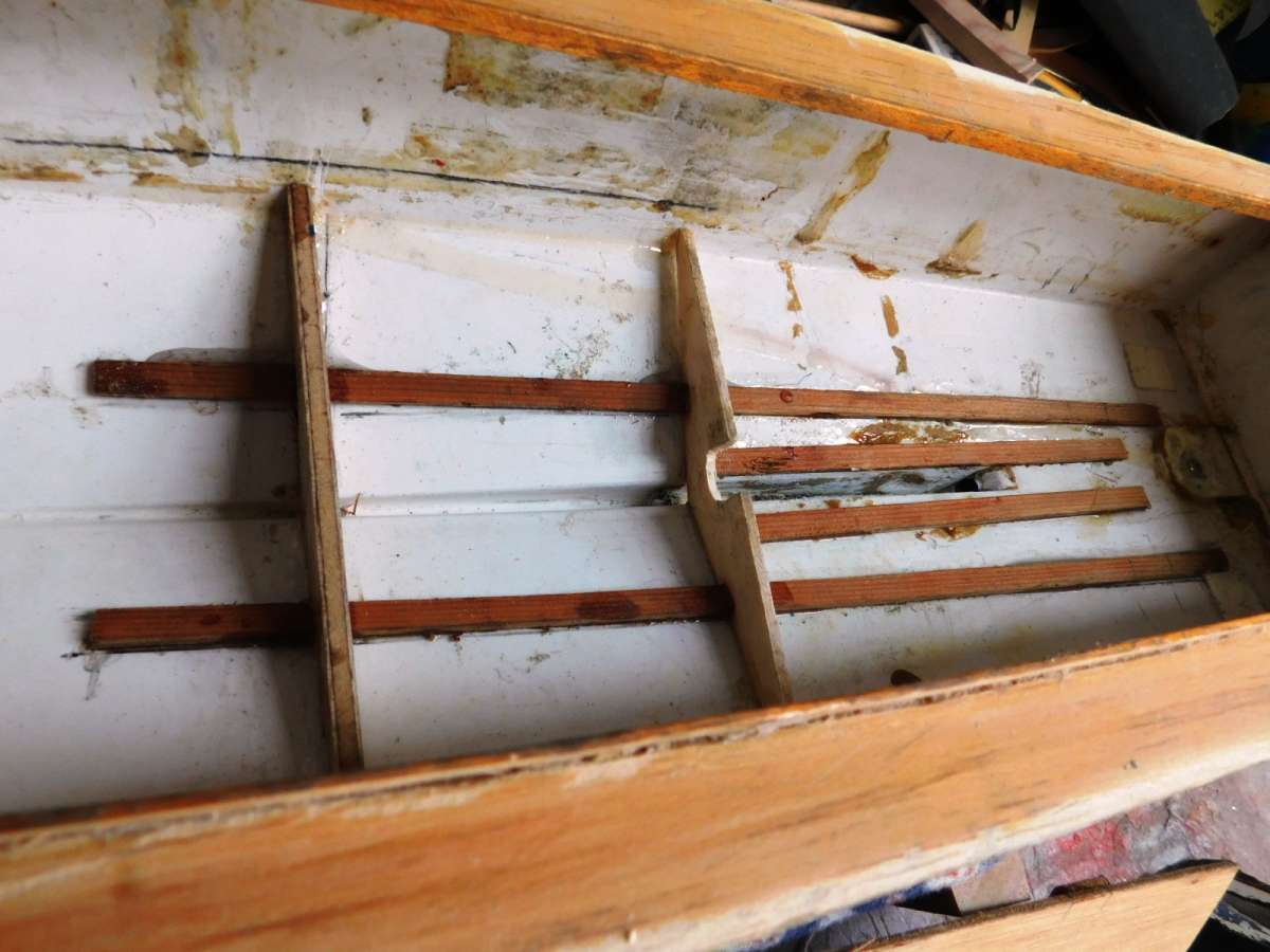

                Hi Lads
                Replaced the hull frames with new ones and added four stringers to straighten up the hull.
                It has a few waves in the bottom of the hull.
                HarryNew floor and hull supports

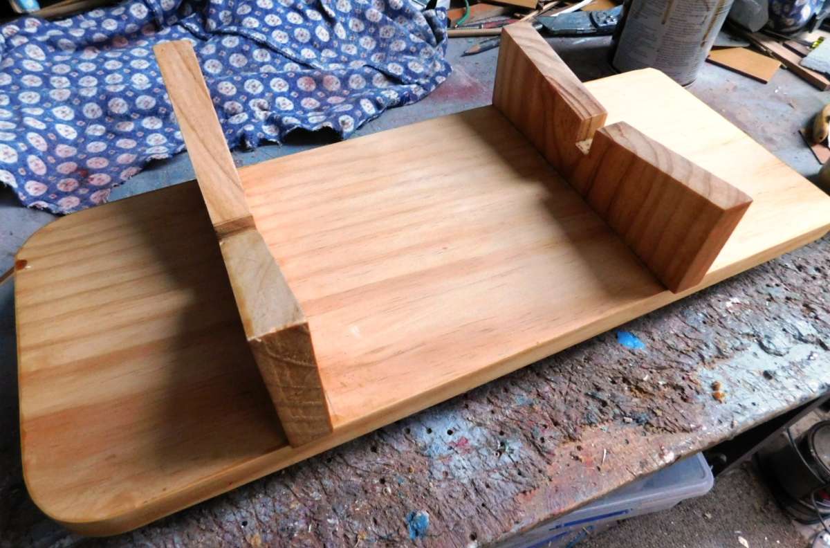

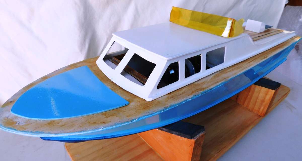

                #124869

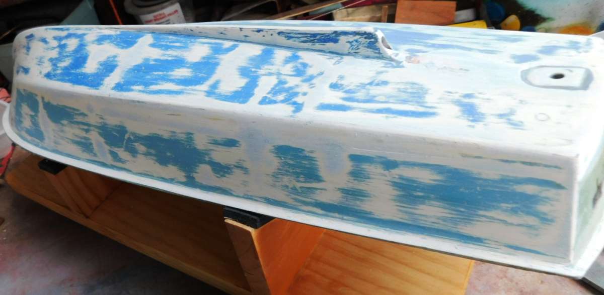

                  Hi All
                  Finally glued the deck in, now sanding off the paint with 80 grit sandpaper.
                  Also started on making a stand for the boat.
                  HarryNew Floor installedNew stand

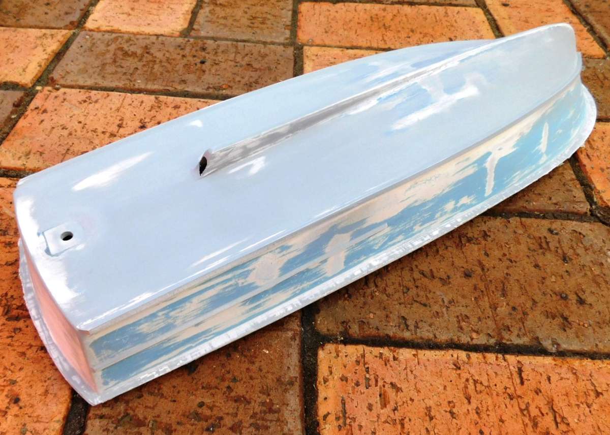

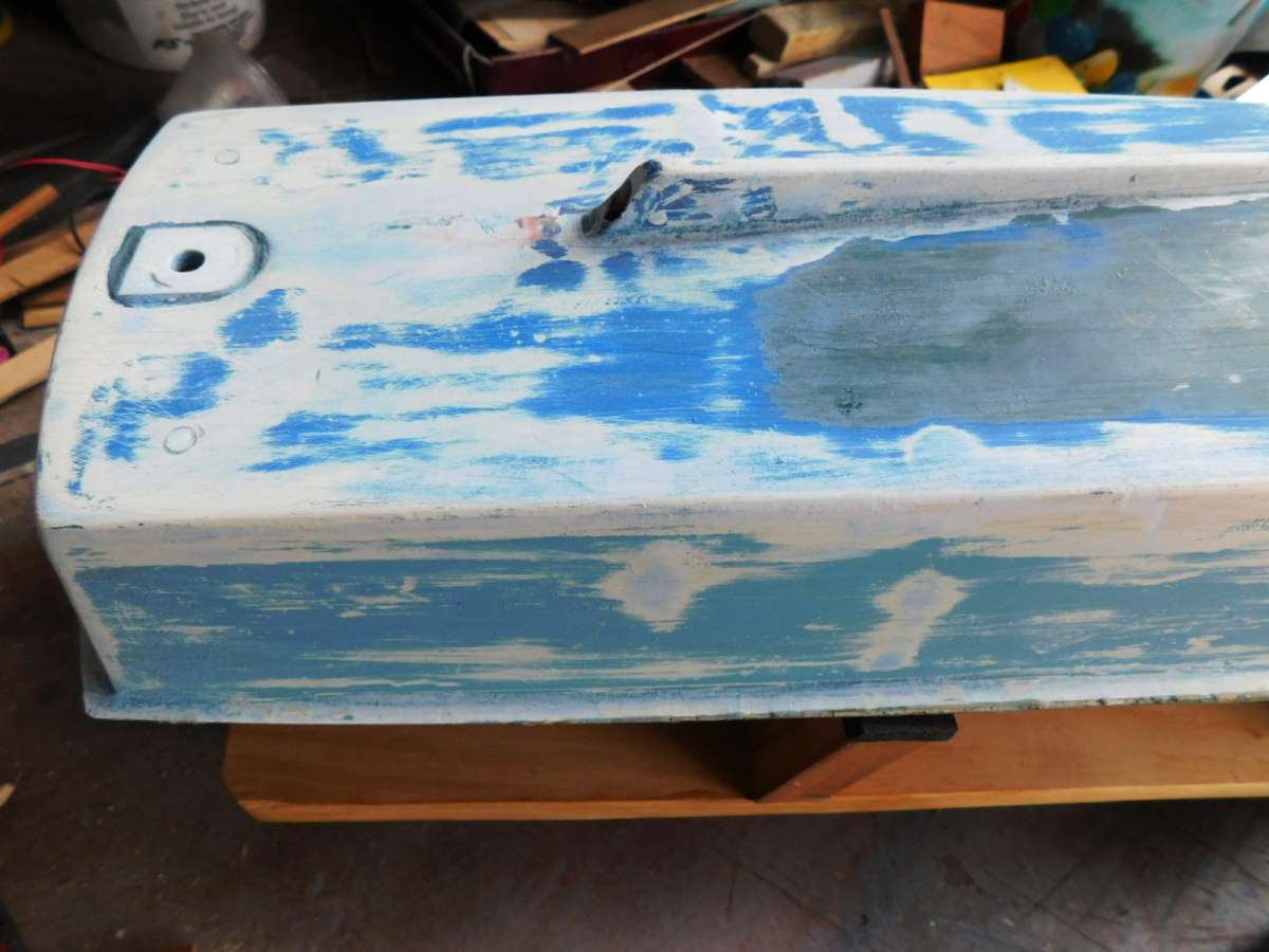

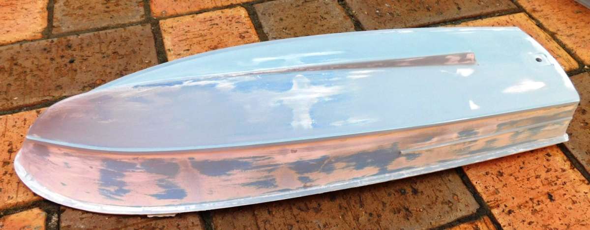

                  #124940

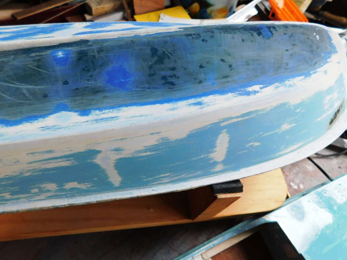

                    Hi Ewe Guys
                    Well sanding, sanding with scrapping and more sanding !!!!
                    I found a boat hull !!!
                    So next is filling the waves in the bottom of the hull.
                    Guess what, more sanding !!!
                    HarryRudder holes filledPaint removal 1Paint removal 2

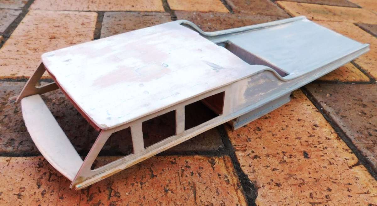

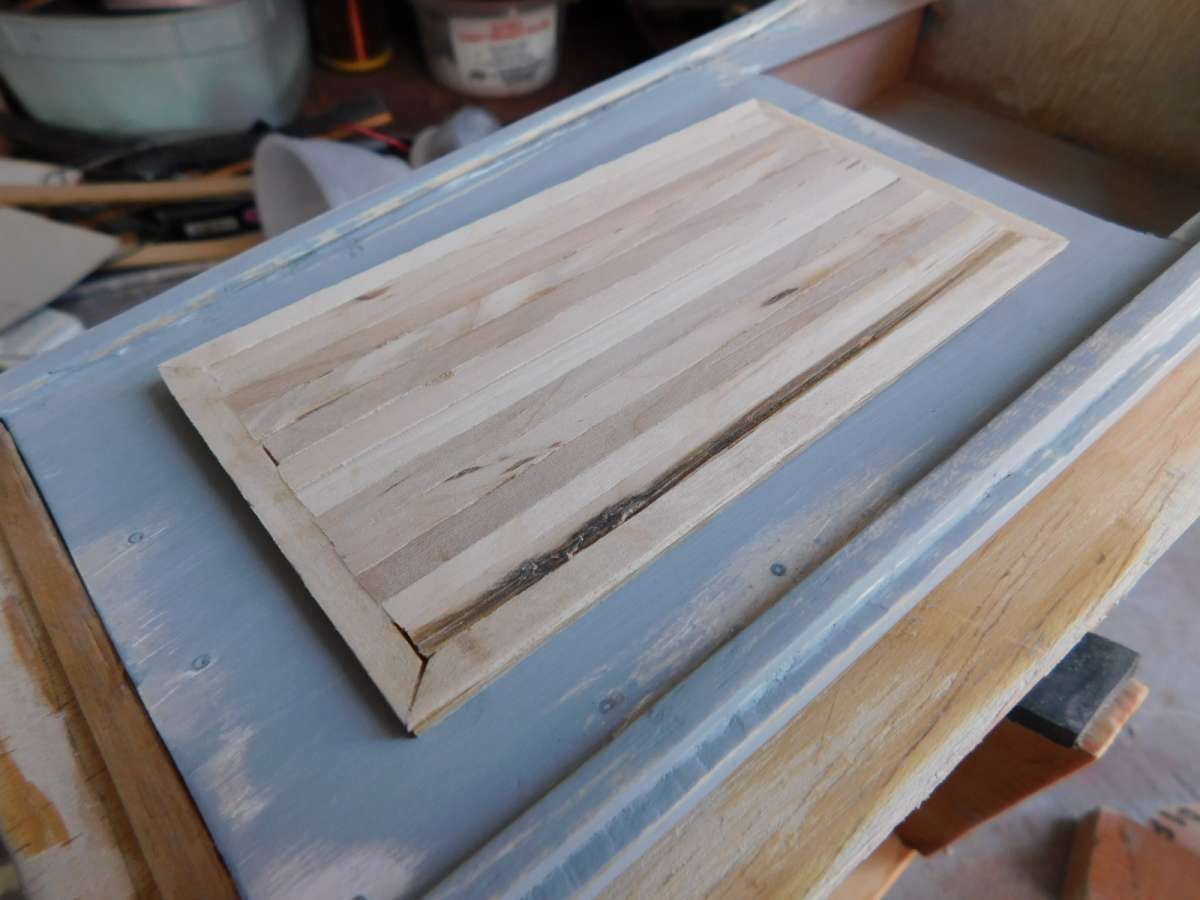

                    #125026

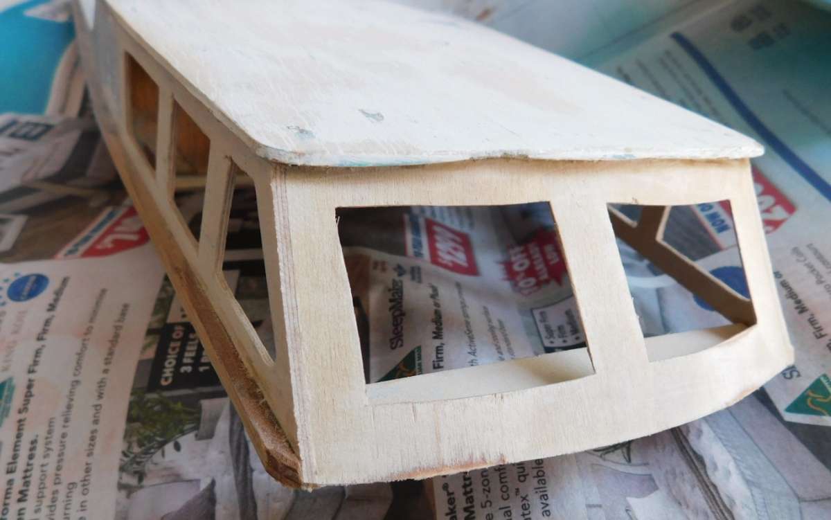

                      HI All

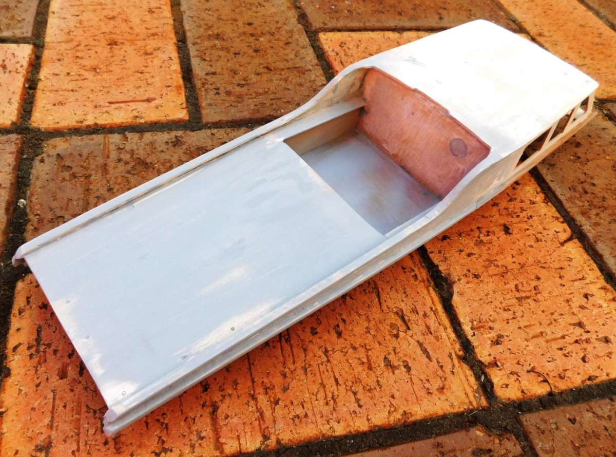

                      Had to replace part of the sides on the cabin plus the whole front.
                      Also installed the missing wheelhouse floor.
                      With a lot of filling and sanding the hull is starting to get back in shape.
                      I also added chine rails which are a lot easier to add with no deck.
                      Plus being plastic clamp into place and run the glue along the joint.
                      When dry remove clamps and add glue to the missed areas.
                      Interesting working in plastic for the first time !!!!
                      I did not like the stern hatch, so I made a new one with thin plywood and decked with coffee stir sticks.
                      HarryCabin 1Stern HatchCabin 2Hull 1Hull 2

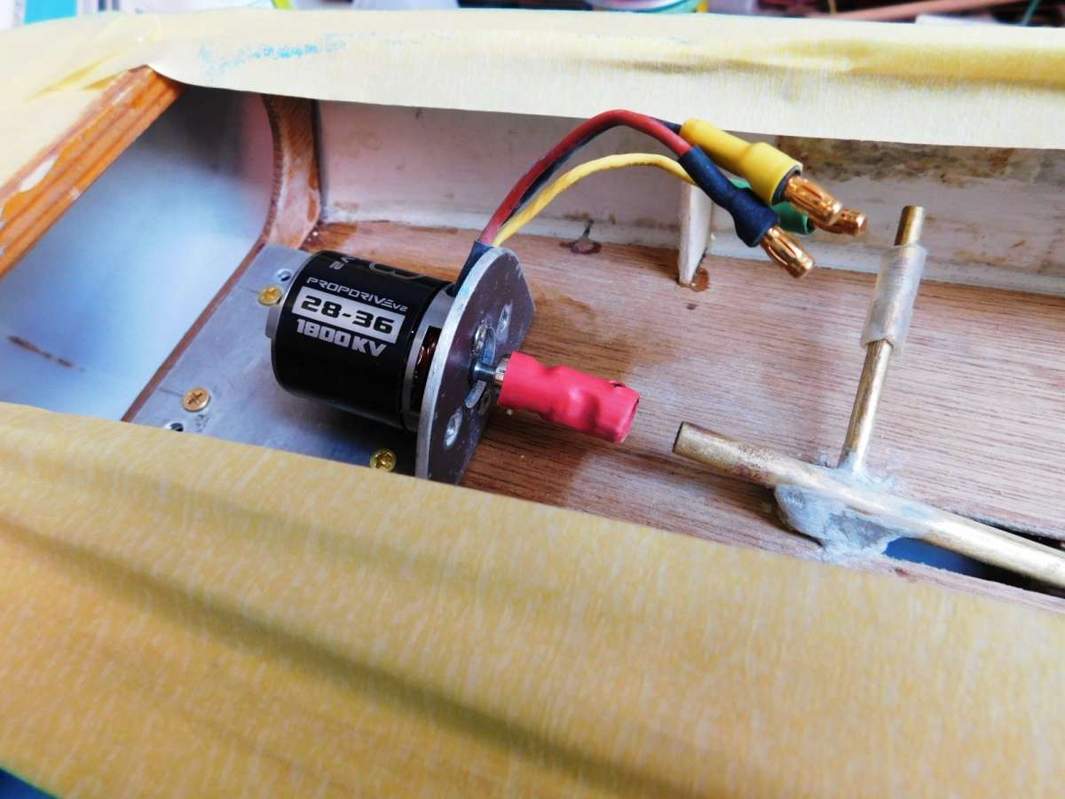

                        #125076
                          Hi Ashley
                          I think it’s the most knackered boat that I have ever had a go at by far.
                          I sold both my Sea Scout and Diva boats without the motors and ESCs.
                          So one set is going into the Kadet.
                          28mm 1800kv, 45Amp ESC but only 2S lipo.
                          I had the Diva on 3S and it got christen the FLYING FLEA !!!
                          I have a Sea Rover arriving next week.
                          Looks better than the Kadet.
                          HarryHarry Diva

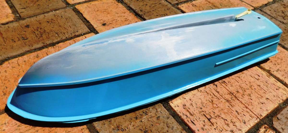

                          #125086
                            Hi All
                            Well finally some paint on the hull sides !!!
                            Motor installed and the cabin has a front.
                            Next up is install the drive line and paint the hull bottom.
                            HarryHull 3Motor installedNew cabin front

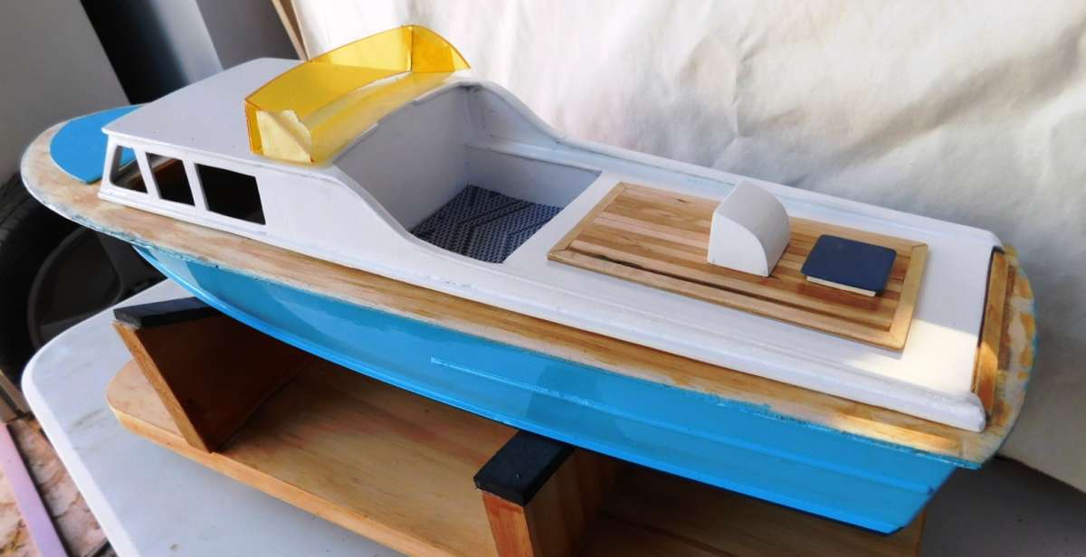

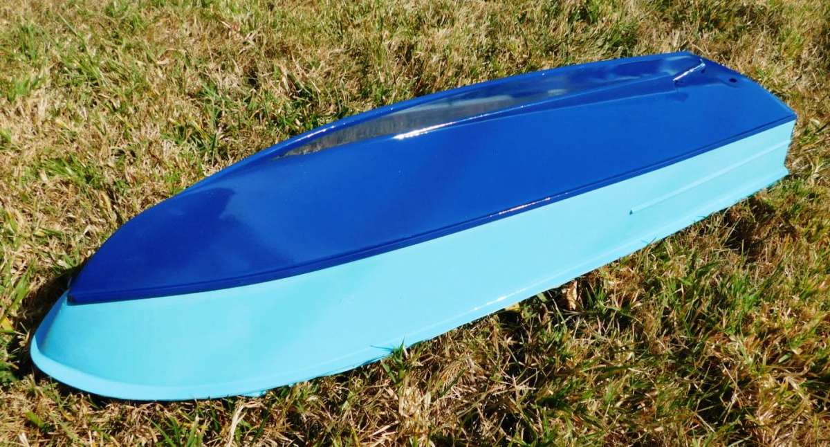

                            #125096
                              Well Gentlemen
                              I am seeing light at the end of the restoration.
                              I sat a few bits on to see what the boat will look like.
                              The one piece curved windscreen always fun to make !!!!!!
                              Matching curved window for the cabin front and easy straight ones for the cabin sides.
                              I do have the front cabin hand rails, so another problem is making the stern hand railings.
                              HarryStern ViewBow ViewHull 4
                              #125122
                                Hello Gentleman
                                It’s time to stick a few bits on the boat including the final install of prop and shaft with the rudder.
                                HarryStern viewTop ViewBow View

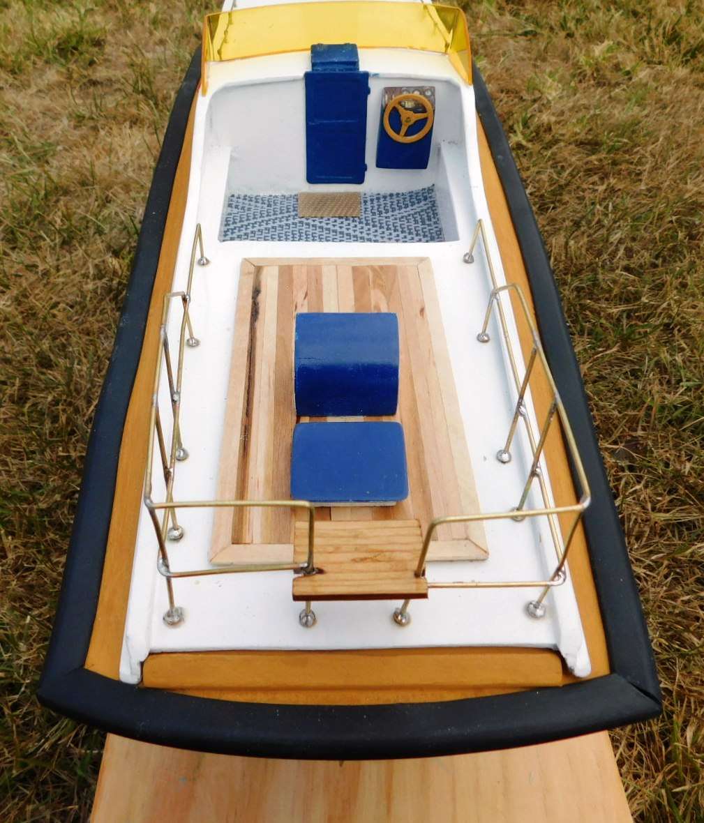

                                    #125148

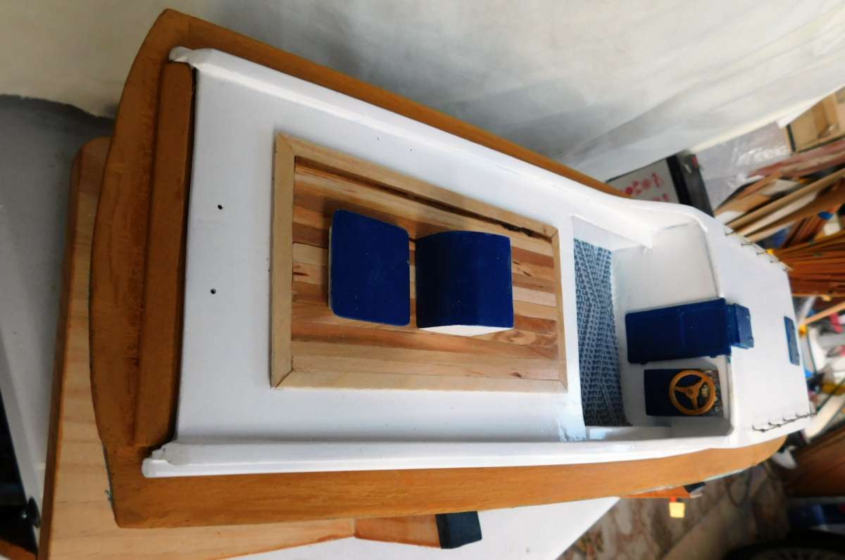

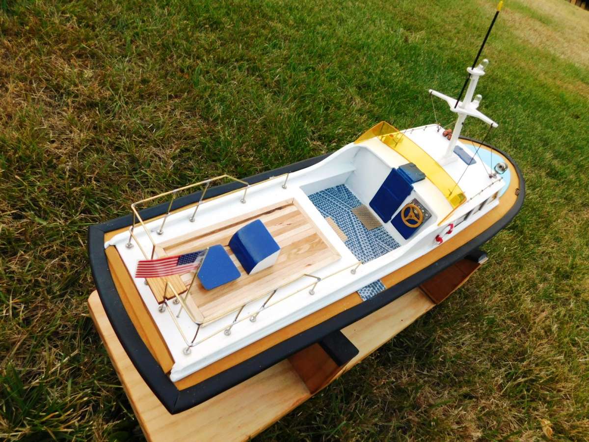

                                      Hello All
                                      Started really adding on bits and pieces also found out I missed some !!!
                                      So the mast mainly, so I printed out the Billings page and cut that out.
                                      Scanned it into the laptop and by using the file as a PDF, I resized it to 200% after a few goes.
                                      Looks the right size going on one of the hatches and the steering wheel.
                                      Eight pieces, really, so I used 4mm western red cedar for the main section with 2mm plywood for the rest.
                                      As I am not having wired up lights, I am cutting the wires from LED lights for lights.
                                      I have an old searchlight with no wires, so it looks like that will do.
                                      HarryStern View 3Bow View 1Stern View 2

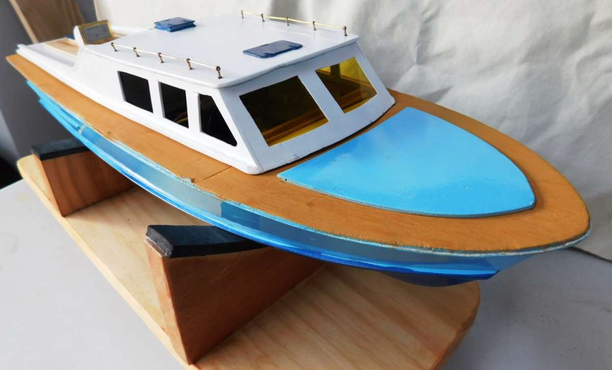

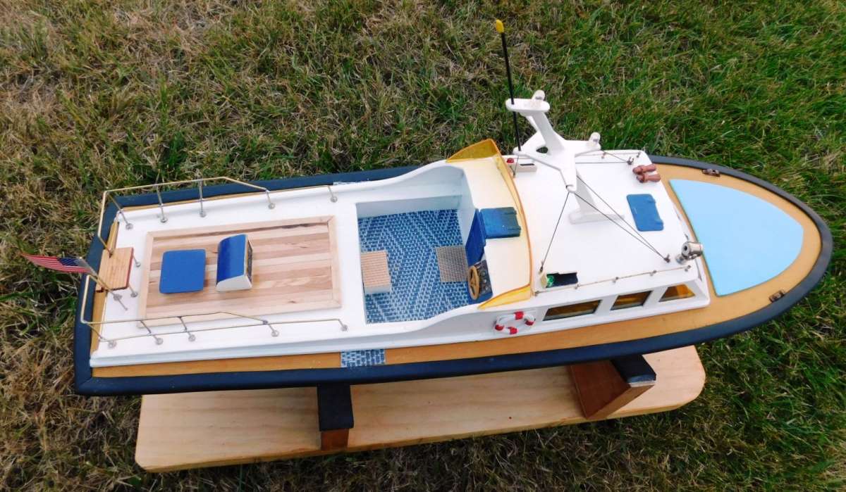

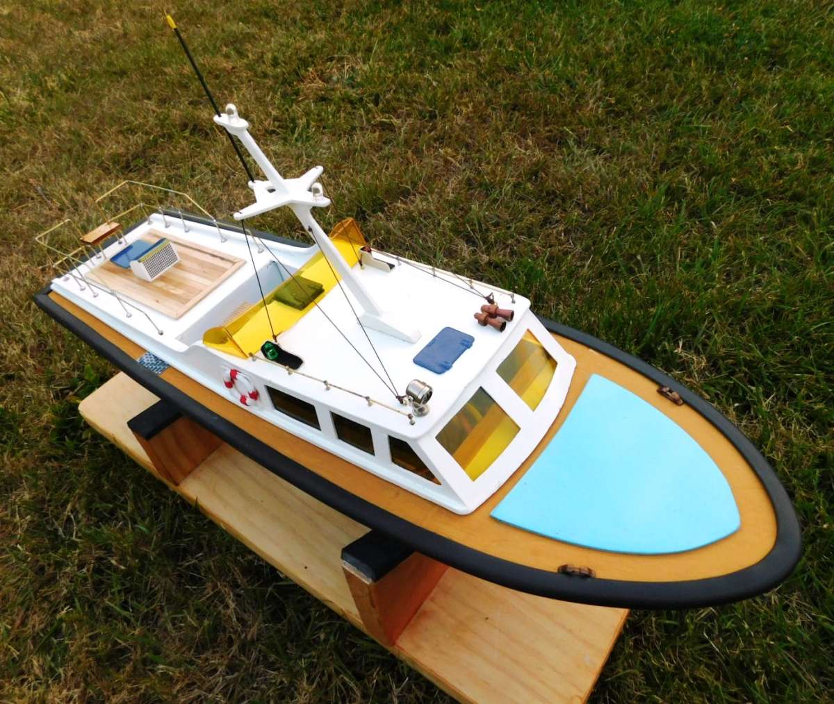

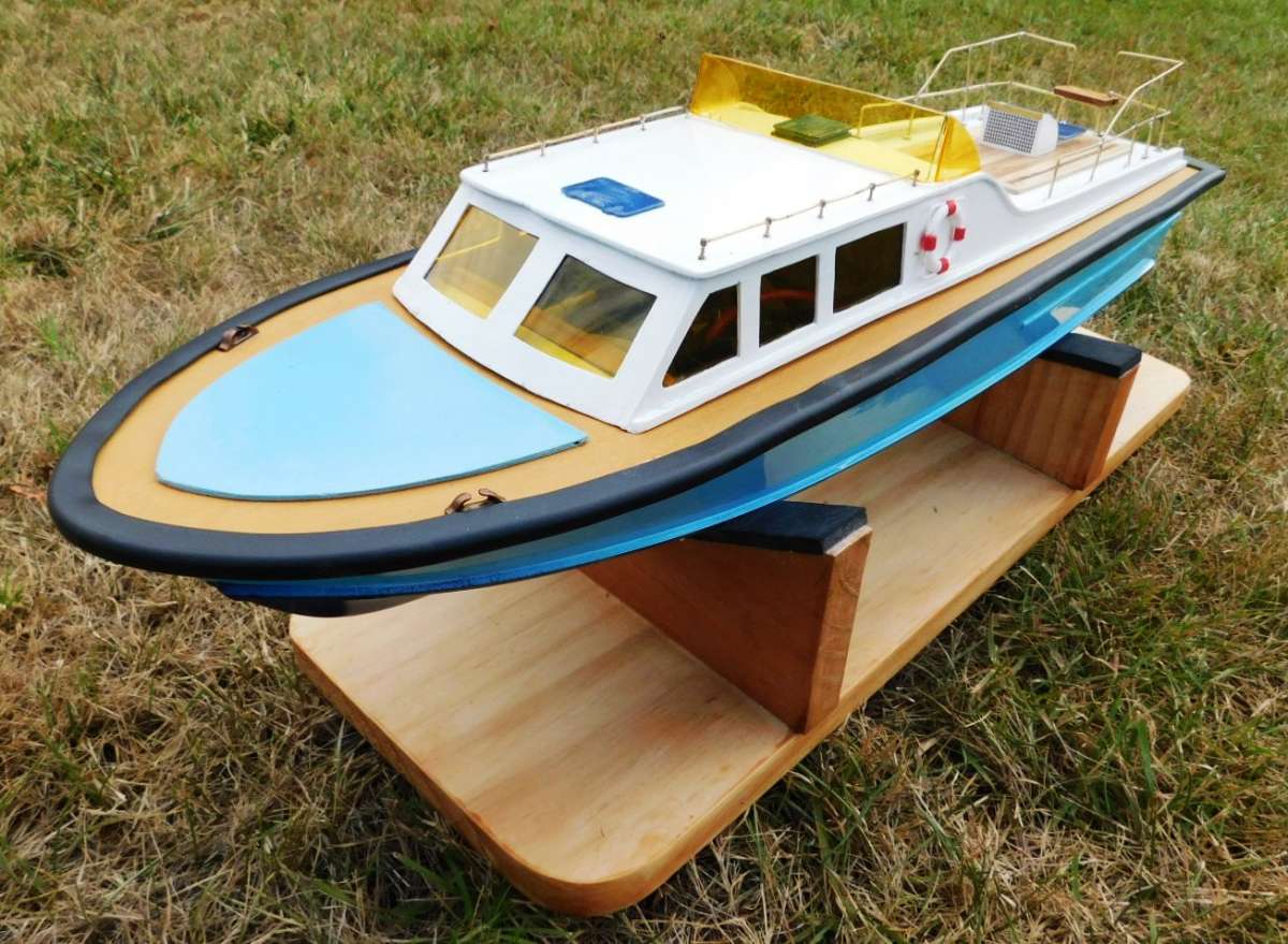

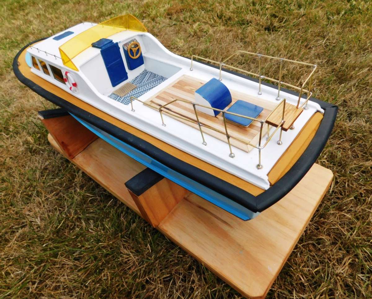

                                                Hi Me Lads
                                                Just finished the boat this afternoon !!!
                                                Only require setting the batteries in place.
                                                Using two 3S 80mm long Lipos (1500mah) because the wheelhouse floor limits a larger standard battery.
                                                HarryTop viewBow view 2Stern view 4

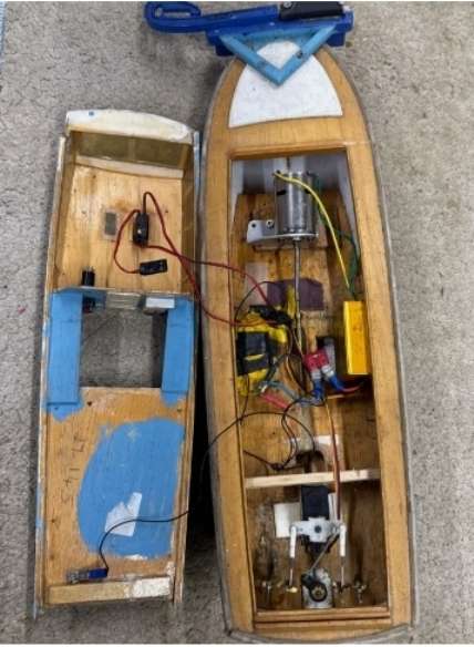

                                                #125327

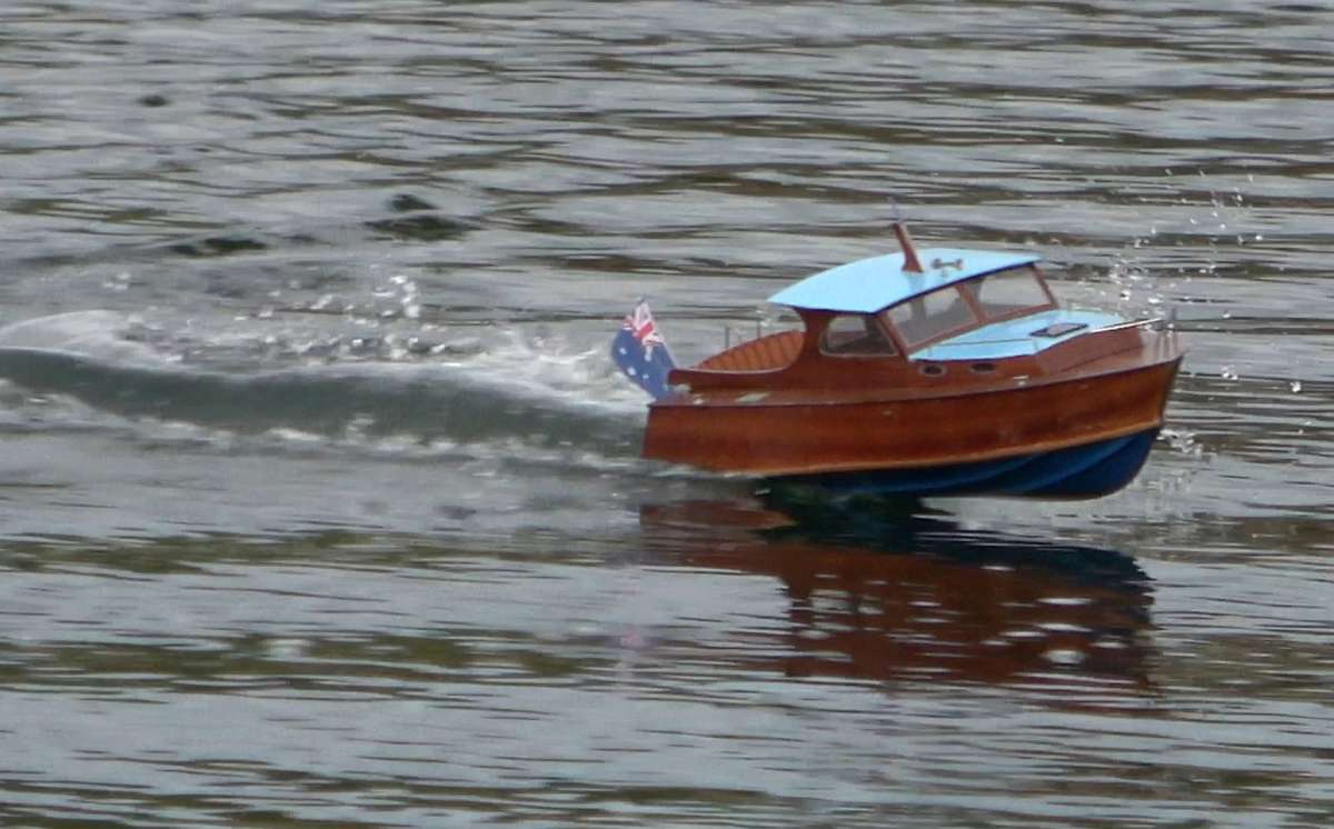

                                                  Hi All
                                                  Thank you all for your replies.
                                                  I ran the boat for the first time and other than moving the battery back a bit the boat run well.
                                                  I am not getting full power out of the motor, but has a good scale speed look.
                                                  So I had started my next restoration after the boat arrived 10days later.
                                                  This one is in better shape, all real wood and Birch plywood !!!!
                                                  HarryHarrys Kadet 3Harrys Kadet 1Harrys Kadet 2
