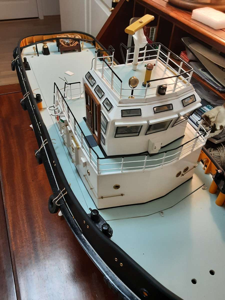

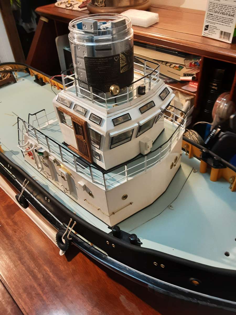

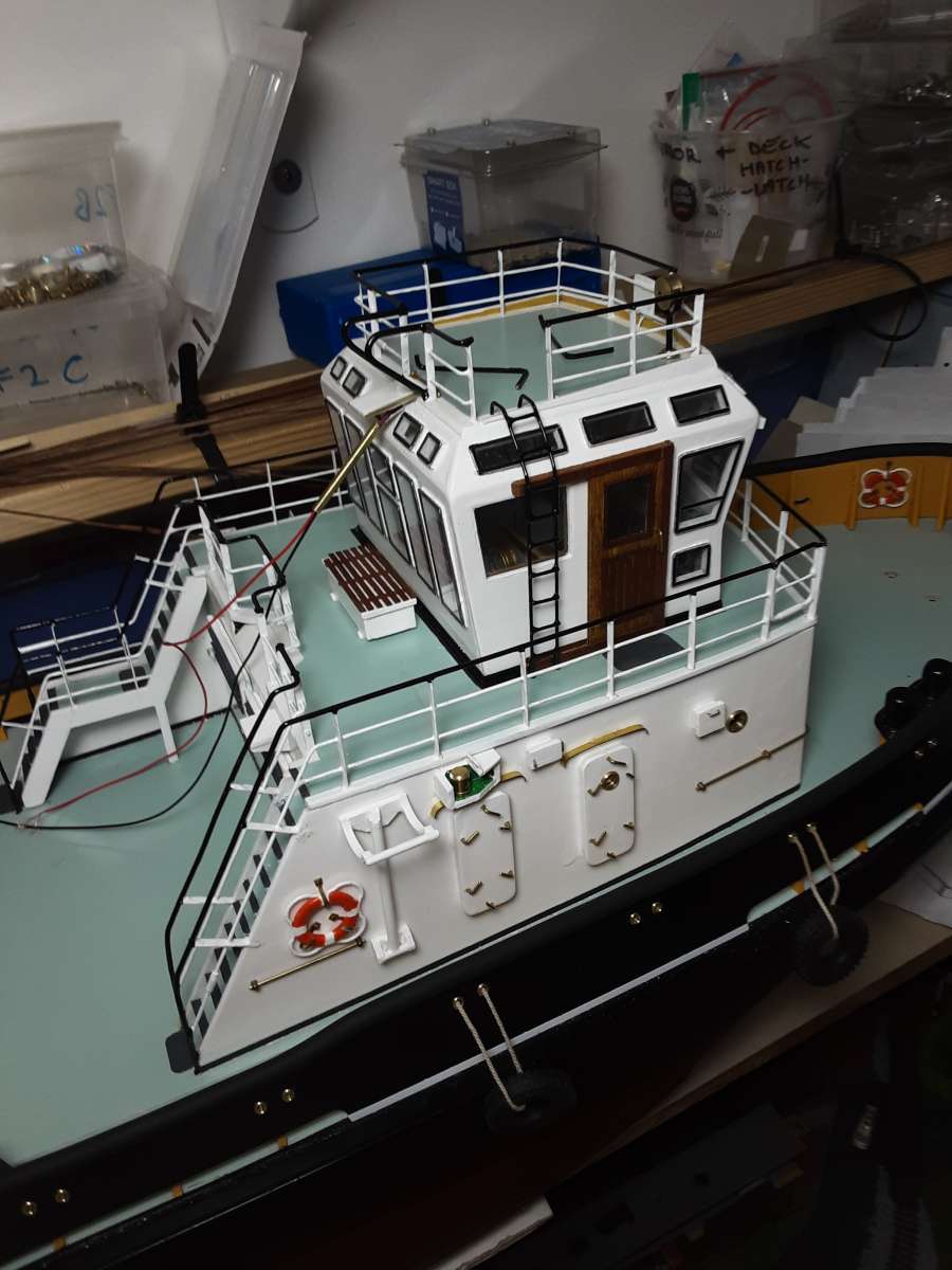

          Saw the photos of some skylights, they look very good. Have you posted photos of hatches too?

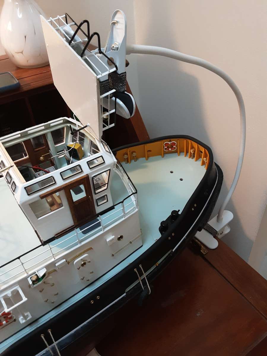

          Smit Ned’ now has the bridge unit glued to the deck. A bit of hassel getting it centred due to all the light cables sticking up through the deck . Had to enlarge all the holes to allow adjustment of the bridge position. The bridge deckhead is still not glued or faired…just sitting in place for ‘show’. I will fit a steaming light to the railing and the wires have to be led below and hidden around a top ledge in the bridge.
          Wipers are on, painted Tamiya Rubber Black and almost invisible, as I have ‘parked’ them very close to the window edge…. which is also black!
          Black ‘skirting board’ added to the deck-bulkhead glue line.I note that paint does not adhere too well to styrene strip. Read last night that it should be wiped with alcohol. What a waste🥂
          20240902_110120
          George

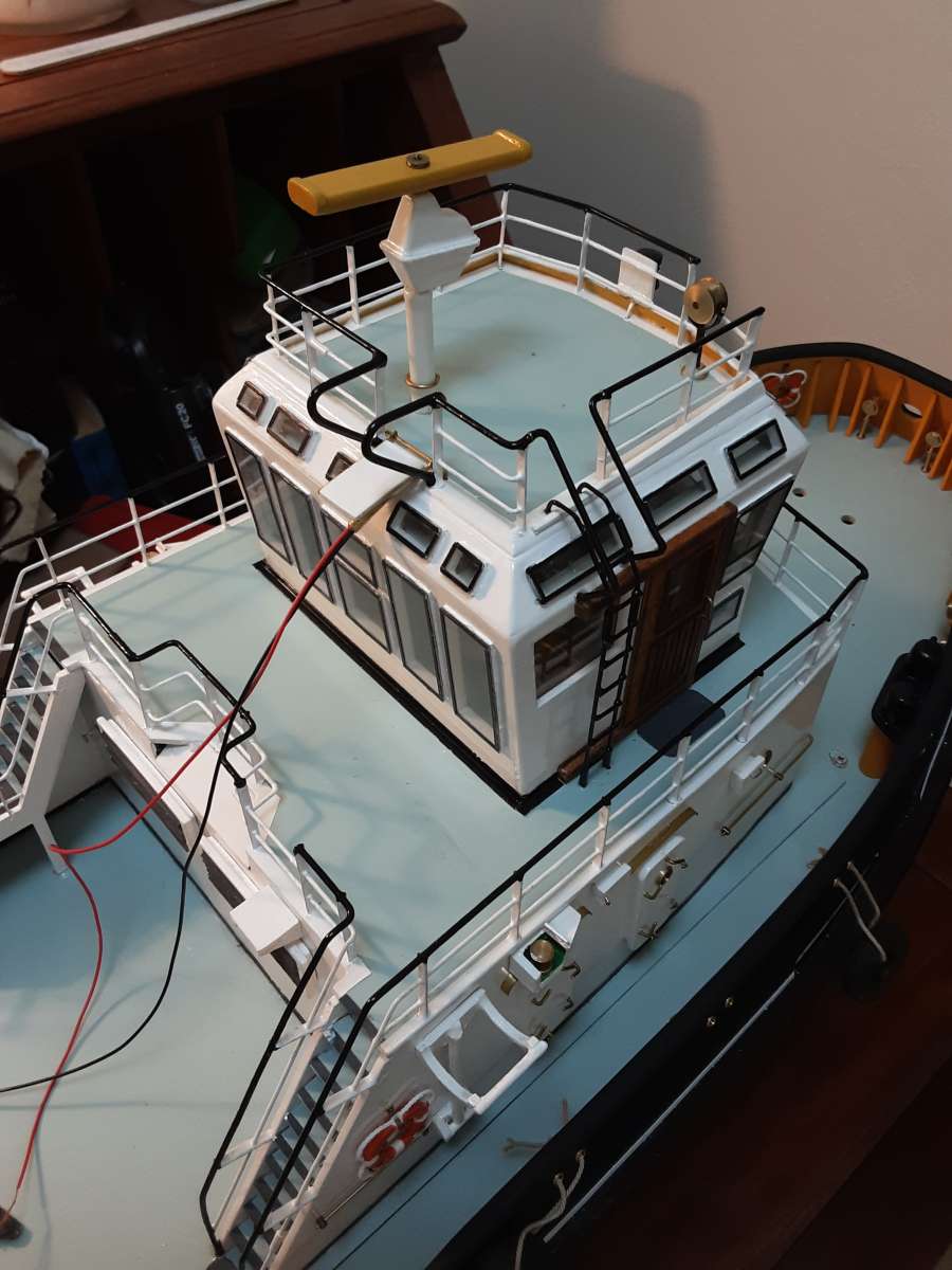

            I originally was going to leave out steaming and sternlights to keep things simple-ish. But the tiny lights were just lying there in the placky bag begging me to fit them somewhere on a tug.
            I have a nasty habit of adding complexity instead of adhering to the KISS principle.
            The deckhead is hanging on a ‘dockyard crane’ while I attach some tiny wires to a grain of wheat.🤓
            20240903_140010

                Finally got the bridge deckhead on. Been looking forward to that for ages. The bridge and ‘internals’ have taken a lot of planning, but would have been much easier if did not get crazy ideas like a radar screen, backlit chart plotter, ambient lighting etc! My own fault.
                George

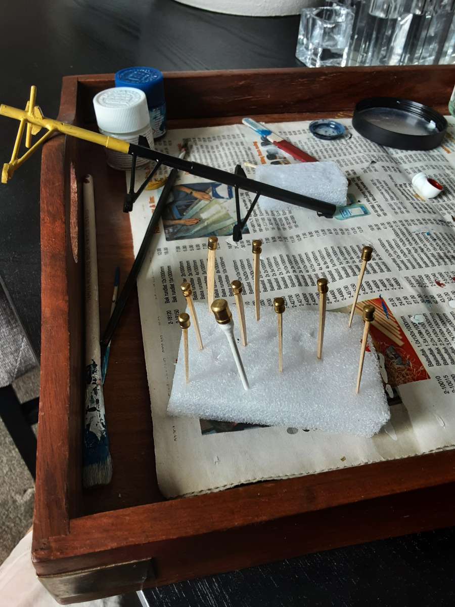

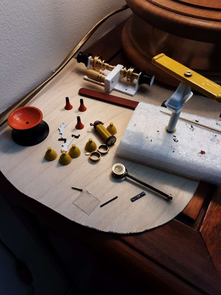

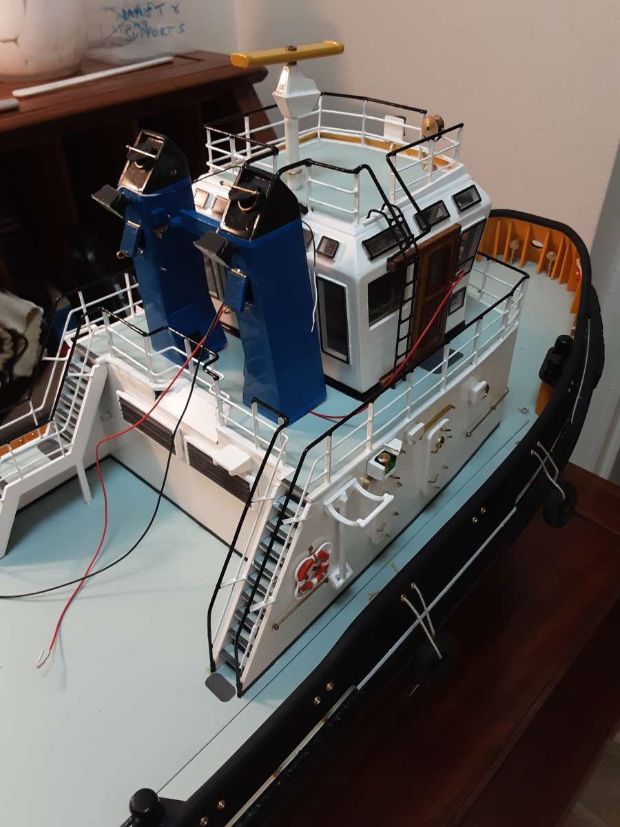

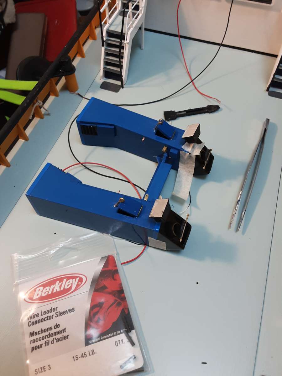

                    20240910_222759Been beavering away all week but not much to show for it. Mostly locating tiny parts, both ply and brass, and then trying to find out where on the tug they are supposed to be fitted!
                    Assembled a few parts and mixed my own version of “mediterranean blue” for the exhaust stacks and fittings.
                    20240910_22264720240908_17323420240910_222735

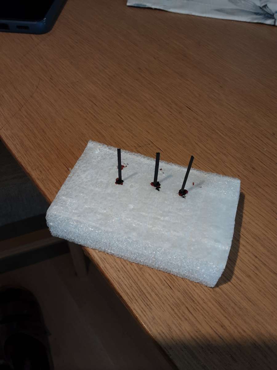

                      As mentioned earlier, I bought in some Hammerite “special metals primer”. It seemed to work OK on the railings which I sanded/filed before application of primer. When I did the same with the tug’s mast, the primer did not stick very well. I filed it all off and phoned the Hammerite importer in Oslo. I was told to clean  the brass with a “Nr.1 thinner” before applying Hammerite. I hapened to have a tin of thinner left over from the Fisher build and on the side of the tin?….”nr.1 Thinner”
                      So, I will find out tomorrow if the primer grips the brass tube of the mast. I notice that the mast is just visible at the bottom of the photo above. That’s the first application of Red-brown Hamerite…before I started scraping too much off it!.
                      I have been looking for Carr’s ‘etching primer’ over here but cannot see any ref. to it in Norway.
                      Hope the above goes down as ‘info’ and not ‘waffle’, it was “news’ to me at least, but then almost everthing is.🤔

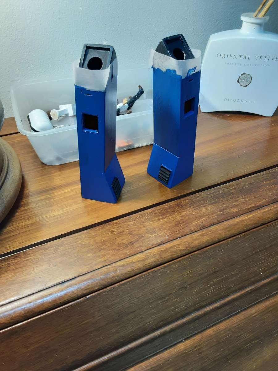

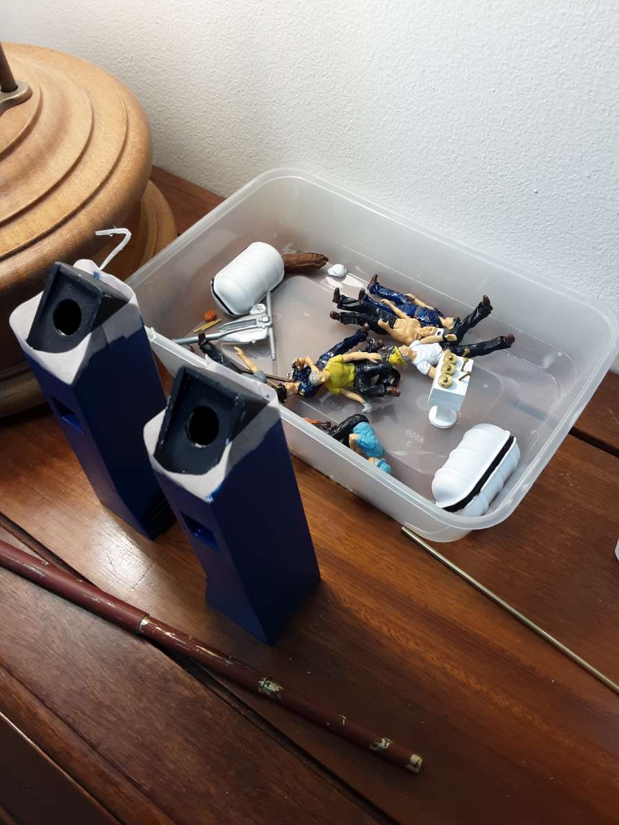

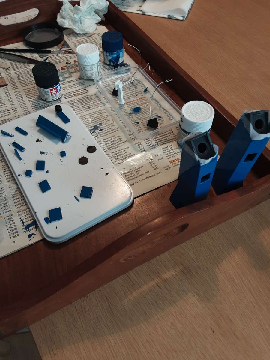

                        And now for my latest blunder….. the Smit Ned’ should have ” Billing ‘mediterranean blue’ paint on the exhaust stacks and associated parts. I googled that Billing Med’ Blue = Tamiya X-14.
                        I had 2 pots of Tamiya X-4 in store -which is a darker blue- so decided to try  to mix a lighter blue. Mixed Tamiya X4 and Tamiya white and added a little Billing ‘light sea blue’. Mixed it all together and painted two sides of an exhaust stack and left it to dry. Next day when I was going to paint the exhaust stacks the new paint mix was a bit thick and ‘gooey’. So I mixed in Tamiya thinners which seemed to fix the problem. When I started painting….small p articles/tiny lumps appeared on the painted surface. First I though that the brush had picked up wood filings etc but then I ‘woke up’ and googled for info.
                        You cannot mix Tamiya with Billing acrylic due to Tamiya having alcohol/solvent in their acrylic paints. So now I too know that.🤓.  You can wash out brushes in water of course, but should use Tamiya thinner to thin the paint. I don’t suppose many use Billing acrylic but there are several which are purely water based and won’t mix with Tamiya and the solvent based acrylics.
                        George.

                          Sorry to hear the tale of woe George.  As you say Tamiya is a solvent based acrylic so is not compatible with any water based acrylic paints.
                          Even now, after all the years I’ve been playing around with building models, if I am intending doing any paint mixing or laying coats of different paint on top of each other, I still always do a test piece first.  Sometimes it is simply testing effects and finishes, but always it checks compatibility.
                          #122314
                            This is something I have covered in my proposed upcoming article in the magazine on building materials.

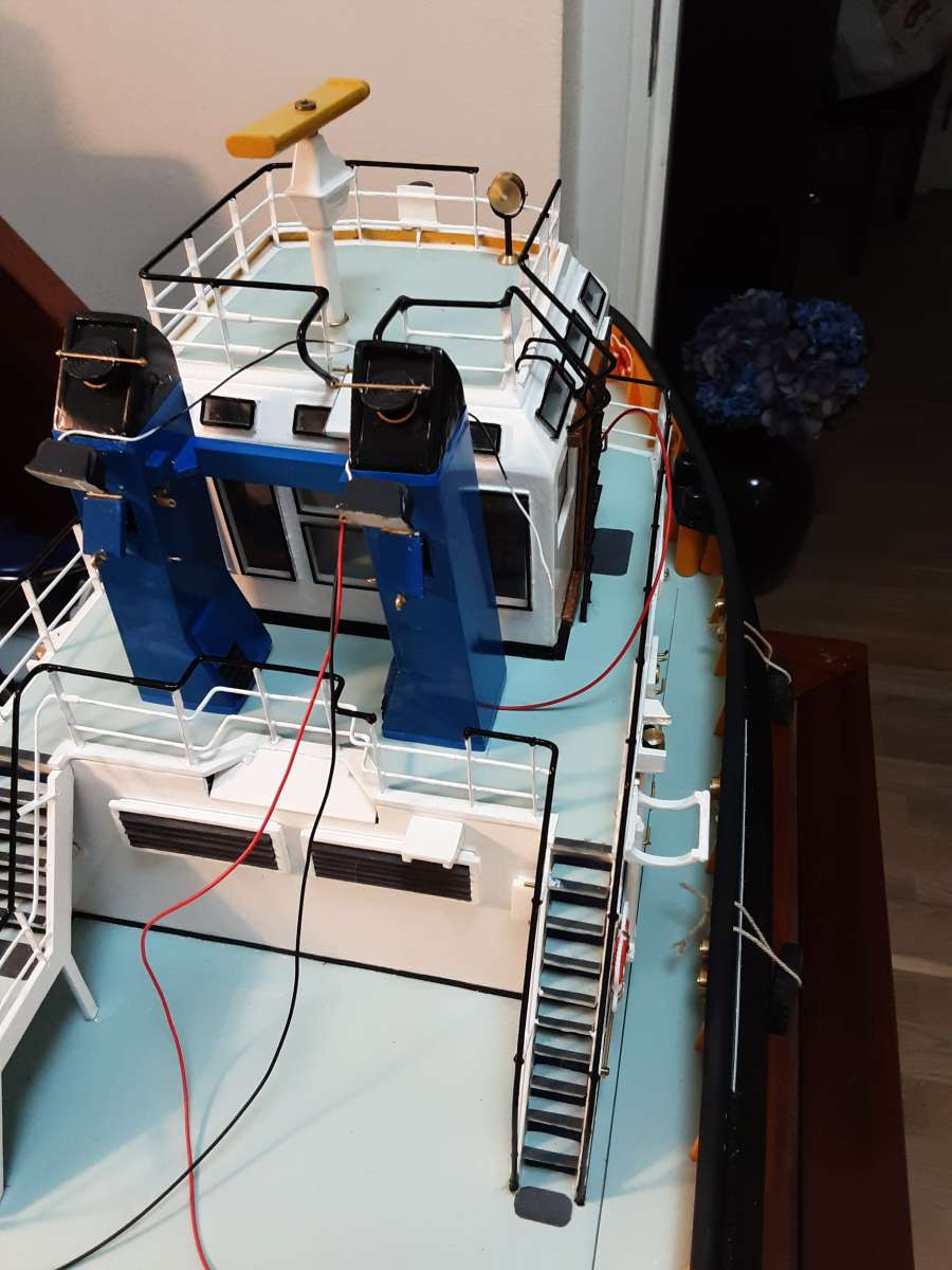

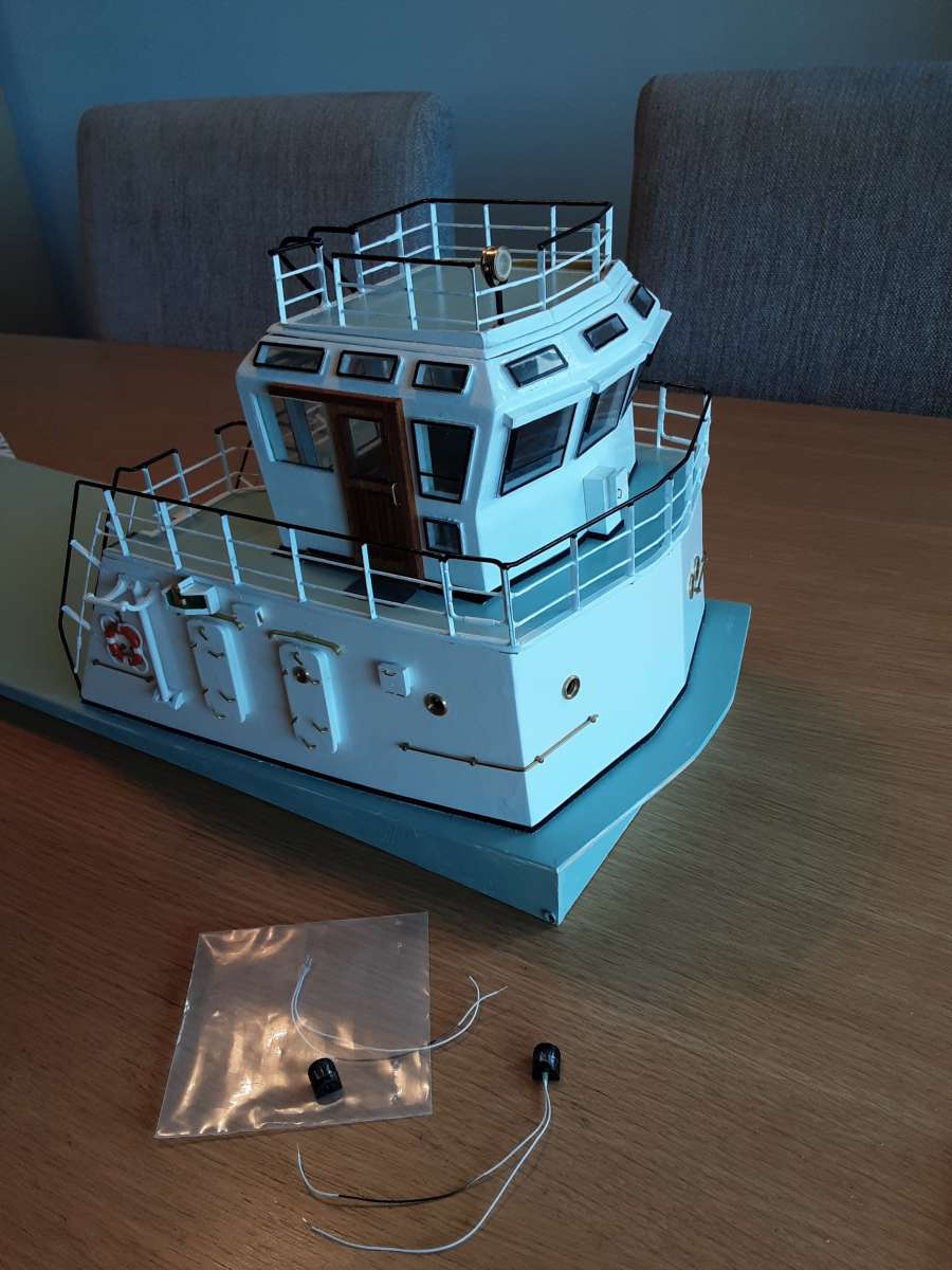

                                Tried priming/painting the navlights a few days ago. Could not get the primer to take, in spite of using all previous tricks. So mast nav and signal lights stay brassy, until they tarnish.
                                The exhaust stacks are getting the better of me. Need to route wiring up through them and out to floodlights and steaming light ++. They also need to be mounted on deck before all the connections can be made.
                                The bridgedeck ladder and handrails have at last been epoxied in place. The short access ramp has been hinged to the aft ‘gateway’ on the bridgedeck.
                                George
                                20240918_14450820240914_11215720240918_144536

                                  Not to worry. Trial fitted exhaust stacks on deck. The wiring will hopefully not be so obvious by the weekend.
