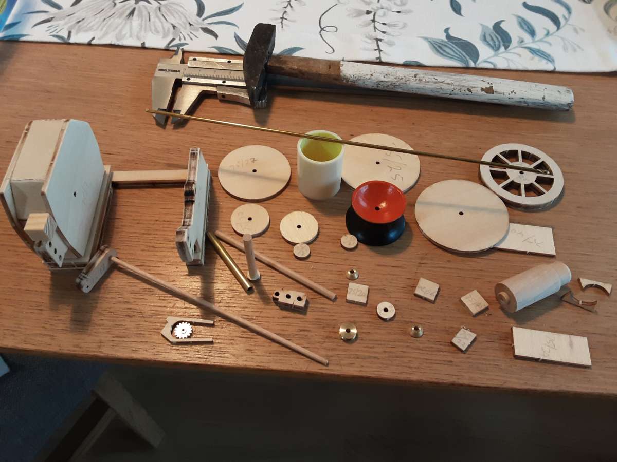

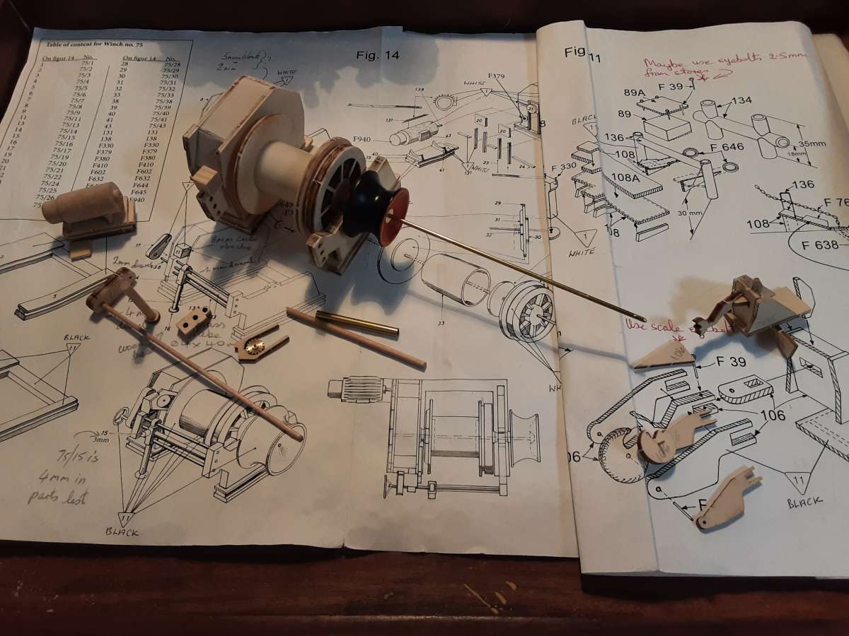

          Aahhh yes, the winch. Lots of small-ish parts, mainly plywood, a bit of plastic and a few brass parts. Preparing and gluing has occasionally been interupted by various attempts at cleaning up the grouting between hundreds of tiles on the bathroom walls and floor. Different mixtures have been tested, from neat chlorine to a peroxide and baking soda paste with vinegar as an extra catalist. The flat does not smell too good just now, but the grouting is getting back to light grey from the unimpresive brownish-grey. And the spiders have “left the building”.

            Hi George,
            I know where your coming from with the bathroom grouting !! I re tiled the shower about 6 years ago with grey, but I should have used black 🙂
            Good to see the winch fabricated with plywood pieces , where would the world be without it ??

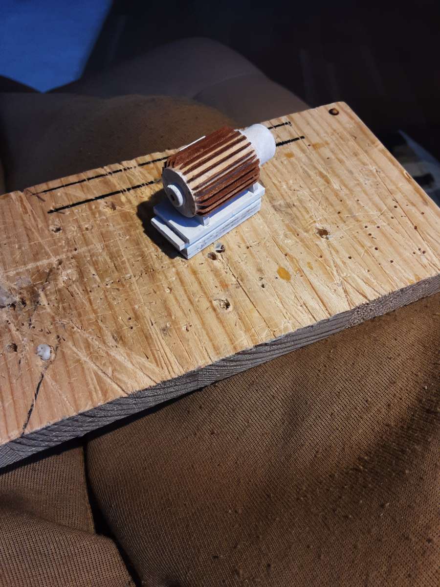

              Been ‘winching’ all day today too. Cleaning the grouting between assembly stages just for a break. As the plans show, lots of parts. Even the parts have parts. PartlyI.
              Turned the page and there was a tow hook; a dozen parts there too. Luckily, most of the parts are to be painted white.
              The laser cut parts are easy to axcess, so full marks there.
              Hope to get the winch painted and glued together next week, so now I’m de-
              parting…ooohh sorry.

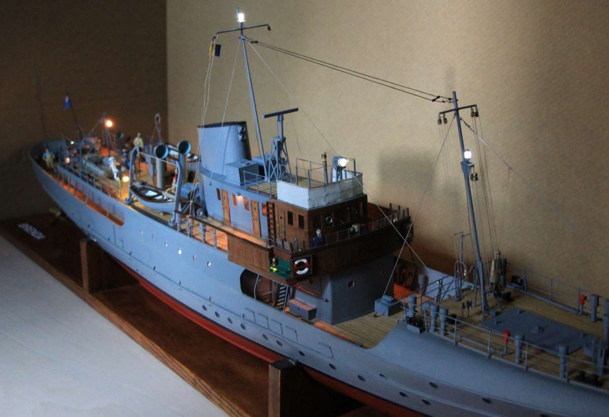

                        Just a word on lighting that might be of interest to some.  I have a steam lorry and was looking into how to light it and the obvious areas to look at are the RC car accessories.  I notice they now do LED light sets that are pre-wired into a harness with a resistor ready fitted and a plug on the end that simply goes into a spare outlet from the receiver.  They are powered by the receiver outlet, which has to be a non-proportional on-off channel.
                        These are available in up to sets of eight lights and I’m sure could also be adapted for boat use.  The wires would probably need extending and, in some cases the resistors might need moving as they can be challenging when directly soldered to the lamp tails, but I’ve not come across before a system that is potentially so simple and so easy to use.
                        Balanced against this has to be the reduction in life of the receiver batteries but I’m certainly going to do some experimenting with my steam lorry.  The lamps tend to be in either 3mm or 5mm diameters, so not the smallest but they may well be worth investigating.

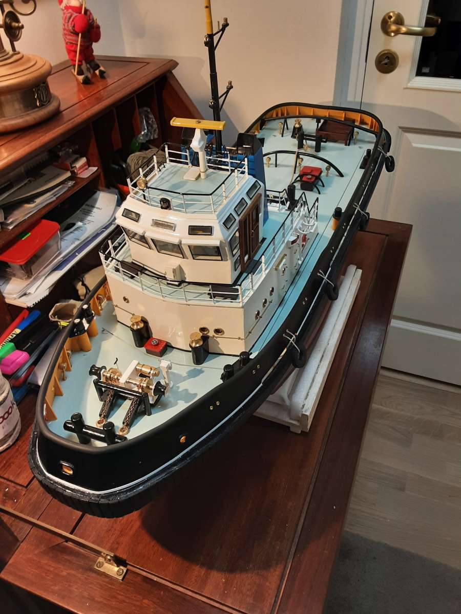

                                            Getting very slowly into the build again and after negotiating my way through all the info above on different light systems I have managed construct more deck gear and give it all a dollop of paint.
                                            Regarding lights on the S-Ned’, I expect that I will have a go at re-wiring it all in parallel and supply via the 6v drybatt’ pack which is already installed. As mentioned earlier -and supported by others- the light systems will be seen only once or twice for show, and never on a lake in the dark.
                                            George20241122_160151

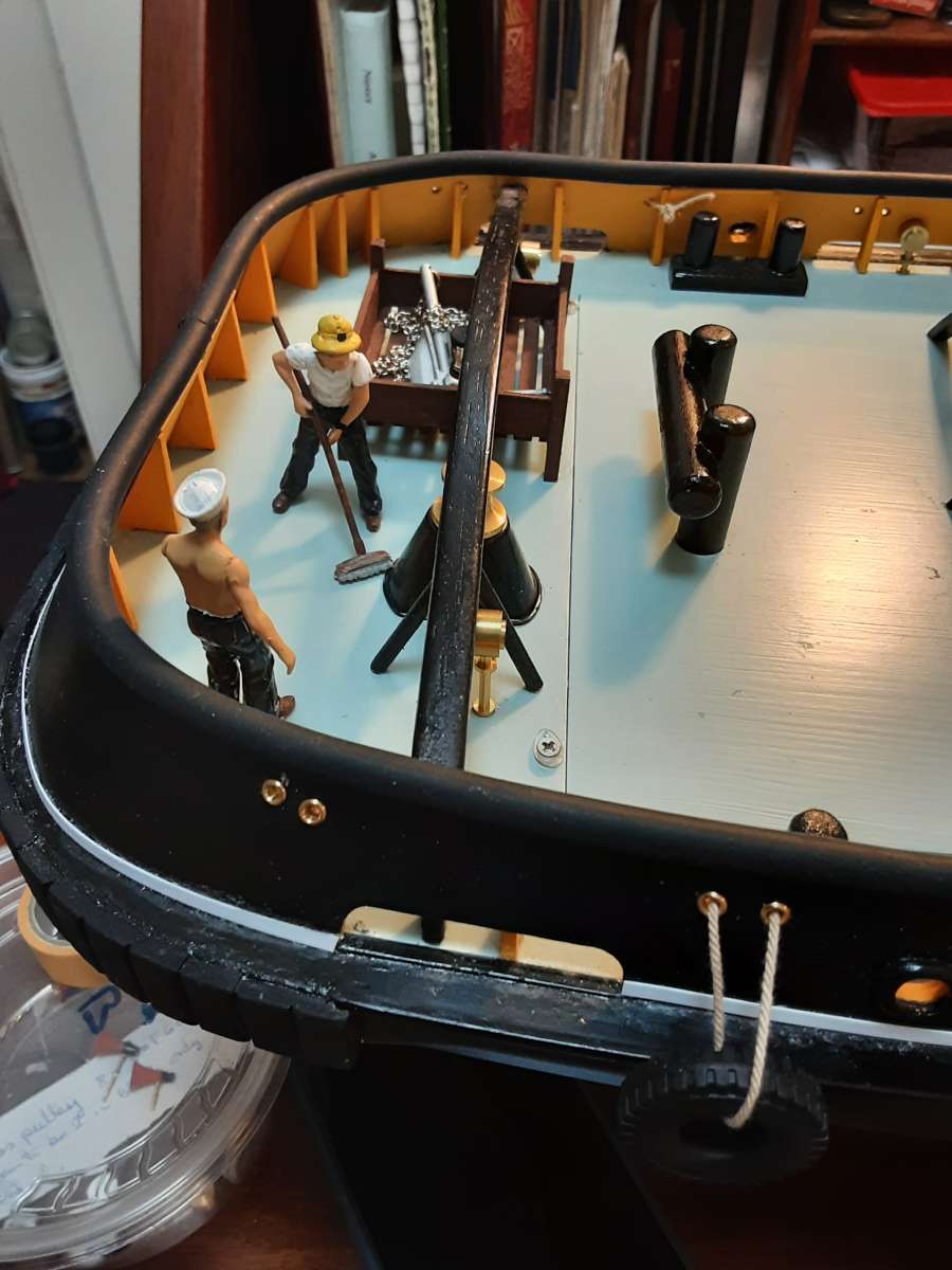

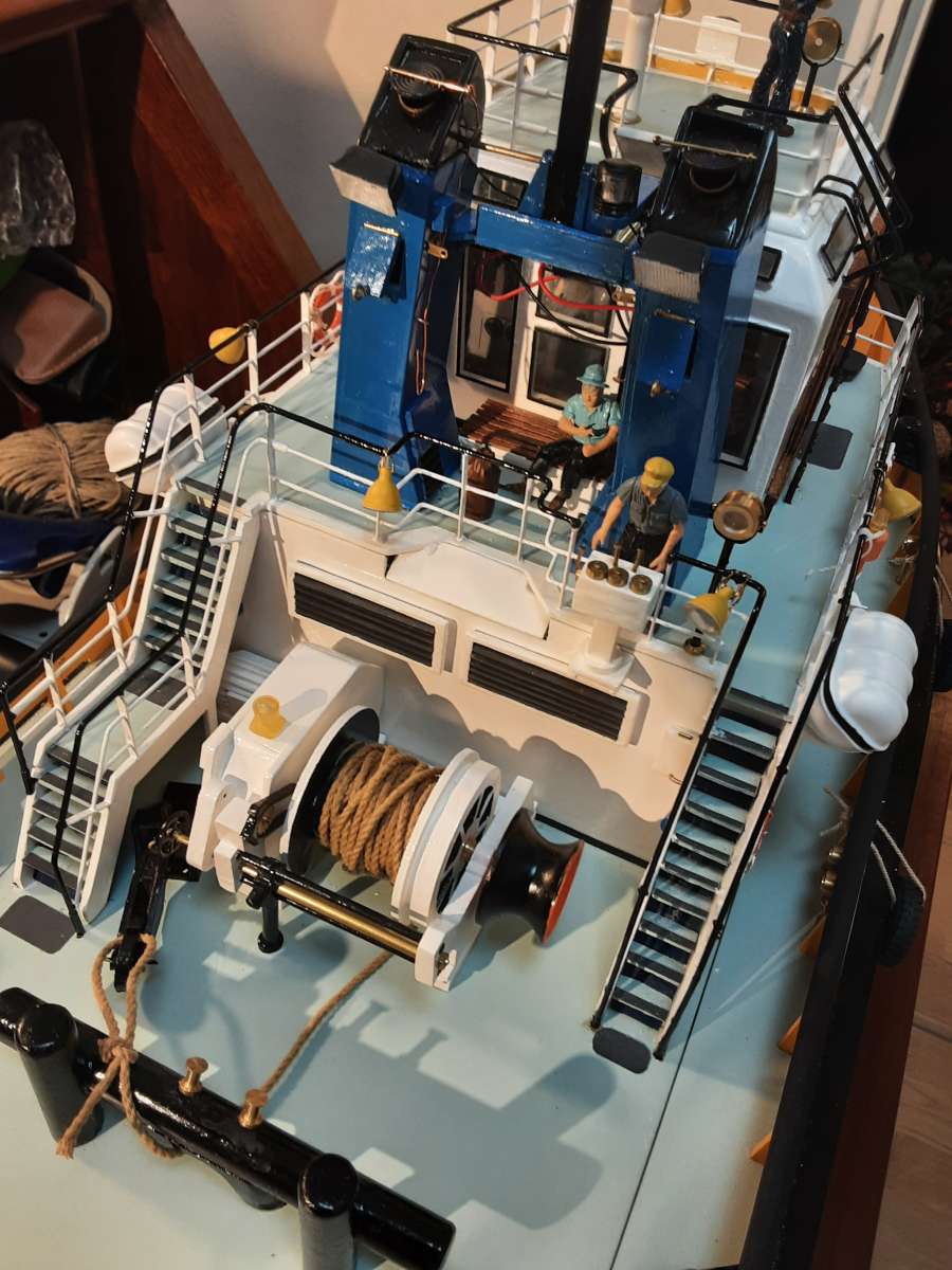

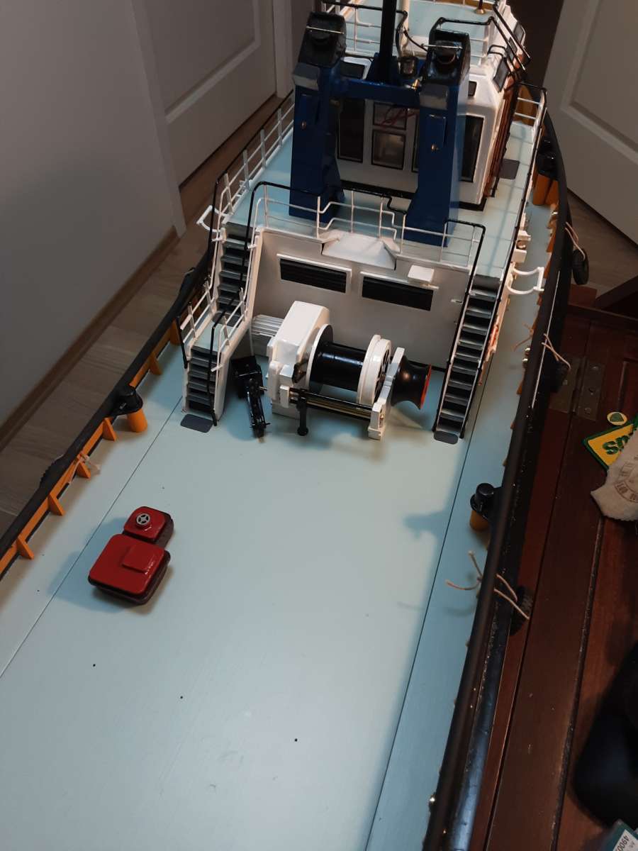

                                              Hi, does anyone know the correct way to route/thread the tow rope on this tug? Should the rope exit from to top of the drum or below as I have done.
                                              Should it be routed below the forward bollard construction as in the photo?
                                              I’ve seen several diffrent methods on YouTube -some of which are strange.
                                              When not towing, I expect that the whole rope would be on the drum but I want to show some rope on deck…as though en-route to start a tow.
                                              I know that it should not be routed fore and aft on the deck as in the photo. I just stowed it like that before putting the tug away for the evening!
                                              Respectful suggestions as to where to put the loop on the end of the rope would be welcomed😁
                                              George
                                              20241128_144928

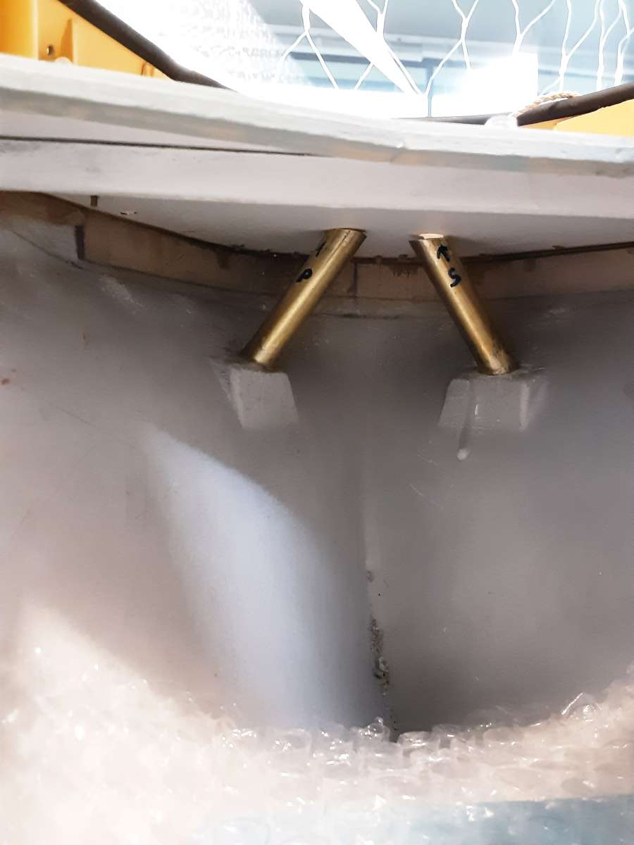

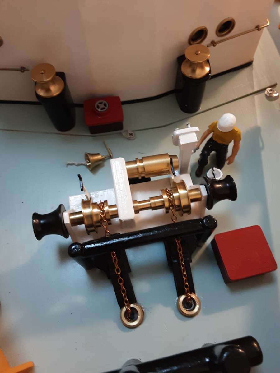

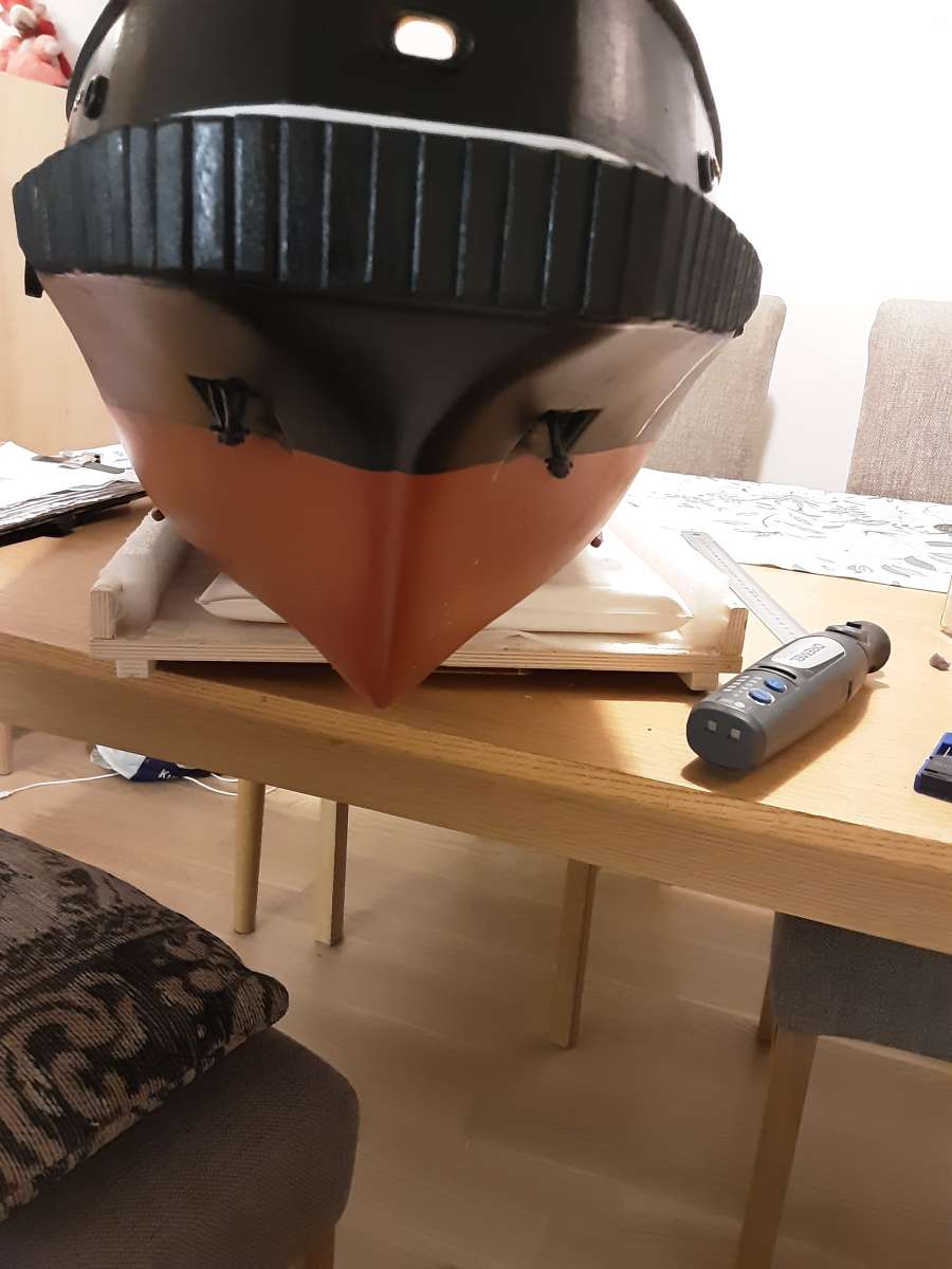

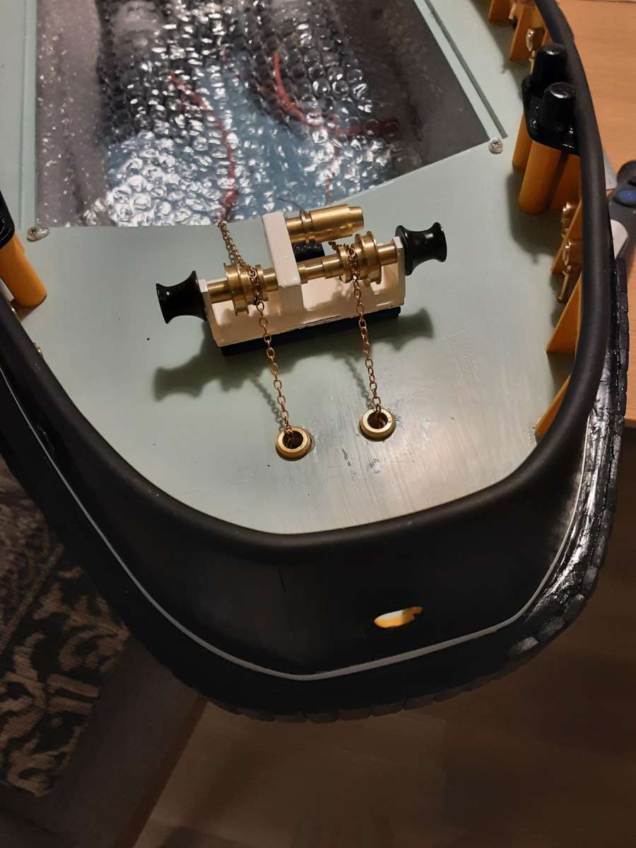

                                                Moved attention forward now to the bow deck and anchor windlass. Inccluded in the kit were two very impressive 11mm brass tubes -to be installed as hawse pipes for the anchorchains. These are far too wide for the job at 11mm dia. and if installed would protrude outside the edge of the achor recess on each hull side.I tried fitting them on the inside surface of the hull and the underside of the foredeck but I fIIIound that it was difficult to make a tidy glue join.
                                                6mm alloy tubes were located in store and have been install instead. Not as impressive, but they look right.
                                                The hawse pipes have been ‘water repellant -ed’ by stuffing a little medium foam up the tube and surrounding the chain.. The larger diamter pipes -if used- would certainly have needed plugging to avoid sending a lot of water across the decks.
                                                George

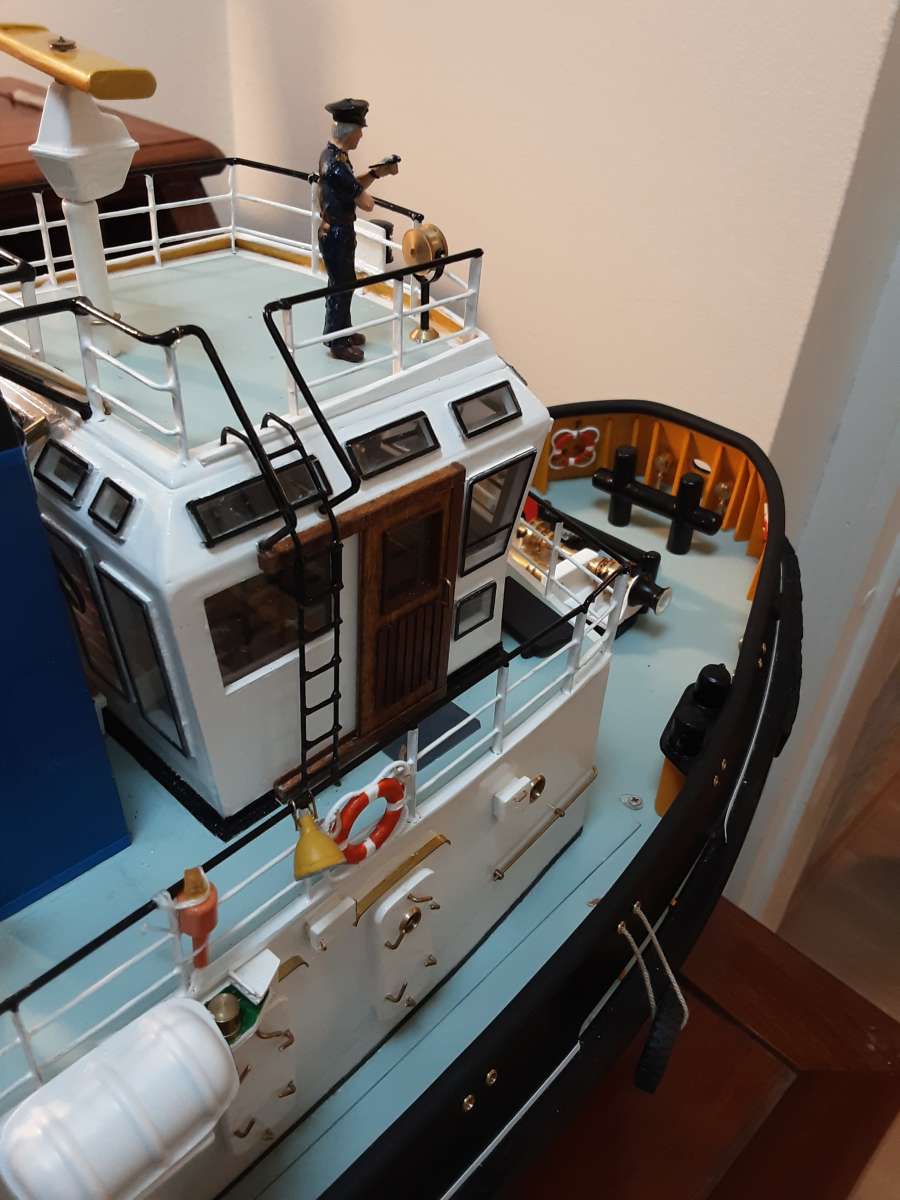

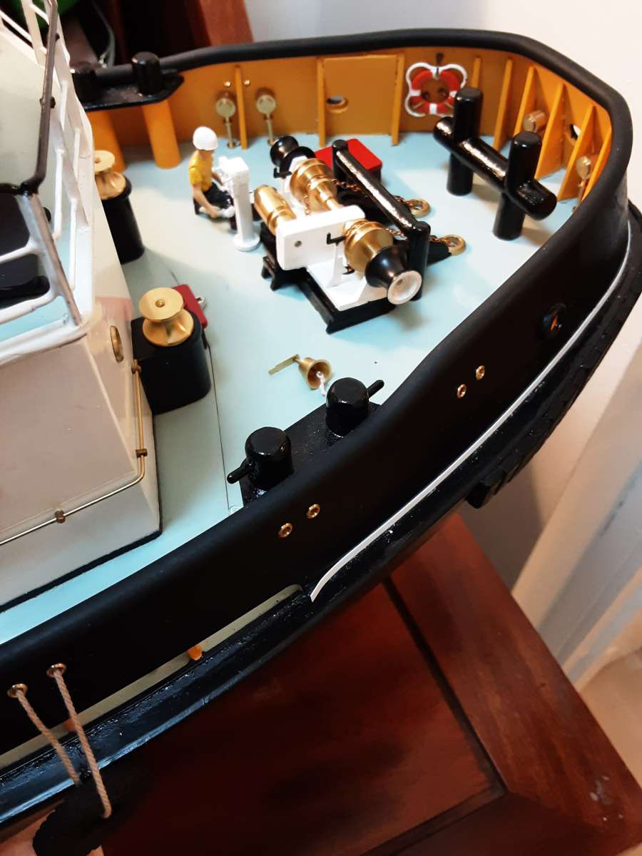

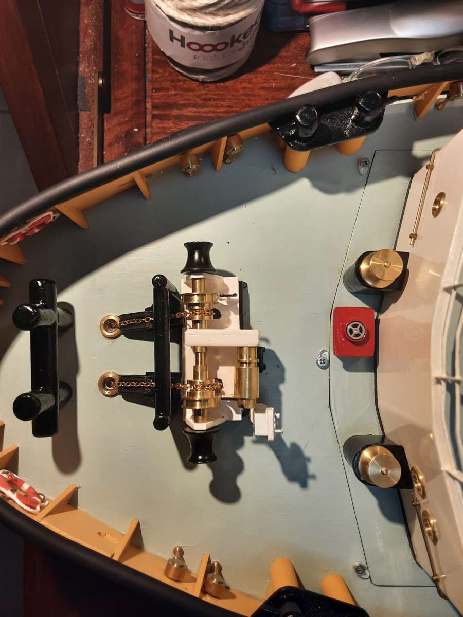

                                                  The anchor windlass, anchors and chain have now been fitted. Many other small parts like loud hailers, deck lights and crew members etc are waiting in line for a blob of appropriate glue.
                                                  George

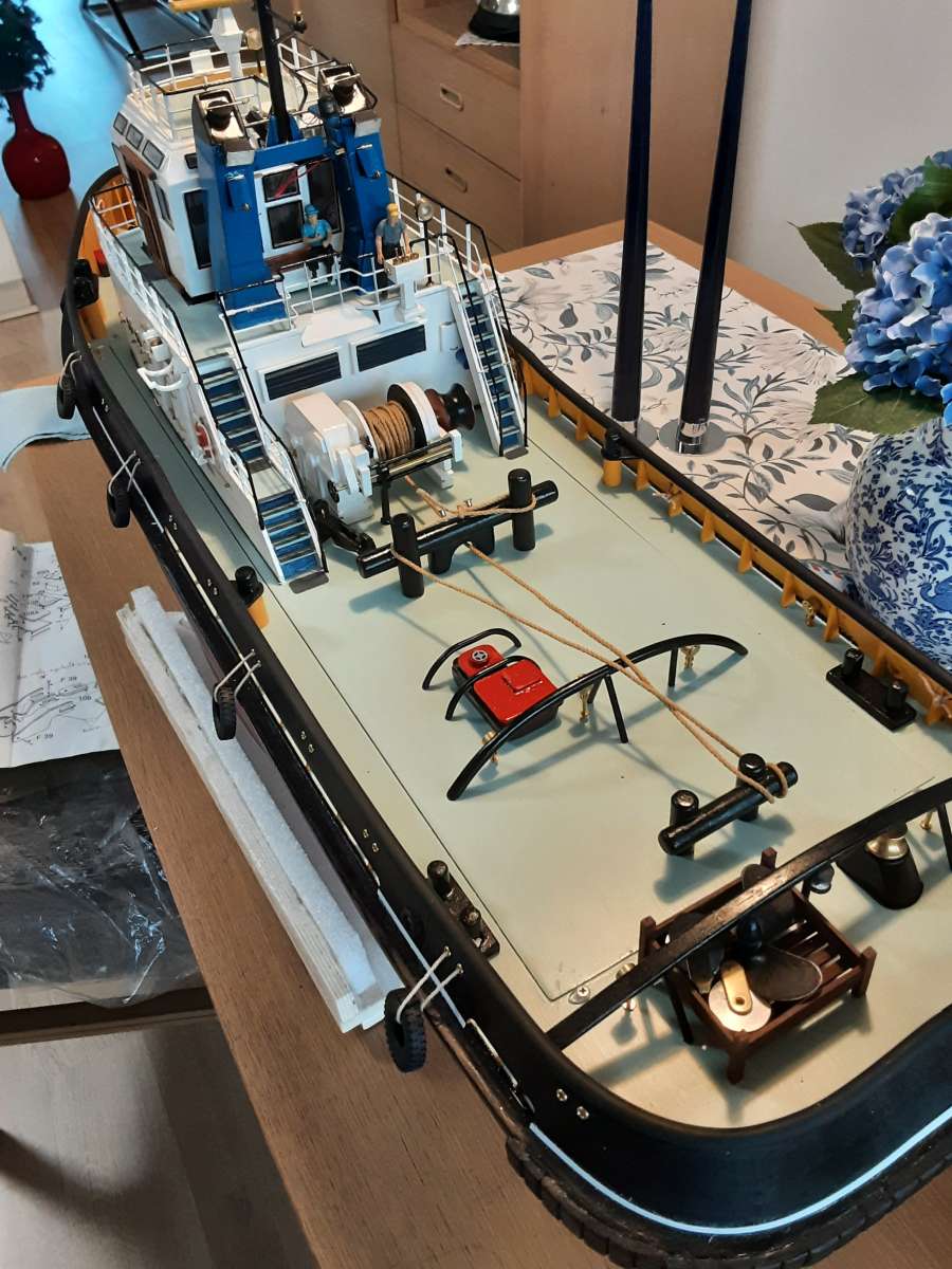

                                                    Slow progress as usual. Rewired all the exterior lights in an attempt to make a parallel supply. In spite of a lot of planning and sketches (and even thinking) most of the bulbs were still in series. Or rather they seemed to be, as only the steaming light and stern light were bright. The 4 others were dim as earlier. So, lights are still on the menu but will not be receiving attention until next year.
                                                    Did some more relaxing stuff recently in way of adding small details around the decks and railings.
