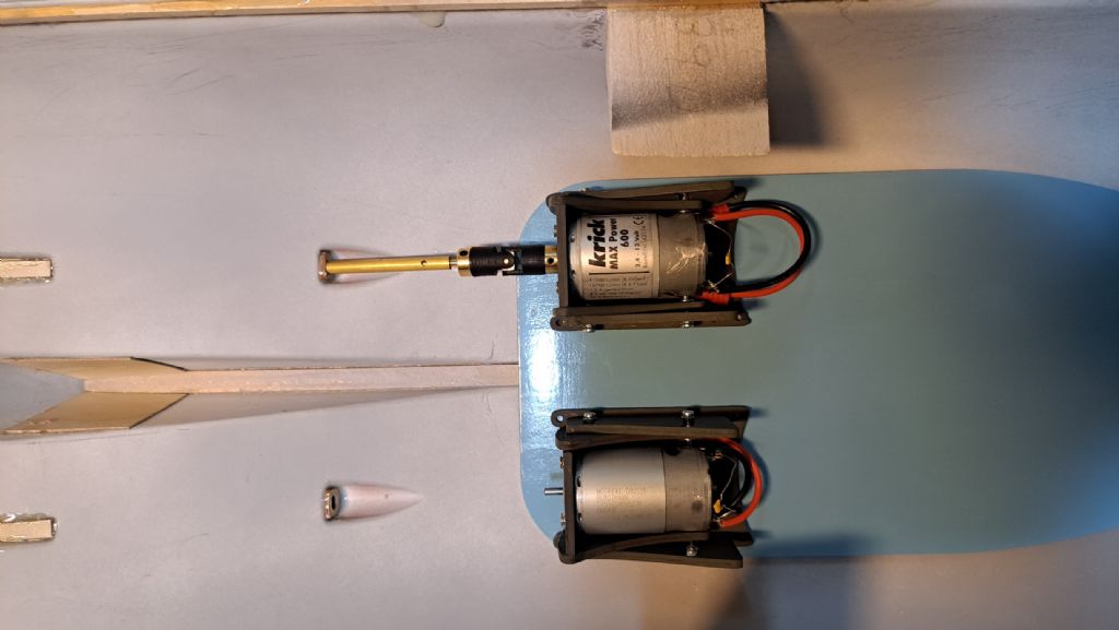

                      Not much to rave about, but due to all the previous posts about RF suppressors etc. here's a small 'offering' to show what the plan is.
                      Motors shown loosely placed on the equipment tray -which hopefully will end up being screwed to the keel in the bilges.
                      If I can get onto the new forum I expect to post a photo of the drive train in place and all the R/C on the tray in…xx weeks from now.yes
                      George

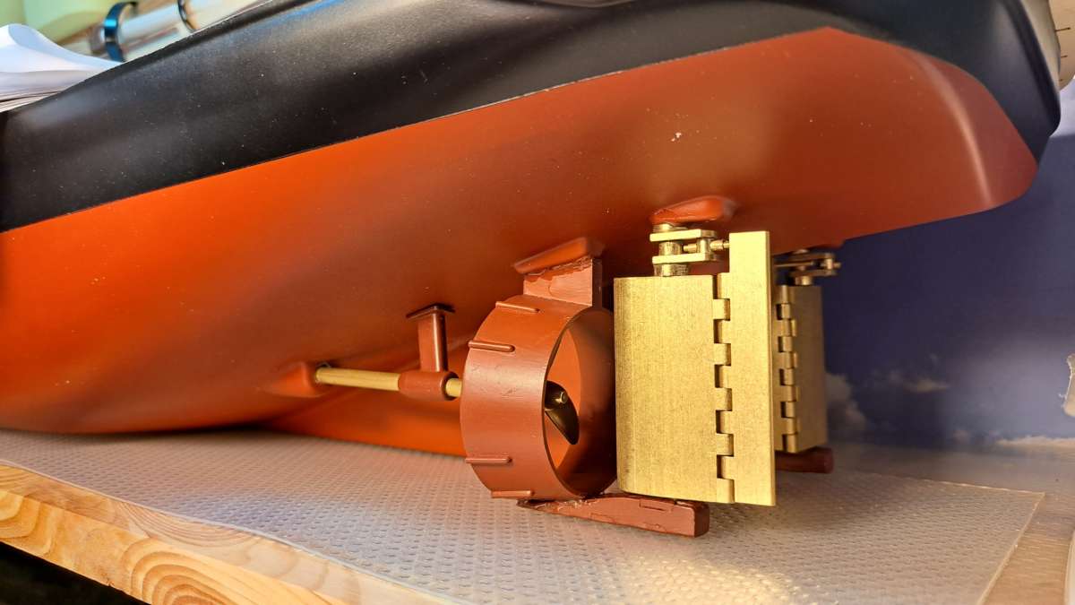

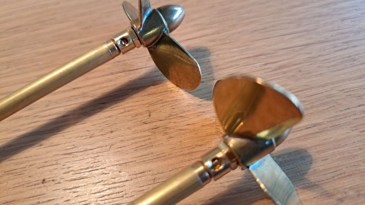

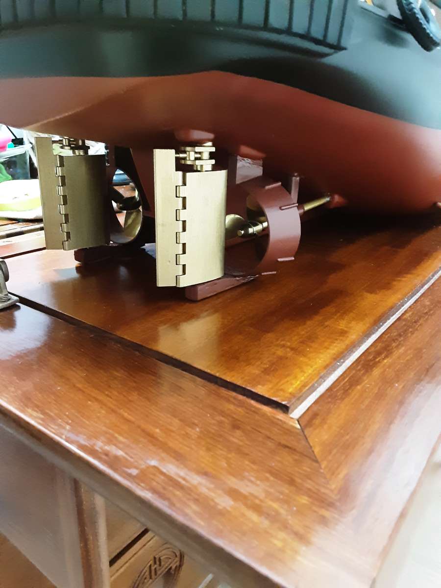

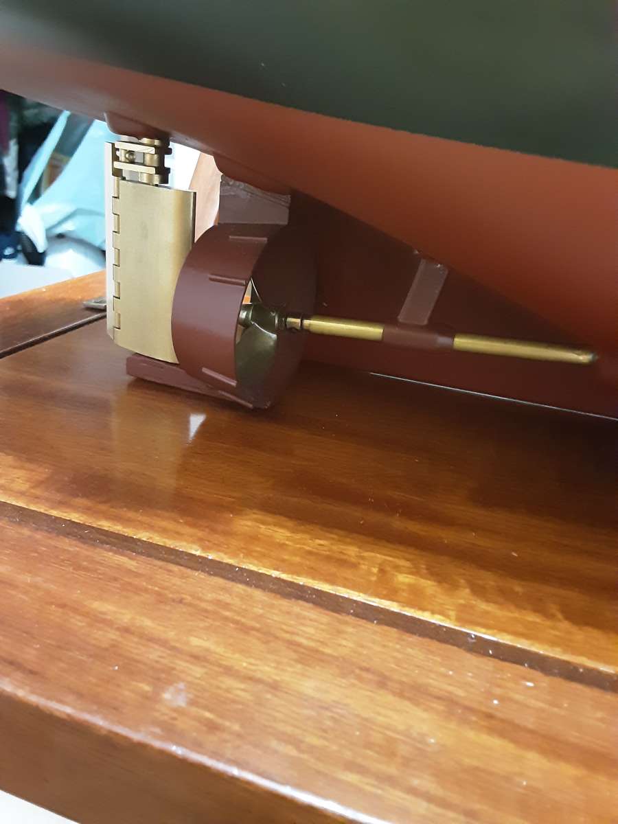

                        Work on the Smit-N has progressed at the usual snail pace. I’m still ‘under the hull’ trying to get the twin motor set-up installed. Been there for many hours in fact. The support bracket for the sterntube is a pre-formed plastic part. It’s position under the hull dictates the angle of dangle of the sterntube and therfore also whether or not the propeller ends up in the centre of the Kort nozzle. The position of the Kort nozzles is dictated by the physical connection to the base of the rudders. There are few variables but only very small corrections are needed to produce change in propshaft angle.
                        I’ve had each tube/shaft/prop unit in and out of the hull at least 10 times each and I’m still not fully happy with everything.
                        I’m getting there though, and hopefully by next week I’ll be able to connect the motors via u/v joints to the shafts.
                        Now, to try for a photo….
                        George
                        20231016_18243420231016_14365020231016_182454

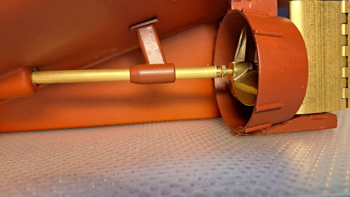

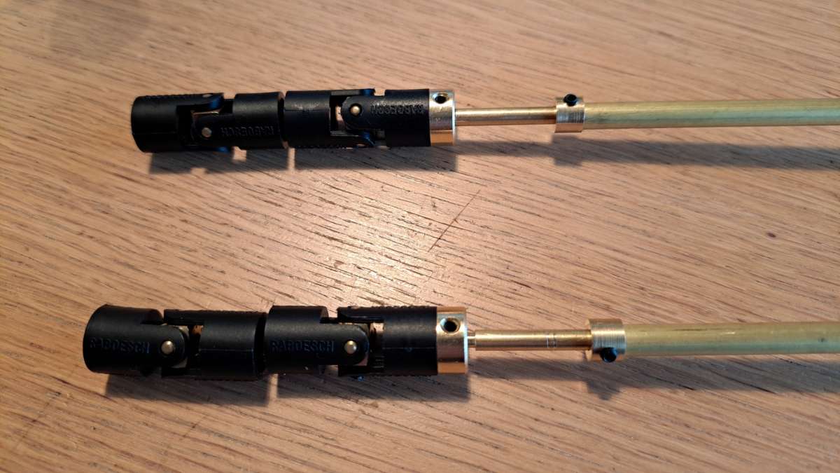

                          I’ve been trying to source two 4mm brass nuts here in Norway to no avail. I wanted to add locknuts to the propshafts. The photo above shows the single nut included in the kit to be used as a thrust-nut. The prop does not go any further onto the shaft than shown. I tried stainless steel M4 nuts but could not get them to thread onto the shafts, and they did not look right anyway. Don’t want to use Loctite as the props are diffcult to get at and would be almost impossible to unscrew again.
                          I found two 4mm brass rudder-shaft collets -which will have to do. They came with a 3mmX9mm bolt, so 3mm grubscrews have just been ordered.
                          I’ll be using double U/J’s. Splined joiners (converters) are also on order.
                          Have been doing several small planning jobs but nothing to show for it.
                          The upper prop and shaft assembly is actually the PORT driveline…sorry.
                          George

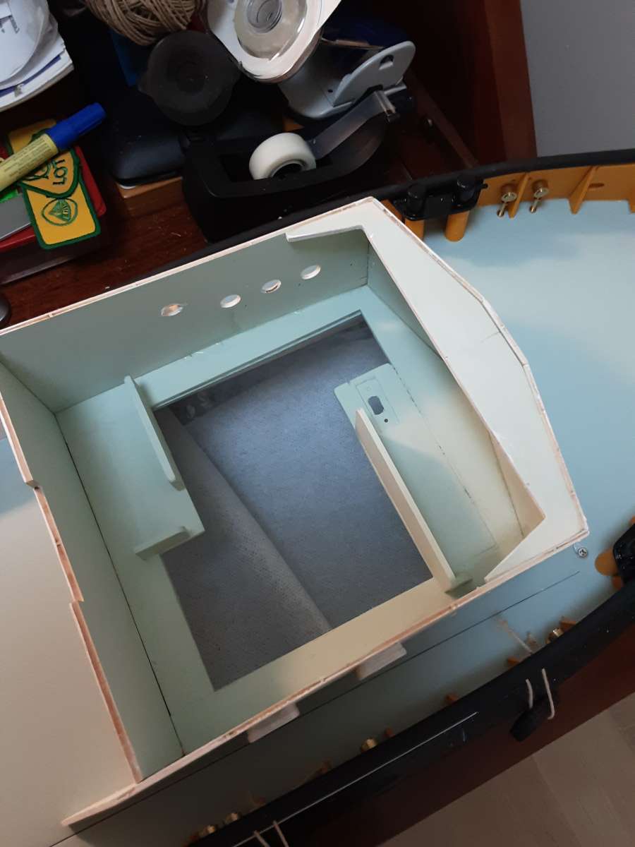

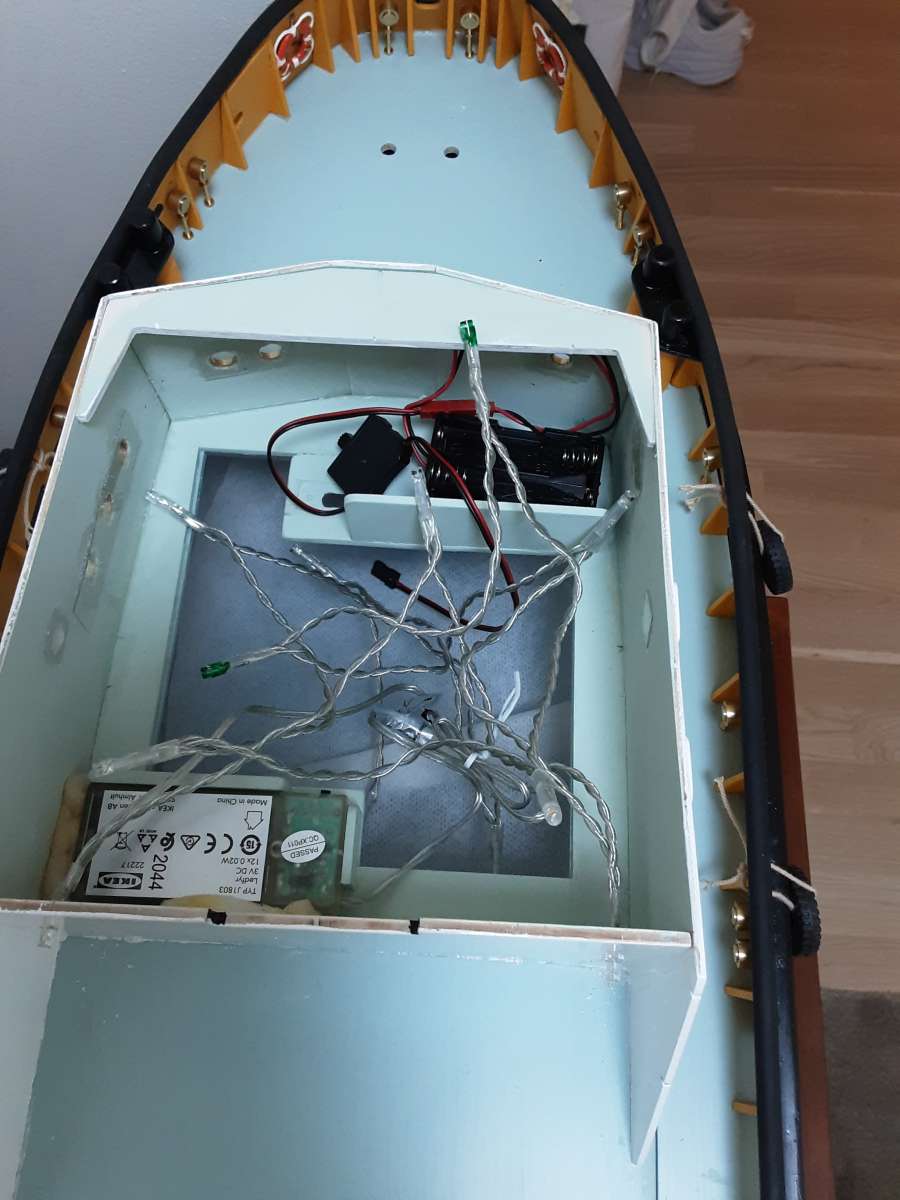

                                                The ‘crew quarters’ will be utilised as an electricity supply room. 2 seperate battery boxes will supply power to navlights and interior lights.20240701_204331

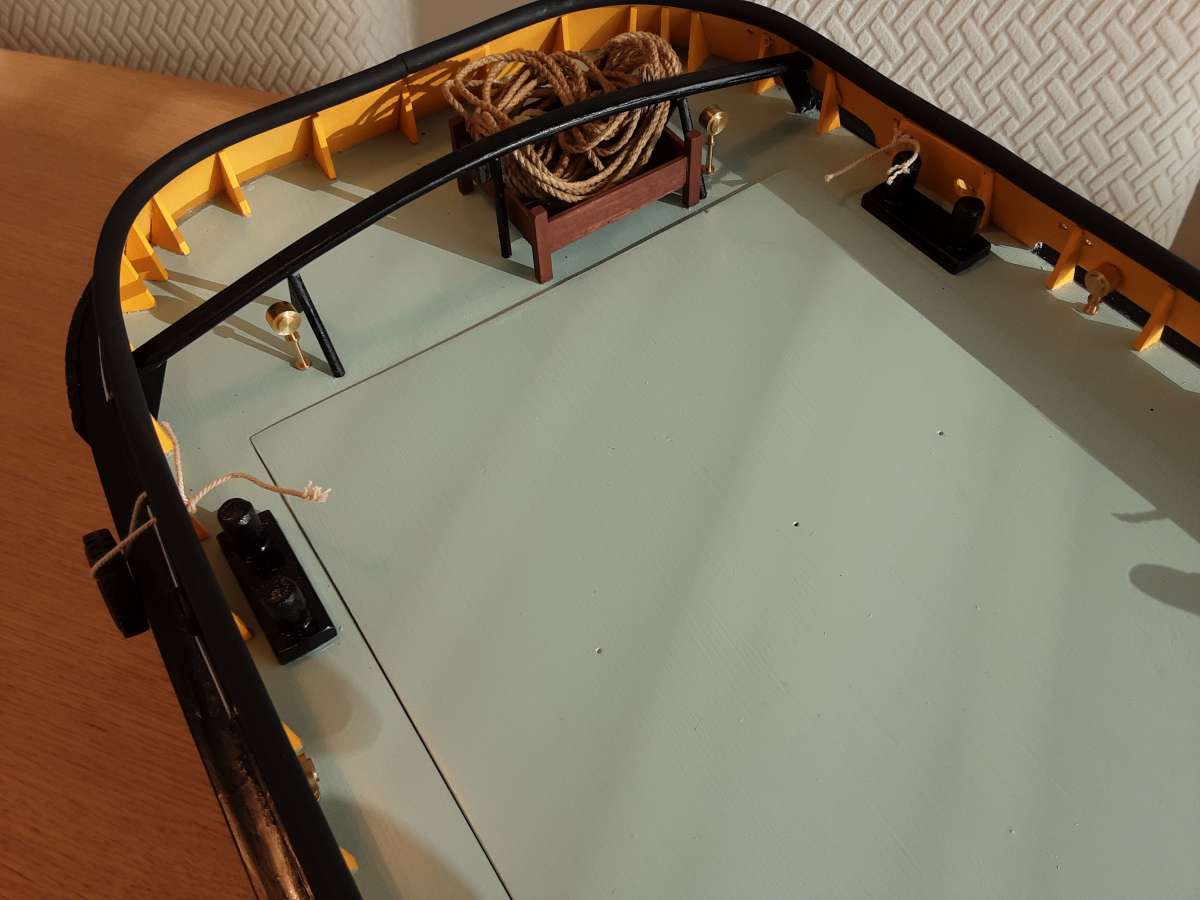

                                                gecon
                                                  @gecon

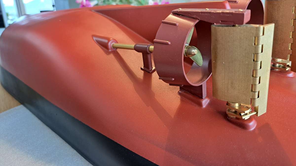

                                                  20240701_20444620240701_204457New close-ups of the ‘naughty bits’.

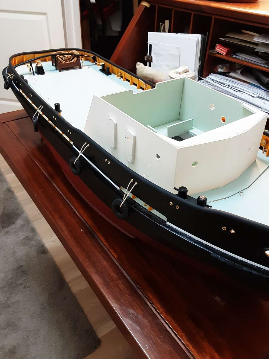

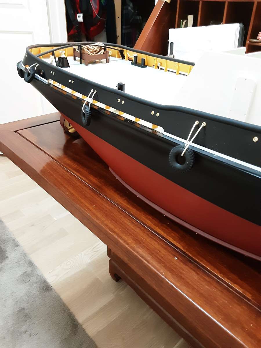

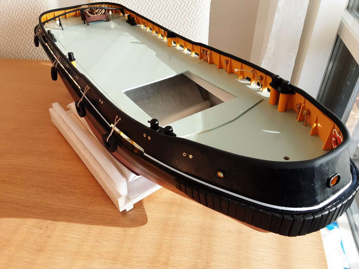

                                                    Constructed a few bits and pieces during last couple of days. I will post a photo or three approx every Sunday if I manage do anything usefull during the week.
                                                    There will be nav lights and interior lighting, with a bit of luck.
                                                    20240707_185441

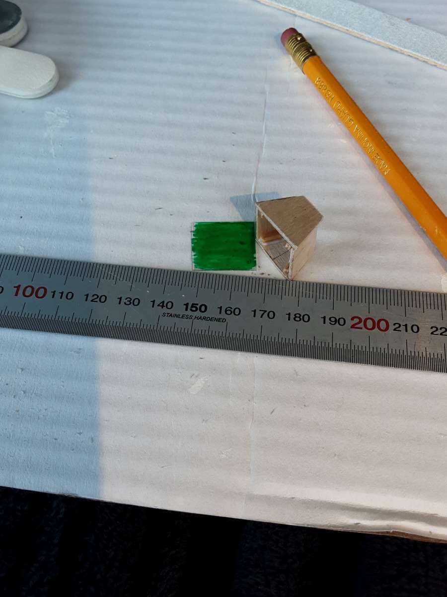

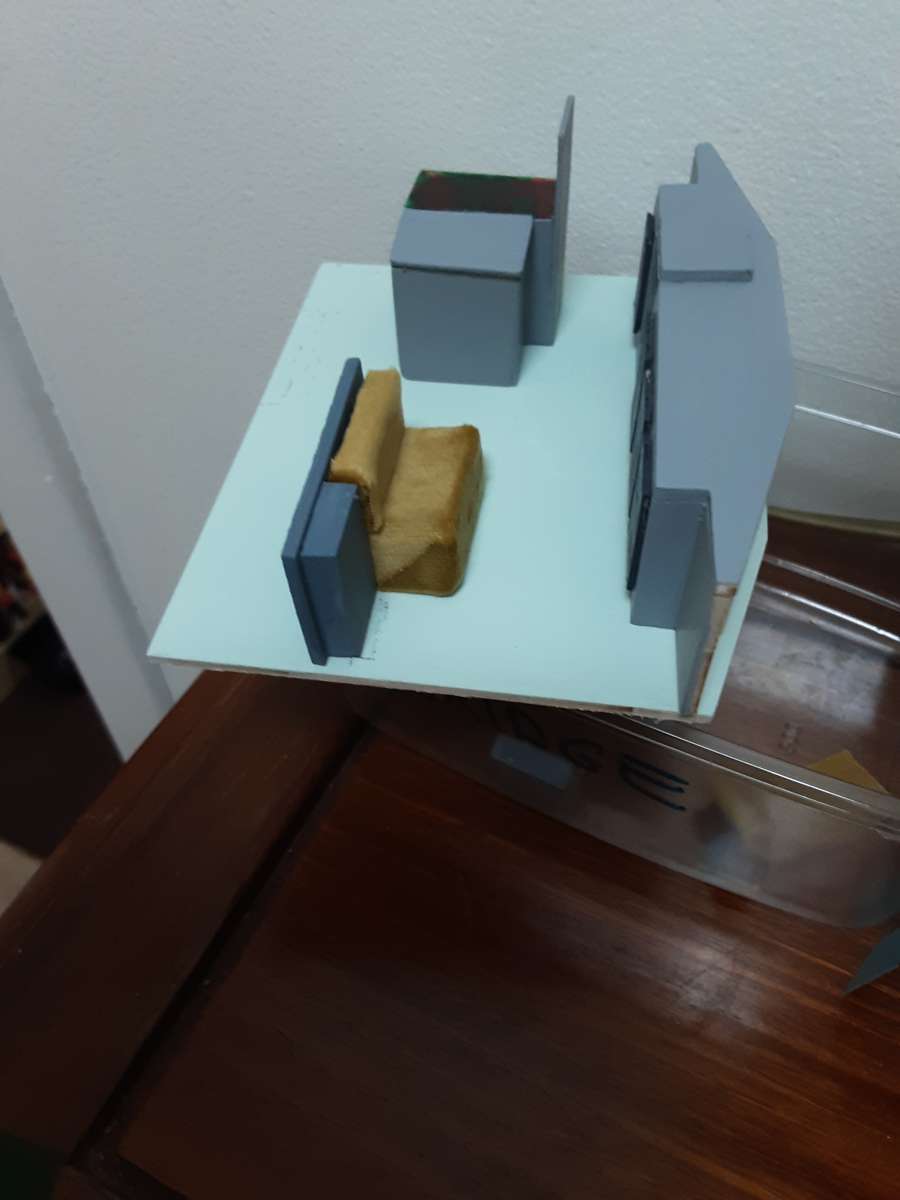

                                                      Furnishing and equipment for the bridge in production. Trying to construct a radar screen and nav plotter with backlighting.
                                                      20240707_08442220240707_185407
