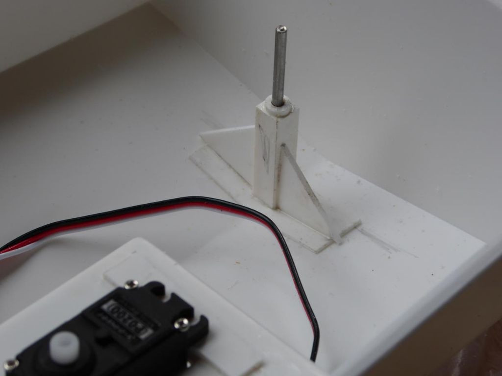

                          Here we have the rudder post and servo mount fitted. The quality of the plastic moulding isn't the best, but this is after all a £50 kit.

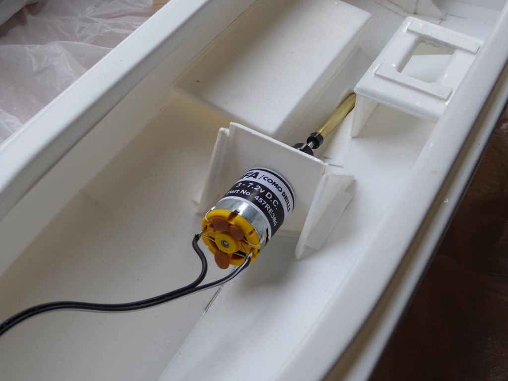

                          Motor and propshaft fitted, but not yet fixed. There seems to be a nationwide shortage of Graupner Speed 400 motors, which is the quoted motor in the instruction leaflet, so I chose an MFA job from Component Shop. This motor is rated to run at 7.2v so I guessed it should do the job nicely. I'm not looking for Donald Campbell type performance!

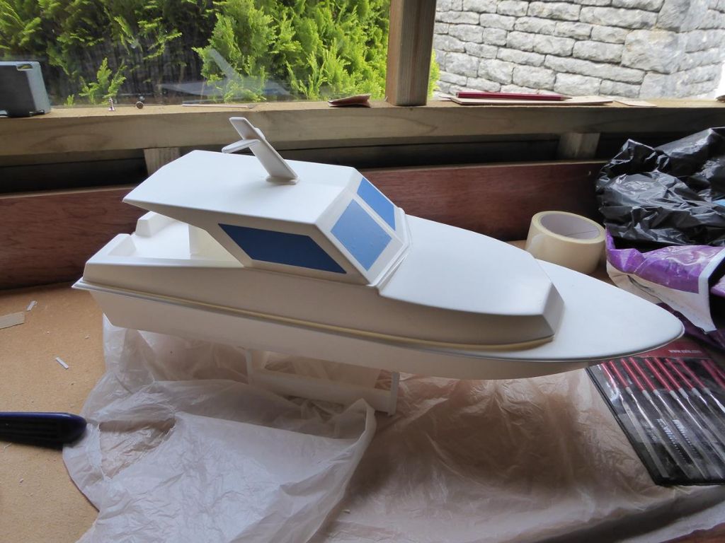

                          And this is how it looks so far. Again, the quality would, I'm sure, leave some of you guys aghast, but it's passable for a £50 job. If it runs ok, it'll do me. I actually think it looks quite pretty. There are still some supplied fittings to go on, but the photo gives a good idea of the finished boat. It's about 18 inches long.
                          P.S. I have just been out to the shed to check, and it's actually slightly larger, at 20 inches!
