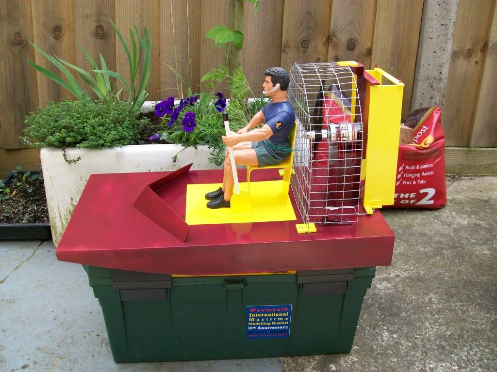

          I have wondered that as well , But at the moment we are staying true to the design chosen, here is a link to a test run of one built by a fellow member..
          The battery was half rundown when I took this.

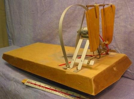

              Hi Ashley,
              I’ve built these too, its the hull shape below the water line that acts to keep it going straight – as I remember the hull is slightly bevelled towards the centre line – I’ll dig out my prototype (made it in ply but was too heavy for the power unit should have used polystyrene – which I did in later versions) and see if I can photo the hull shape for you.
              They do “drift in the turn” but that’s the skill in running them. I remember also suffering from wire burn out do to high power drain. Still have the ESC’s purchased for them and the power units and pusher propellers!

                  I’ve put a couple images or 2 on albums.
                  I also have a pdf file with drawings and article re airboats and shapes etc. Can’t send as attachment till you contact me re pvte email address.
                  Yes, this is in pull format, but I did build with prop at rear of motor as a pusher too! I didn’t know the props were different, and yes, you get more power pushing.

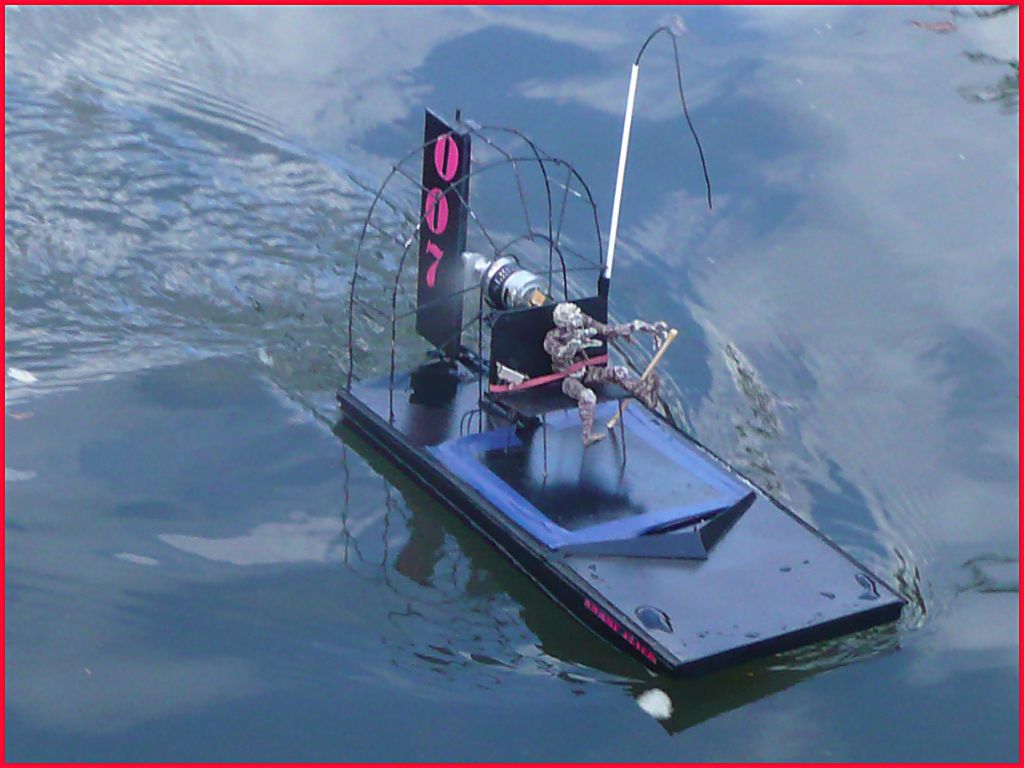

                            Todays Sunday morning boating was very satisfactory, The Herald had an outing, and sailed well enough although the breeze was a bit fitful, and the motor stopped working for a bit (and I need it to tack properly !!!) which was a bit disconcerting.
                            Berengar had his three engined flying boat out which was working a treat, having had a propeller swap from the large fairly crude 3-blade fat paddled props to pukka thin two bladed types. The engines were revving so much more and the steering was better due to the increased prop wash from the centre prop.
                            This seasons secret project also had an outing after yet more modifications and was also performing well-ish. HMS Nelson battleship did not leave the dock (boot) as it was not needed for recovery work and the others were running without fault. Our little handies were getting all cold so after a couple of hours we headed back to harbour, or Grandma`s as its known for a cup of tea.

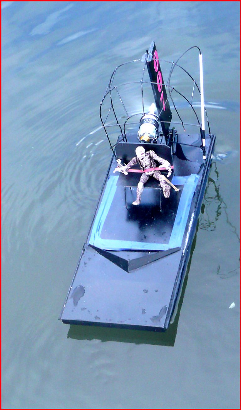

                                      Well, the beastie has been partially built and goes ok, so far on tests
                                      A fixed skeg has been fitted at the rear and has improved straight line steering no end.
