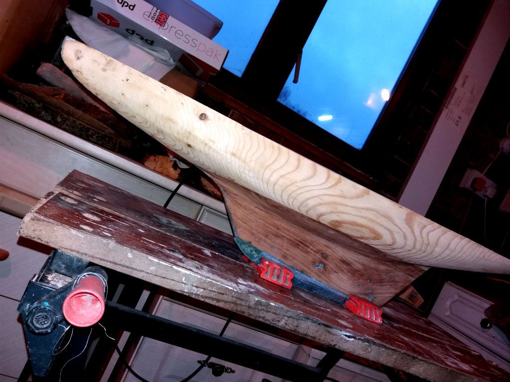

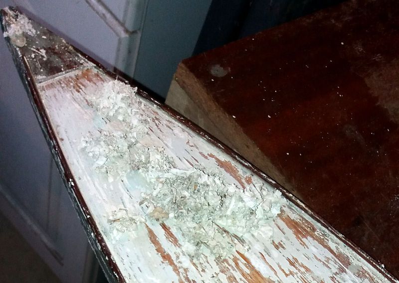

              Thank you both very much and my apologies for not getting back sooner but my wretched internet has been down.
              I don't know if there are recognised proportions to boats (I guess there is) but this hull is 30" long and 7.5" wide. I'm thinking that a mast would have to be something like 30" tall and that makes for a big model. That said, I'm not one to ask for advice and then ignore it so, since you're both of the same mind that this is unmistakably a sailing boat then that is the way I need to go.
              Before posting here I had already begun the paint stripping process and have now stripped back to bare wood. I'm loving the grain and thinking that I'd like to try and stain and varnish the boat. Given that it isn't going to be floated I needn't worry about waterproof treatments or the likes.
              #84551
                Brian. It looks like the hull has cleaned up well! A stain and varnish will have it looking great. Acrylic varnishes do not yellow with age which will keep your initial varnished colour the same over the years, however the darkening of polyurethane varnish can also look nice, and give it that well-aged look. Almost any varnish will be ok for the odd sail..🤔
                Regarding the mast…it’s a bit heretical, but, look at pictures of pond yachts..get a bit of bamboo, make some paper sails and see what looks pleasing to the eye for you size wise if you do not intend to sail it. As I said, there is always the option to make a much smaller mast and have it folded down.

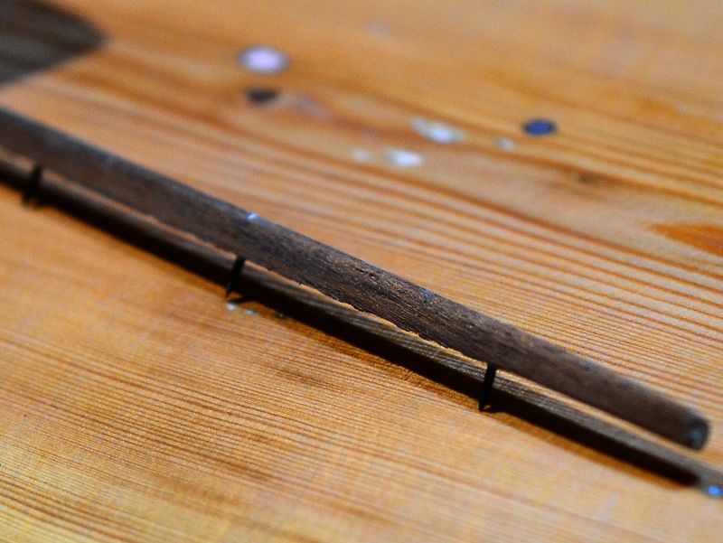

                                  2019-11-12 14.22.17.jpgThanks gents. I'm far from sure that I'm going to get the sort of finish I want when varnishing this hull as I've never done anything like this before. You've now provided me with a second string to my bow because, if the result is disappointing, then I'll resort to painting it after all.
                                  As an aside, when I stripped the hull I discovered a small raised wooden edging around the edge of the deck. It was in a darker wood and is about 2mm wide and 4mm high with a curved top edge. I've attached the best photo I have of it. Is this the sort of thing I'd be able to buy from a model shop? I've been googling everything I can think of but can't get anywhere near close.
                                  Edited By John Johnston 6 on 23/11/2019 14:04:00
                                  #84601
                                  John Johnston 6
                                    @johnjohnston6
                                    Hmmm …. I can't find a way of editing my last post.
                                    I was wrong about the sizes of the 'edging'. It's actually 5mm thick and 4mm high, and I've attached a photo. I'm not concerned about matching it ….. just need something to replace it with.
                                    #84603
                                      You can buy stripwood of various types approximating the size you mention but the problem with buying online is the postage costs which are likely to well exceed the cost of the wood which is why many people prefer to buy at shows.
                                      You can see what is on offer here:
                                      If you have a model shop within striking distance then it's certainly worth trying them, phone or email first.
                                      Commonly stocked woods will be obechi, bass/lime or mahogany. The light woods can of course be stained to whatever colour you want. The usual stock length is 36 inches.

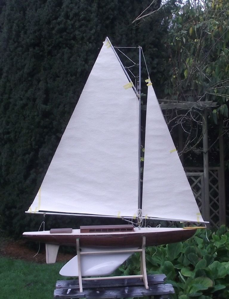

                                                    Hi. John, is this of any help, it's a boat I refurbished for a friend, it came as a hull without a keel or mast and sails,
                                                    These sails are just the paper patterns, the hatches are my addition for access to the radio and steering.dscf3331.jpg

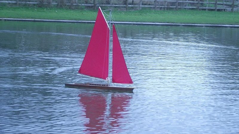

                                                    This is it on the water after being fitted with radio.
                                                    Swallow pond yacht
                                                    Regards and good luck wwith your refurb.
                                                    Eddie.
                                                    #85000
                                                    Dave Cooper 6
                                                      @davecooper6
                                                      Looks lovely Eddie – does it sail well ?
