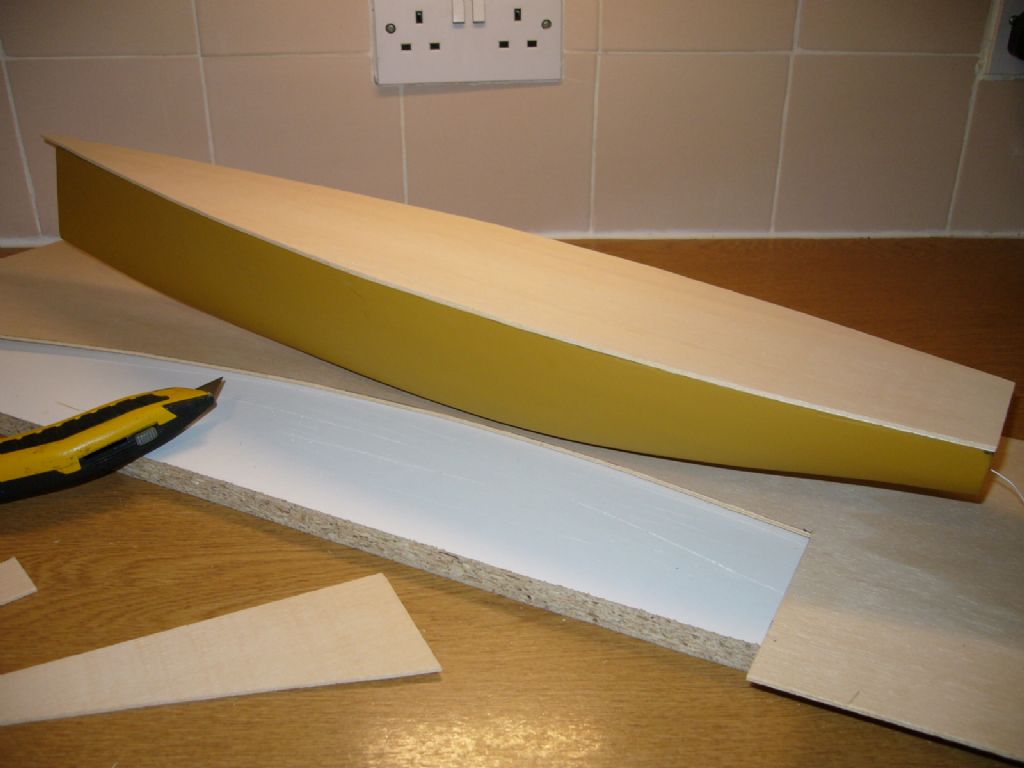

        The build of my RG65 progresses and I have reached the stage of cutting out LitePly for the deck. I find this to be a daunting stage. The boat's internals are going to be sealed over, some never to see the light of day again.
        I'm planning access arrangements to those areas to which access will be required. As I already have a Joysway Orion, I'm familiar with the sticky-backed Dacron fabric patch for covering openings in the deck. I procured some of the aforementioned Dacron in order to cut out replacement patches and find that the metre I bought should keep me in deck patches for the rest of my natural! I am therefore going to follow a similar route with my scratch build.
        My experience to date is of building scale or semi-scale electric powered models with a reasonably high freeboard only having to deal with relatively small quantities of water across the decks. A sailing boat in anything other than very light conditions is another matter. I'm building with the thought in mind that the deck could be continually awash with water. In an ideal world I wouldn't have any openings at all!

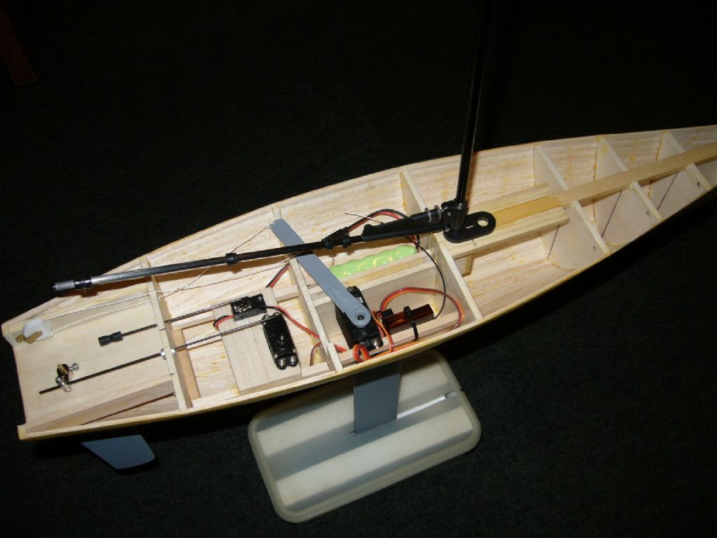

        I have modified the Racing Sparrow design to follow the Jowsway Orion and DF65 practice of having a lowered after deck allowing any water ingress via the rudder tube to flow outboard. The rudder linkage is therefore exposed for adjustment as necessary. The on/off switch will be controlled via a push-rod in this area.
        What other access to the interior of the hull is really required?
        There is one definite:- the battery, for removal for replacement or charging.
        I'm minded to leave it at that and only have the one deck patch. But then part of me says, "What if something fails and needs attention?"
        My first instinct was to try and design a clever arrangement that allowed access to all internal components. That would, however, entail either one relatively huge opening in the deck, or several smaller ones. More scope for leakages and the LitePly structure would be considerably weakened
        Do I really need this level of access?
        My current thinking is to only have an opening for access to the battery. If any other component fails, I can cut out an opening in the deck to effect a repair and cover the said opening with a patch afterwards. (Isn't this the approach of the MOD to major repairs to type 45 destroyers?!)

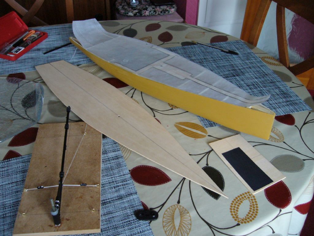

                When building the hull, I added 'strongpoints' into which I can screw through-deck fittings. It occurred to me that it might be a bit hit and miss trying to accurately locate them once the deck is in place. I therefore took a roll of baking parchment (in lieu of tracing paper) and carefully pinned some to the hull over the deck aperture. I traced around the structural elements of the hull. This means that I have an accurate picture that I can lay over the deck, almost as an x-ray picture of the skeleton that lies beneath. I'll go further and accurately depict the locations of all the interior fittings so that if I have to do some surgery to the deck at some later stage, I know precisely where to wield the scalpel.

                  Good idea for the X-Ray diagram.
