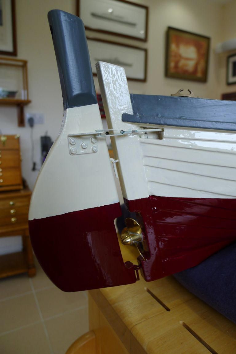

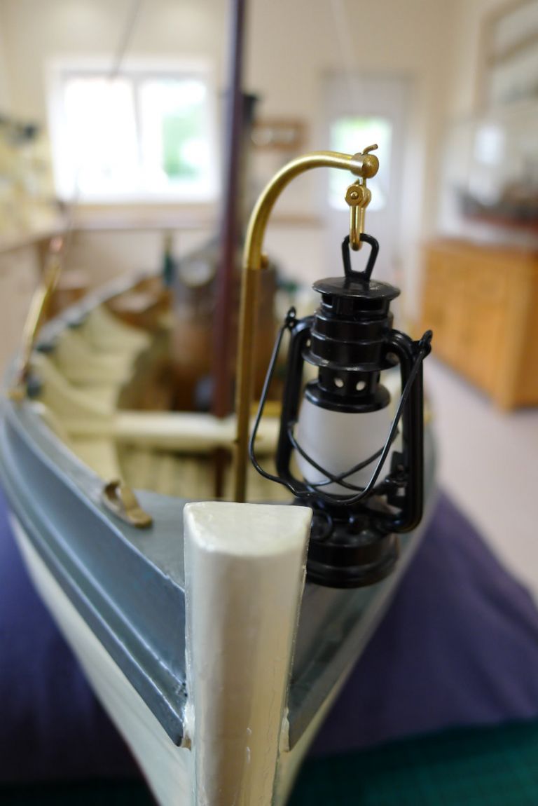

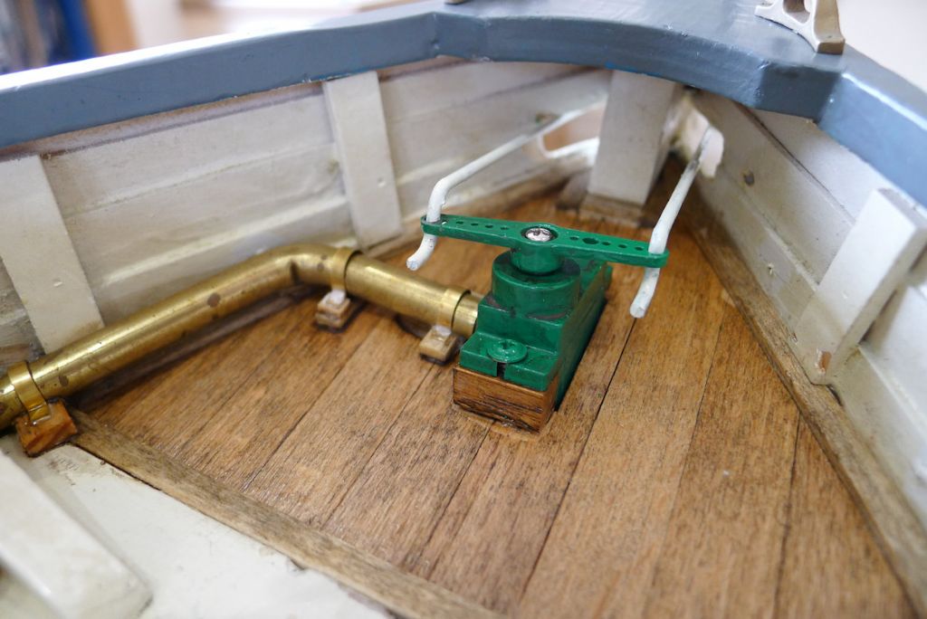

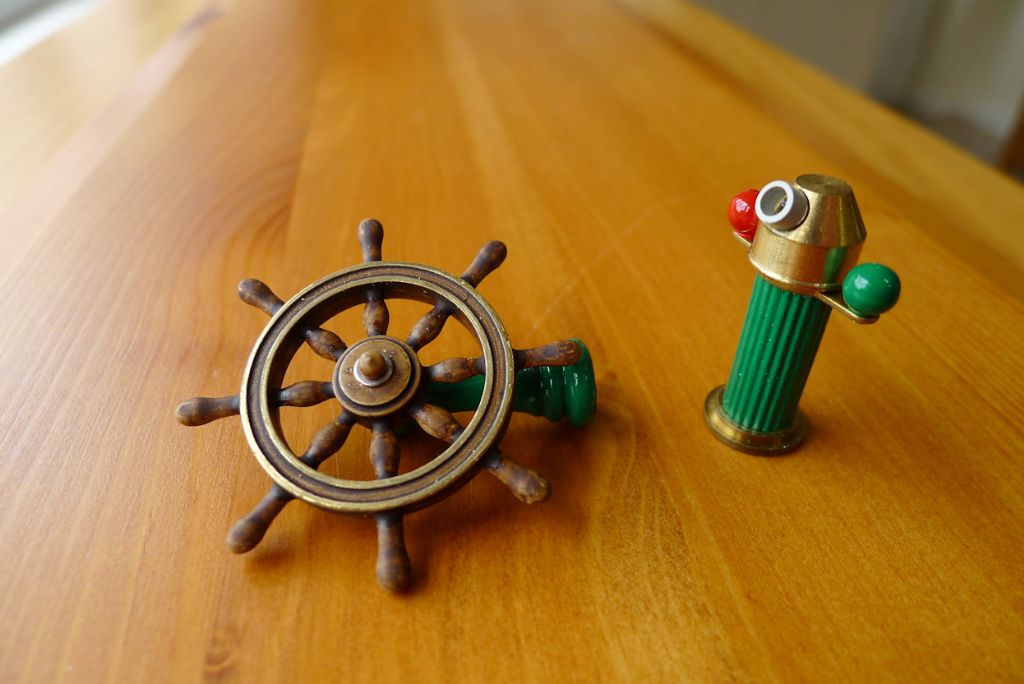

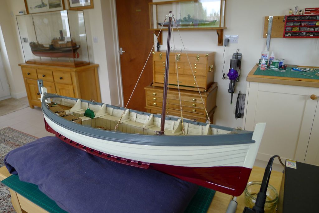

              Just a bit of progress with the steam boat. Mainly the fiddly bits of detail now. The shaft is in and the rudder all connected up, the hull, after a further test in the bath proved it was sound, has now had a couple of coats of ivory on the top and burgundy below the water line with a grey along the top of the bulwarks.
              Still more fiddly bits and pieces of detail to do but not too far away now. The final job will be an overall careful weathering to take the high gloss off the hull and bring everything together.

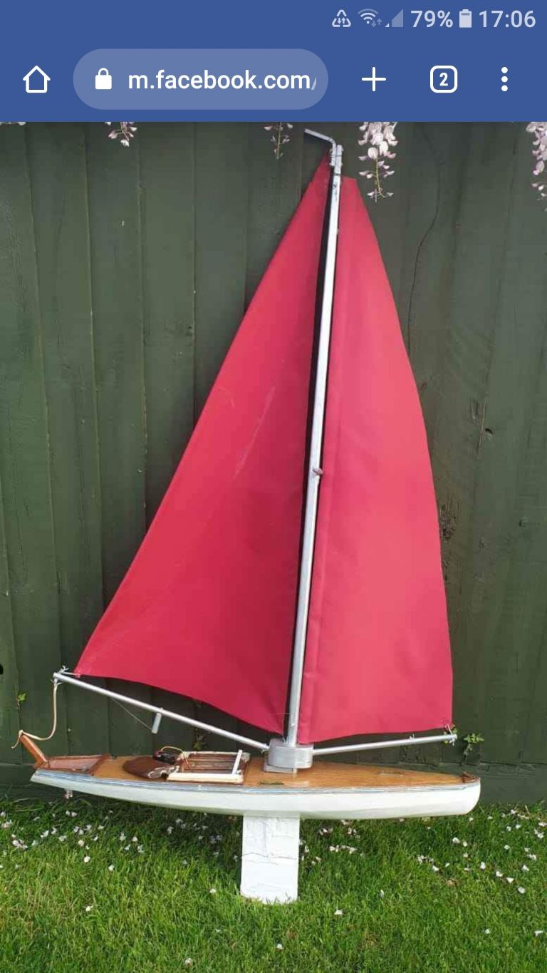

                  Hadn't really intended to take on another refurb, but this is just so different ….and I've no idea what it started life as but I don't think it had that massive swing rig originally.
                  #96539
                    That's certainly an unusual piece of engineering at the base of the mast. Does that just hold everything in place?
                    #96541
                    Nigel Northwood
                      @nigelnorthwood17509
                      The yacht is fitted with a 'swing rig', where the mast rotates and the jib is attached to it's own boom, usually with a sprit/spar underneath the sail which pivots on the boom. While initially complicated, the amount of adjustment while sailing can be reduced. Why the mounting block for the booms is so massive, I don't really know. The boat is 200 miles away at the moment. I saw it on Marketplace and it happened to be very close to where my sister lives, so she collected it. I'll go and get it next month.

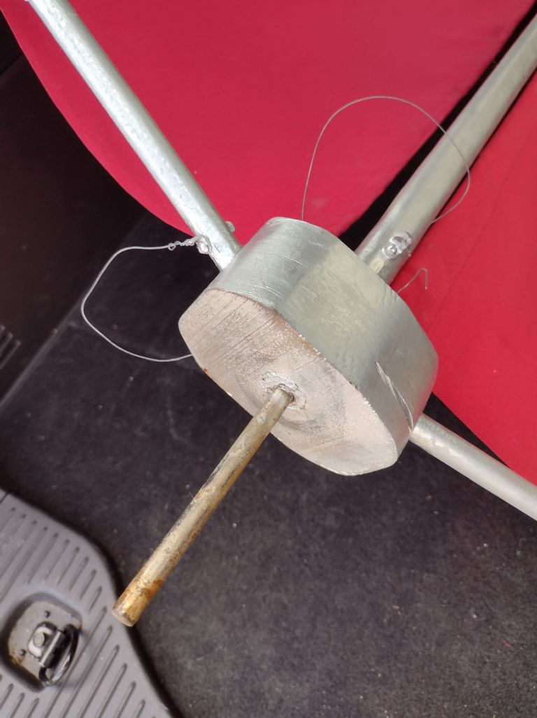

                        #96548
                          I guess it is certainly going to hold things firmly in place!

                            Just guessing, but I have a feeling that the original builder had some misconceptions about rigging a yacht which might have contributed to the abandonment of the project. Some closer pictures of the sails might help confirm or deny.
                            As a general rule, the leading edge should be arranged to be straight, the trailing edge left to find its shape. On most swing rigs the fore sail has its own boom rather than being loose footed, and, just like any other yacht, there is a "slot" between the trailing edge of the fore and the mast.

                              If I decide to stick with the swing rig, I'm certainly going to slim it down!

                                I wouldn't put any importance on the existing sails and rigging. They've been just tied on (for display?). The deck still has shroud plates so I think it had a conventional rig when it was built (the mast has a spreader and eyes at the bottom for a diamond rig as it is).
                                It'll certainly need a spar in the foot of whatever foresail I make up for it

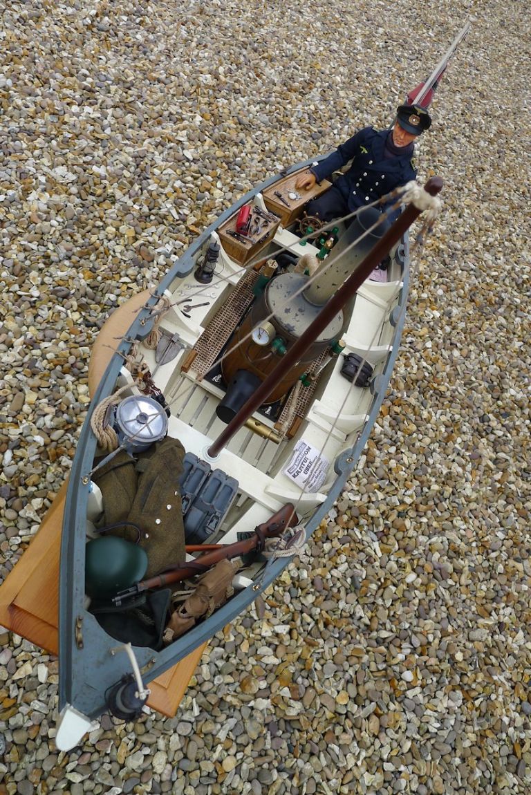

                                  Finished, works in the bath, just need to try it out on the pond.

                                    That looks amazing Richard .

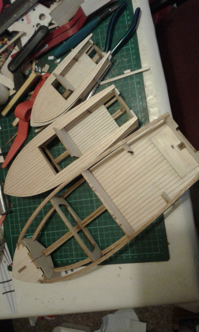

                                          Three sizes of the same small Cabin Cruiser – 7, 10 and 14 inch -awaiting an outboard to power the largest one – held up because of the pandemic – only received the 9g servo for powering the smallest one last week. All to the same design using Les Rowells Aerokits method of building – the kits were cut on our Laser so parts are a very accurate fit and a pleasure to work with . The two smaller ones will use dummy outboards as rudders – outboards currently under productioncurrent 155.jpg

                                            Lovely little jobs. Do you think there is a market for them? Maybe aimed at youngsters.

                                              Not out here unfortunately – In the UK there might be a market – maybe I should write them up and send the plans to the Ed – 7" version does not have much displacement to spare.
