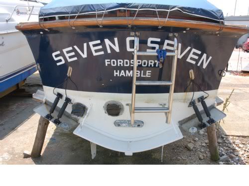

                  Yes we like photos, I'm sure Dave & Chris have drawings of the full-size 31 for the shaft & rudders, here's my twin rudder set up in the H31 Precedent 34" version & a real one in the yard near me. 50mm props sounds a bit big to me and also has to increase the shaft angle to clear the bottom of the hull.

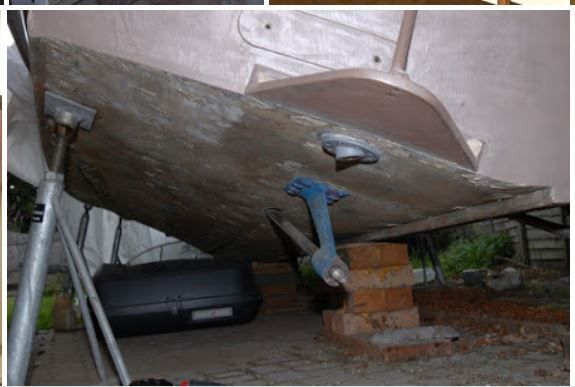

                                don't forget the operational hydraulic trim tabs on the transom 😄😄😄,
                                Sorry, Ray – no hydraulics on cavitation plates on H31 "Mirak". Photo c/o Scott Pett
                                #87890
                                  Hi Dave,
                                  Oh yes they were on the standard boat in your photo, I must have seen them fitted on the go faster version 😉
                                  Thought you would pick up on Joe's bow thruster ??I
                                  BTW that's a great photo ✔ it's interesting that there is an external keel, and those angled "P" brackets would be hard to get right 😎
