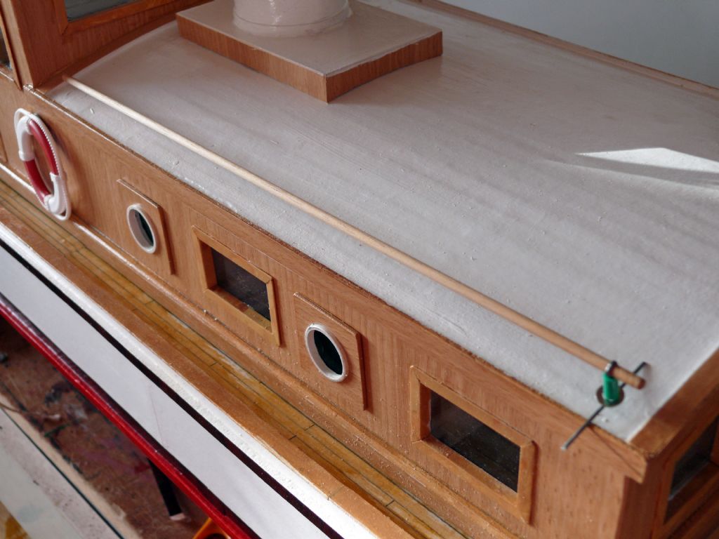

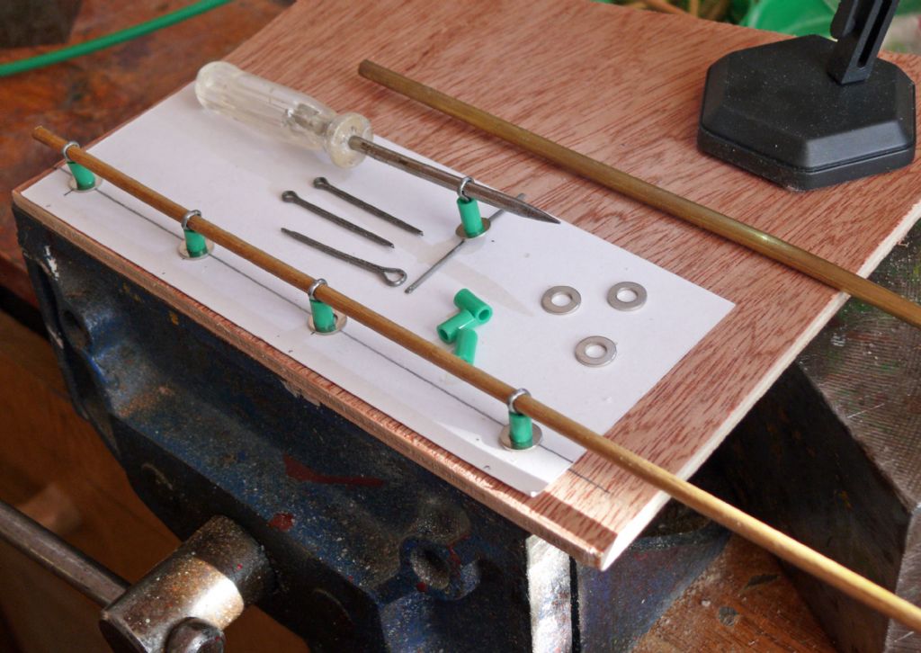

                          The nice tip, first……..I need four lengths of handrails for the cabin roofs, which are essential, but tricky to make easily…….Till now, that is
                          Being a bit lazy in my old age, they had to be simple and cost nowt!
                          Based on soft wire split pins,…..wood or brass, hand rails…….stem extensions……chopped off plastic or brass tube and the job is done!
                          And the good news?………Going for a trial run this week sometime, at Etherow Lake with my pal, Duckie

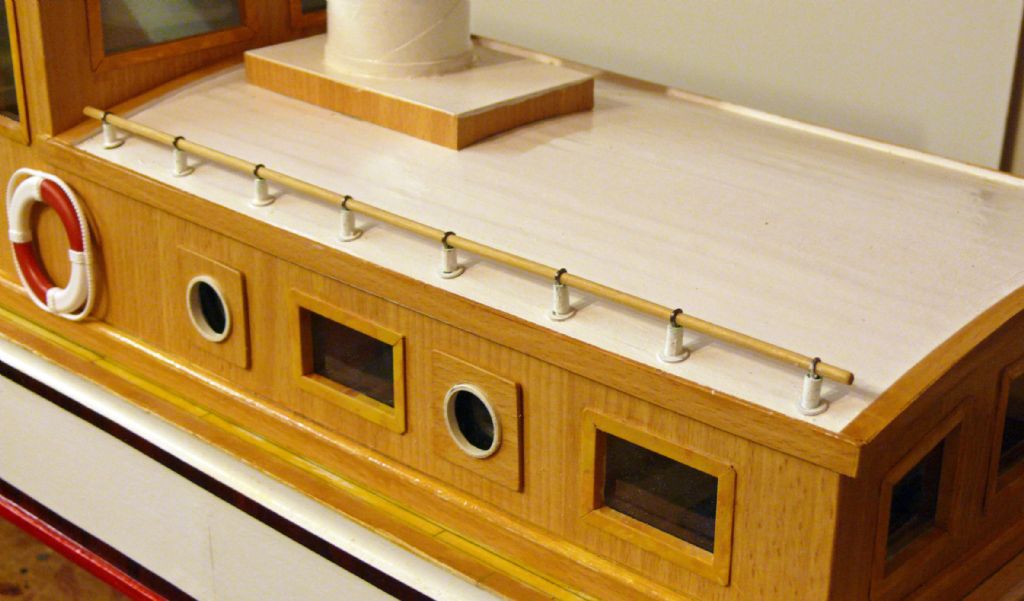

                              A finished handrail……….Probably a few too many?
                              Handrail
                              #74013
                                Probably, but who cares! Looks ok to me and adds to the personal touches that you are making to the boat.

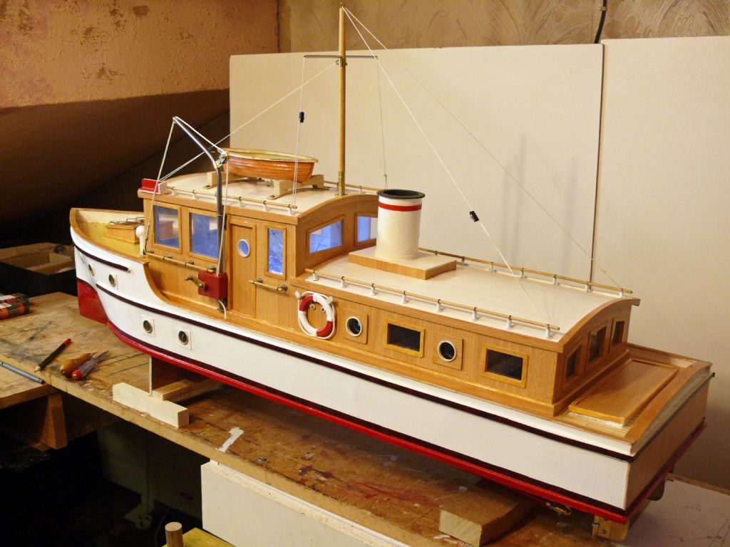

                                          Just realised that there is a mast yet to be constructed!
                                          From the full size photos, the height is about the same distance from the waterline to the cabin roof…….About 9"
                                          It also has a main sail, normally furled, which will be a nice talking point
                                          The Jolly Boat will look better white?
                                          All in all, Lady Jane is looking a Bobby Dazzler!

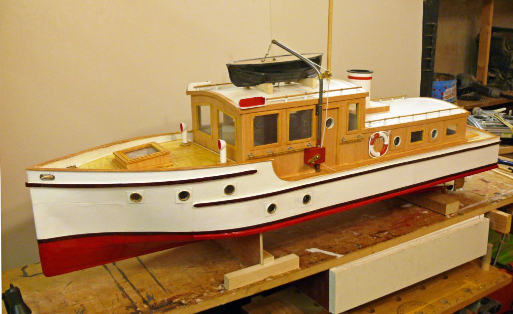

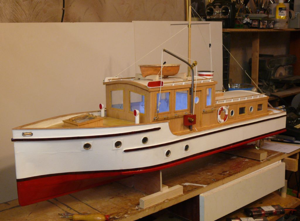

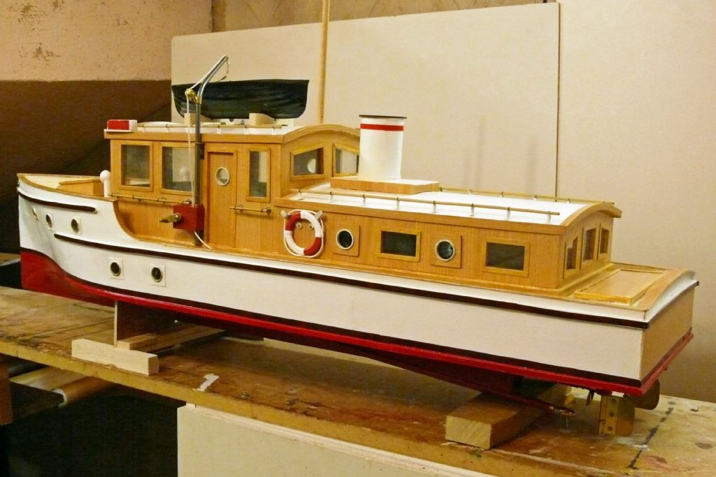

                                                      Work in progress pictures
                                                      Fitted the mast and revamped the Jolley Boat
